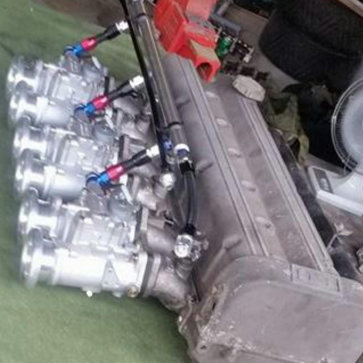

For so long i have been trying to get this job from japan. Finally its going to happen bits are turning up and parts ordered. Going to be a epic build going all out 90x90 bore stroke .full work over of the old head .stay tuned

Think this might be the most expensive L built lol. The head is one of the last original heads os made .and its been sitting in a shed in Japan for over 25 years lost till last year .. so looking forward to bring it back from the dead

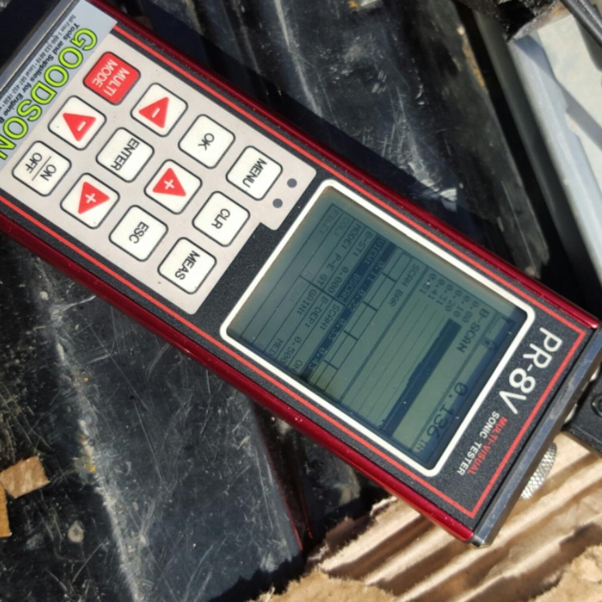

It all starts with a good block ..trying to find a block that will go 89 mm or bigger is not a cheep experience now ..i went through 5 this week. To get 1 that will be safe at 89mm perfect for my build as im using a billet 90mm stroke crank . My goal is to crack 400hp on a superflow engine dyno at 8000 rpm .stay tuned
