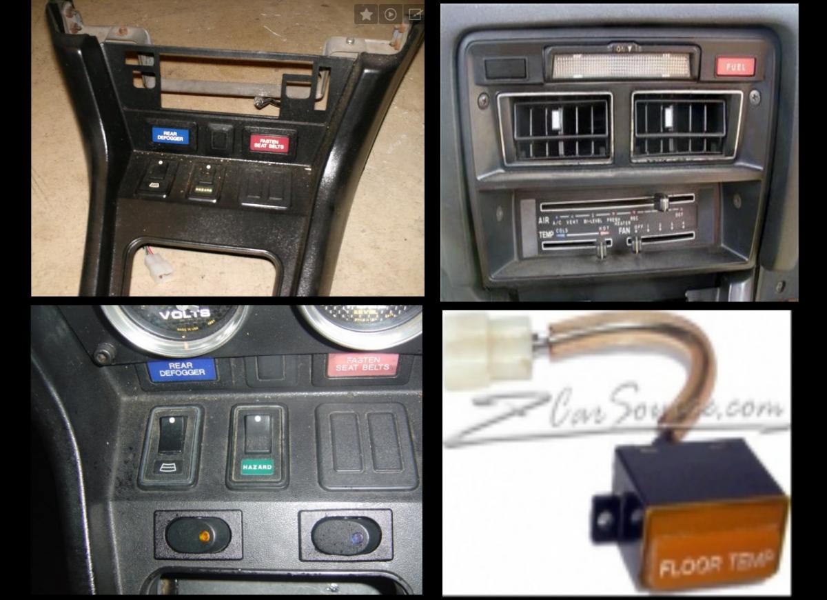

I did a quick search on line and put this composite together for you.
The fasten seat belt, floor temp and low fuel lamps were for the US market and you can see the positioning in the pics of the Fasten seat belt lamp in the center console and the low fuel lamp to the top right upper fascia, the floor temp lamp slotted into the upper left hand side.
The floor temp lamp was part of the 280Z package with the L28 injected motor running a CAT converter which sat beneath a floor pan bulge directly below and to the right of the drivers seat in the 280Z, seems it would get a bit hot at times. Australia never got this option so those 3 lamps are relative only to US ( EU ? ) vehicles.
I assume the remaining blank plated spots were for after market owner switch provision.

I have a heap of switches collected by previous owner- chokes, hazards, demister, fuel warning for up near the the air vents (small rectangle). from what I can tell it should be as giltech describes ( the top left pic from Sirpents post minus the fasten seatbelt light) as the console i have replaced had a demister and hazard switch, demist light and the blanking plates had been modified/drilled for thermo fan and fuel pump switch and the small upper centre square blank drilled for the kill switch light.
