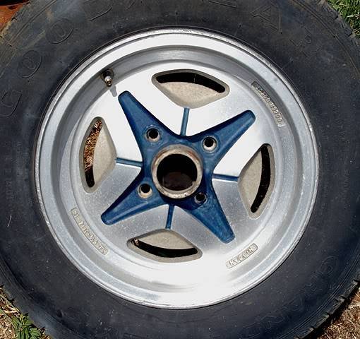

So this is what my starting point is...
Posted Image

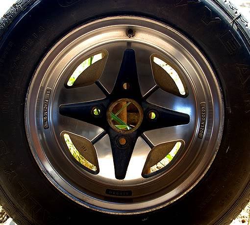

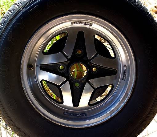

As you can see the wheel hasn't been polished in a while but it is not beyond redemption. The recessed areas have been colour coded to match the Z it came from. So after about 20mins of swearing and sweating The wheel looks like this...
Posted Image
As you can see it came up all right but could be better. So next comes the repaint, I was originally going to mask of the wheel and pressure pack spray the recessed parts. After messing about with the masking tape for 10 mins and getting no where fast I decided to turn to plan B, hand painting with a fine brush. It was tedious but I think it's OK for a first coat.
Posted Image
When I have repainted the hub haps and installed the wheel, I think the black will contrast the shine of the alloy to highlight it's brilliance. When this is done I will post another pic.

Much better with the black centers. I remember using a $20 alloy buffing bit from Bunnings some years ago on my rocker cover. I was quite impressed witht he results. Might be worth looking at if you want a really shiny finish. From emeory also remember talk of using some sort of clear coat to retain the shine on the alloy.

The product I used was "Autosol Metal Polish"
Posted Image
It's a paste that you rub with a soft cloth. You then wipe off the excess with a different, clean cloth. Apparently it also works on fiberglass.
Since it is suggested that a Soft cloth be used, I would think twice about using steel wool.
Took Toecutter's advise and mechanized the operation. I tried to find a polishing bit but my local hardware store didn't have one. I ended up settling on a 5 inch diameter buffing pad which just fits between the outer rim and the central hub.

I struggled away for years polishing my mags with that fabric polishing stuff in a yellow tin. Takes ages. Anyway one day I asked my brother how he kept his mags looking like new. He bought from bunnings a polishing kit for about $10-$15.00. This included a couple of fabric connectors that go on a drill bit and some chalk all in one pack. Fantastic. I now use this. 10minutes on each corner and then I still finish off with my old fabric wool type stuff. Now my mags are kept pretty good all the time.

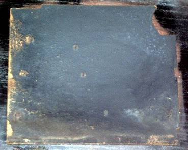

Passenger side came out easily as there were no rubber lugs on this side!

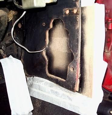

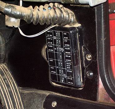

Drivers side started off well, fuse box unscewed and moved to one side, bonnet release bolts came out without any fuss, and then there was that electrical stuff above it. The first scew closest to the door was simple but the one on the fire wall side was impossible (for me) to get to. This calls for my trusty/bodgy friend "Plan B". So I masked the area up redy to spray it in place. See pic

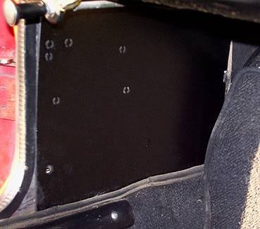

Fairly straight forward. I used a pressure pack of Black enamel satin finish paint. Passenger side was done outside of car. Crawling upside down underneath the steering wheel is beginning to become second nature. Bugger pilates work on your Z!
Posted Image
Re Installation
Still need to source some lugs for the passenger side.
Posted Image
