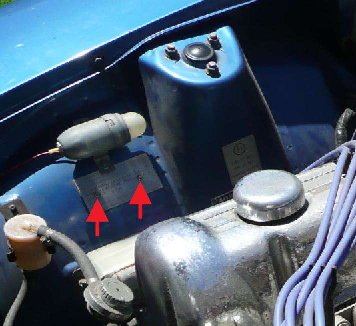

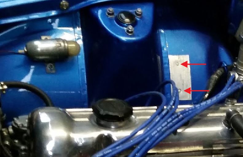

Does it have an Australian compliance plate like the one in these 2 photos? (it might have been in a different location - it varied quite a lot)
post-101663-0-51541700-1442797679_thumb.jpg post-101663-0-44496600-1442806261_thumb.jpg
If not, does it have two rivet holes (in or close to, the positions shown by the red arrows) to suggest that it might have had an Australian compliance plate that was removed?
