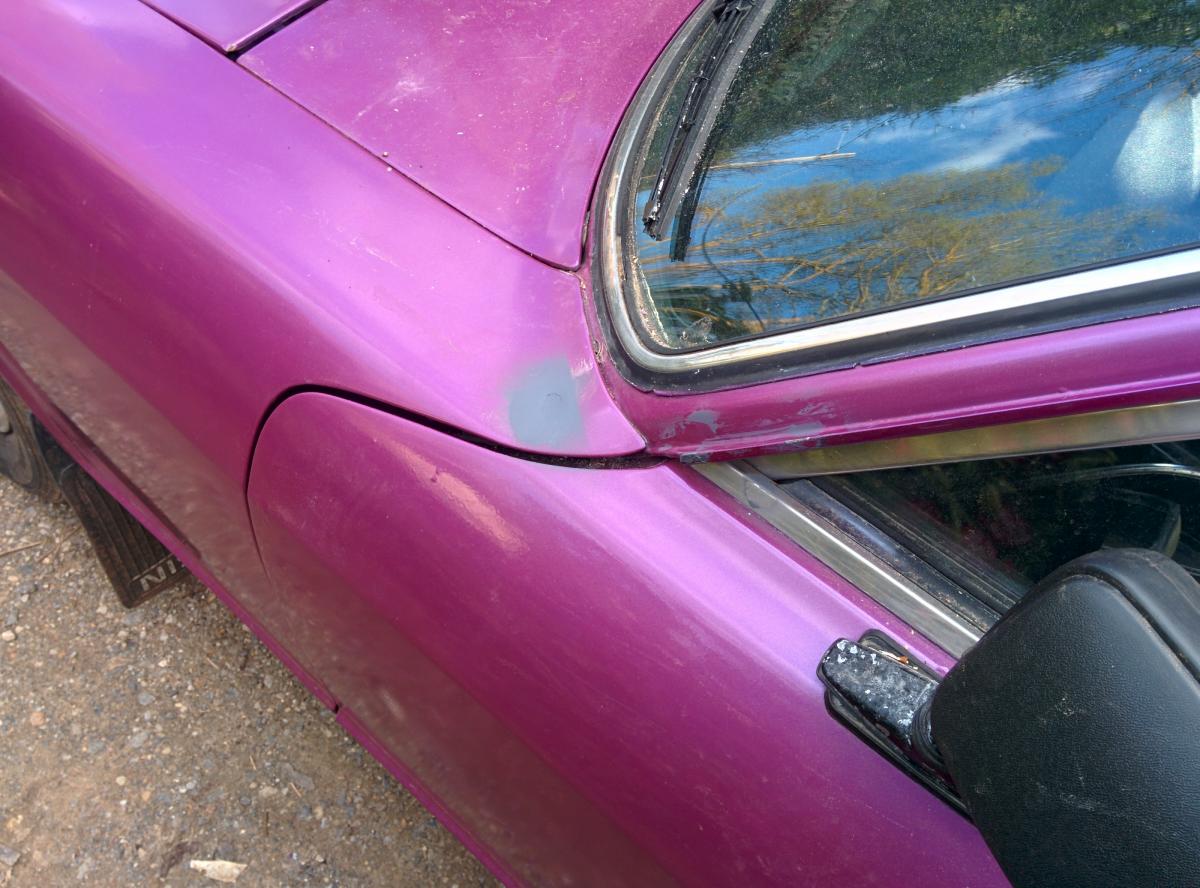

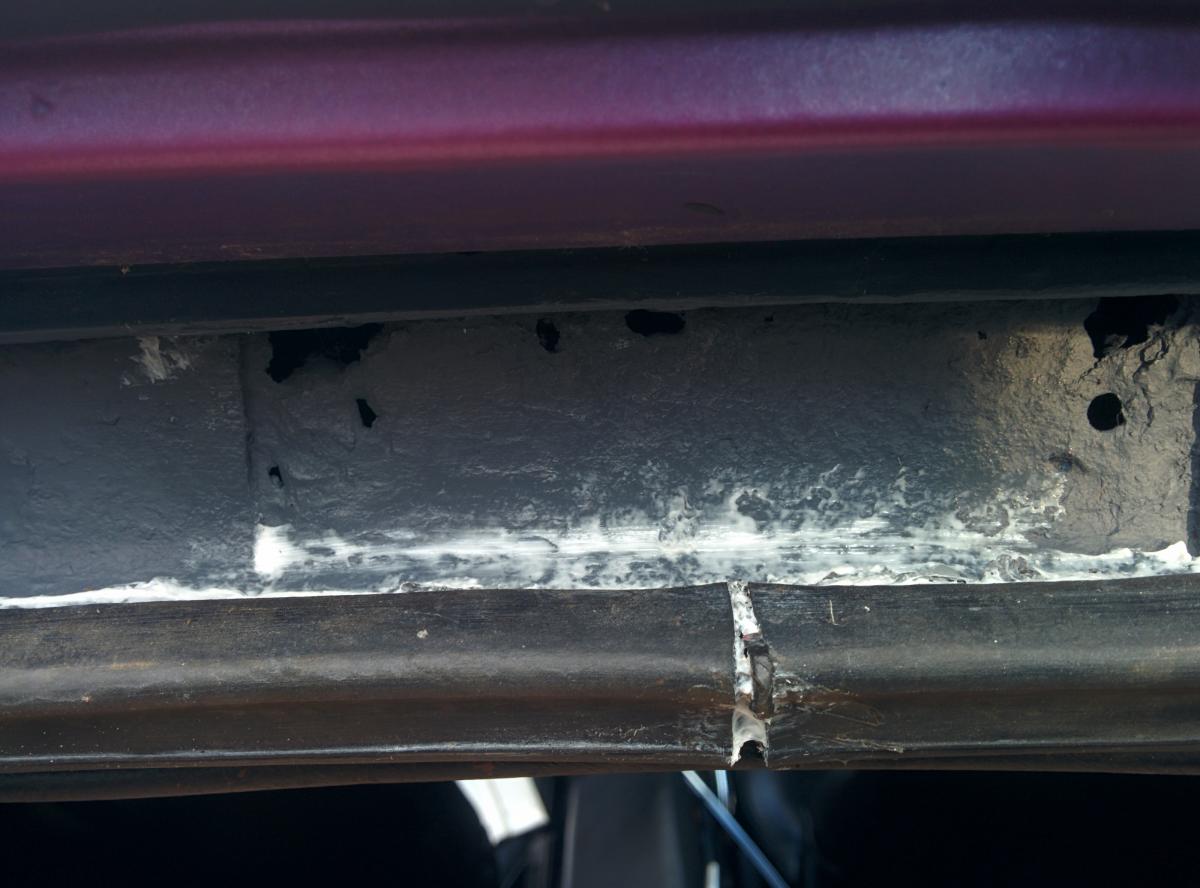

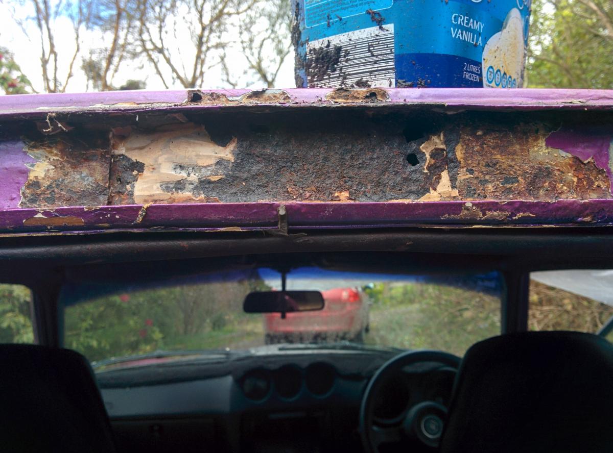

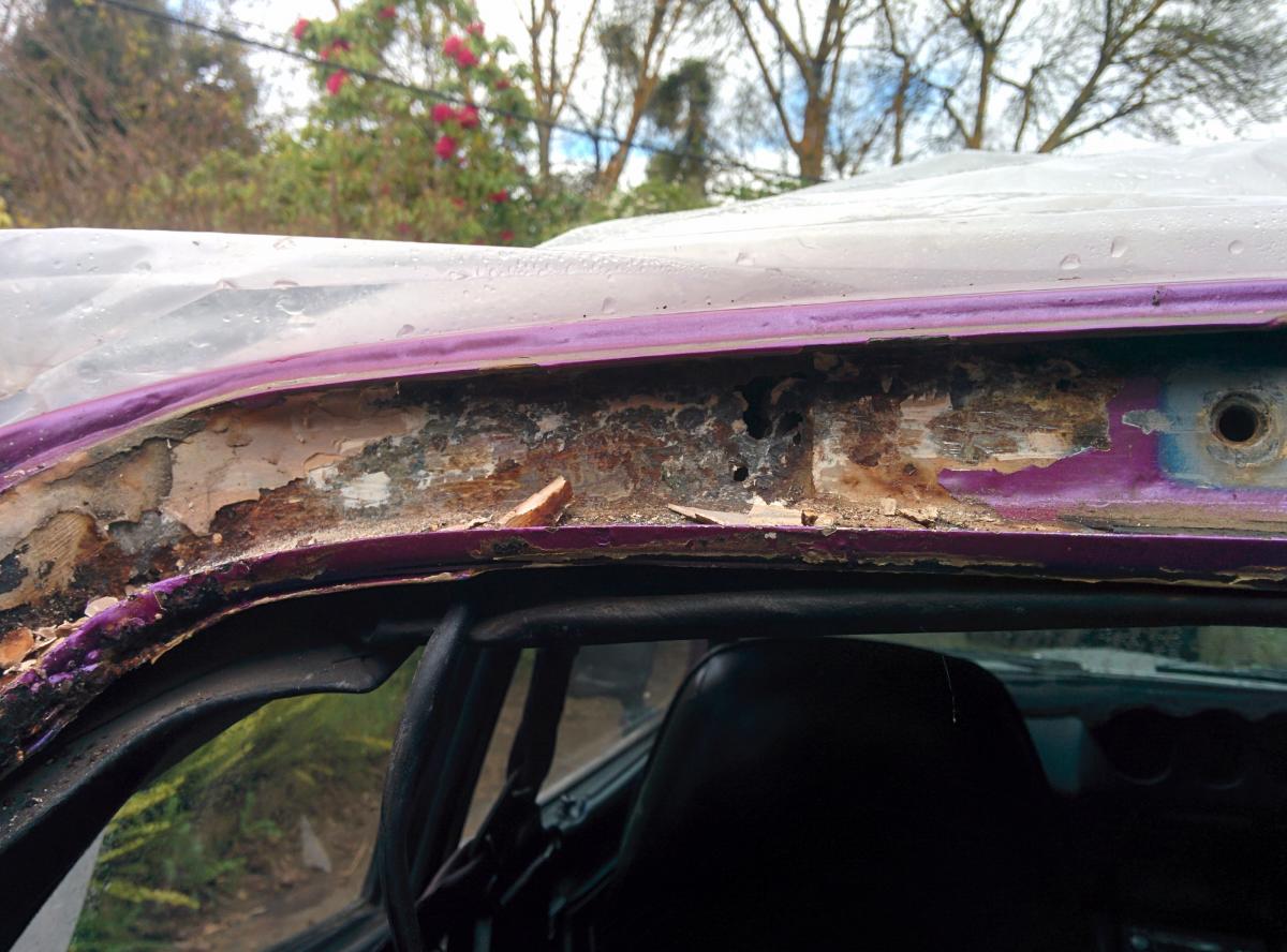

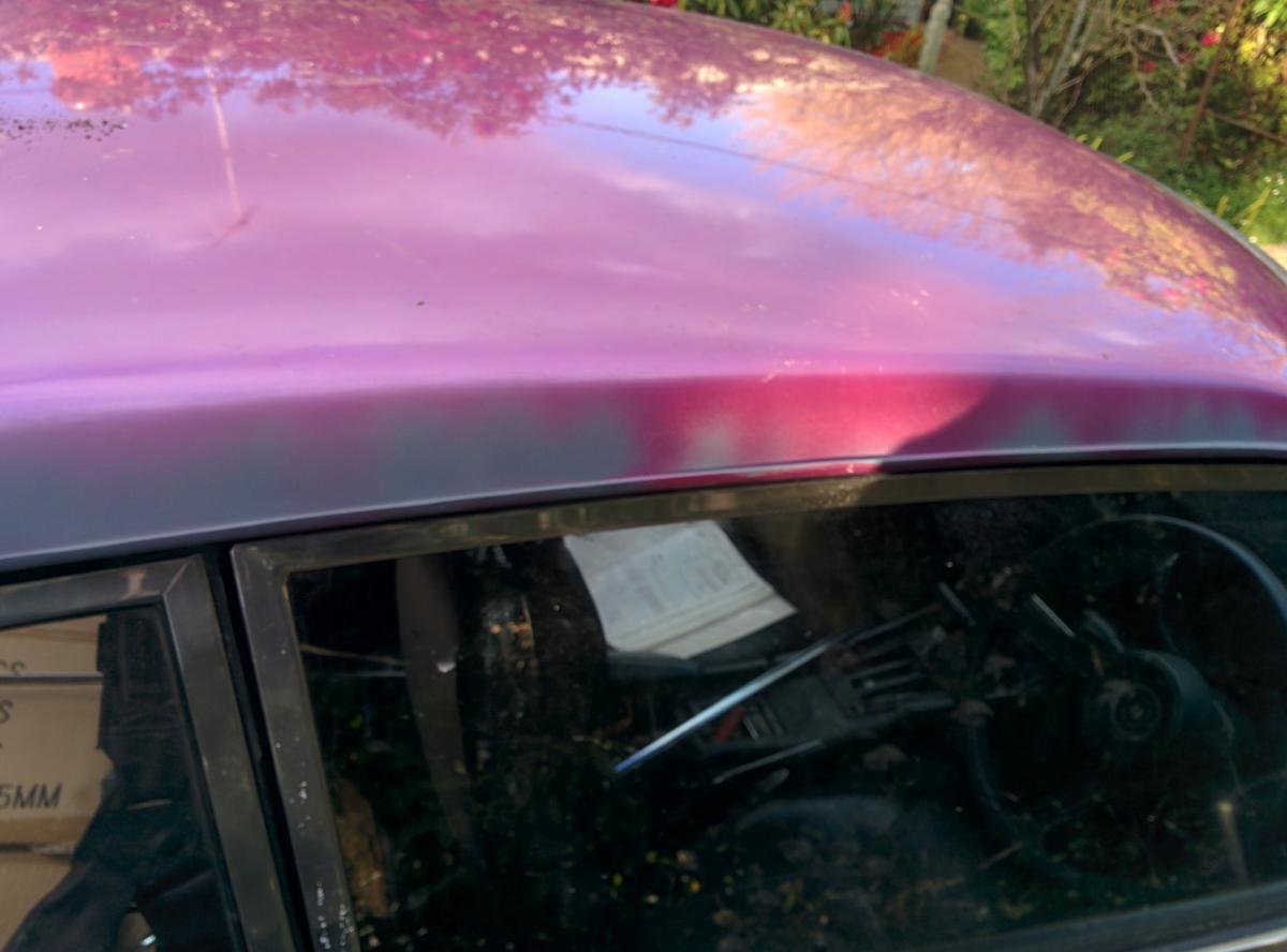

So not a hell of a lot has happened since my last update however I started my first bit of body work (sort of)
As many of you were aware this car came with a simply tragic spoiler and it had been crudely screwed onto the rear hatch, these holes had begun to lightly rust (nothing too bad but needed to be dealt with, so I began to take up the paint surrounding them only to find around 1mm of bog  :o so I took some bog out, then more, then more and more. I was so ridiculously worried but I couldn't stop. Anyway, it turns out that the de-badging was not done well to say the least, it appears that someone has plug welded the holes over however not grinded back the welds and instead just built bog up around it. So after that ordeal I'm left with this decent sized patch of bare metal, currently it is covered in duck tape but that will soon change! I have decided to roughly paint some primer on it then vinyl wrap the car! I have got a 10X1.5 M roll of matte(ish) silver wrap here waiting to go on, this is only cheap stuff and may damage the paint, I'm not too worried about this because I've decided to sand back any rust bubbles, prime them and wrap over it, this way I can stop any rust in its tracks without starting a massive overhaul on the body work, before I paint and wrap the rear hatch (and maybe fenders) I would love to drill out the plug welds so I can attach the badges. If anyone happens to have the measurements of where these holes are that would be a godsend  ;D
I also went into a brake shop today to see if I could order new break drums, apparently there are only 4 left in Australia and they cost $174 EACH! plus $25 freight EACH! so I have decided to look around for a cheaper deal. I assume these may have been OEM ones and thats why they are so expensive. Also got the headlights working properly after re-wiring and fitting some new plugs (thank-you Factory Service Manual  :) )  Engine bay has been degreased and looks mint, turns out that I have a slight oil leak from the rocker cover gasket and I plan on replacing that gasket pretty soon. I managed to get the heater working fairly well after flushing the heater core, greasing the tap and sort of fixing the vacuums lines, If anyone has a diagram of how that all fits together that would be amazing. The rims have been mostly stripped as I couldn't stand them having purple accents!
Anyways looks like we might be going back to "The Questionably Purple 260z"  ;)
Oh and thanks to the thread "you can fix your 260Z clock" in the interior section I now have a functioning clock, I am still adjusting it slightly but all it needed was new caps!
Enjoy these photos, I have since fixed up the back seat (with some neat work with vinyl tape)
As always high res photos are available in my google drive
https://drive.google...aGdoWmw5QzNKNlU

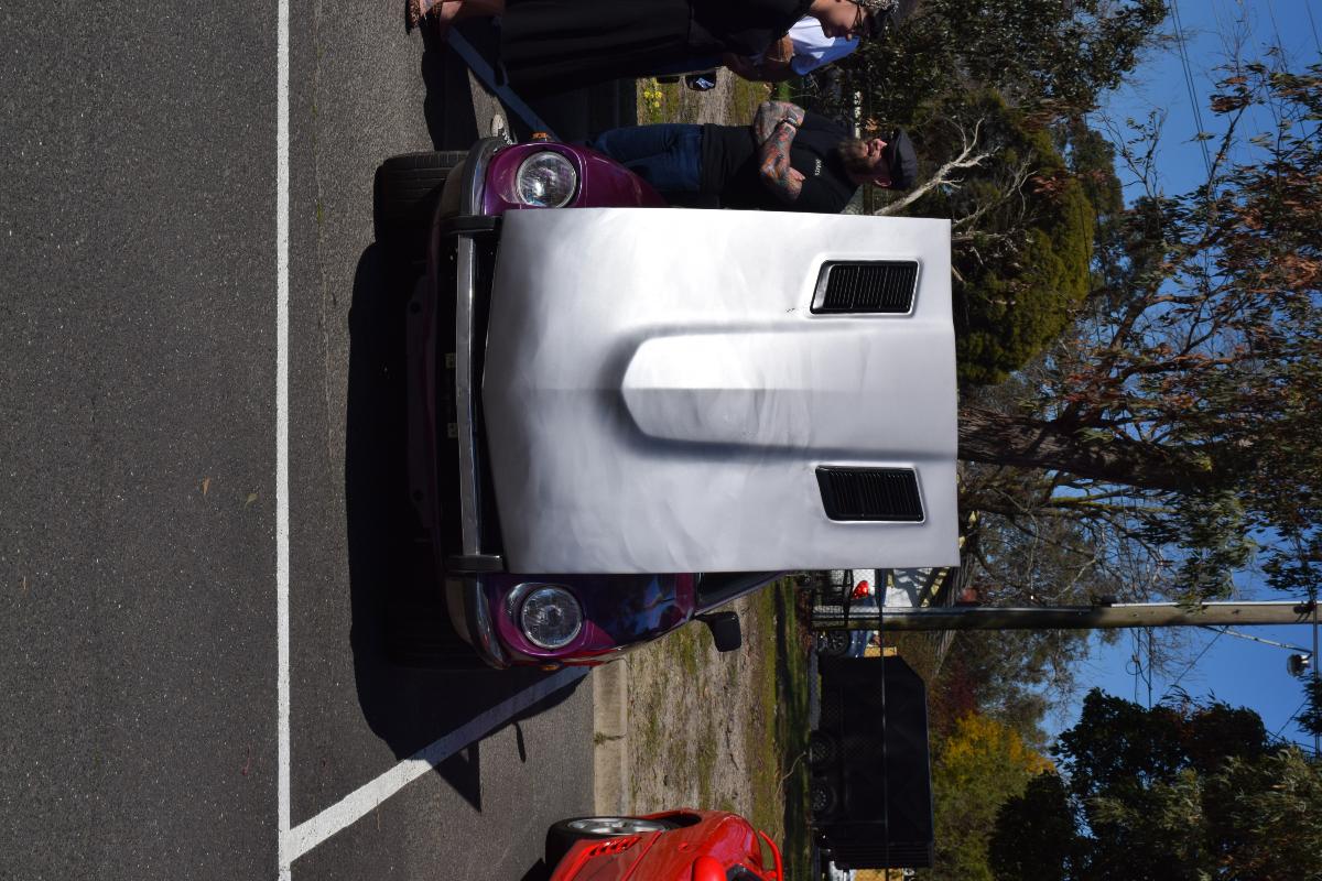

Posted 23 August 2015 - 09:29 PM

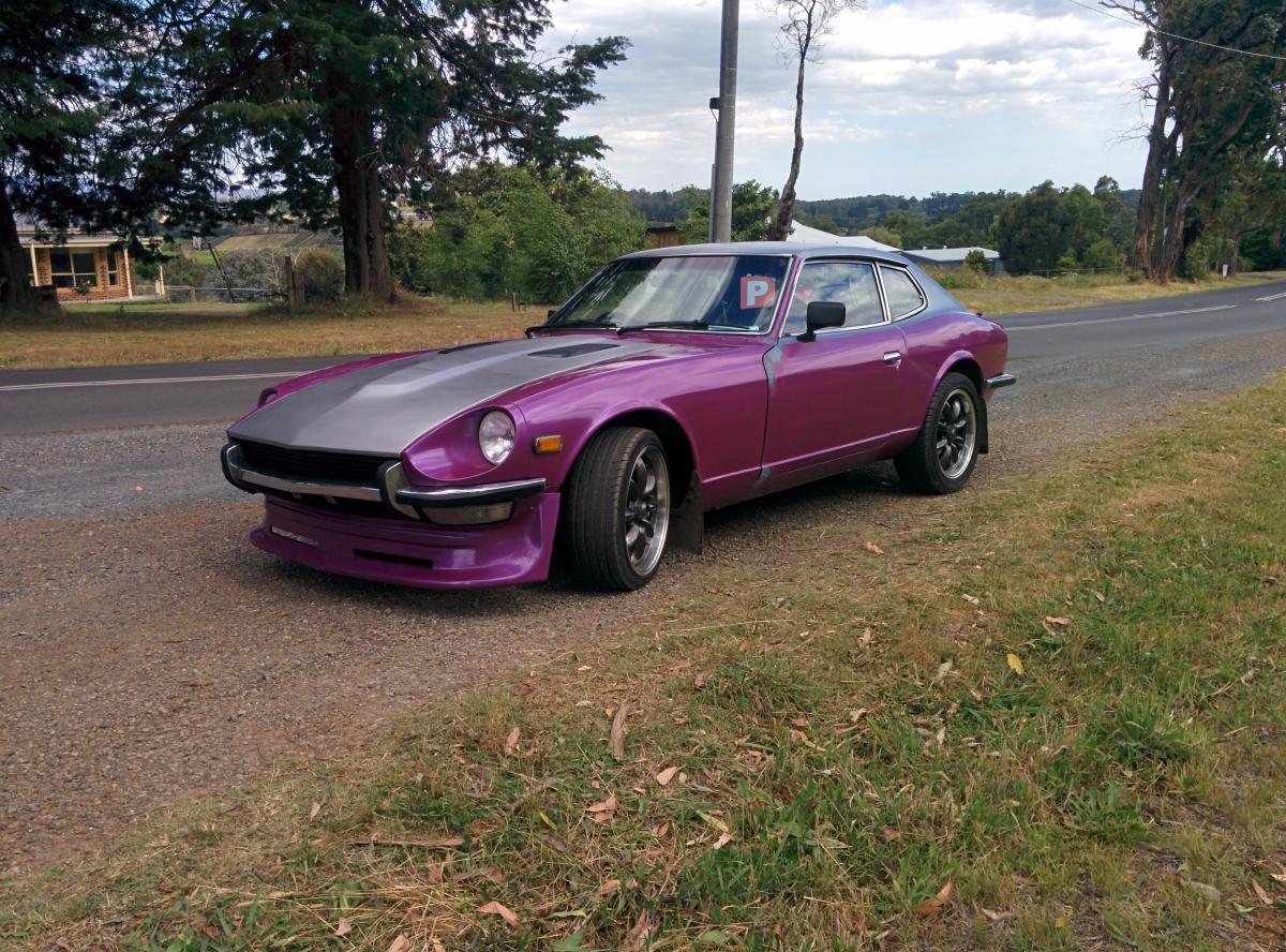

This weekend I wrapped the bonnet, it was half for practice so I will probably re-do it some time now that I know what to do.
Next week is the dreaded hatch.
Also the new image uploader, I'm in love *_*
Edited by Andrew_L26, 23 August 2015 - 09:31 PM.
  • casho likes this
#75 PB260Z
PB260Z
    Peter (PB)
  • 3,281 posts
  • Location:Northern Sydney
Posted 23 August 2015 - 10:52 PM
Gidday,
Looks like a good result, how hard was it to shrink the wrap around the bonnet bulge ?
PB
#76 Andrew_L26
Andrew_L26
  • 408 posts
  • Location:Melbourne
  • Tagline:That Purple Zed
Posted 23 August 2015 - 11:00 PM
Gidday,
PB
It was fairly easy, the stuff is just like a huge sticker so you just put it on with a squeegee and some heat from a heatgun or hairdryer (which allows it to be stretched easily then re-heated to shrink back again)
Loving the member status of "Peter" by the way  ;)

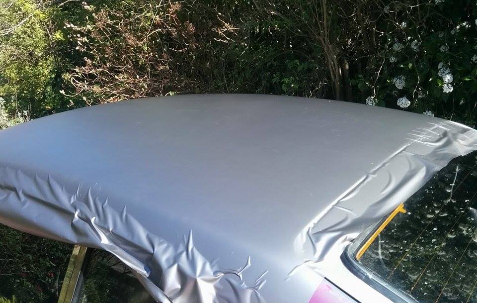

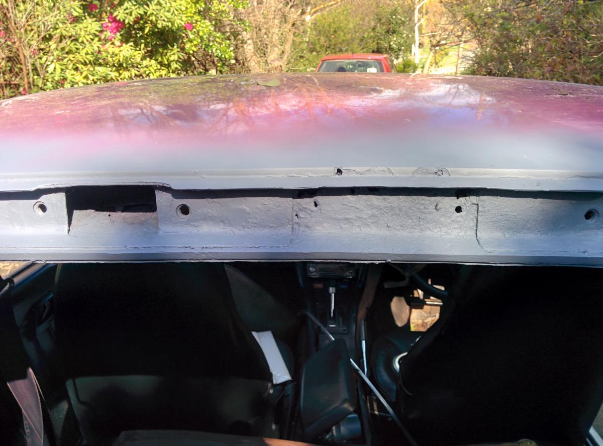

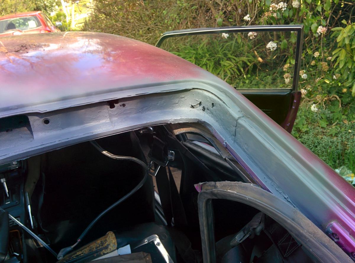

#77 Andrew_L26
Andrew_L26
  • 408 posts

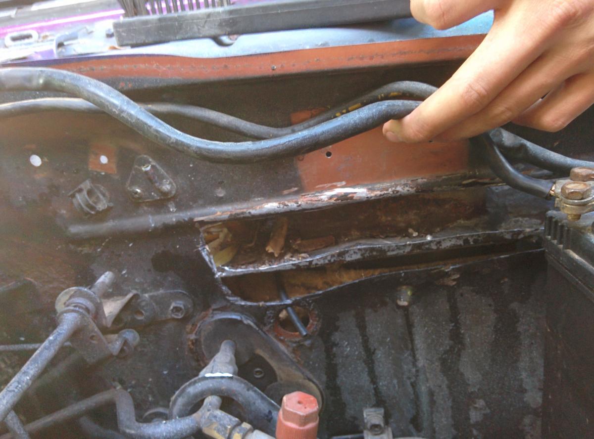

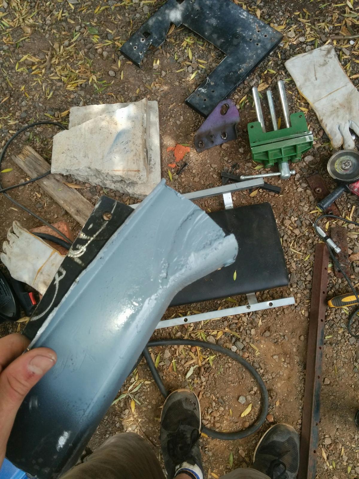

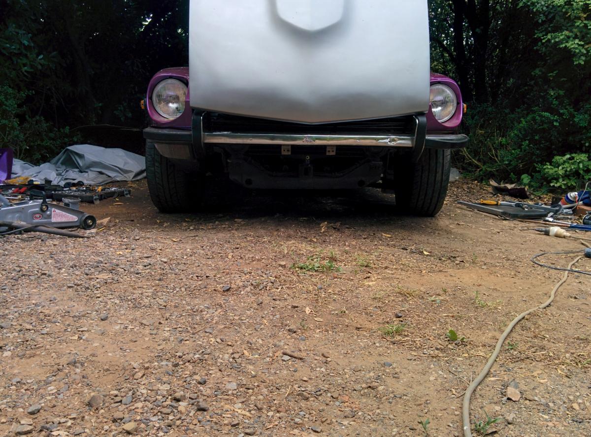

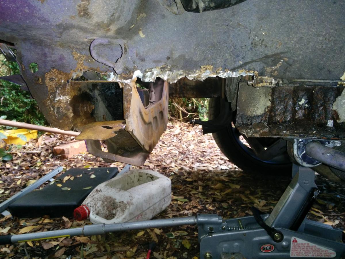

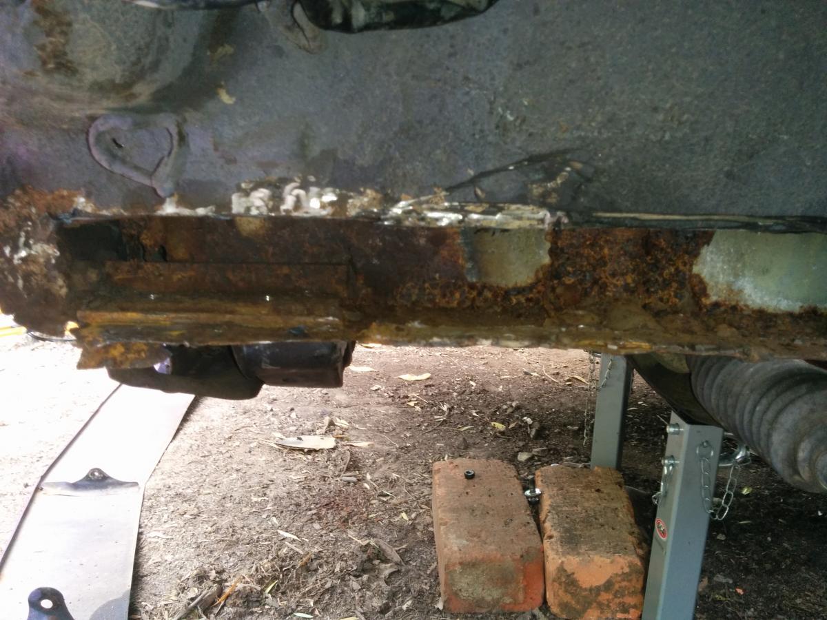

Posted 06 September 2015 - 12:37 AM

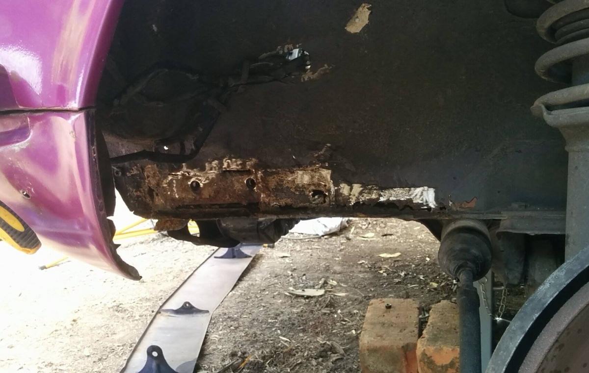

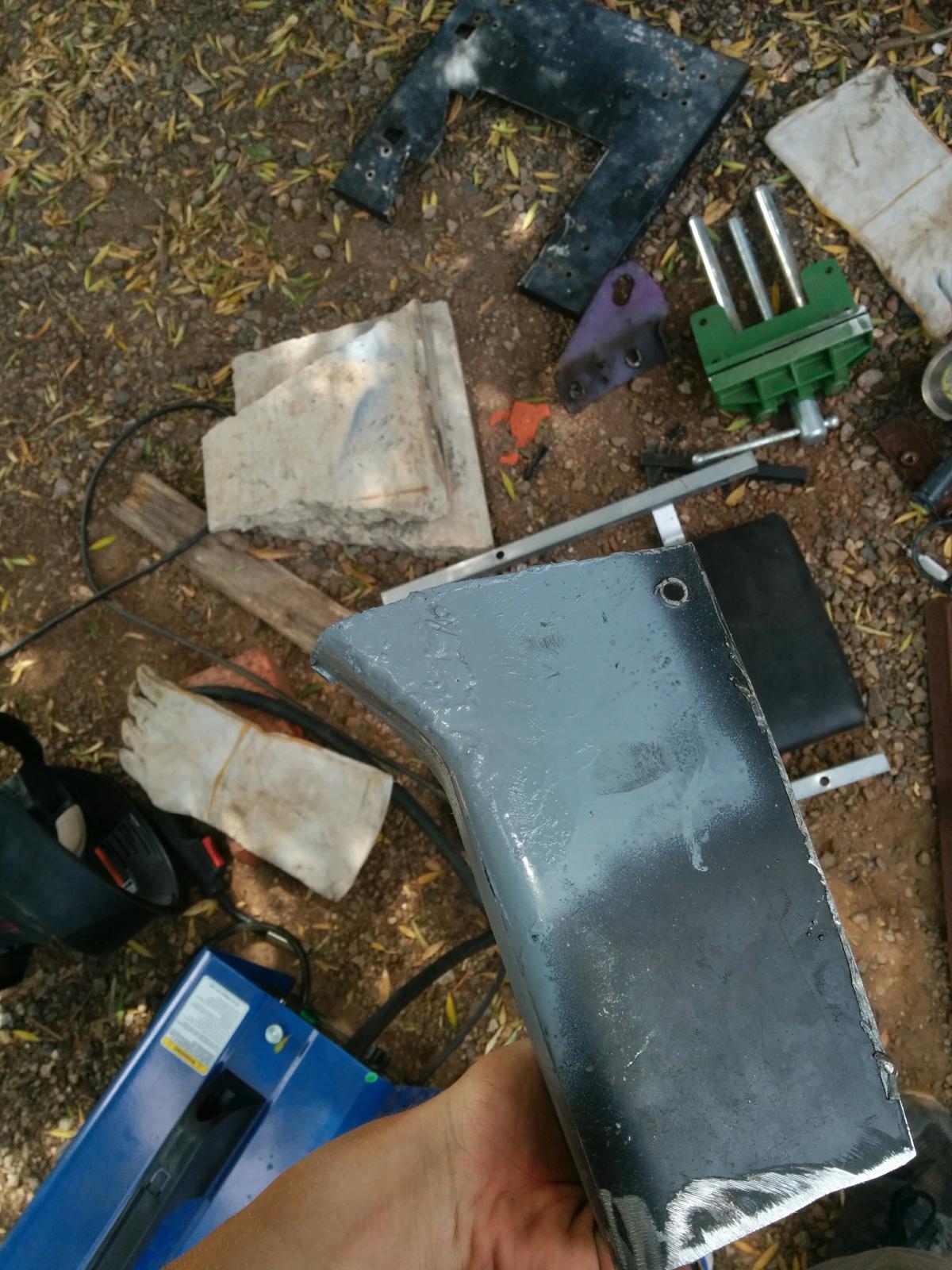

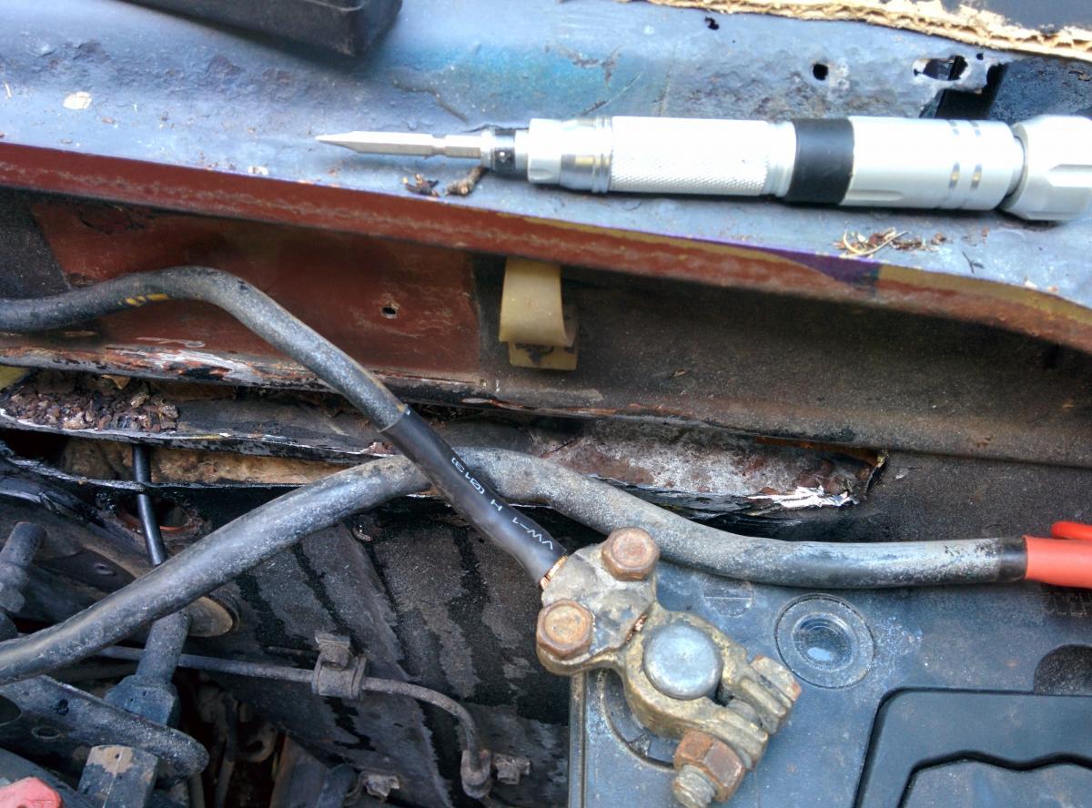

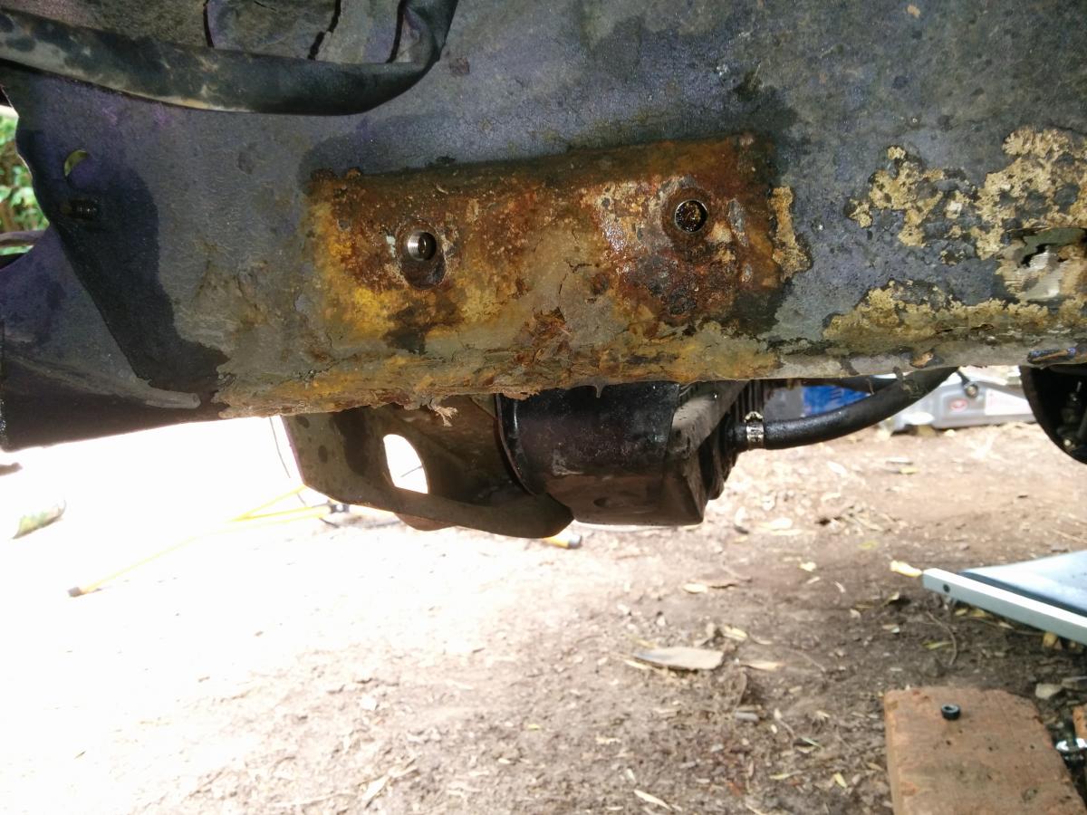

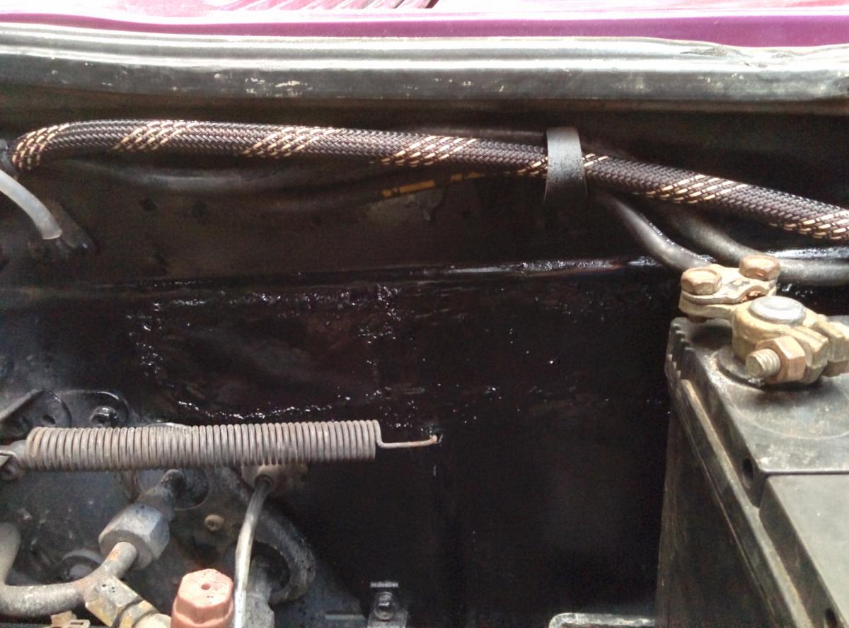

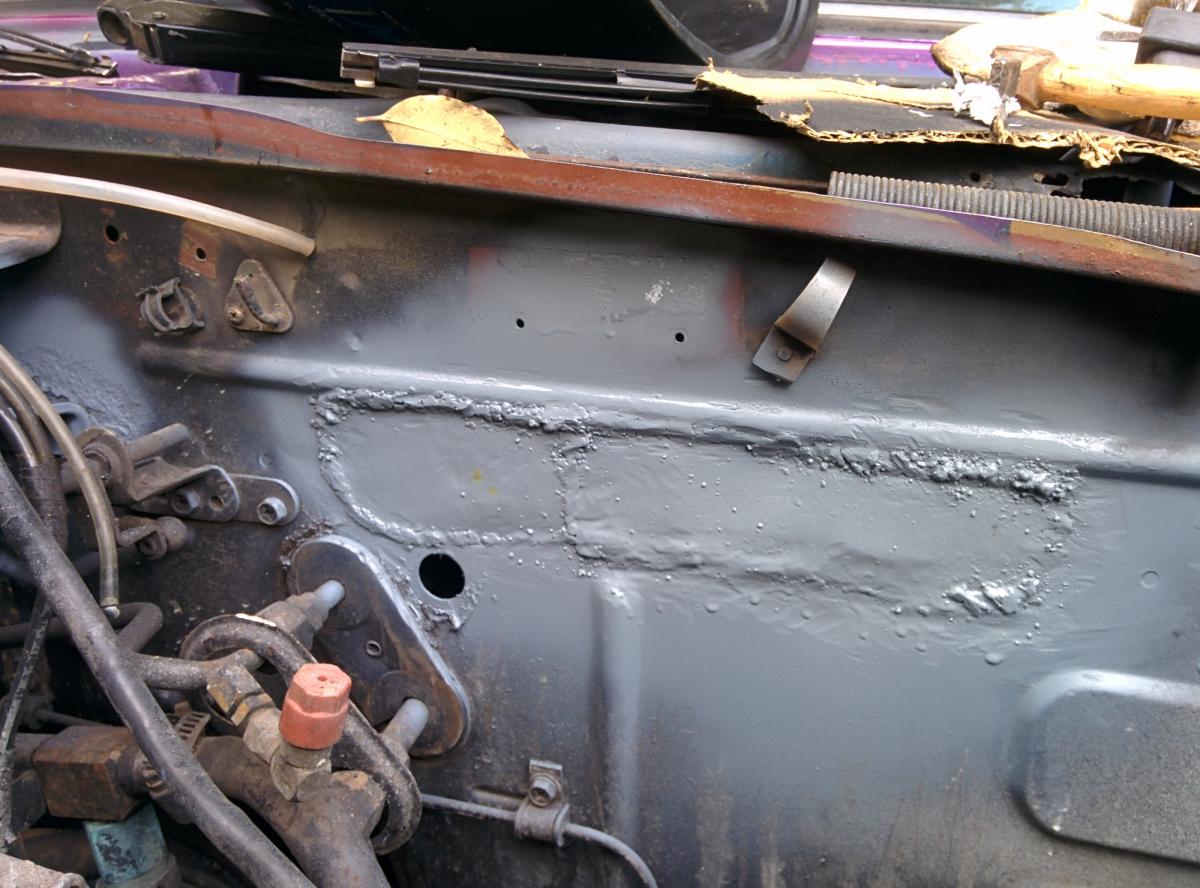

So today was a day of much progress and rust removal (sort of)
As many of you know my plan is to wrap the car so that I can utterly destroy the paintwork underneath by which I mean get every little bubble out and put some primer on it. That stage has started and been nearly finished today. The first thing to do was get rid of the rust bubbles on the drivers side rear window. That just required some sanding, rust converter then primer. Now the upper hatch sill...... I have been scared of it since I first inspected the car and always knew it would be an issue. Anyways, I removed the rear hatch and got to digging away at the bog. It wasn't too bad however I know that there is probably some issues under the roof around the frame. There are a few rust holes here and there however these are going to be plugged with silicone and wrapped over until it is time for a proper respray. My process for all this was Bog removal>Wire Brushing and sanding off loose Rust>Rust converter>Primer and that is all that I am going to do at the moment. Next weekend the holes will probably be plugged up with silicone ready for wrapping. I am thinking that I will put some bags of rice or Silica (the stuff that removes moisture from food) in the holes where the hatch hinges go and up behind the interior light in an attempt to get rid of moisture. I also intend on essentially filling the entire area with fish oil and or WD-40. Maybe I will get some spray on rust converter and see if I can get that up in there.
Must say that rust converter is incredible, it gives the metal or what's left of it so much more strength as well as stopping rust. Also, the car gave birth to a large spider with a solid 15cm span!
Try to enjoy these photos
Must say the 15mb upload limit is a godsend, now I don't have to manually compress everything beforehand! Thank-you Gav!!!!!
