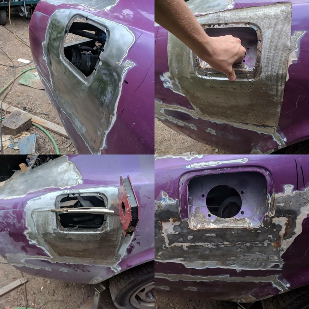

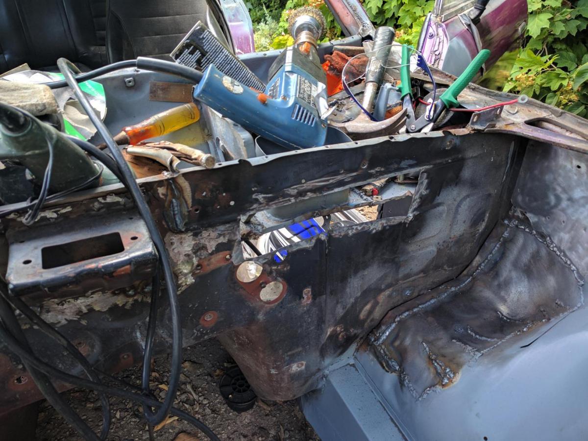

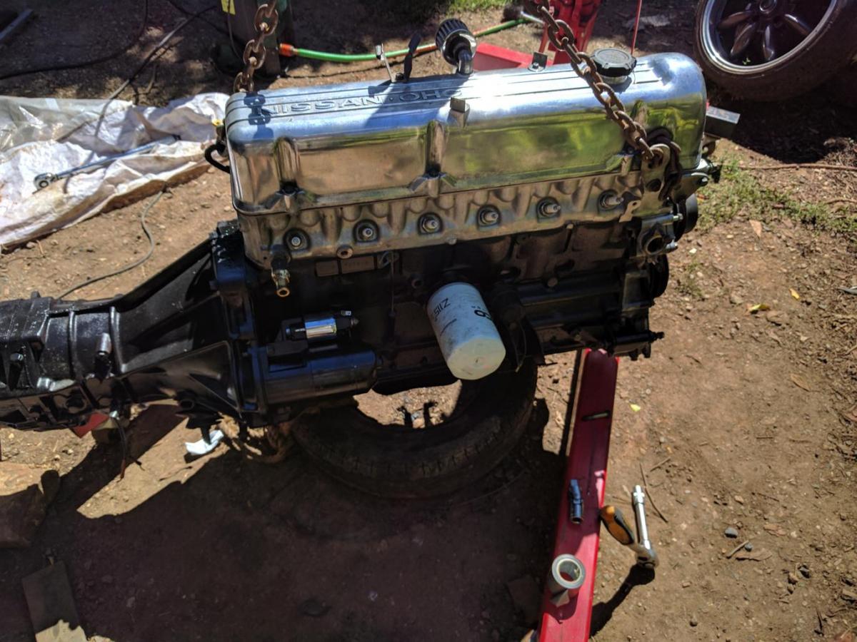

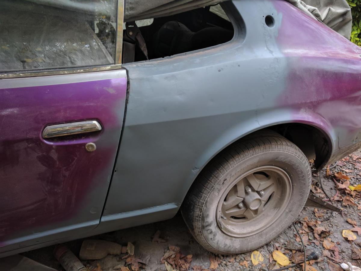

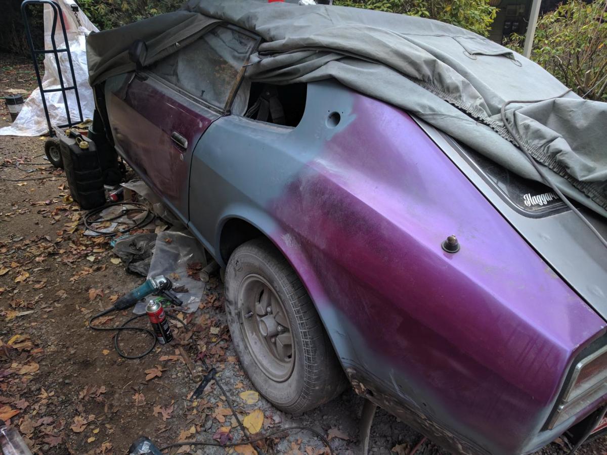

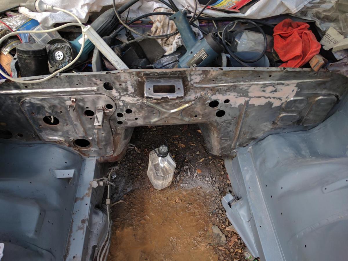

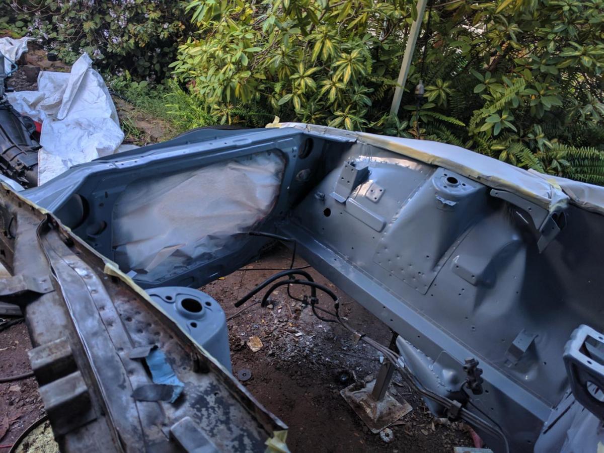

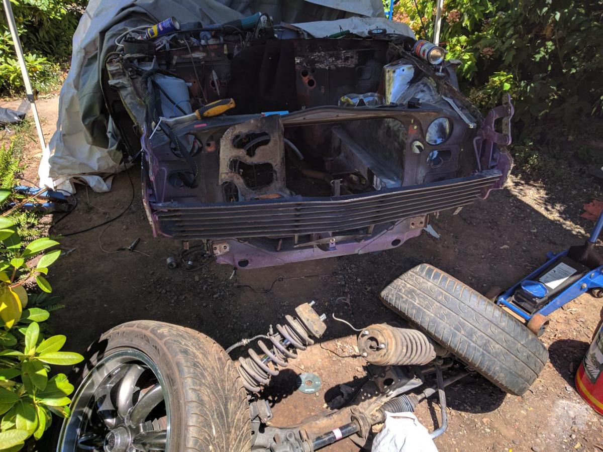

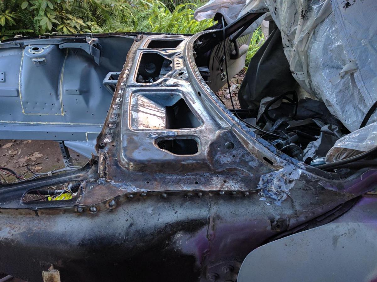

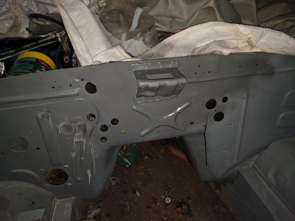

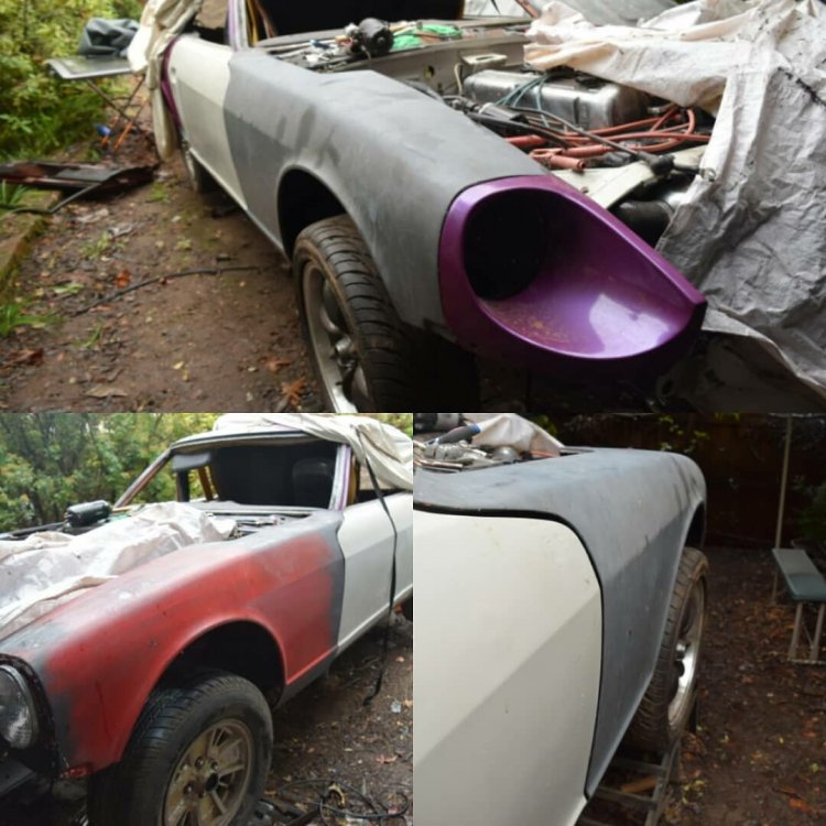

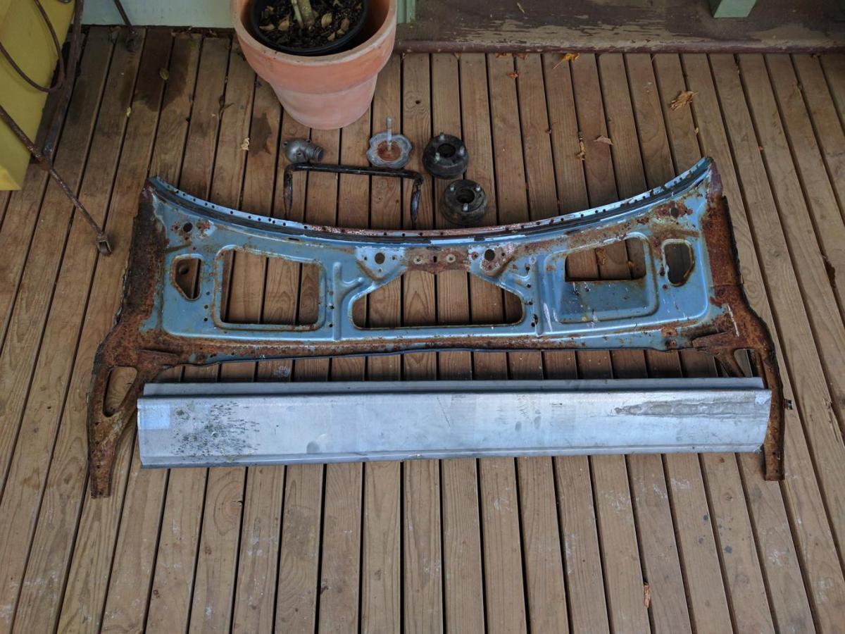

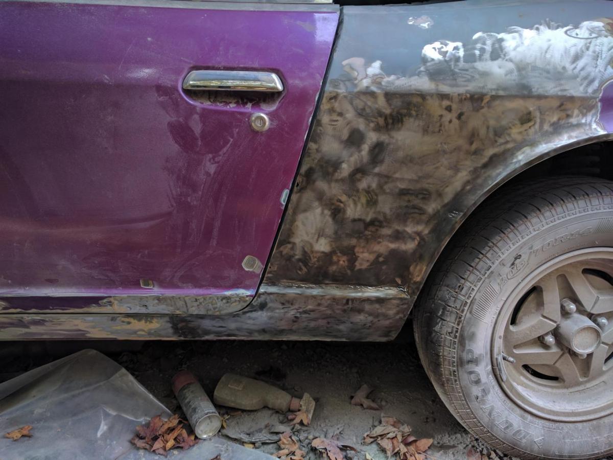

Got my LH fender off, the dogleg looks to be in goodish shape with just some surface rust and rust juices from the fender. The fender is a different story, a section has been cut out previously and they've done a pretty good job, not fantastic but it's not really worth re-doing. They didn't treat the panel correctly so the rust has come back and I'm going to need to cut out a small section and weld in some fresh new metal. I also managed to make a new section for the frame which will be getting put in properly when I take the motor out some time this week. Much much better then the last repair that I did. I was able to use my schools workshop which allowed me access to some great hardware and tools.

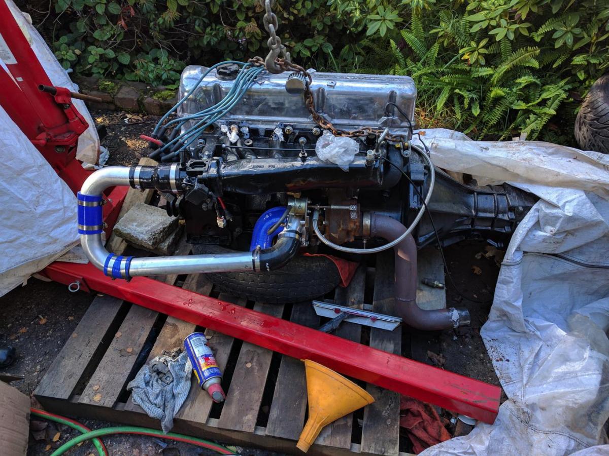

Just starting to pull things out of the engine bay so that I can get the motor out, do my repairs and paint it.
I am starting to lean towards the Bayside Blue colour however I'm still keeping 362 Purple in mind. I'm also wondering if anyone has any nice looking engine bays in black, do they look good in a different colour to the body or is it better to keep it all the same?

Nice work Andrew.

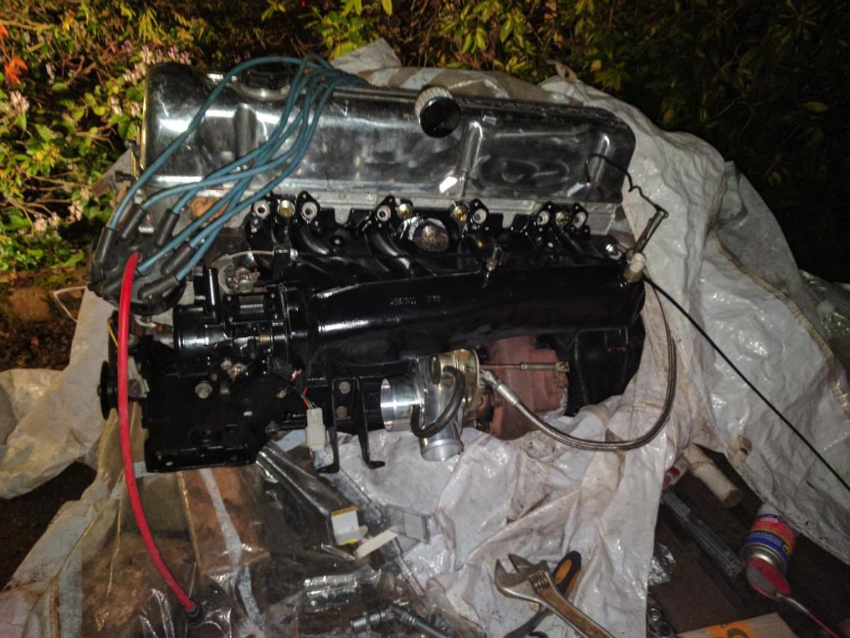

In regards to engine bay colour its a personal choice. The black engine bay really emphasizes the engine, and therefore the engine must look neat and clean !! I asked the same question in my build thread and got a few pictures for an example.
Here is some old pics of mine, I am still tidying up cables and hoses etc

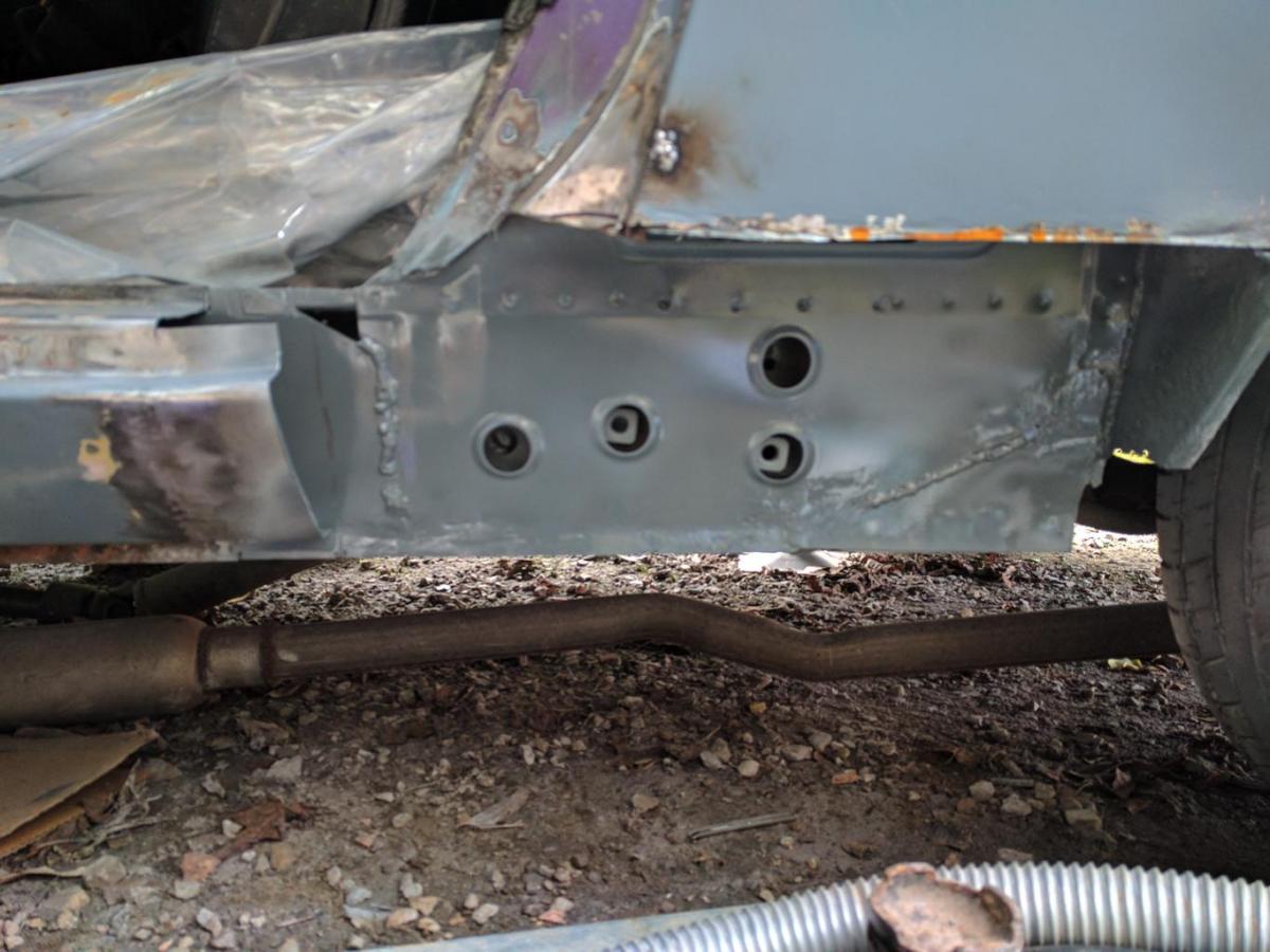

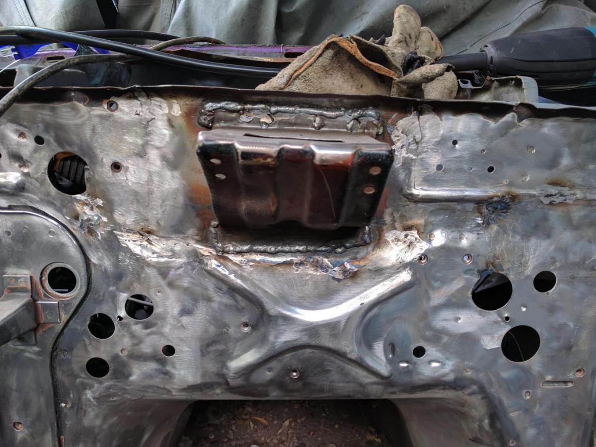

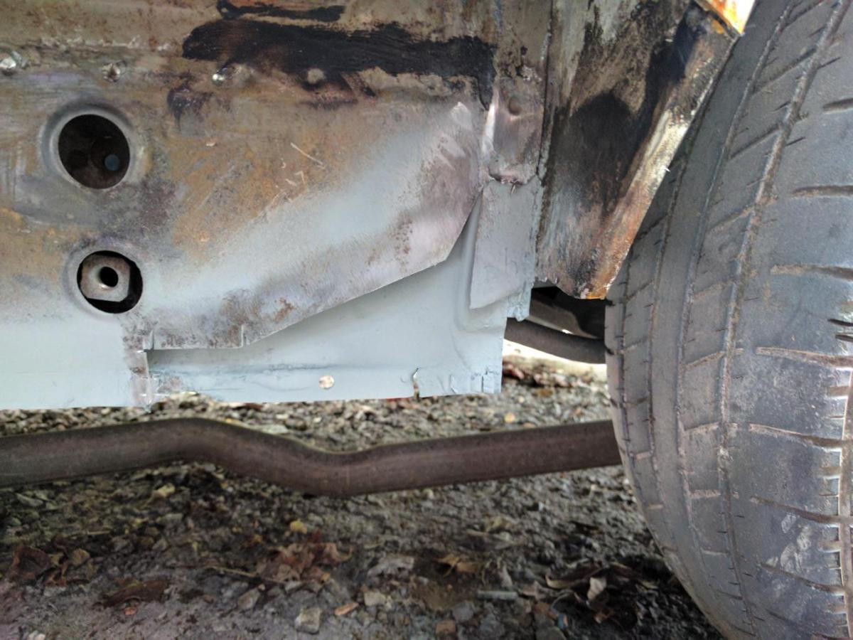

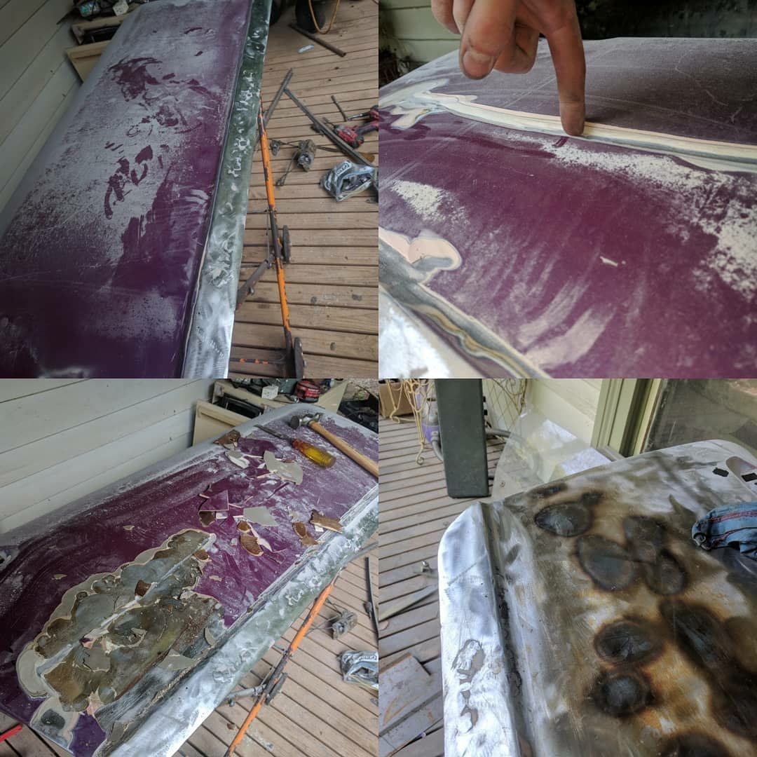

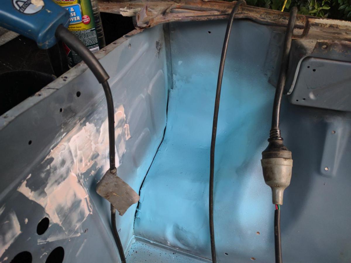

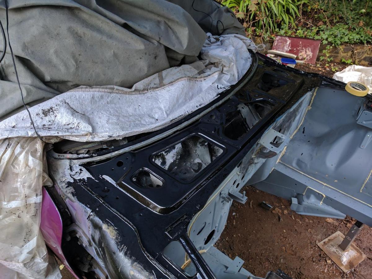

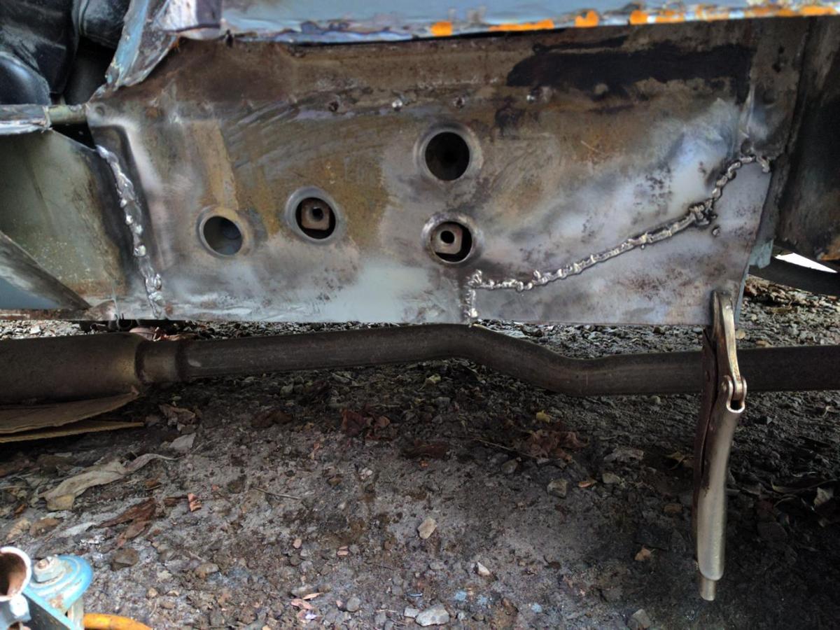

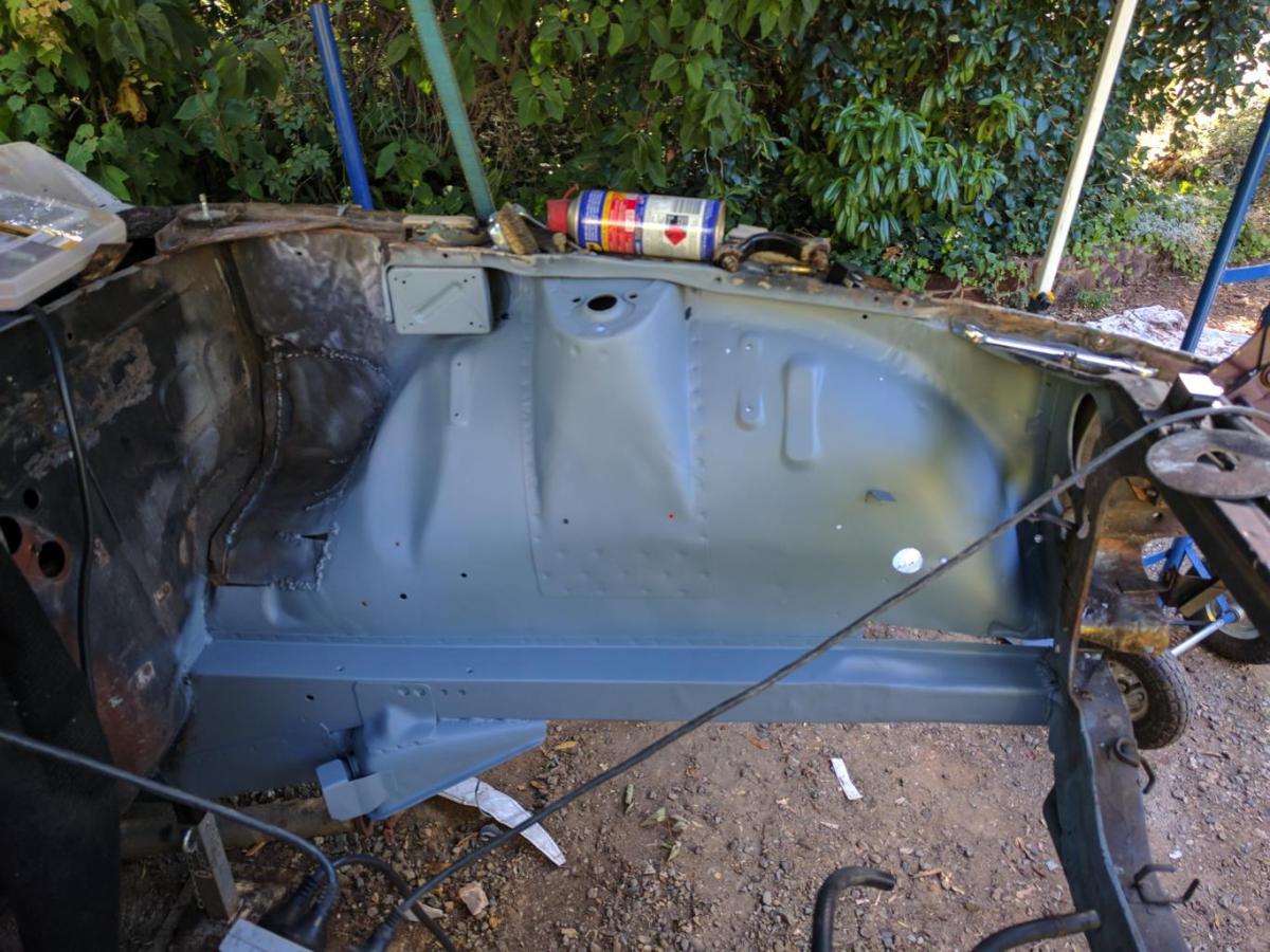

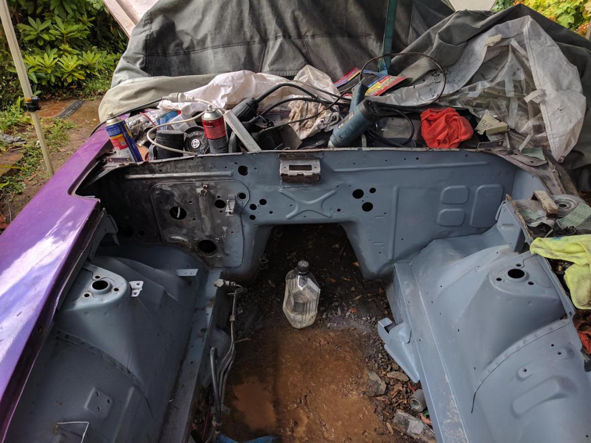

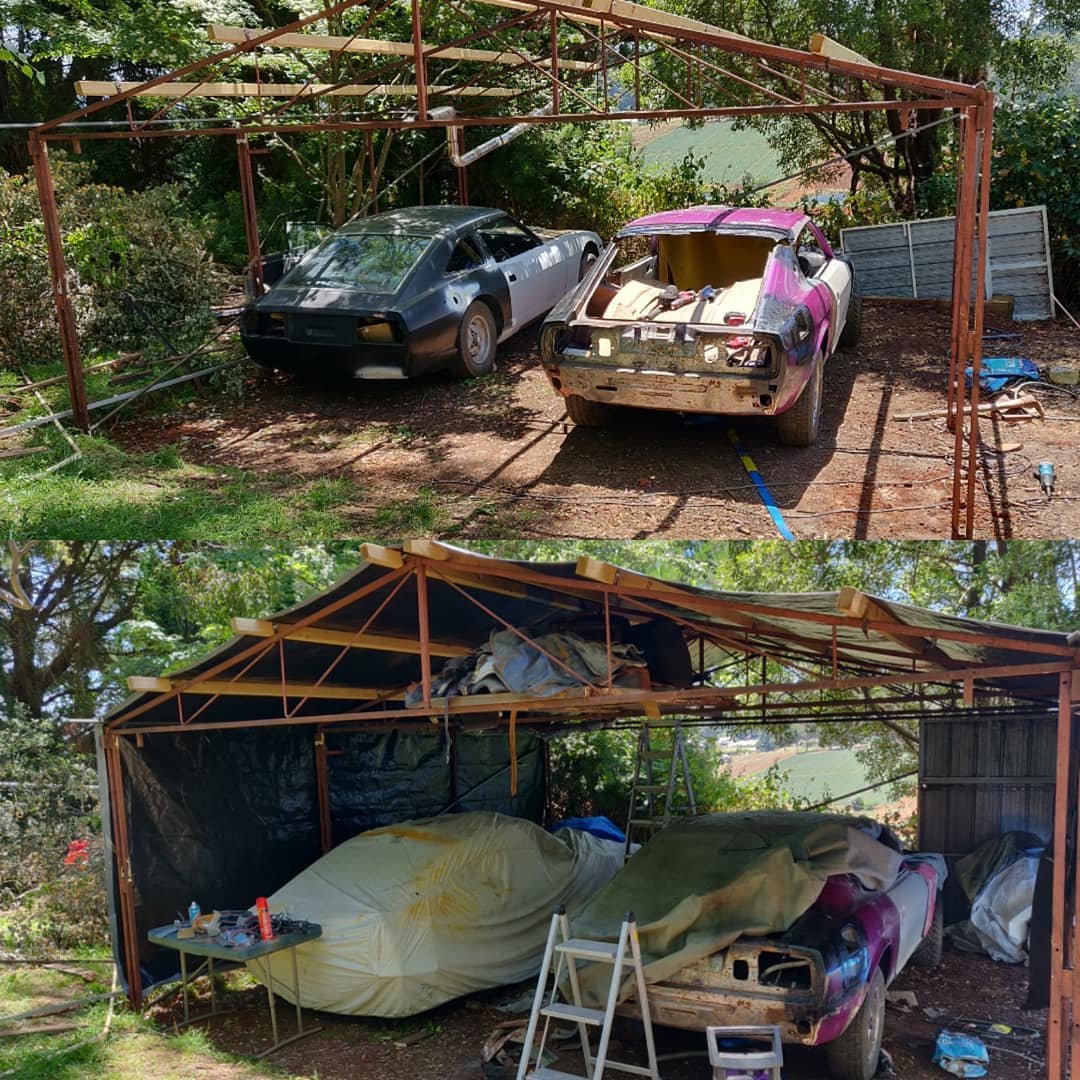

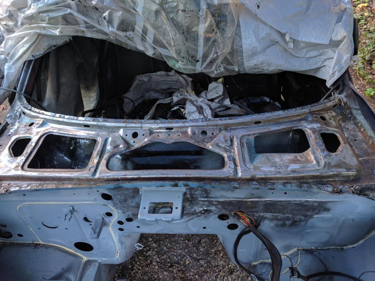

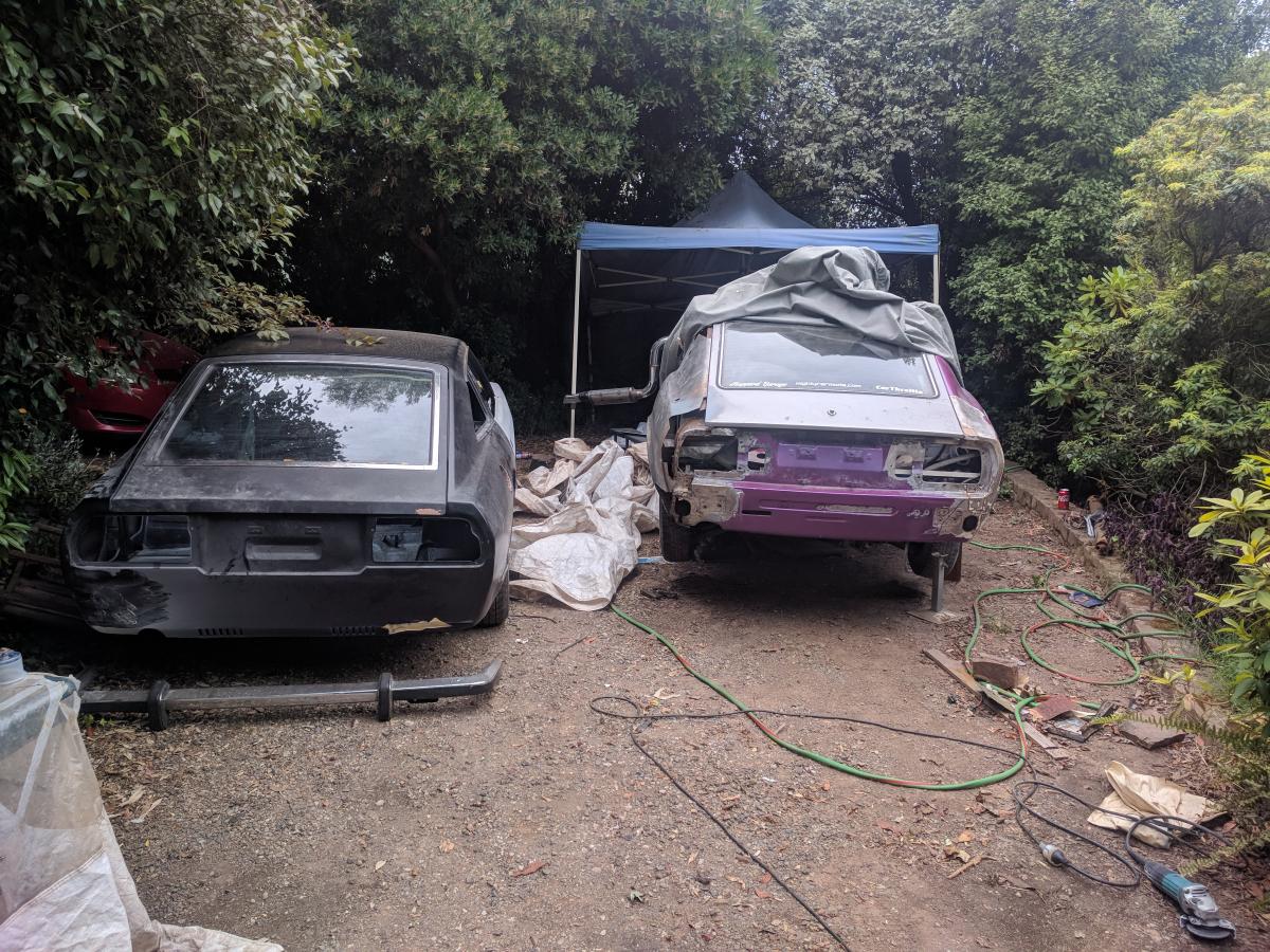

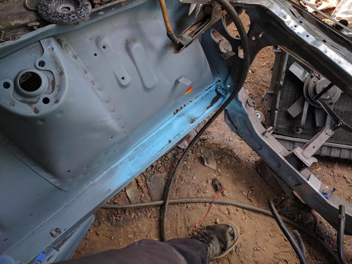

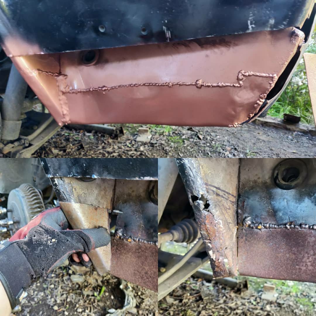

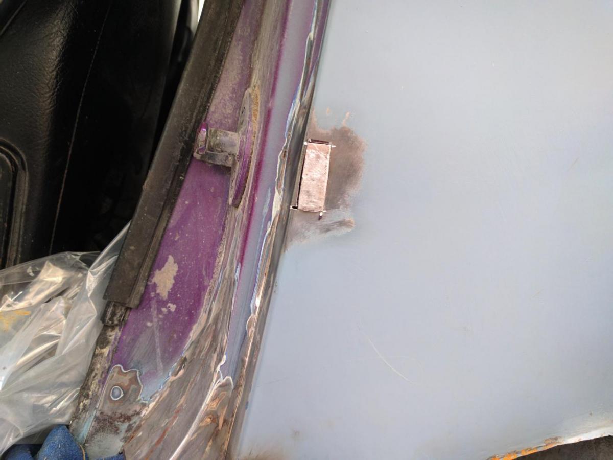

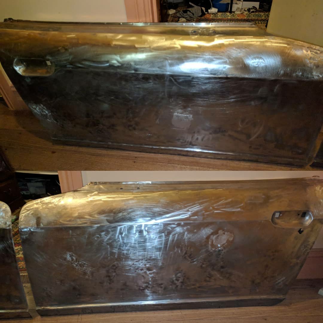

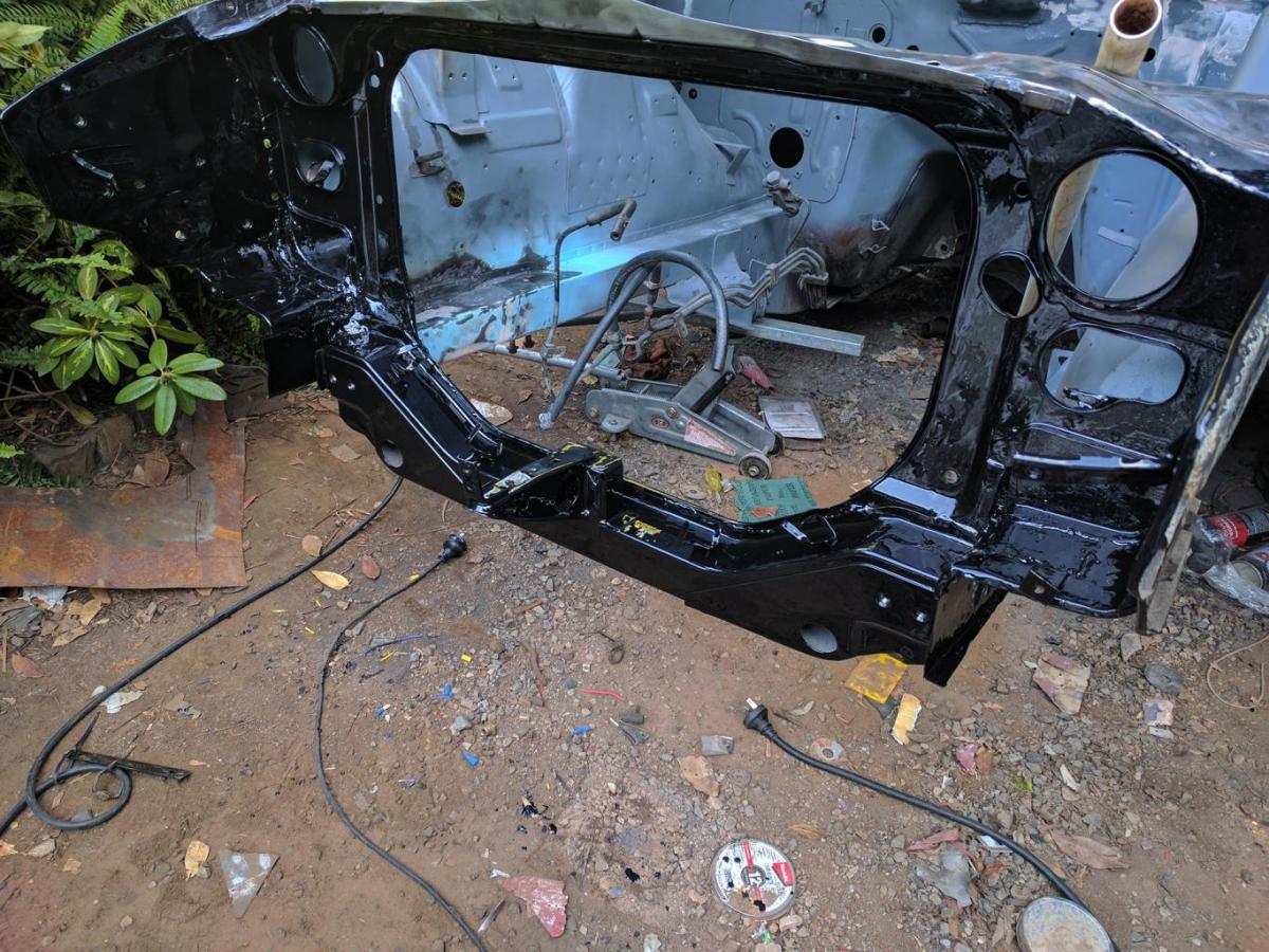

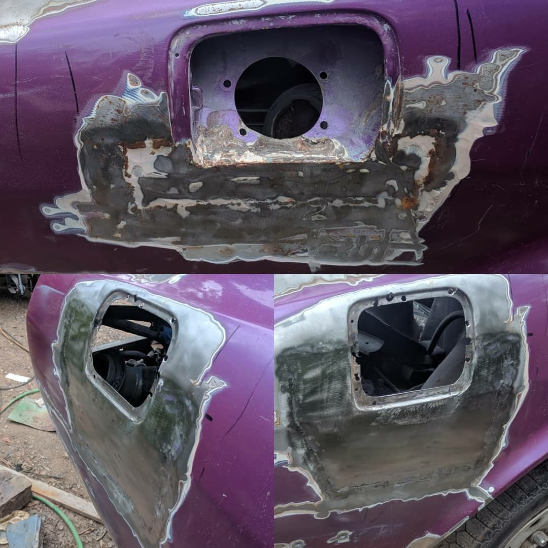

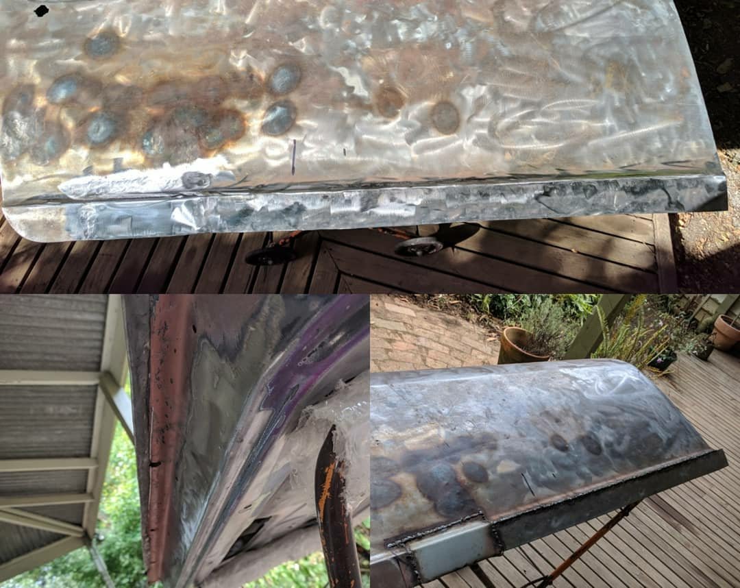

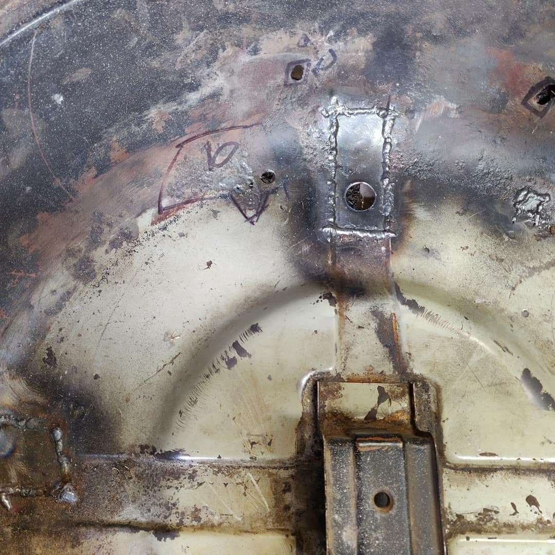

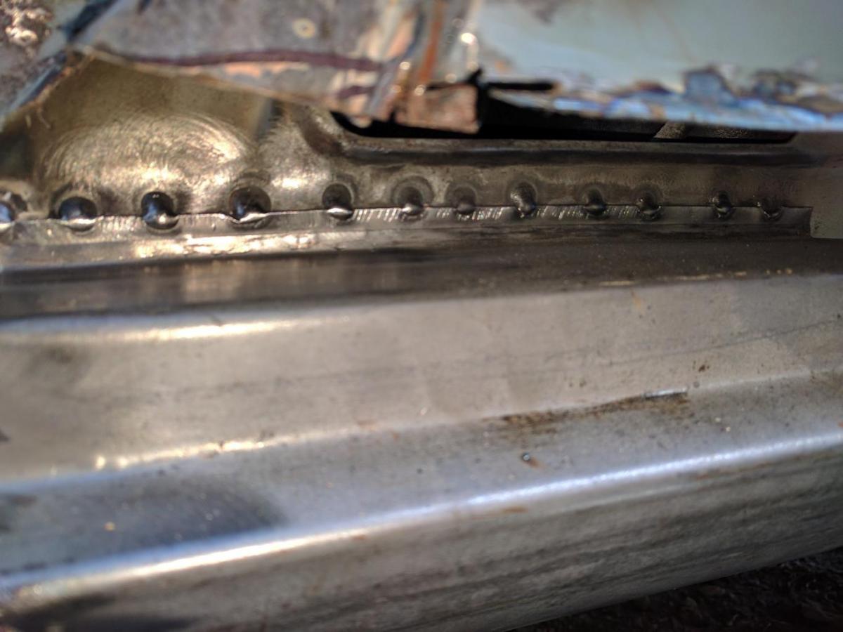

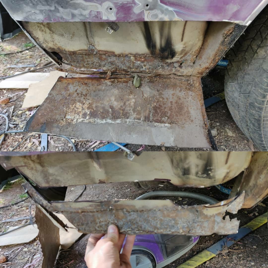

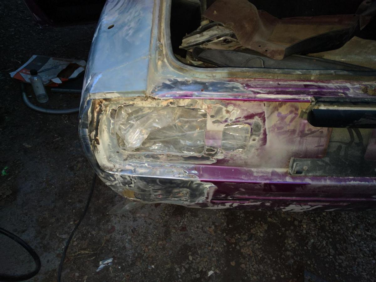

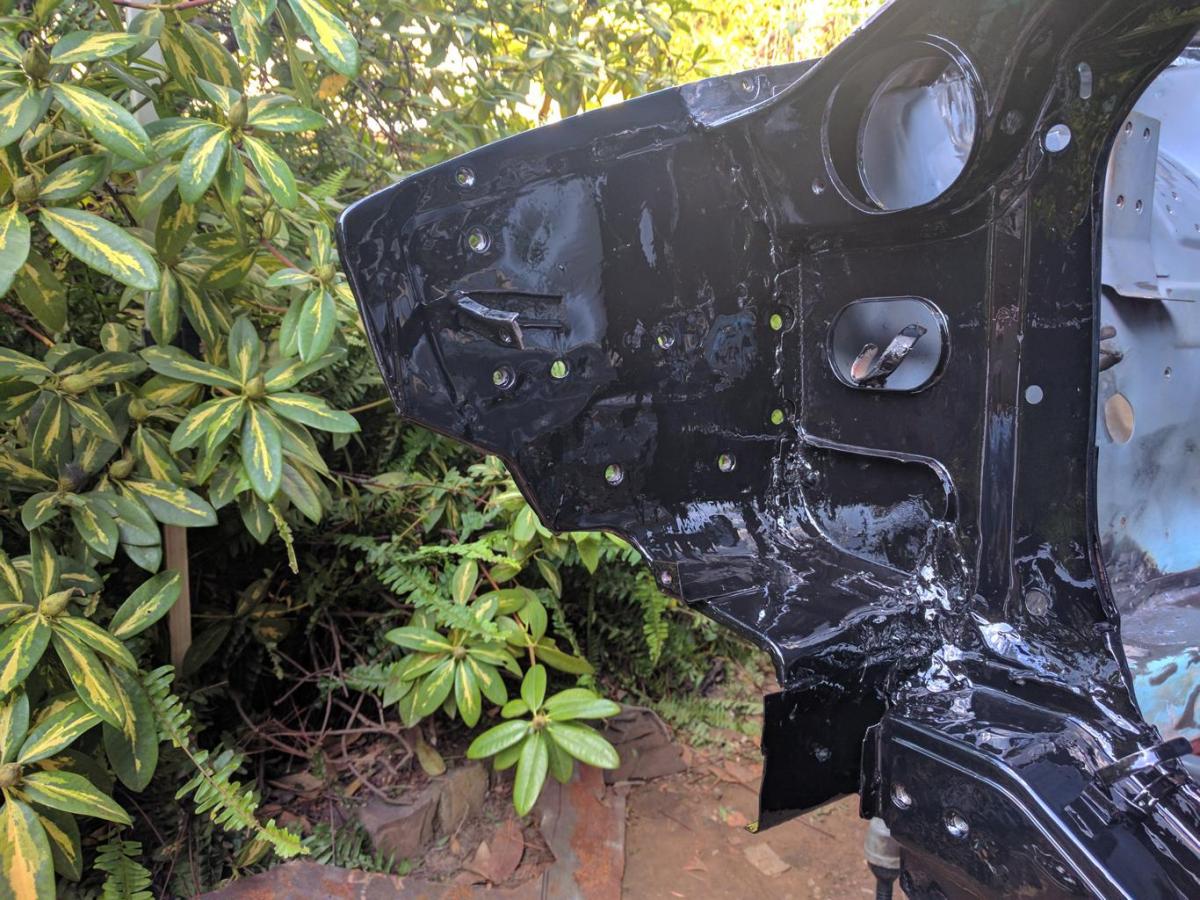

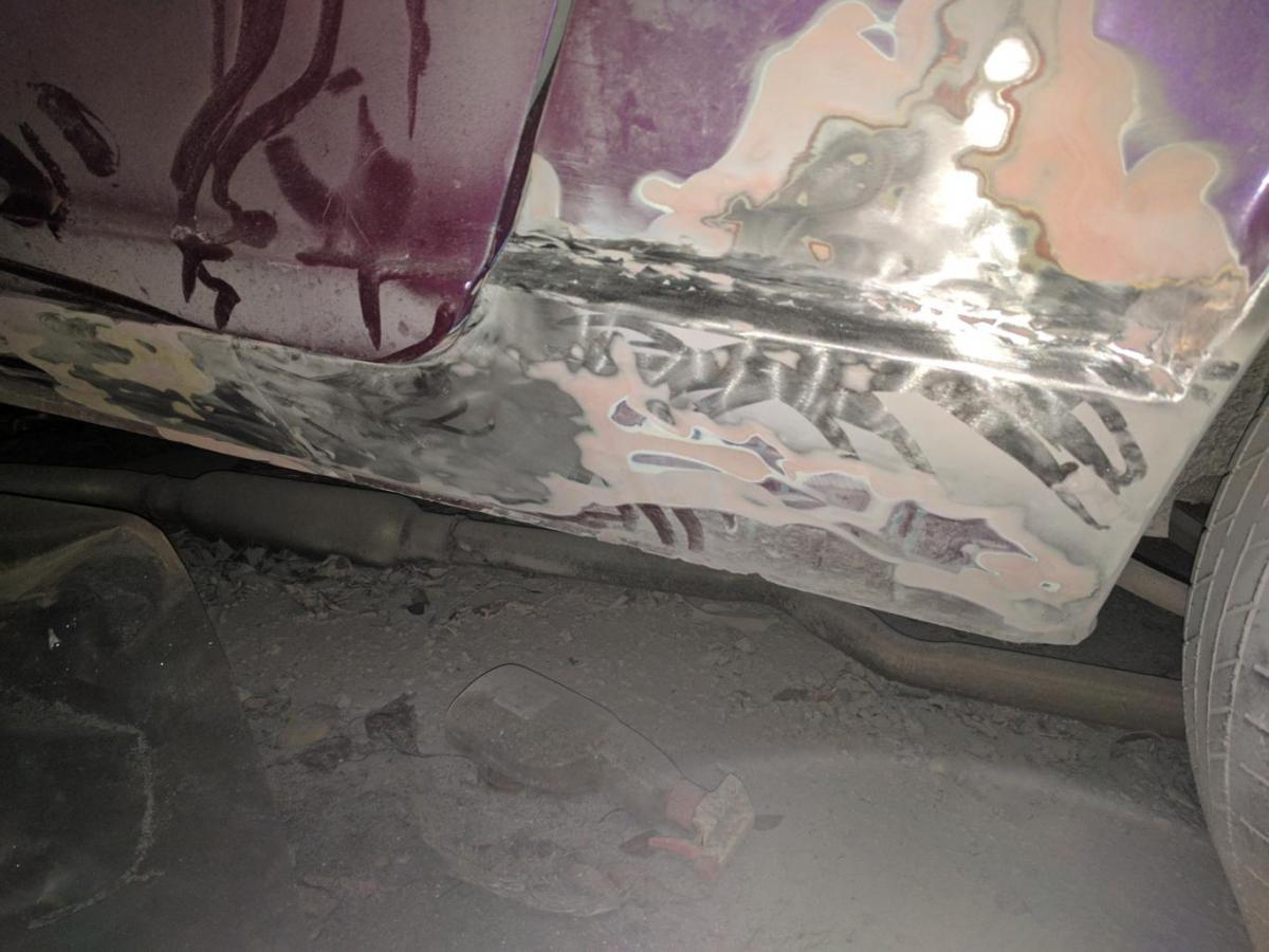

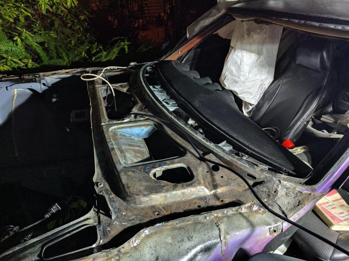

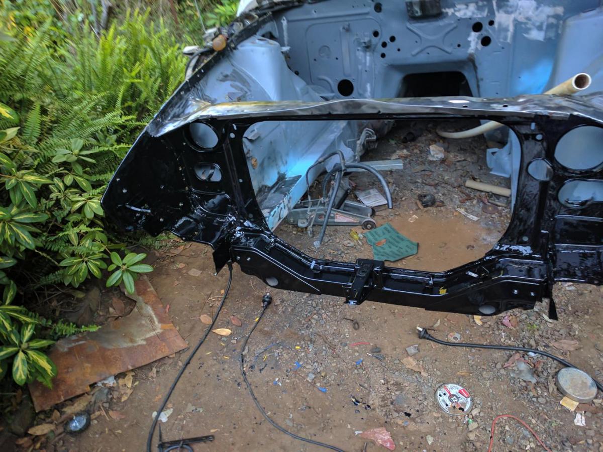

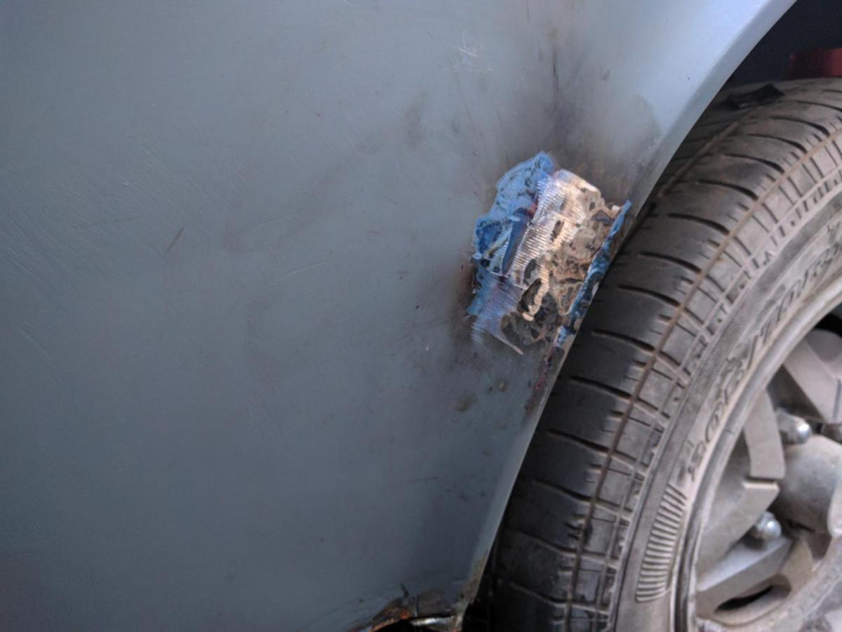

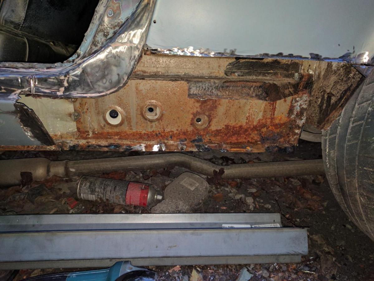

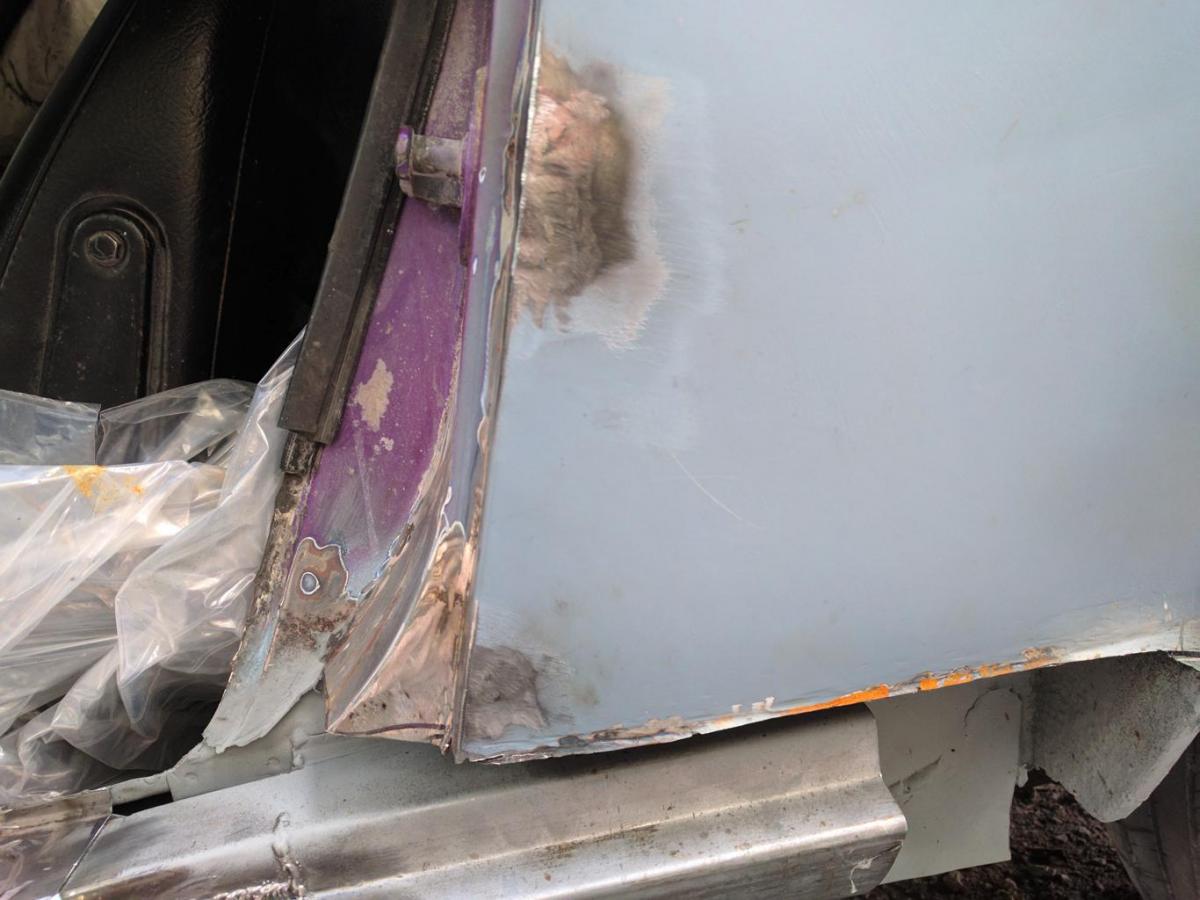

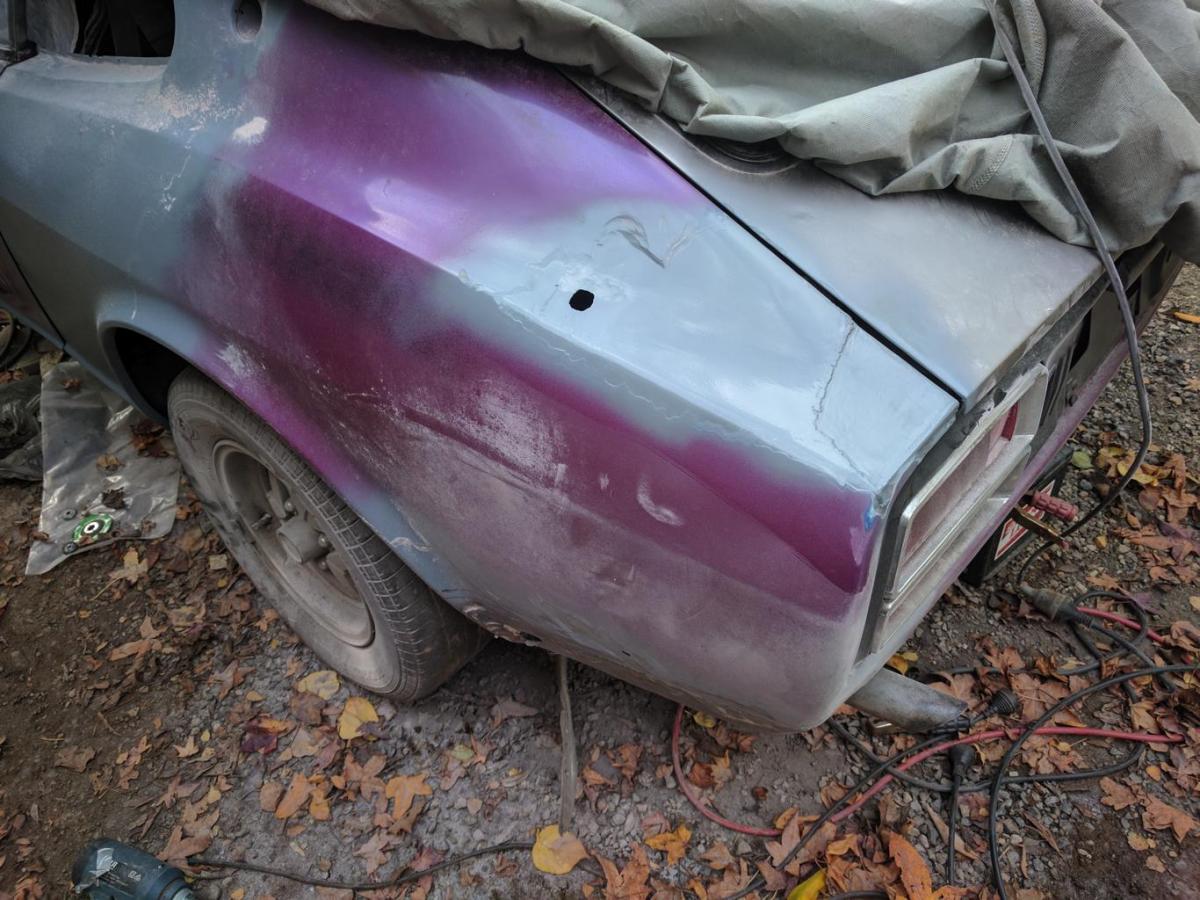

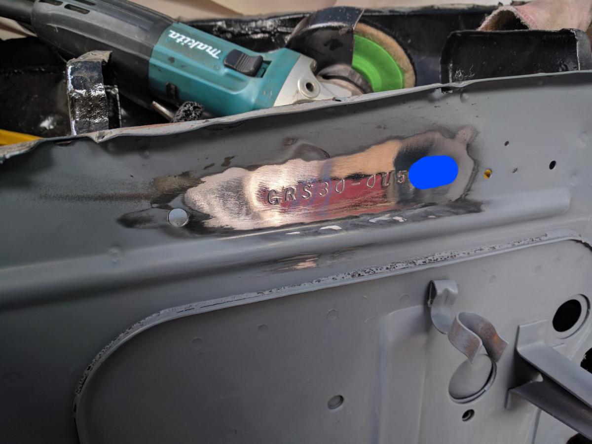

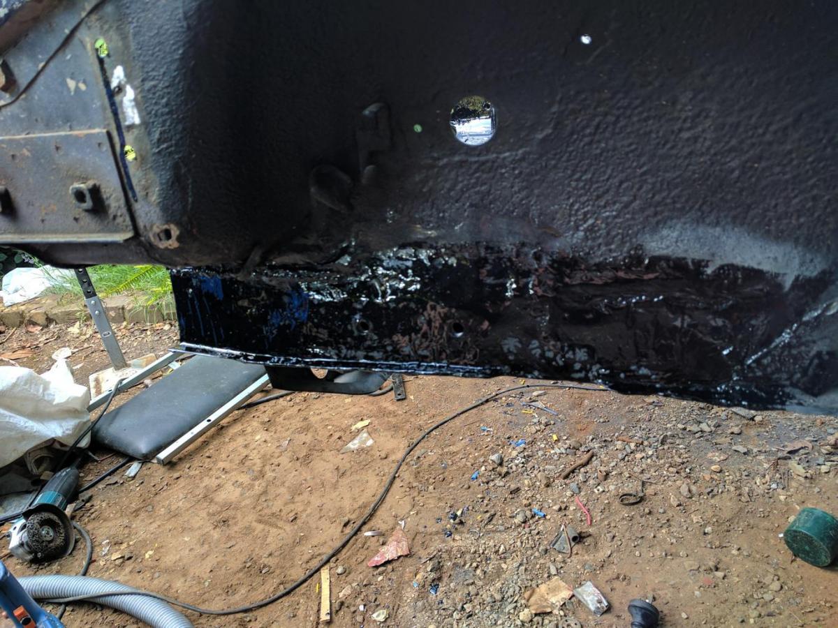

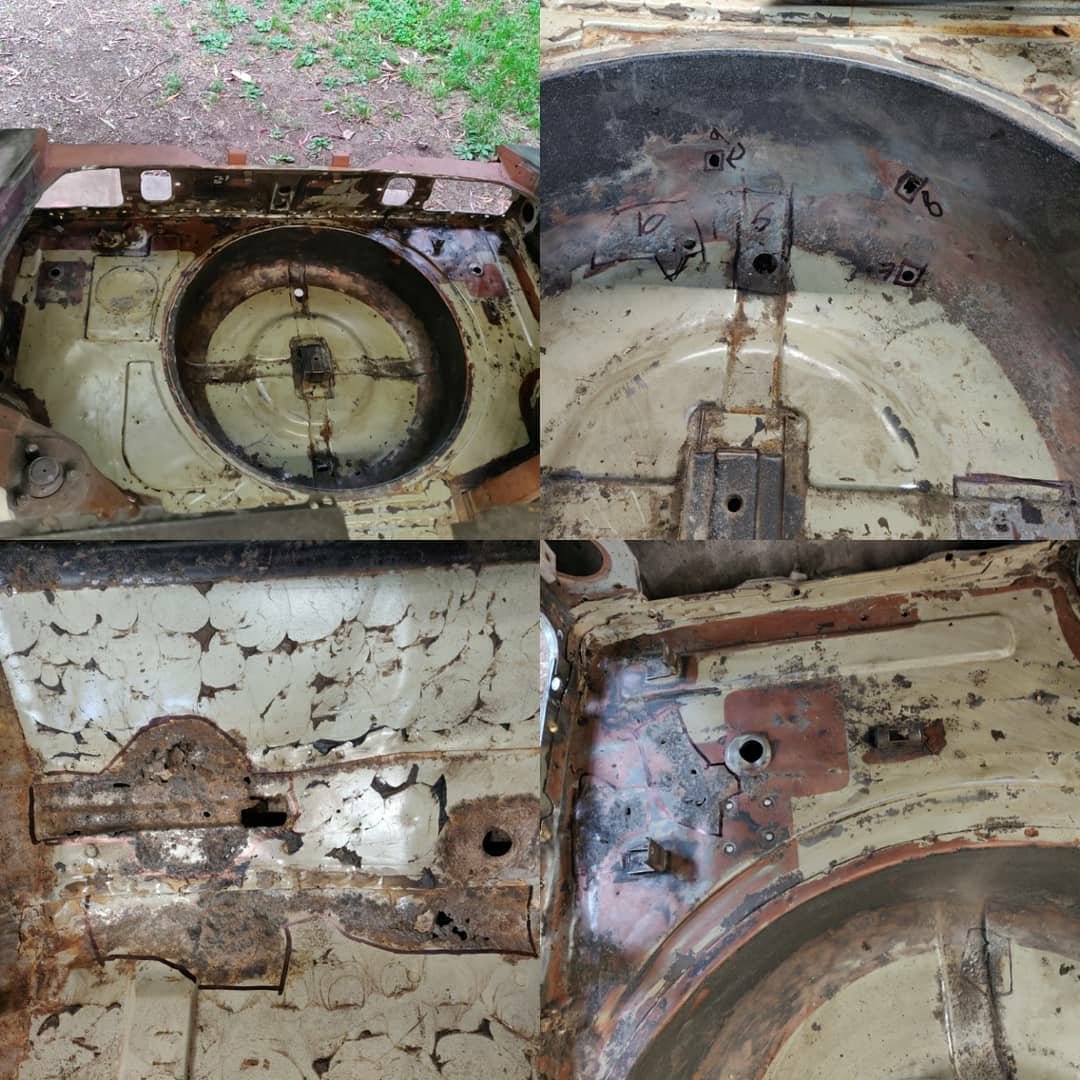

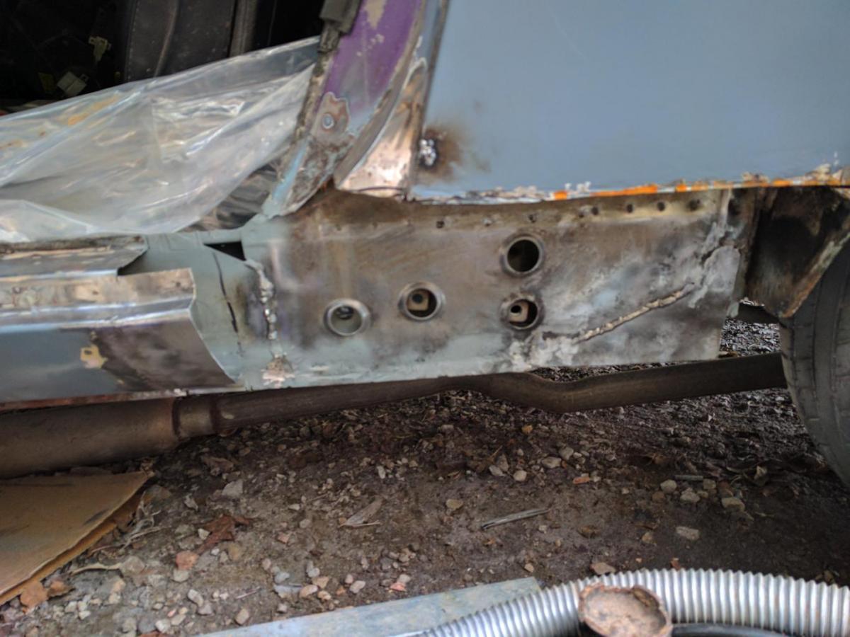

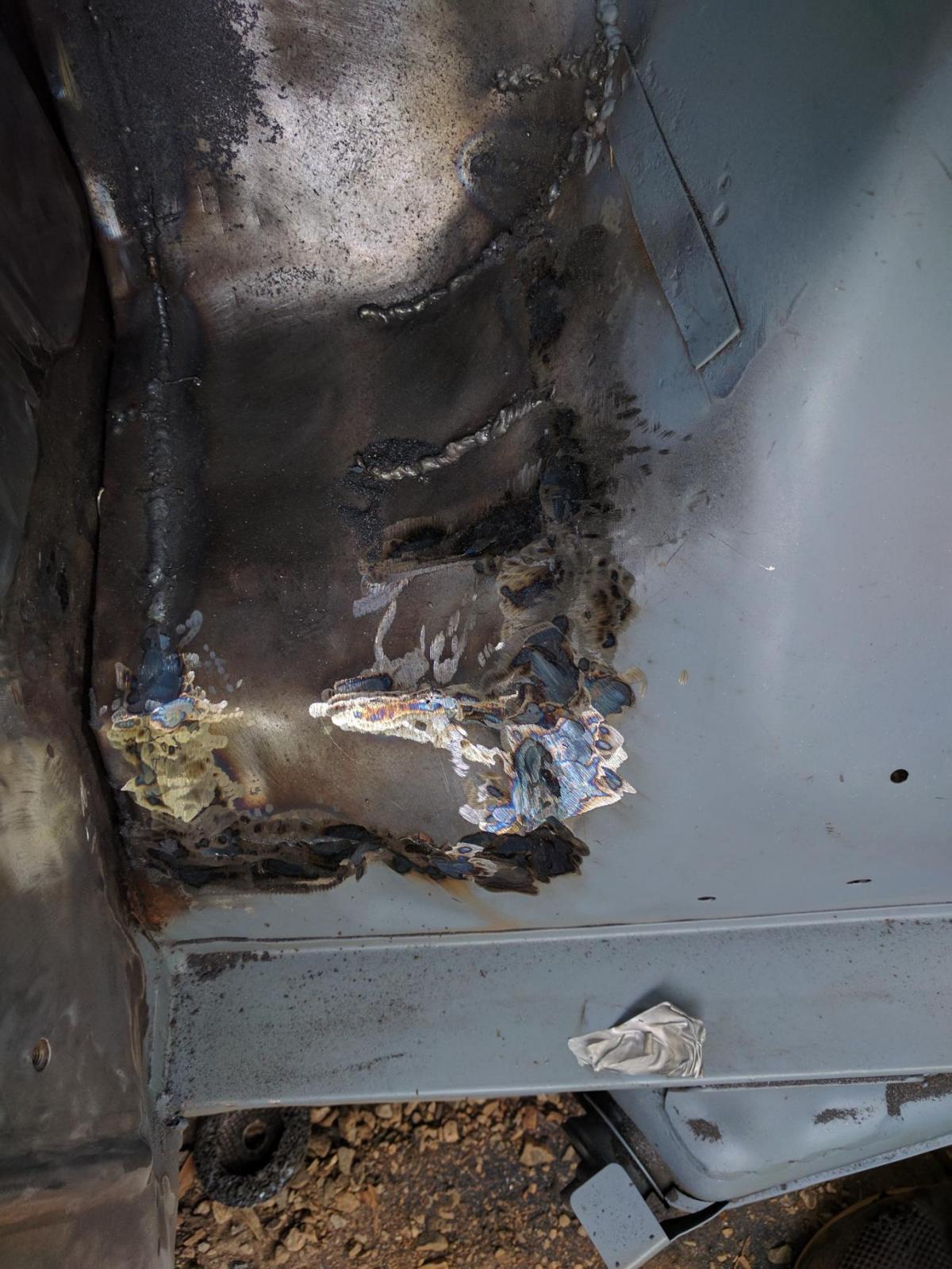

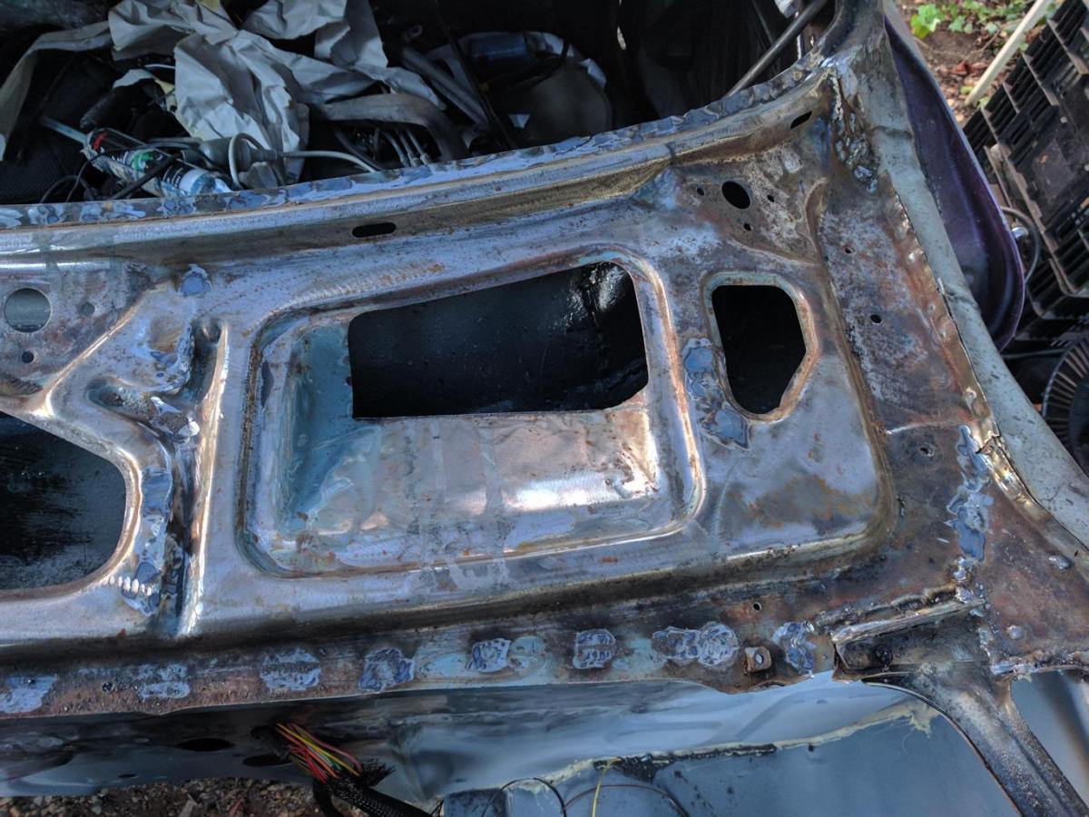

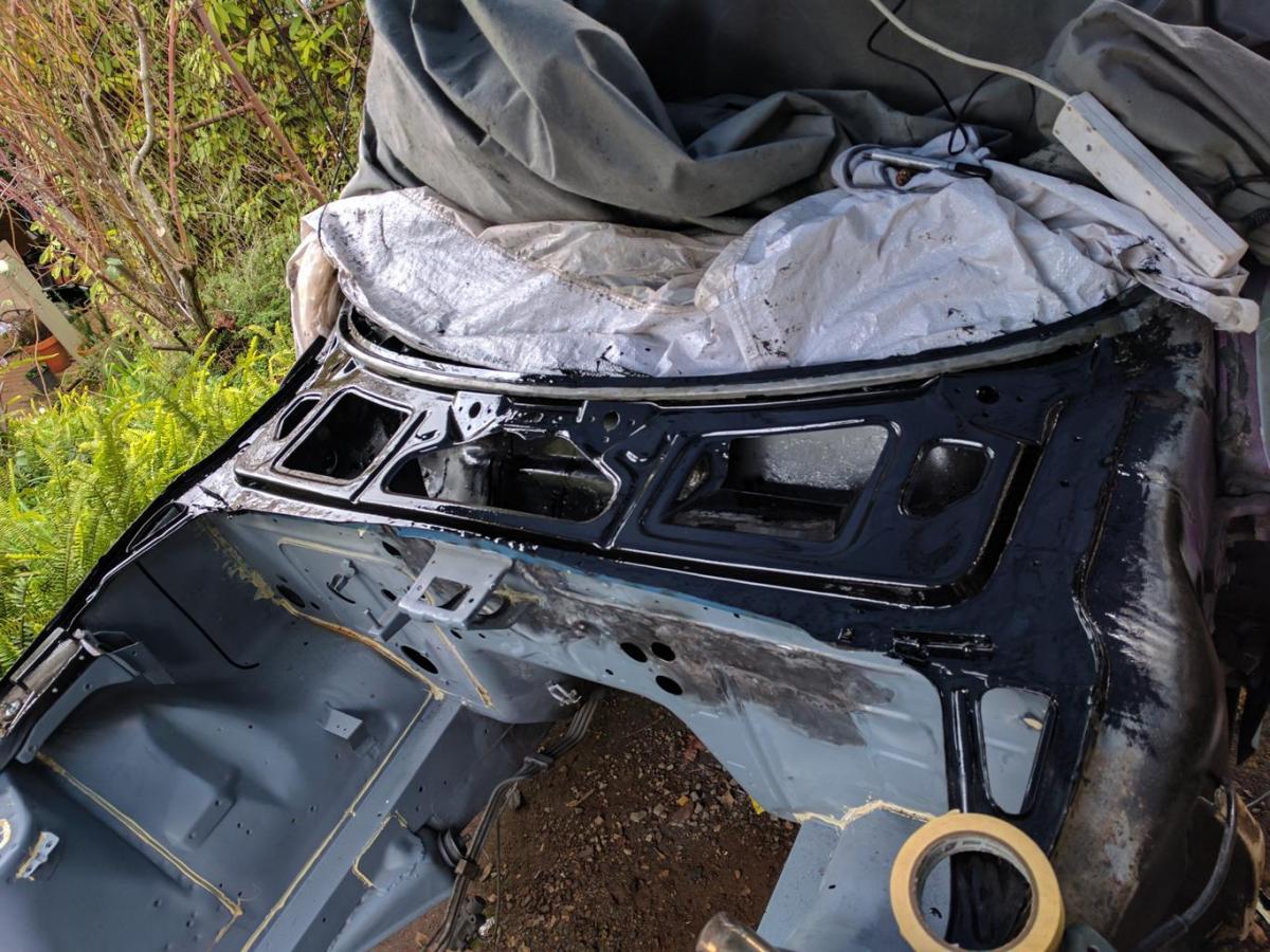

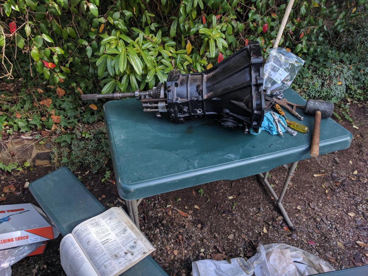

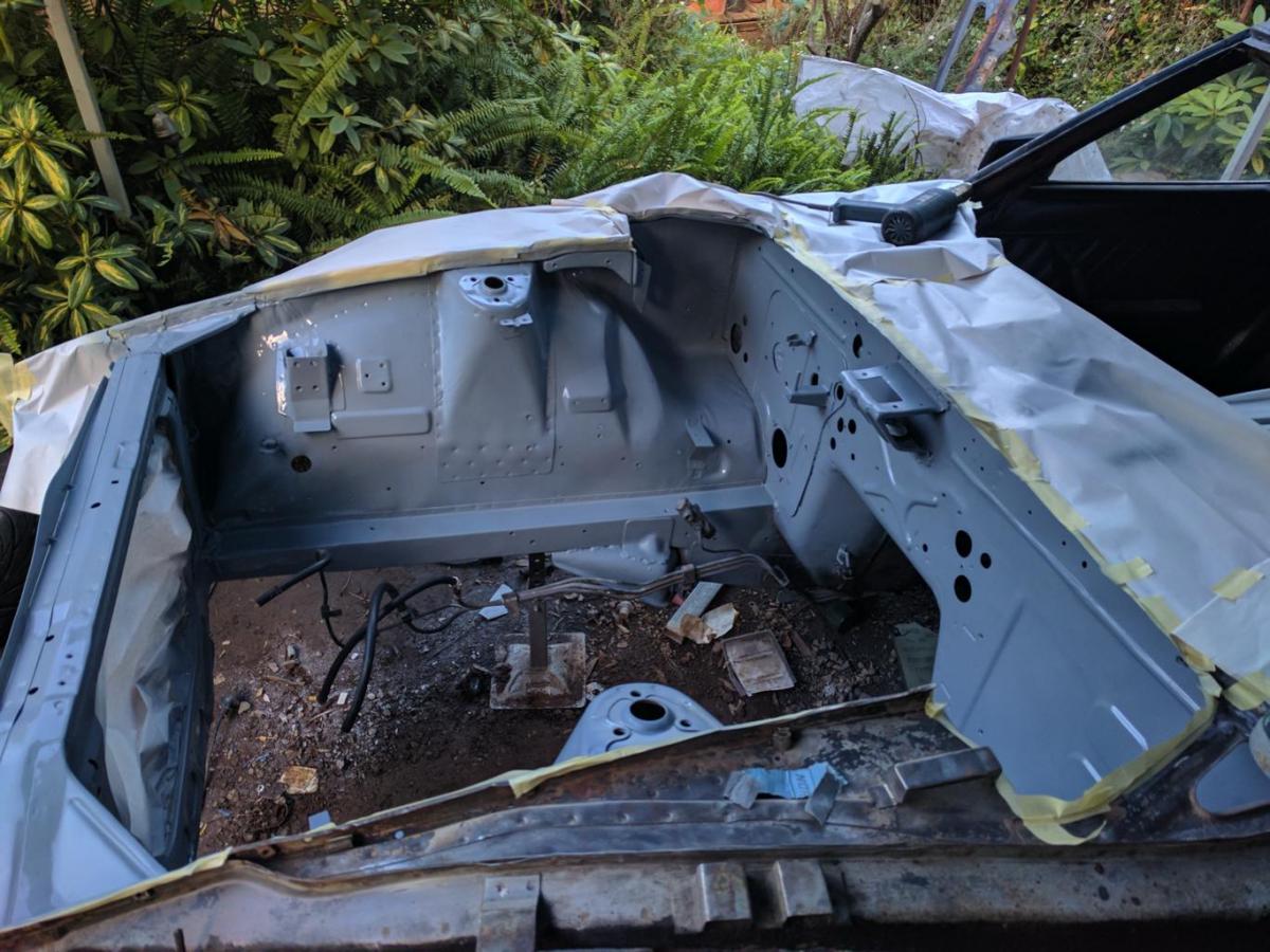

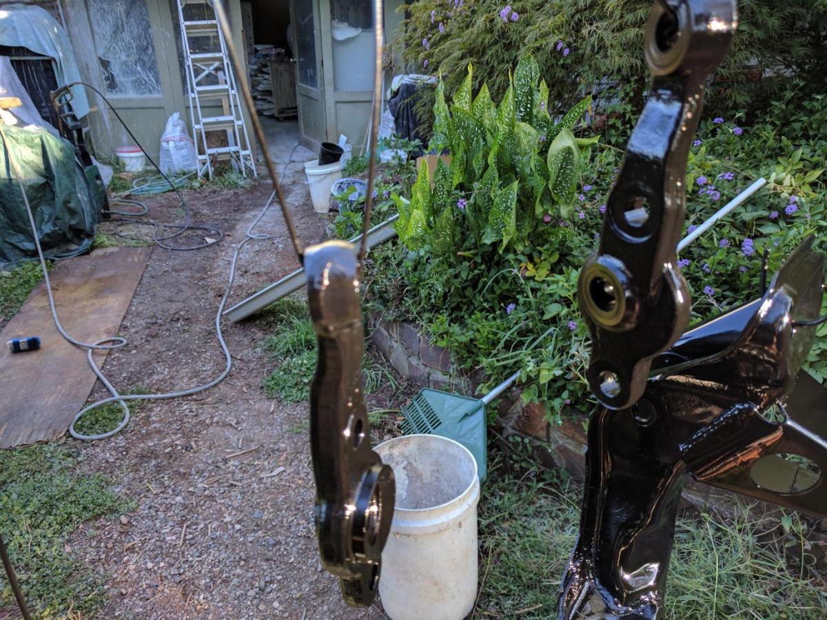

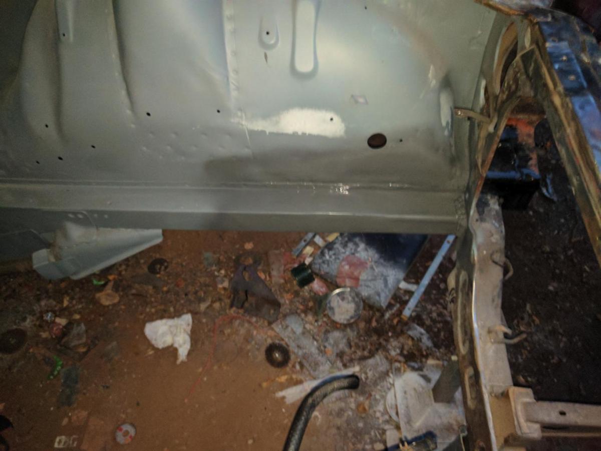

Last few weeks I've got a little bit done, found a bit more rust and decided to actually solve the problem properly (which Locky will hopefully love) and I purchased a second hand Cigweld Transmig 175i with a Gas bottle and regulators etc.

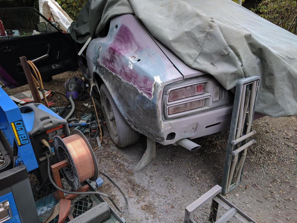

I also purchased my spraybooth/ working area which I can thank Jeff for!

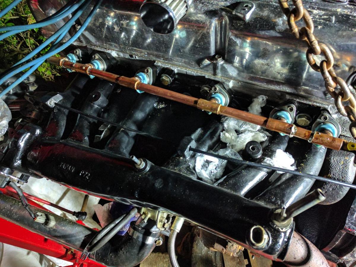

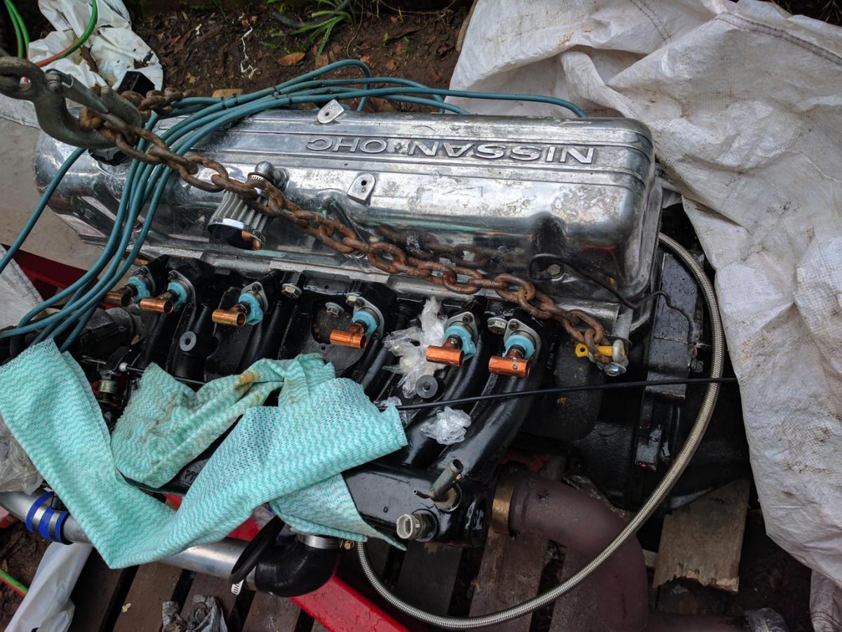

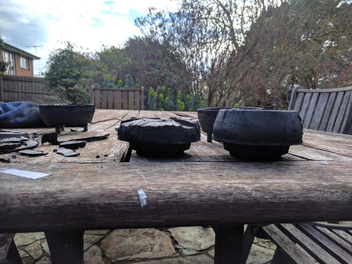

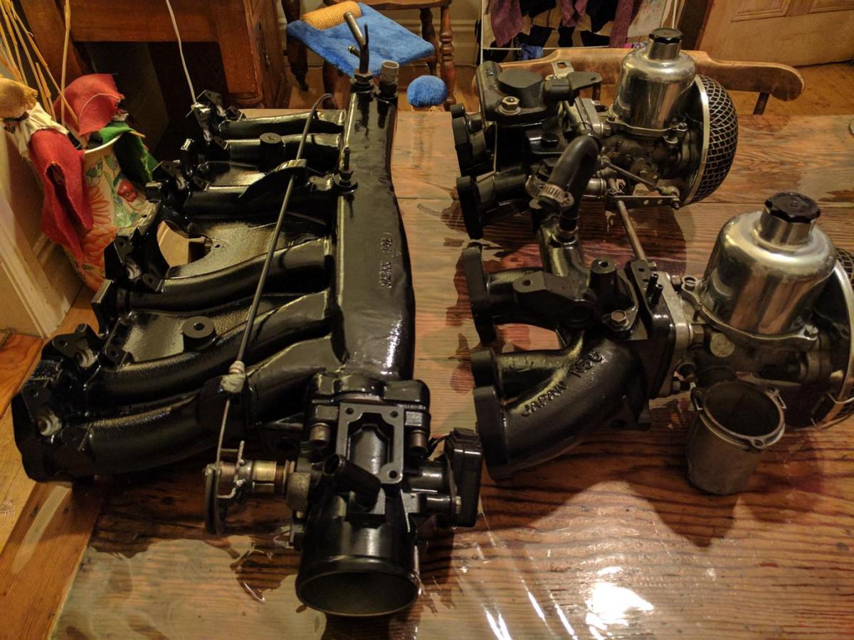

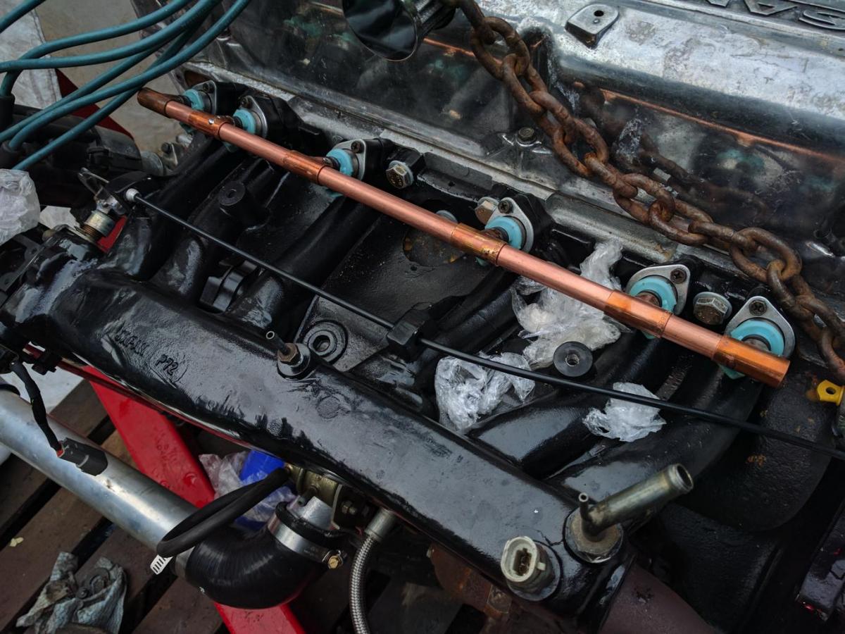

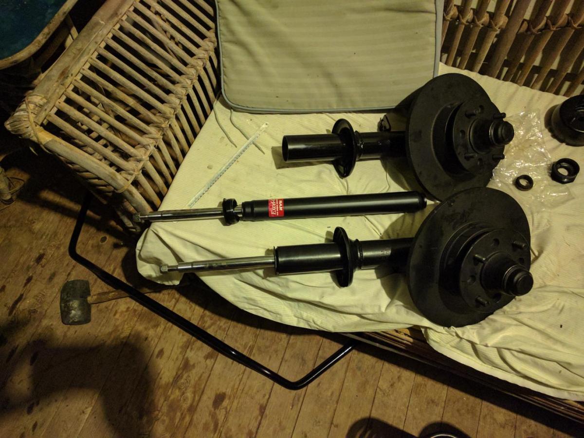

Polished my Twin British SU domes and Rocker cover which looks fantastic (Just something small to do at school during lunchtime)

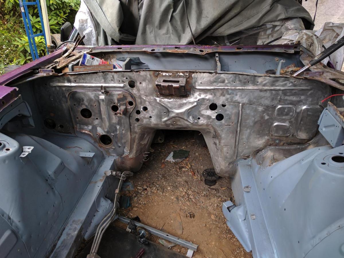

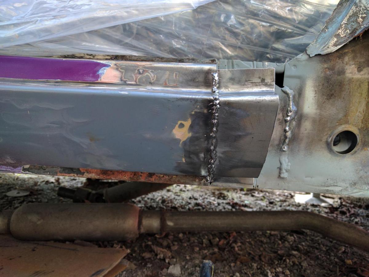

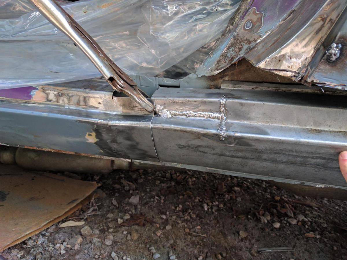

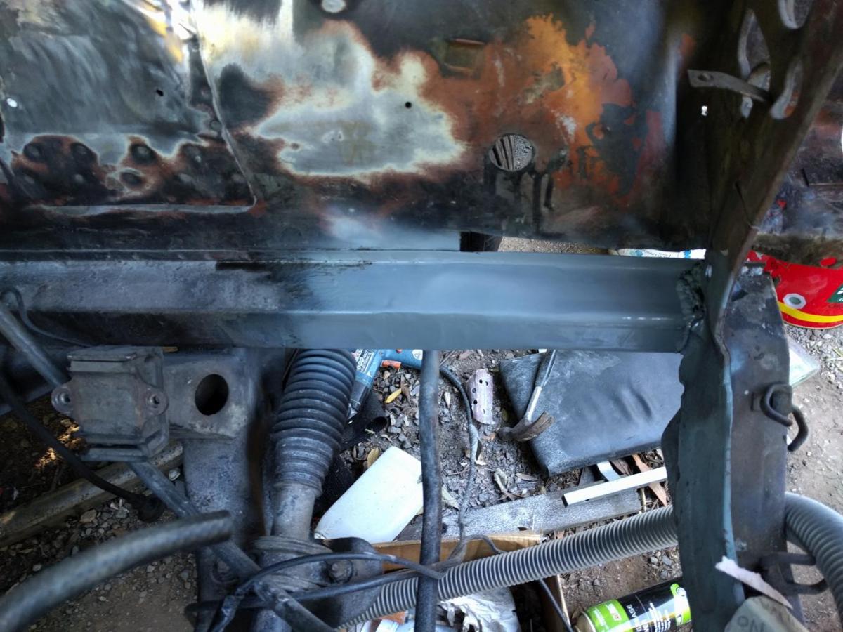

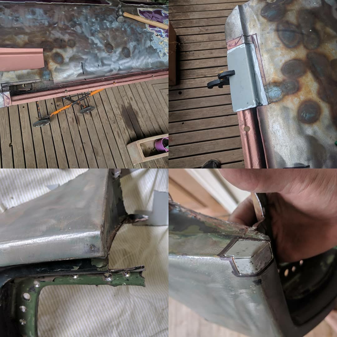

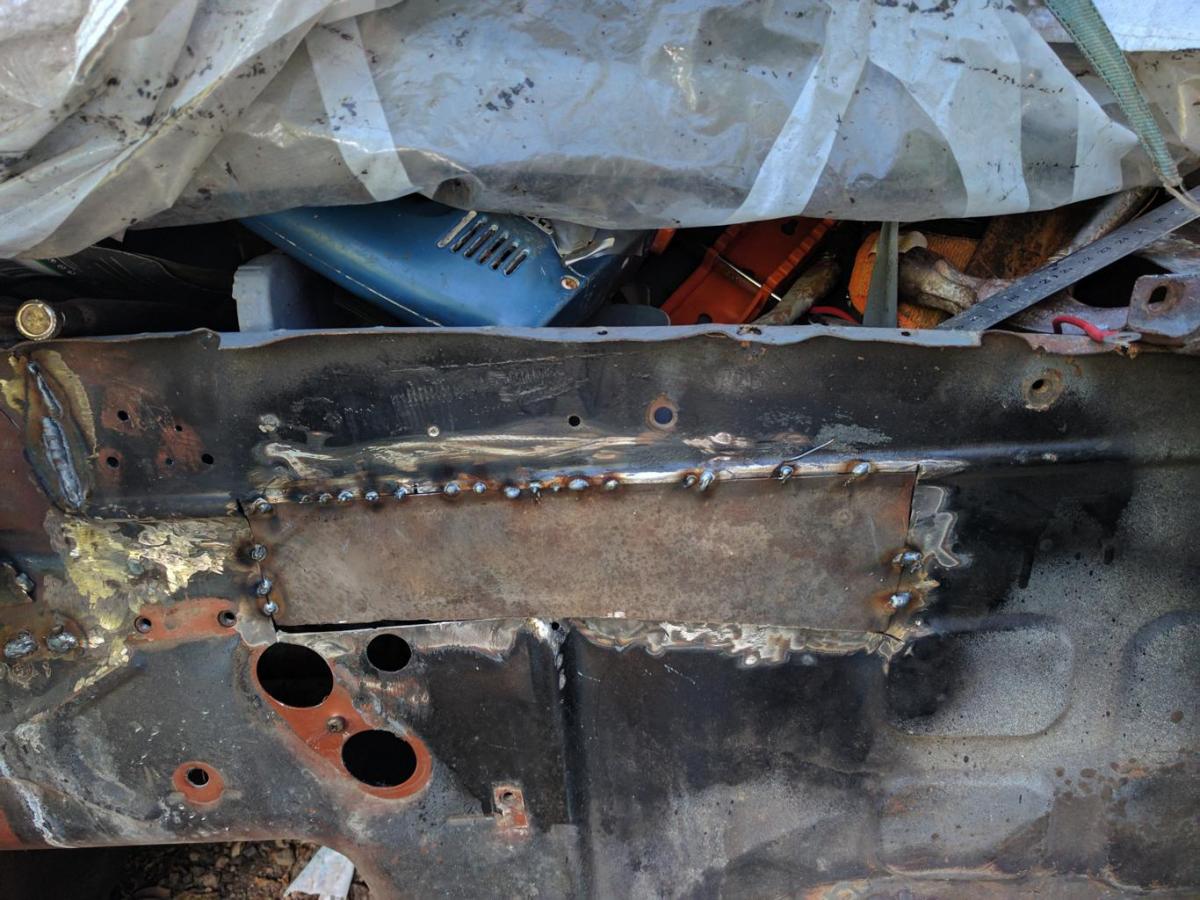

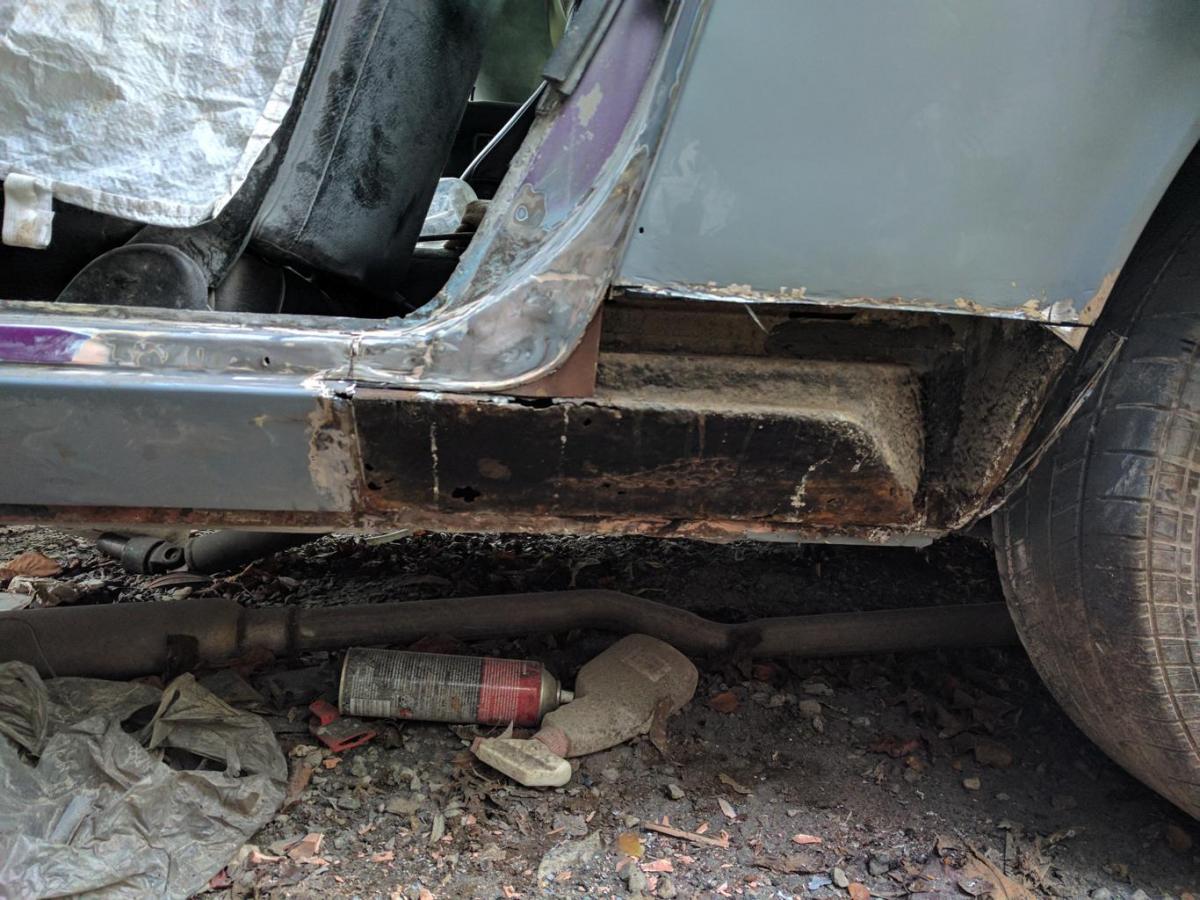

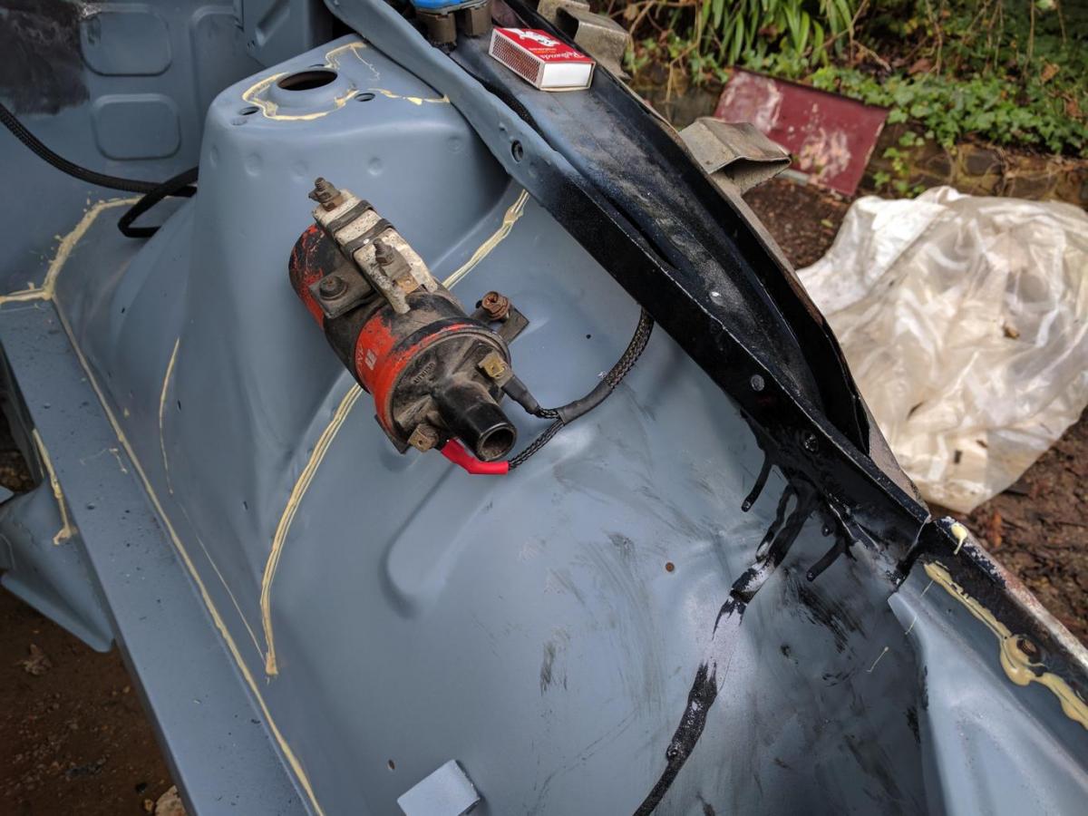

Also cut a little rust out of the sill and put a borescope camera down the sills and rest of the car to find the extent of the rust issues. Passenger sill is fine other than what I cut out, drivers side needs to be replaced or repaired to a higher standard as I am not happy with the previous repair (although they got rid of all the rust)

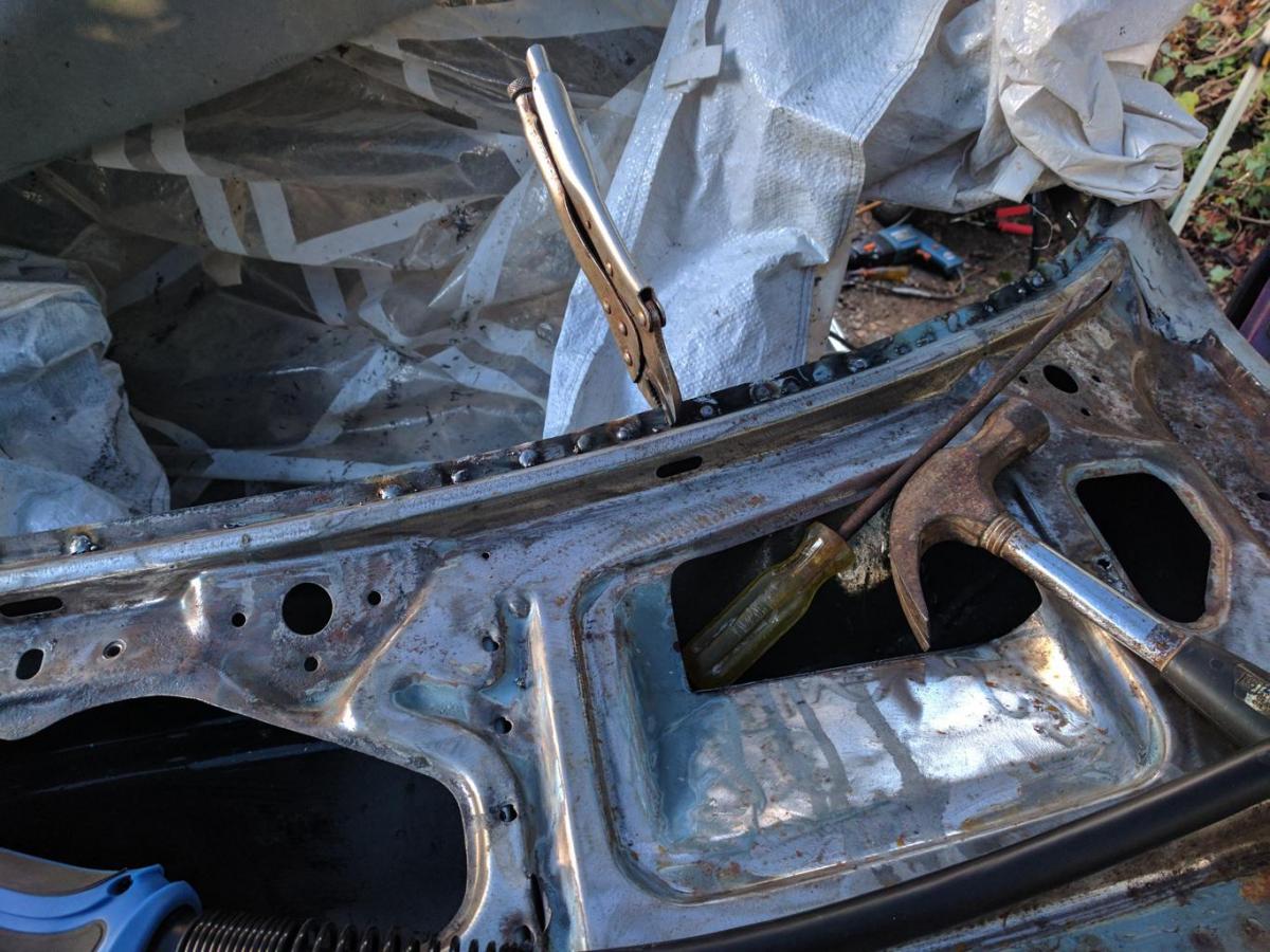

Dash needs to be pulled out as well as the windshield, scuttle panel removed completely repairs done and replaced, the tail light area needs to be repaired (which shouldn't be too hard with a decent welder) I will re-do the rear window repair properly or I might even be able to hammer and dolly it in to an acceptable state.
Also found the terribly done black paint job, makes me think they didn't prep it at all considering the lack of primer and roughing up of the original paint, looks like the paint is coming off at the end of the year!

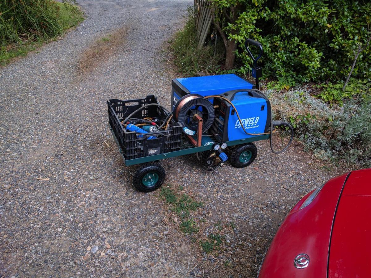

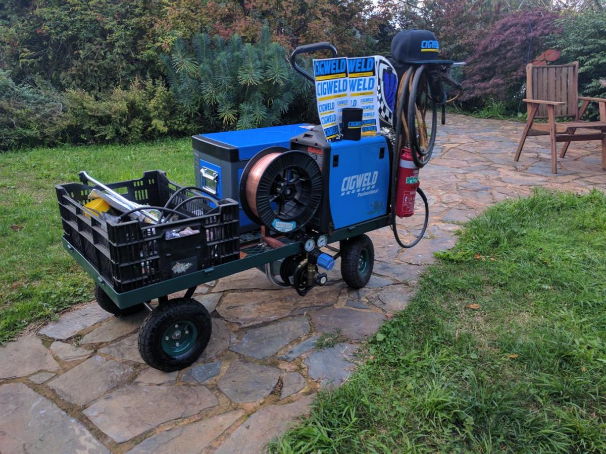

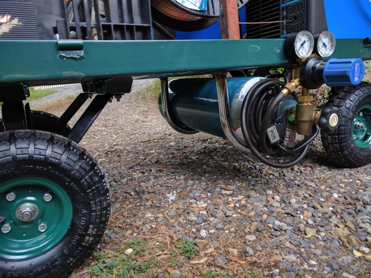

After using a good quality gassed mig (with what very little gas was left) It is incredible how much better my welds were (Not like swiss cheese when ground down which is amazing) having the ability to turn it down so it won't blow through is also incredible!
Thanks to Jeff again for the spraybooth idea! Looking forward to seeing what you do with the 240z!

Looking good. The Gazebo is a nice cheap handy shed. I am not sure how well they will stand up to the weather outside though. I would make sure it is well pegged down ;)
  • Andrew_L26 likes this
#219 Andrew_L26
Andrew_L26
  • 415 posts
  • Location:Melbourne
  • Tagline:That Purple Zed
Posted 21 August 2016 - 12:30 PM
Yeah, It gets blown around but it's in a fairly sheltered spot so it seems to be ok just with some pegs and guide ropes! We will see in time haha

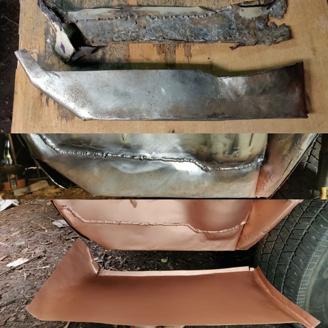

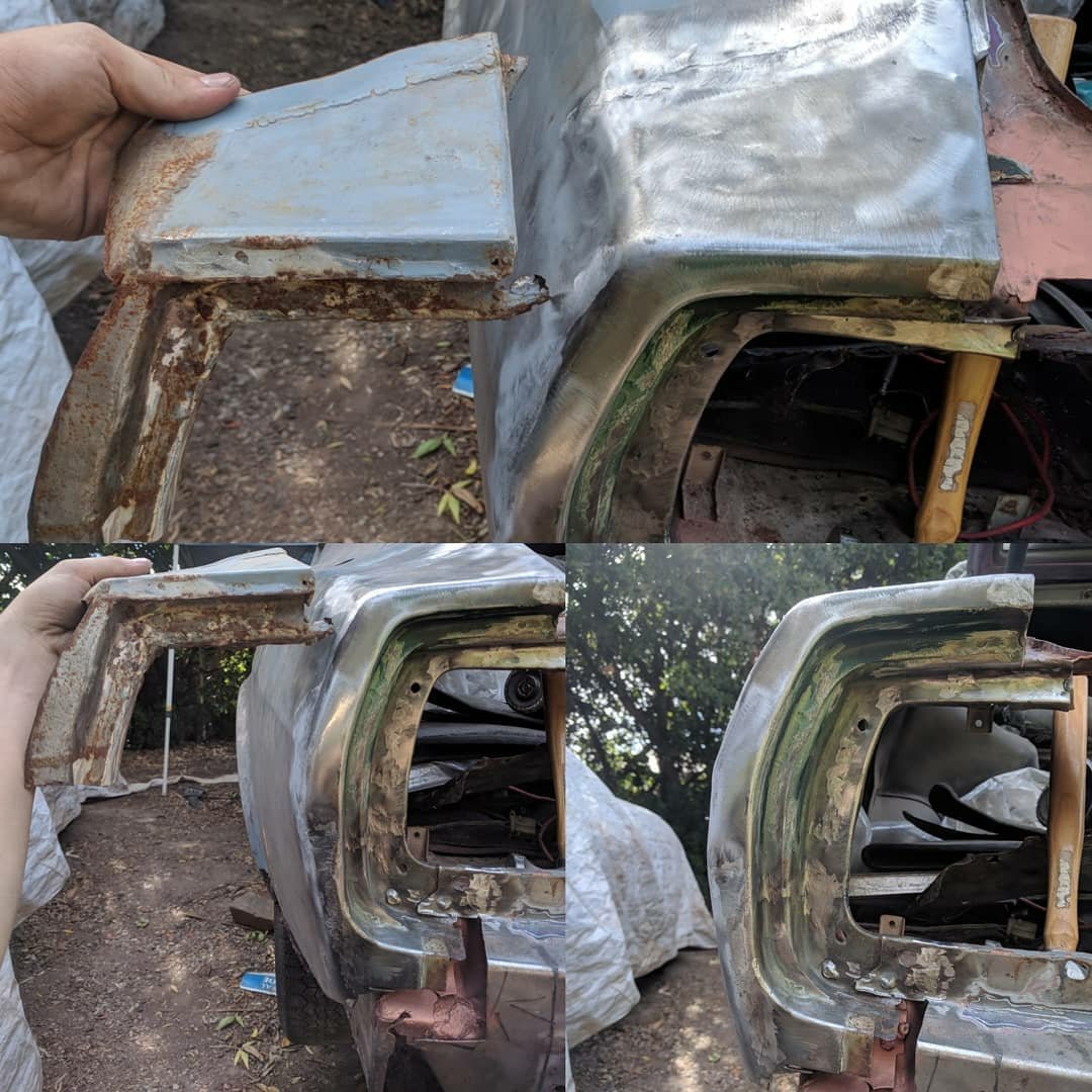

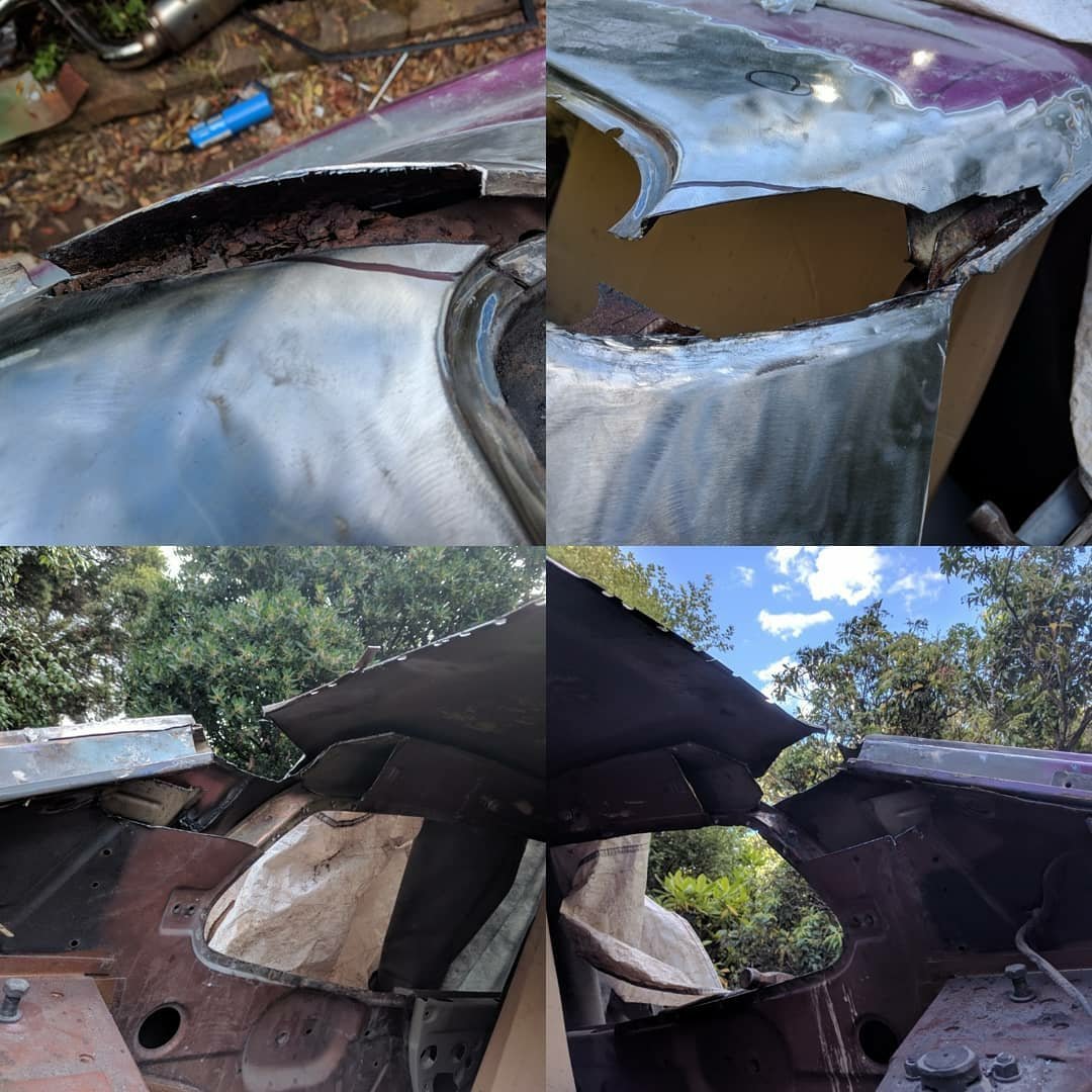

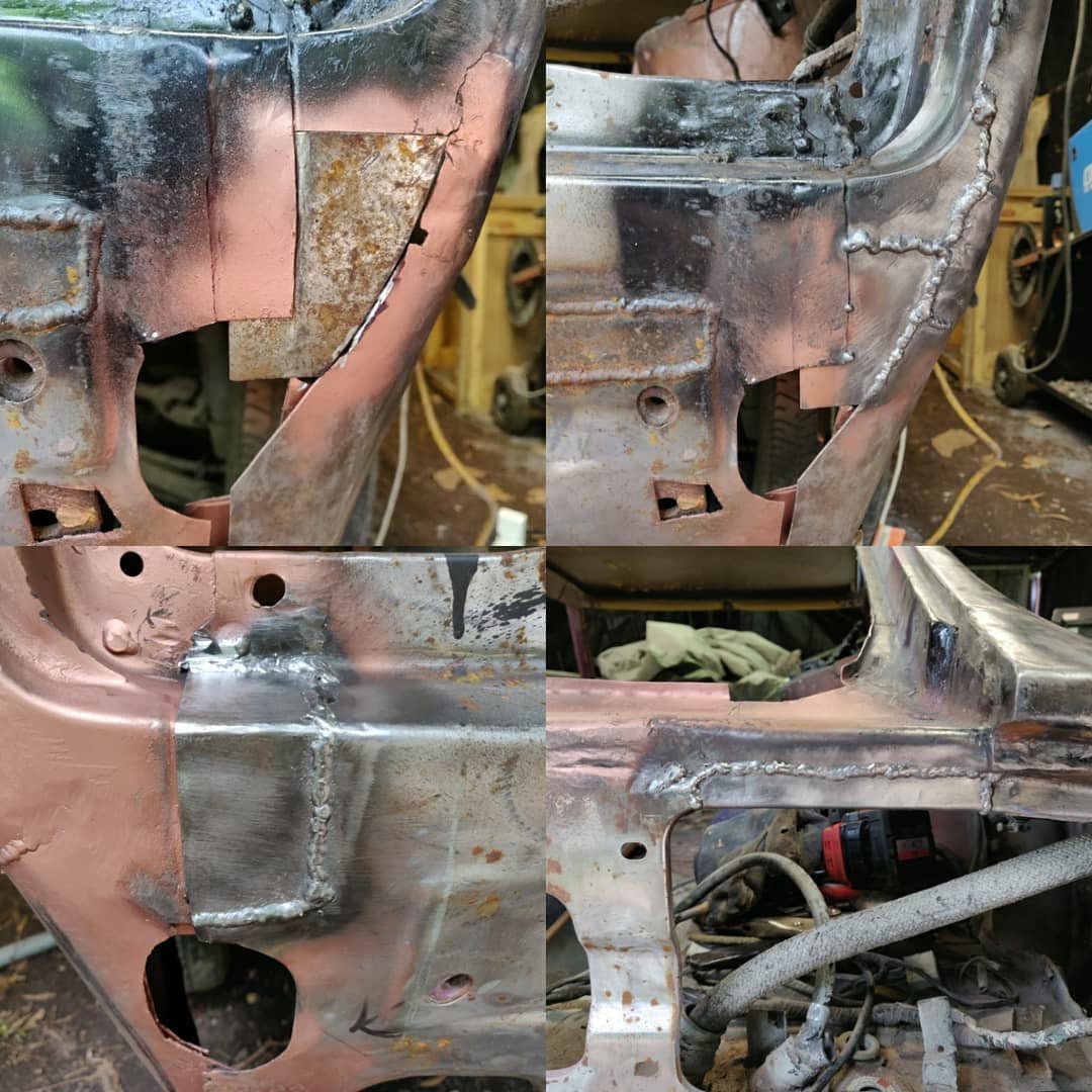

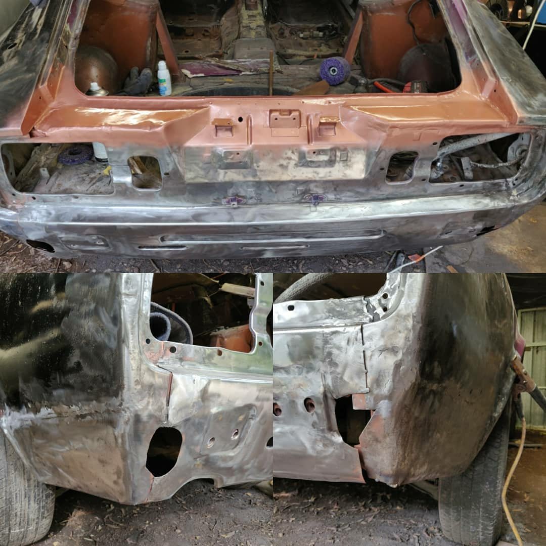

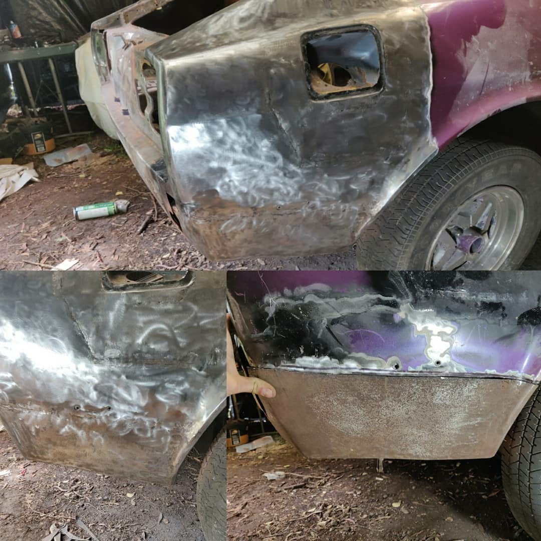

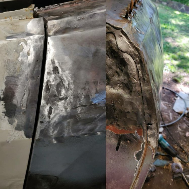

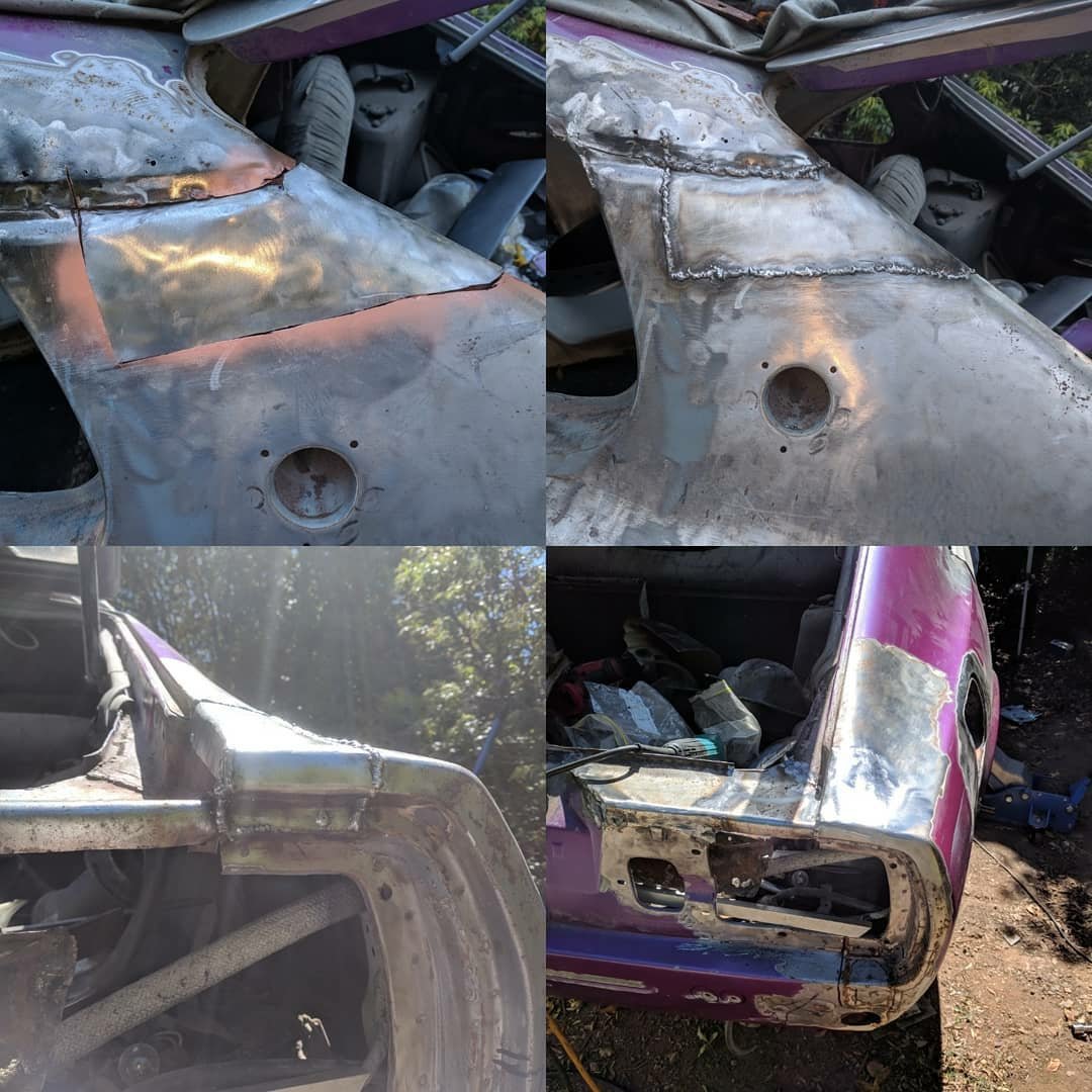

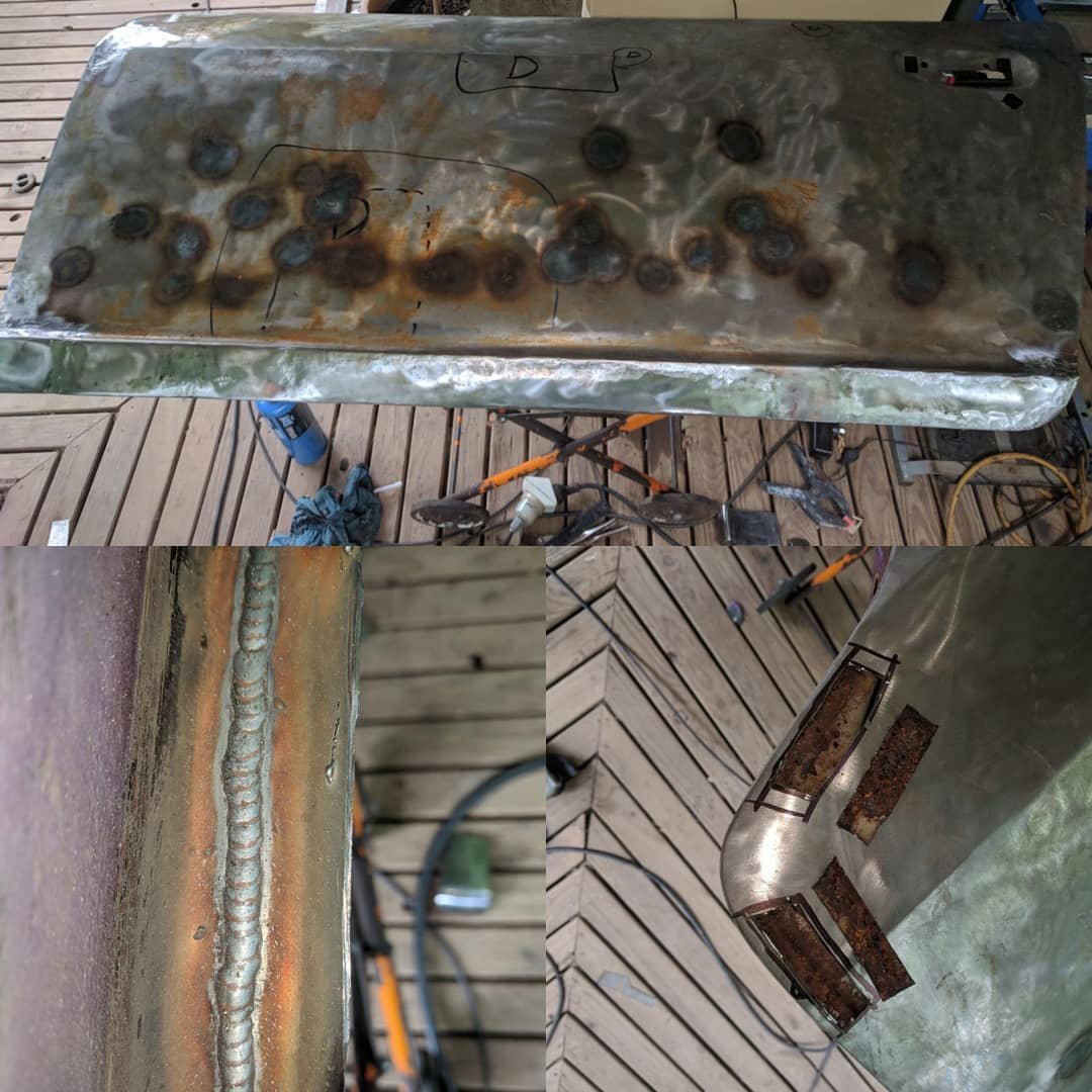

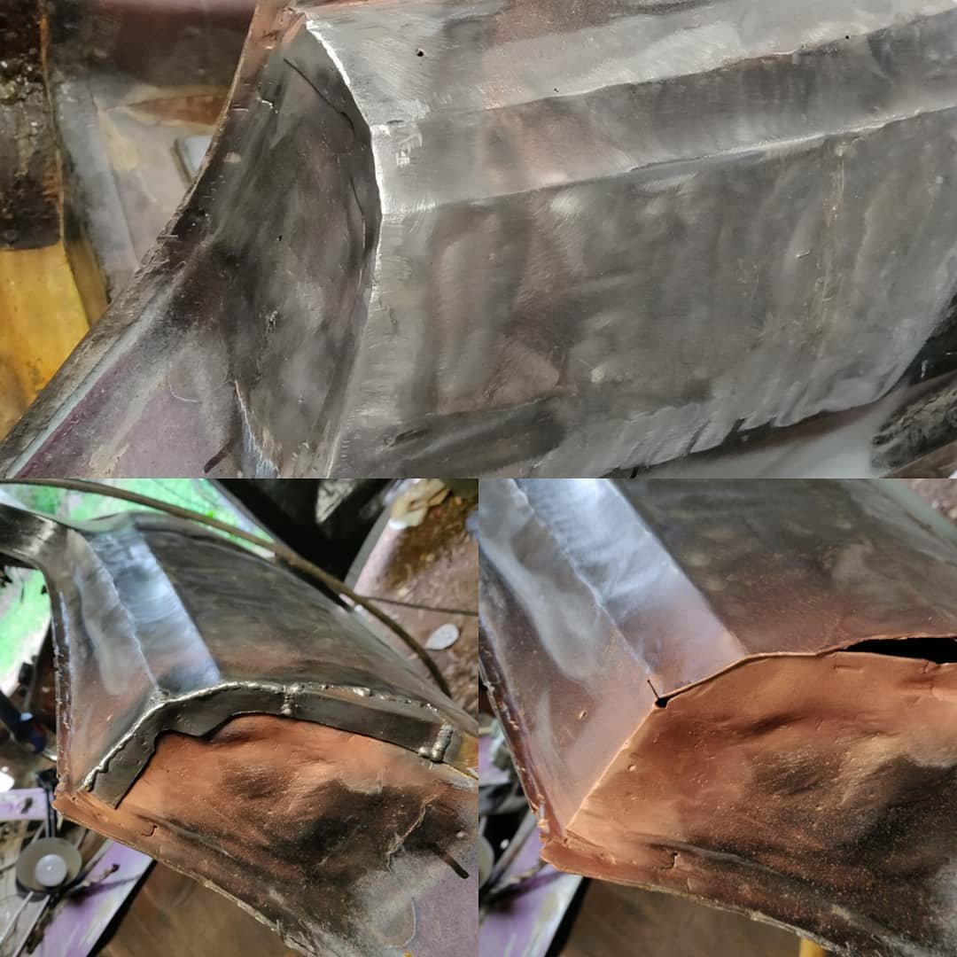

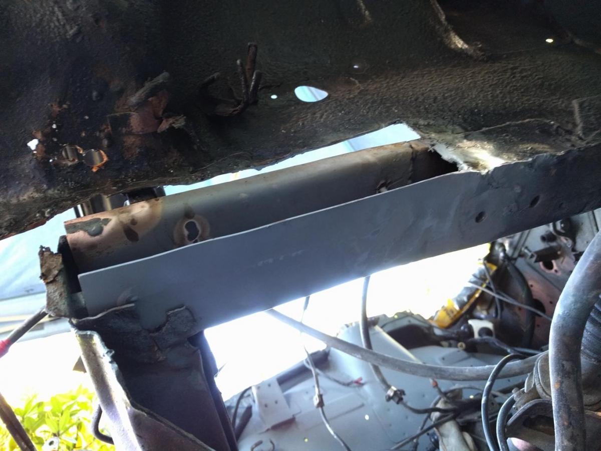

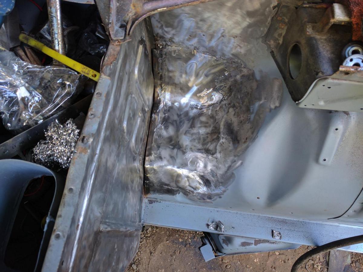

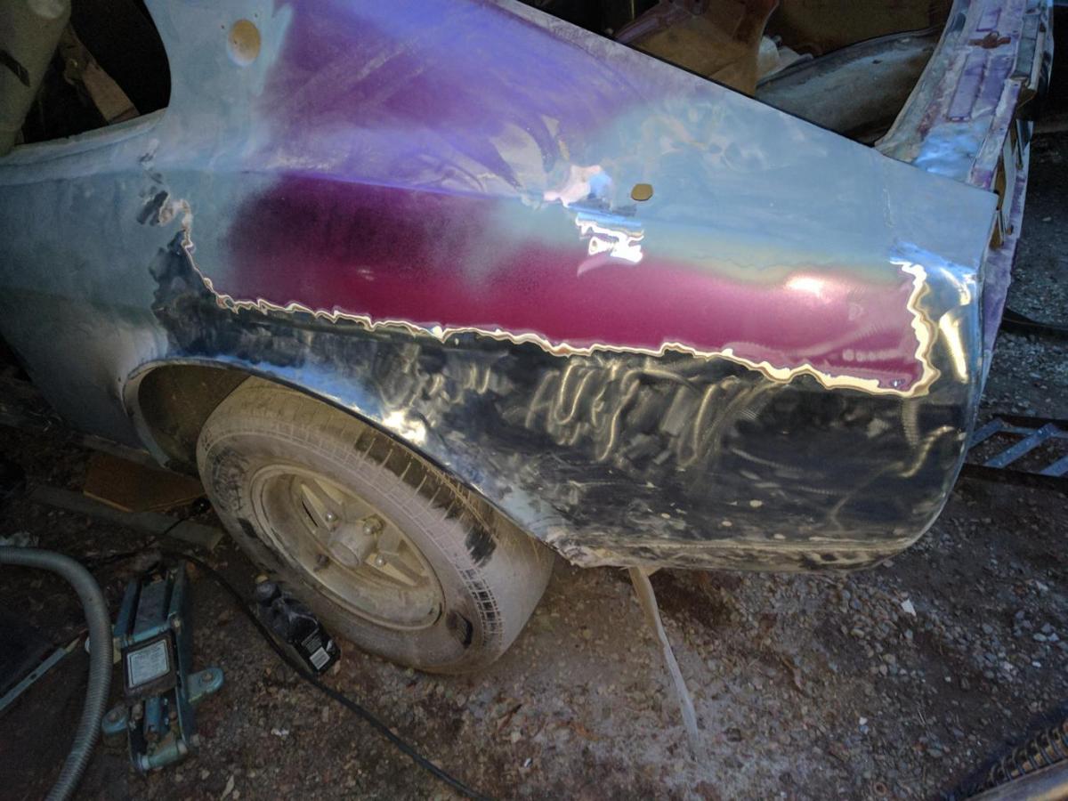

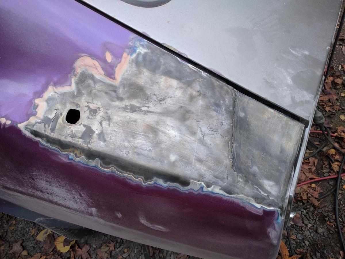

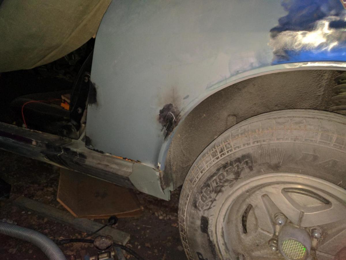

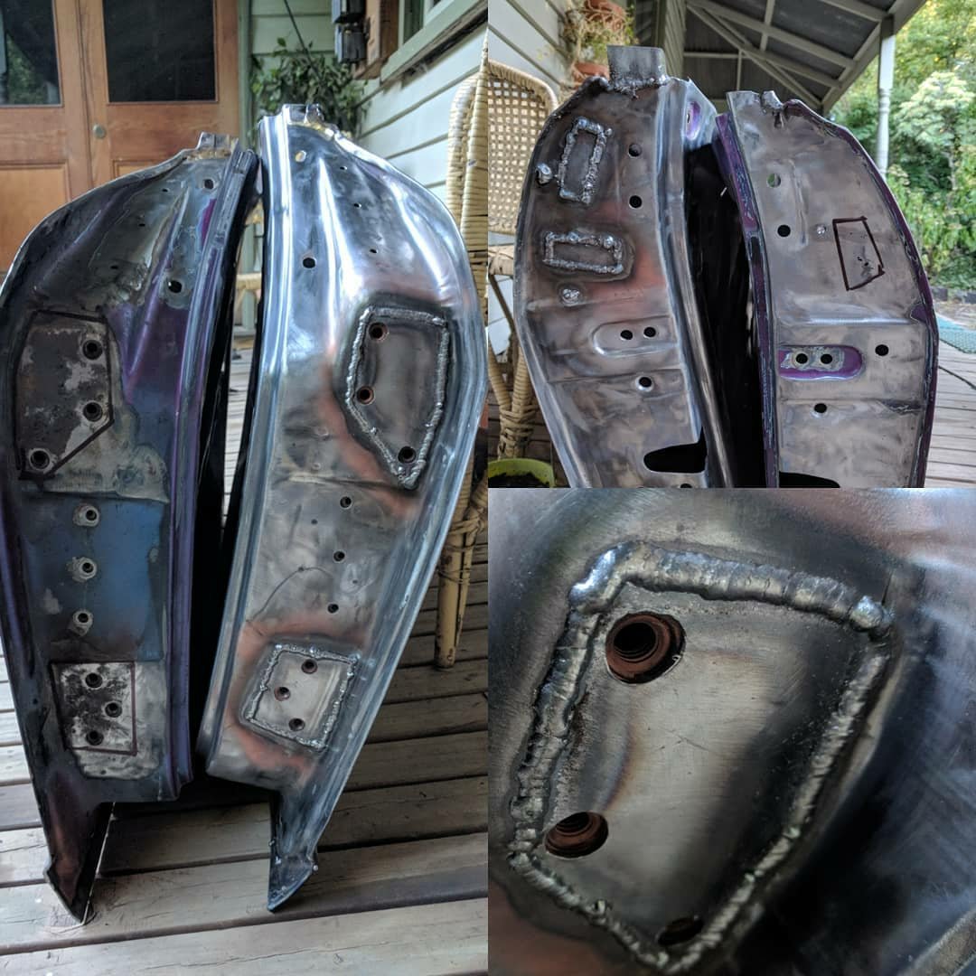

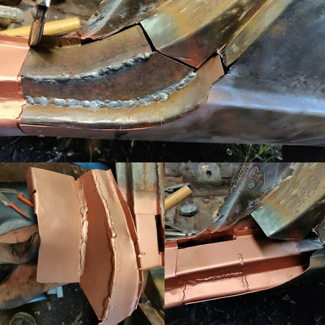

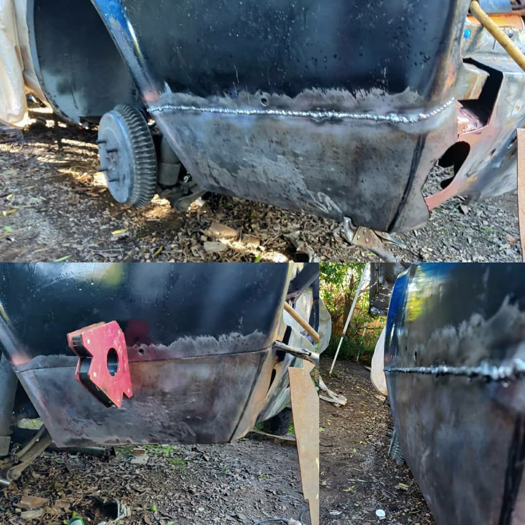

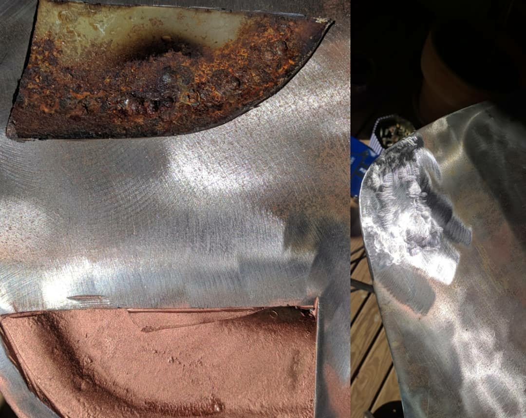

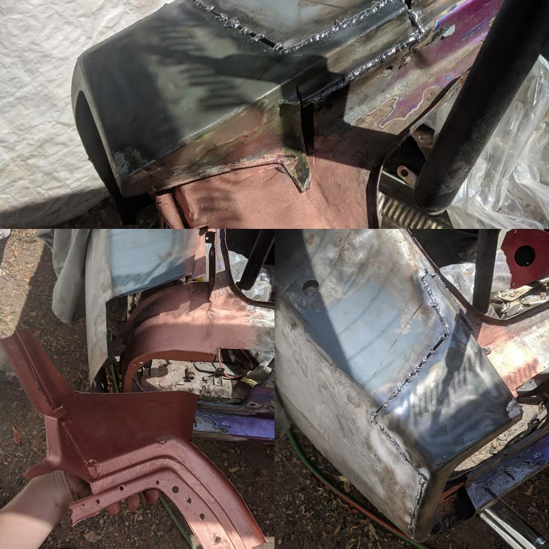

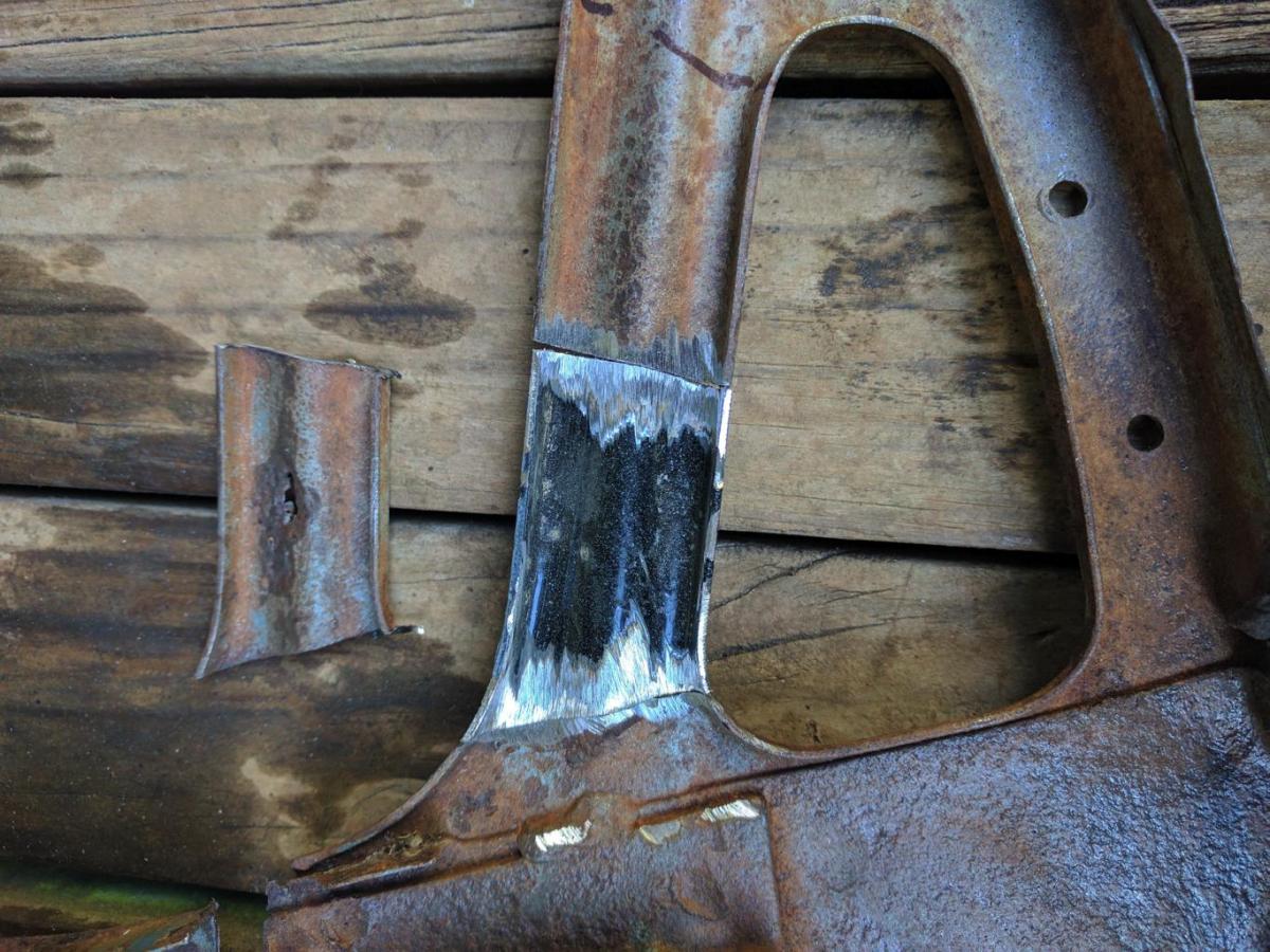

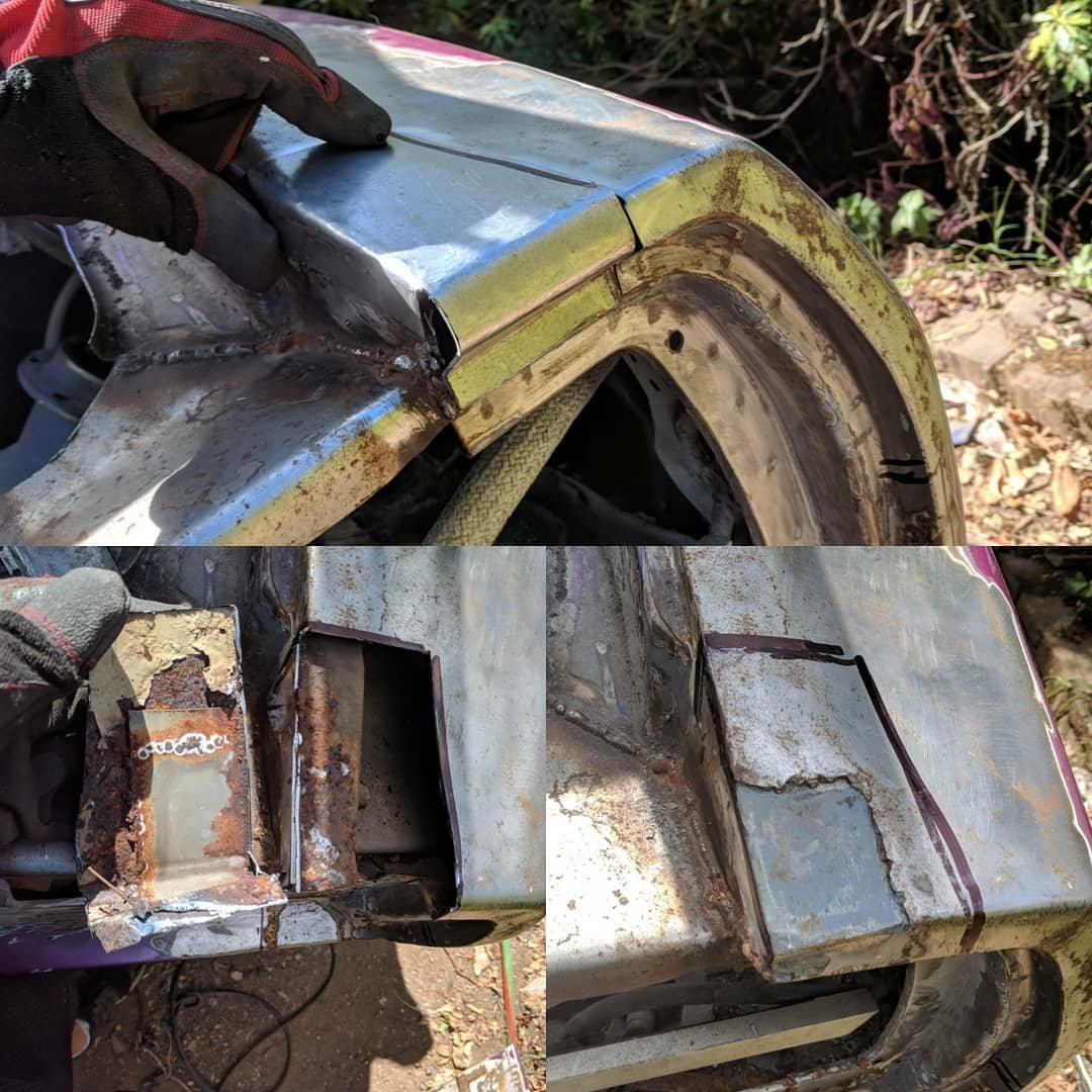

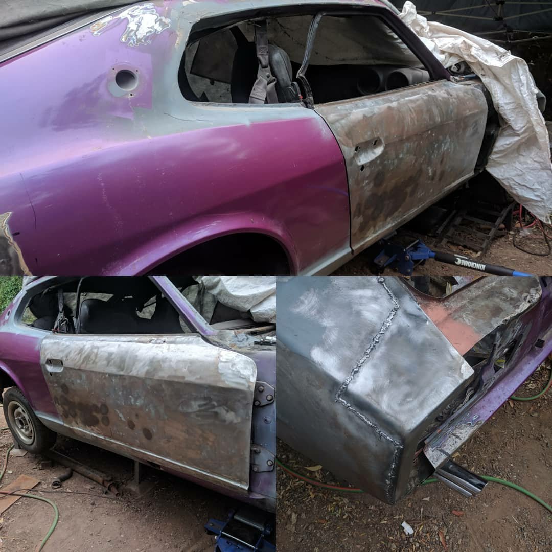

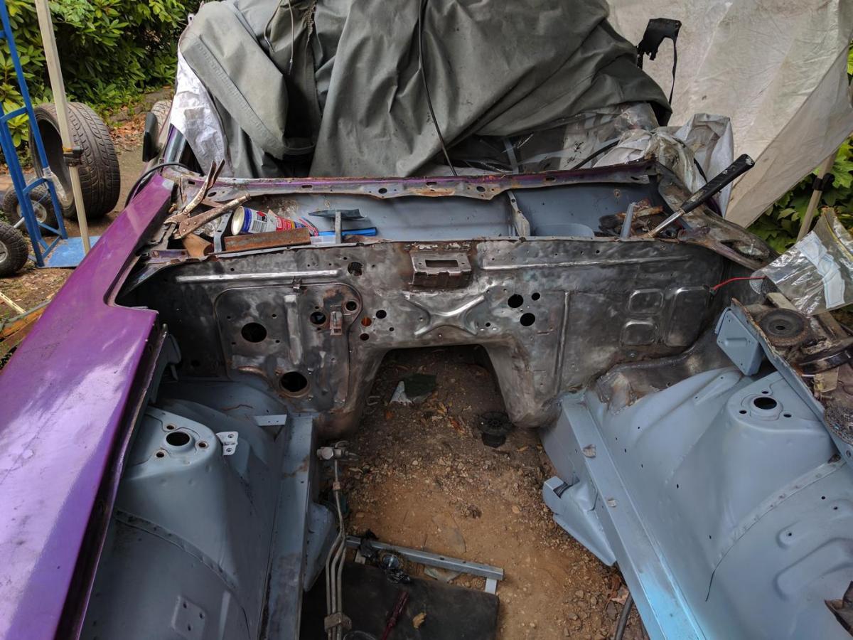

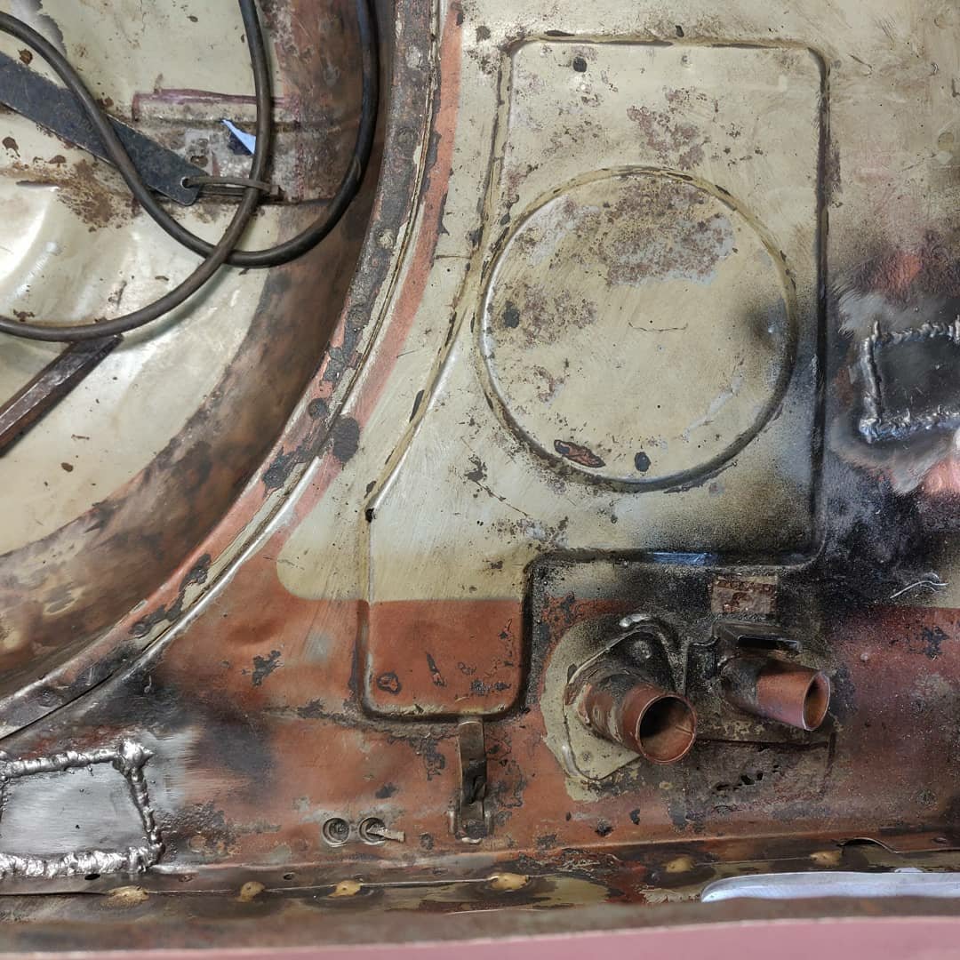

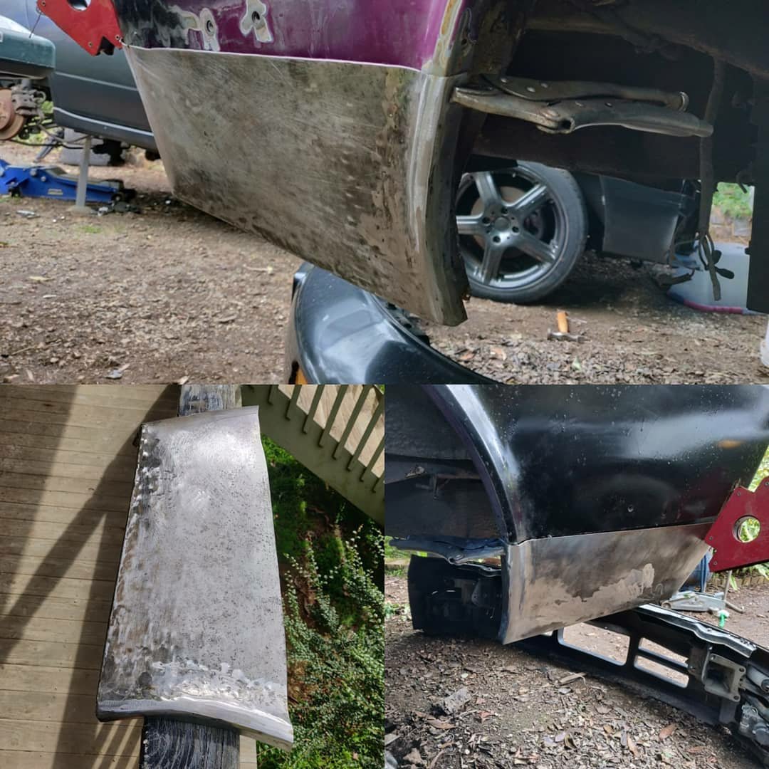

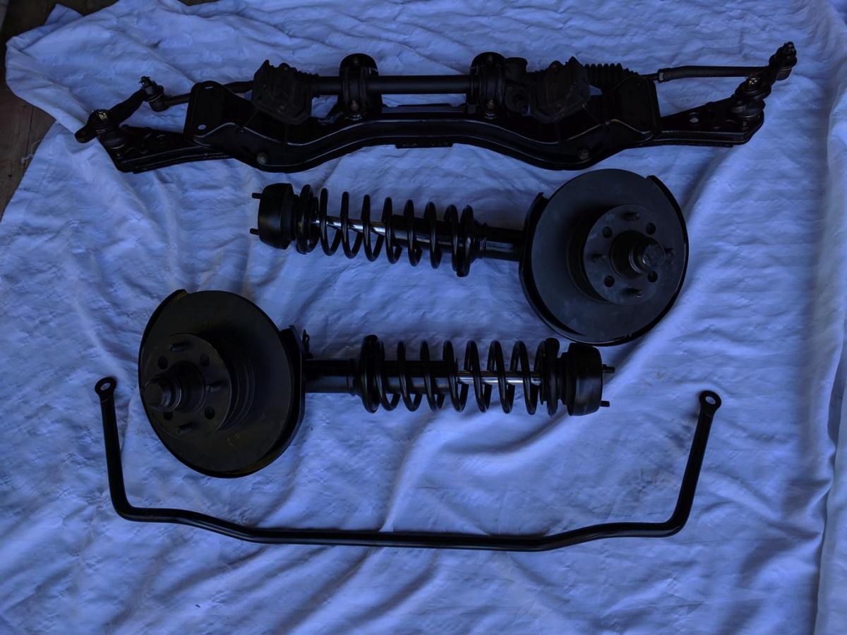

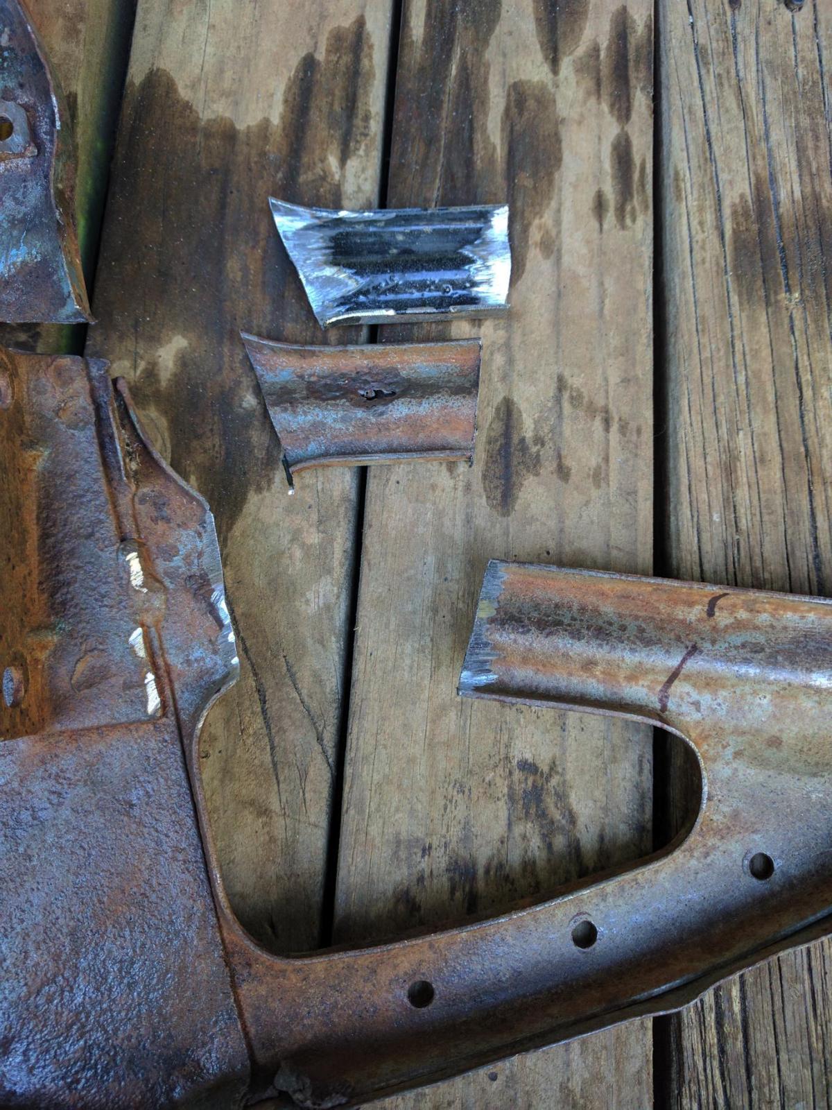

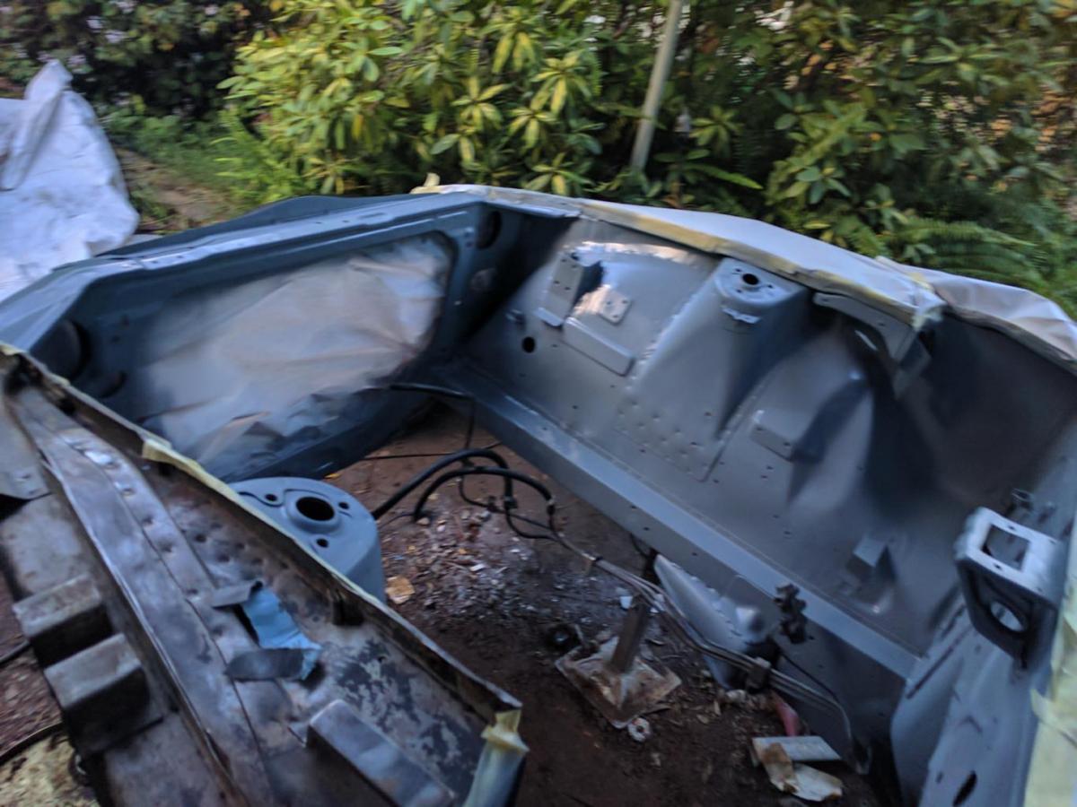

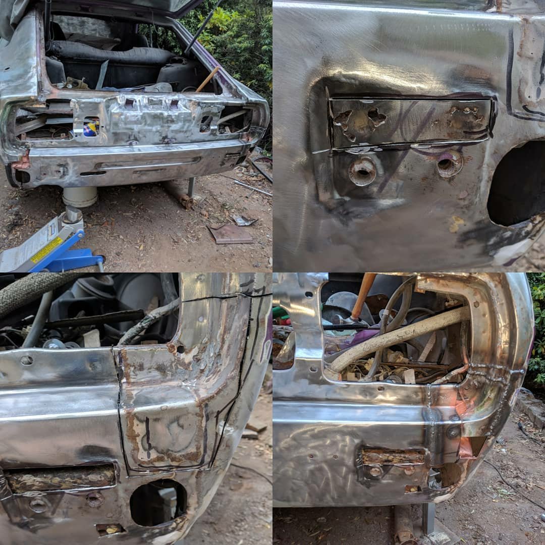

So I've pretty well decided on a full stripdown rebuild. I'm not going to strip it down all at once though, I think I'll do a panel at a time to avoid getting distracted and overwhelmed, decided to rip into some bog and begin refining the passenger rear window sill repair.
I began with this:
Got the little hammer out and began to shape the upper curve
Cut out the overlapped bit that was poorly done and ground down some of the welds, I'm planning to weld up the one or two little holes that have appeared since grinding and lead fill the small indent.
Actually really enjoyed this little job and I just need to form a bit of sheet to fit these hole. what thickness steel is everyone using for their bodywork?
