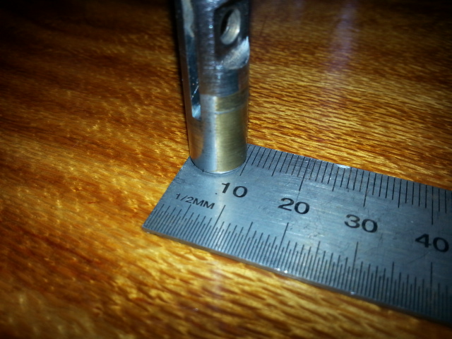

#17 RAP260
RAP260
  • 49 posts
  • Location:Toowoomba
  • Tagline:Robert
Posted 25 June 2015 - 12:23 PM
5/16th I.D. Is 8mm which is the same shaft size as the FCR needle rollers.
I'll take some pictures, get part numbers and measurements tonight.
Unfortunately I can't provide any accurate measurements. This is the best I could do. I get about 10mm OD.

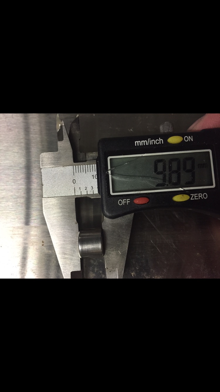

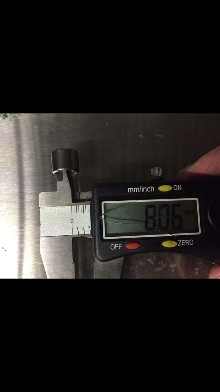

#19 Riceburner
Riceburner
  • 3,261 posts
Posted 25 June 2015 - 04:00 PM
Ok so the SU shaft is 10mm then. Perhaps the SU size will be the next bearing up in this range?
I purchased spares for my setup through SKF bearings.
Specs are:
I.D 8mm
O.D 12mm
Length 9.89mm
They have about ten needle rollers and the pinkish bit is the shaft seal. It's only on one side of the bearing.
