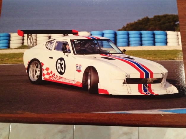

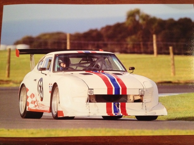

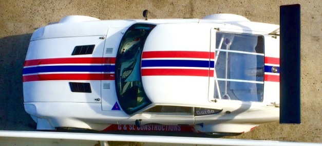

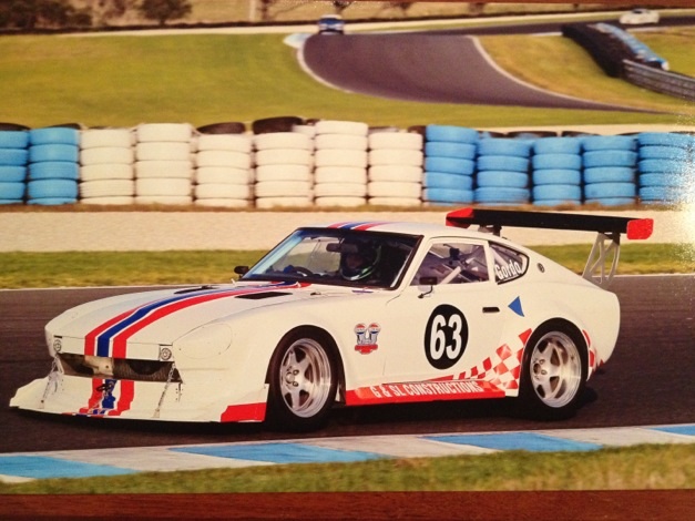

    7.15 am at the Phillip Island race track and it was about 6deg and foggy.  Rolled the car off the trailer and screwed the front splitter on. A few friends came over and did the walk around. The first time people had seen the car. It was nice to get a good reaction .  Scruteenering went well. I was in the second practice group. I have to say I was a little nerves. Lots of things could go wrong, but I had preperd well , but I will,still take it nice and slow and get my confidence with the zed. The first thing I noticed was how slippery the slick tires are on the first two laps. Also the brake performance was weard . They just didn't work. As hard as I pushed I couldn't get them to bight hard. I found myself braking way early and standing on the pedal as hard as I could. I actually came into Honda corner with no cars behind me and tried to lock up the wheels. Not even close. I couldn't do it all weekend , the brake pedal was as hard as a rock.
  But the aero was great. I could go faster through the fast corners once the tires warmed up than ever before.
The morning sessions track temp was below 10 deg. It wasn't till the afternoon when the sun came out and track temp went to 20 deg , that the tires worked a bit better.  My son timed me at 1.49s I was happy with that.
  But the brakes and tires would need some working out. Anyway, Sprint day was next.
      We were confronted with the same weather conditions. Very cold start.  I rolled onto the weight bridge at scrutineering. Was a little surprised at the weight, thought I might come in a bit lighter.  1020kg.
But when I thought about it it's got 40kg of roll cage, massive wheels, 15kg front splitter. Petrol tank cover and heavy brackets holding it up and electric powersteering .
  So the first session was cold and no tire temp. Temp gun on the tires was only 30 deg. So I temped the rear disc, only 40 deg and the front 60deg. Say what. Normally there off the scale. This wasnt helping  the tire temp.
Normally the brakes build heat into the wheels, and this transfers to the tires. NOT HAPPENING.
Over all the car was good. Spring rates worked. No vibrations , turn in was good, understeer , over steer was natural . But did notice the R32  Diff wasn't working, was single spinning over Lukey Hights.
Ended up with a  high 1.48s.  Happy to get through the weekend .
  The pedal box is having the master cylinders changed for more pad pressure. So I'm hoping that will fix the brakes, and with any luck help the tire temps. The diff I'm going to leave for another time.
The zed has hit the track, so the fun has just begun.  It's race ready. But it will never be FINISHED!!
        Hope you enjoyed the journey . I will be back on the track in about 4 weeks.  Cheers.
  Some pics from the weekend.
