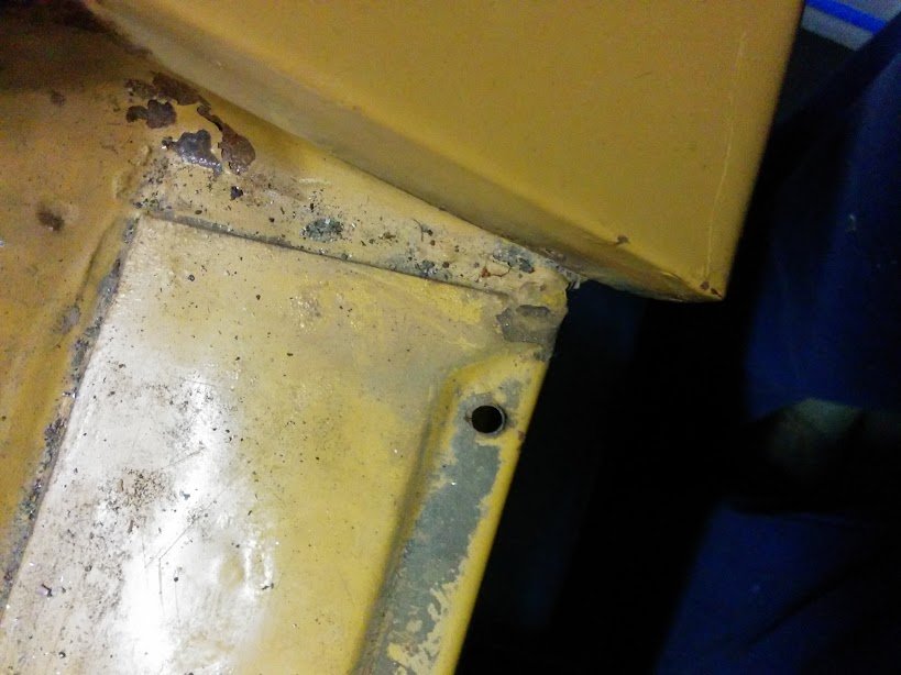

There is quite a few 'hidden' spot welds near the corners of this panel, best way to find them is actually try lifting the piece. You'll find that the places it won't move after using a chisel and hammer to try and separate them are likely spots where you need to remove the spot welds.
A couple of other 'hidden' ones are on the edges right near the 1/4 panel join.
Right side
https://lh4.googleus...i7=w819-h614-no

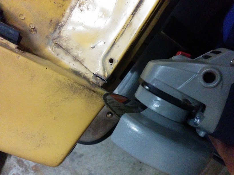

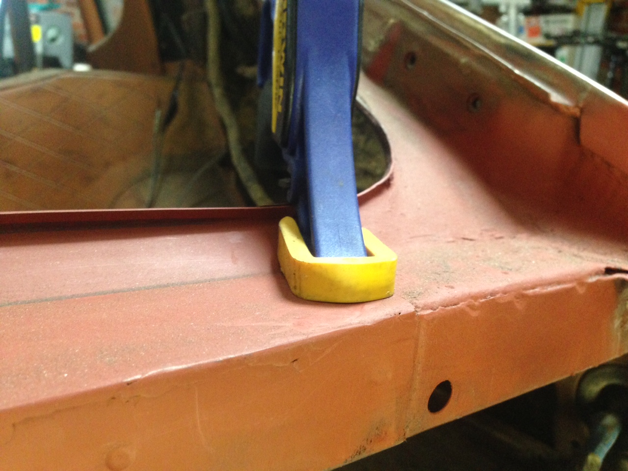

Left side after nipping it with the grinder.
Posted Image
Using a cutting disc on a grinder I nibbled these spots.

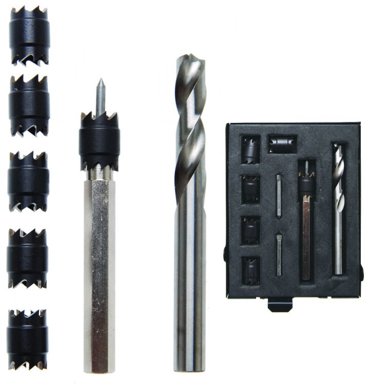

So I bought another spot weld cutter kit.
http://www.ebay.com....tm/120678177633
http://r.ebay.com/7K8dun
Posted Image
I bought another kit a while back which cost around $40-$60 but I think this is much better value for money, comes with it's own case. It has different types of spot weld cutter. I quite like the drill bit piece as I've used these before and found them better than the ones that require a pre-drilled pilot hole.
It also has spare tips in case they break (which is what happened to my last 1). Even comes with it's own little case.
Postage was free and quick (within a couple of days).

Don't bother with the hole-saw / broach type bit Gav. Once you've removed the panel you'll have to grind down all the little lugs that are left behind - that's a PITA!
Use the drill bit type, as the only clean-up required after the panel is removed, is to buff over it with a sanding disc.
Oh BTW make sure you use a good quality cutting fluid to keep the drill bit cool, otherwise you'll blunt the bit.
#7 PeterAllen
PeterAllen
  • 1,340 posts
  • Location:Sydney
  • Tagline:Manana!
Posted 19 June 2015 - 06:59 PM
I've found that either approach works better if you firstly drill a small pilot hole right through, rather than relying on a centrepunch mark.
#8 zzzzed
zzzzed
  • 2,691 posts
  • Location:south australia
Posted 19 June 2015 - 07:29 PM
I am with lurch on the hole saw type spot weld drill. Also when they go blunt you may as well throw them away.
Where as the drill bit typ spot weld drill you can keep sharpening them. I actually re shaped a standard drill bit in to a spot weld drill bit which is handy for getting some hard to reach spot welds. Because of the extra length

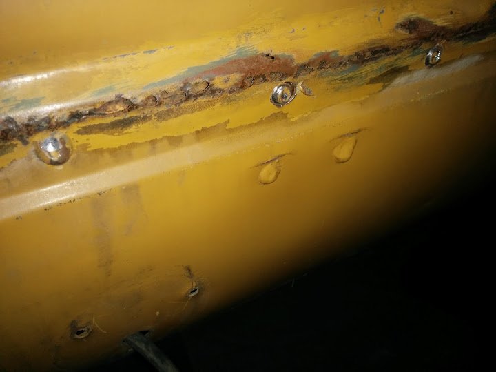

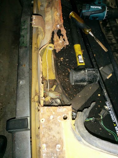

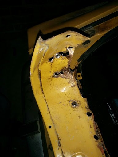

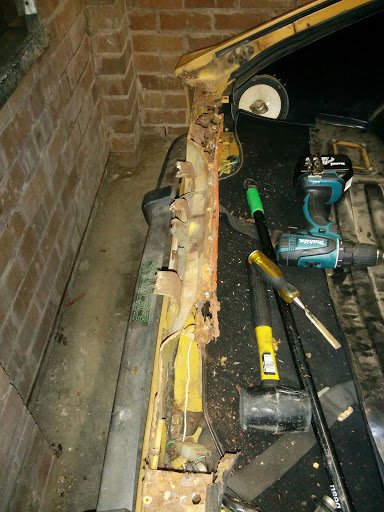

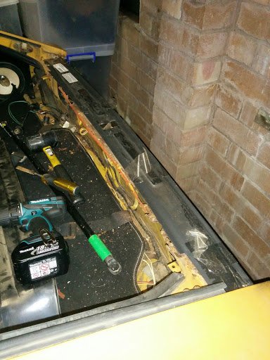

So there is quite a few difficult to spot, spot welds on each corner.
Hopefully these photos will help you see where to look.
Posted Image
Posted Image
Posted Image
Posted Image
Posted Image
Posted Image
Posted Image

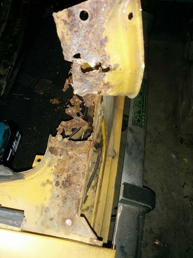

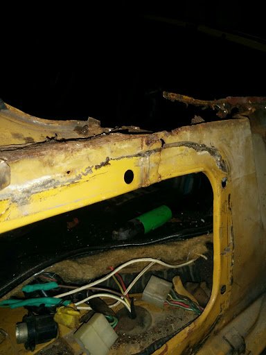

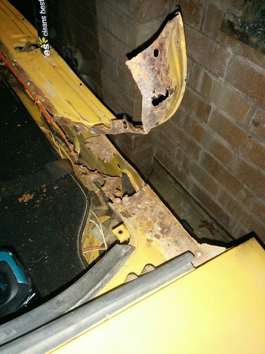

After removing the old slam panel (which had some bog in it cover 1 or 2 spot welds for some unknown reason). I added it to my trophy room of rusted s30z parts...
Posted Image
Posted Image
Posted Image
Posted Image

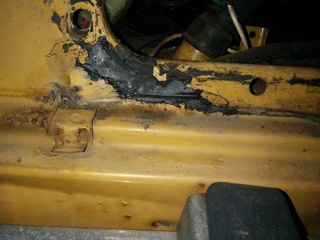

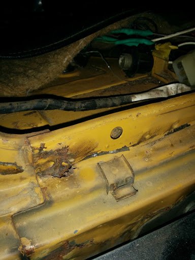

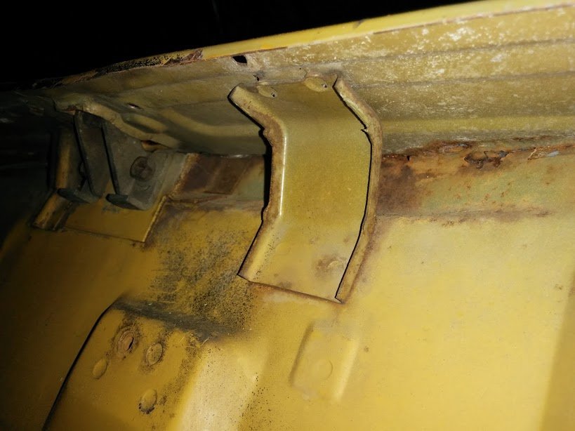

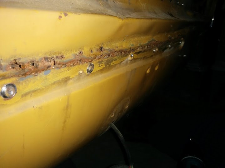

Some rust in the bottom left hand corner where the tail light goes (passenger side).
Posted Image
Driver side has a small pin-hole also.
Posted Image
Posted Image

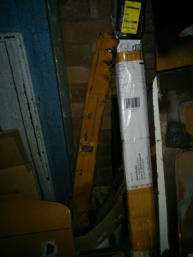

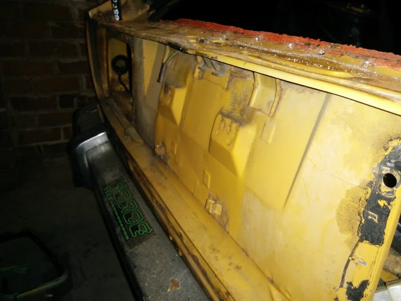

Just placing the rare spares slam panel down there to see how it will look.
Posted Image
Posted Image
Question, since this area has quite a bit of rust and is now missing, has anyone got photos of what the area is supposed to look like that they can share? I'm going to have to figure out a way to fabricate this area.

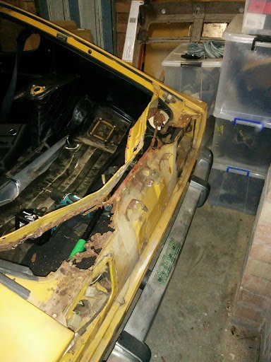

I have just posted some photos in my build thread of my slam panel repair. I managed to only replace the sections that were under the slam panel. The passengers side was the worst with most of the section missing.

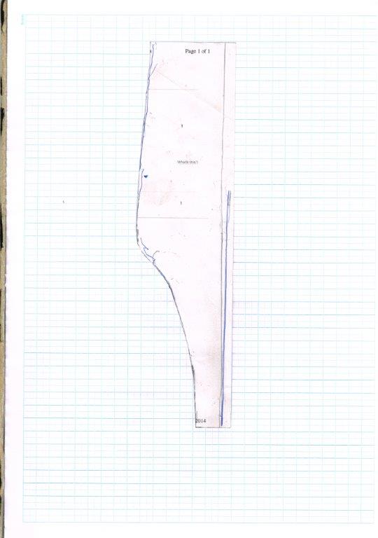

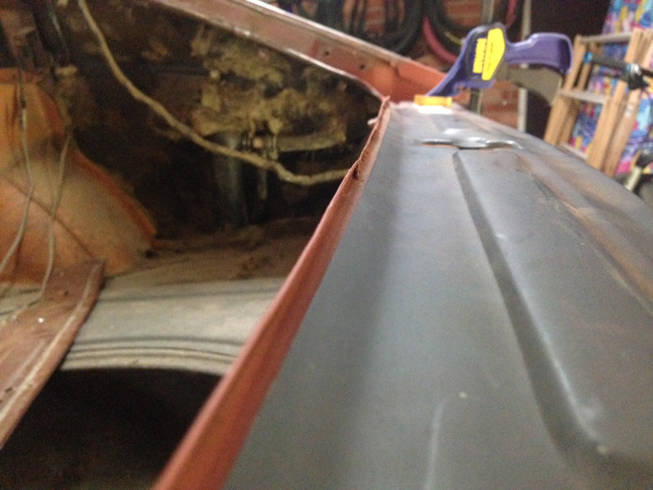

Gav some of this may also help.
I checked a few things this afternoon.
The angles on the repair panel is the same as the original (see photo)
The lip at the top on the under panel is the same height as the lip all the way around the tail gate opening. It is also at 90 deg to the opening
The template is for the side to the centre section but not the actual centre section (see photo). It is mirror image L to R are is on A3 paper graph is 10mm
Jeff

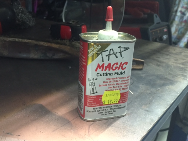

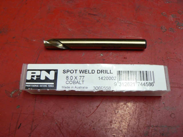

Any recommendation on good spot weld cutters? The last kit I ordered was pretty useless it went blunt very quickly.
What kind of cutting fluid do you recommend and who sells it? Bunnings?
#20 KatoKid
KatoKid
  • 1,696 posts
Posted 30 August 2015 - 10:15 PM

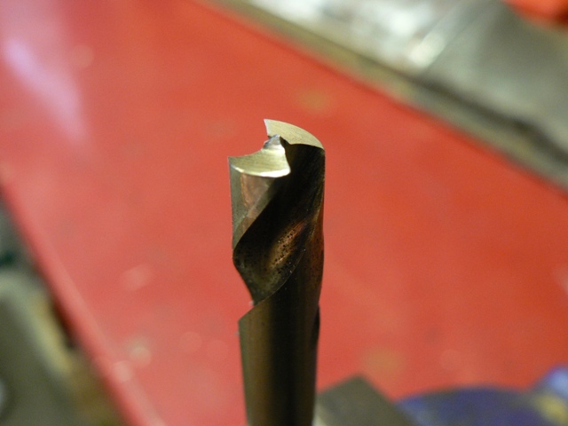

Hi Gav.
I used these ones, not cheap but they don't drill through Both panels and if you keep the speed slow they last really well.
