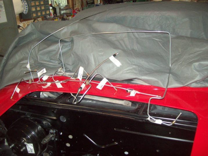

#8 PeterAllen
PeterAllen
  • 1,340 posts
  • Location:Sydney
  • Tagline:Manana!
Posted 05 June 2015 - 10:37 AM
An alternative suggestion.
Take all, or any, of the old lines off and bend the bundy tube to the same profile and leave 100mm extra on length.
Trial fit and marks to the correct length.
Give them to any brake place and have the ends PROFESSIONALLY* flared (including double) to the correct length.
That's what I did.
Posted Image
Be careful of buying tools you may only use once, they just clutter up the shed.
*= i.e. no mistakes nor any need to remake because of ineptitude!
