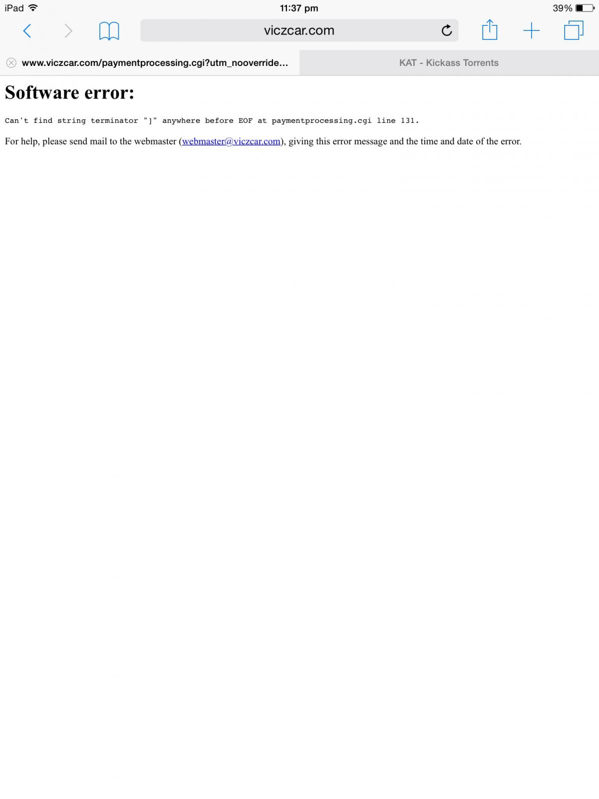

Gav, can you confirm if my donation has gone though - 23/8 @ 23..36? It came up with this...image.jpg
#60 PB260Z
PB260Z
    Peter (PB)
  • 3,281 posts
  • Location:Northern Sydney
Posted 23 August 2015 - 11:47 PM
Hi Mate
Whilst I can't access the accoynt to see if the $$ actually came in, I would be confident that it did though for the following reason
- the error you got is the same I get, but my monies have always gone trough.
When he gets time, I am sure Gav will confirm.
PB
