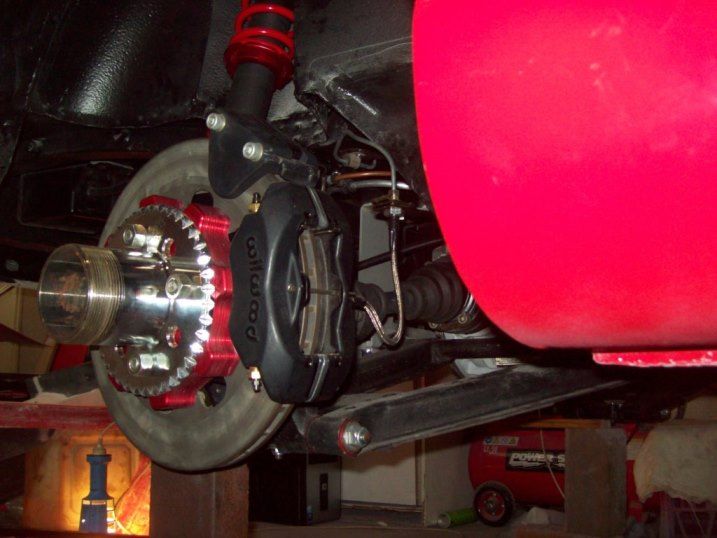

I've modified the rear brakes a bit.
Posted Image
I have Wilwoods with a modified version of WOZA's parking brake mount. Warren supplied the cables but I remember there was a need to open up the tunnel mounts as the cables were designed for 260 fittings. I'm just wondering if the cable lengths are the same for 240 and 260 2-seaters?

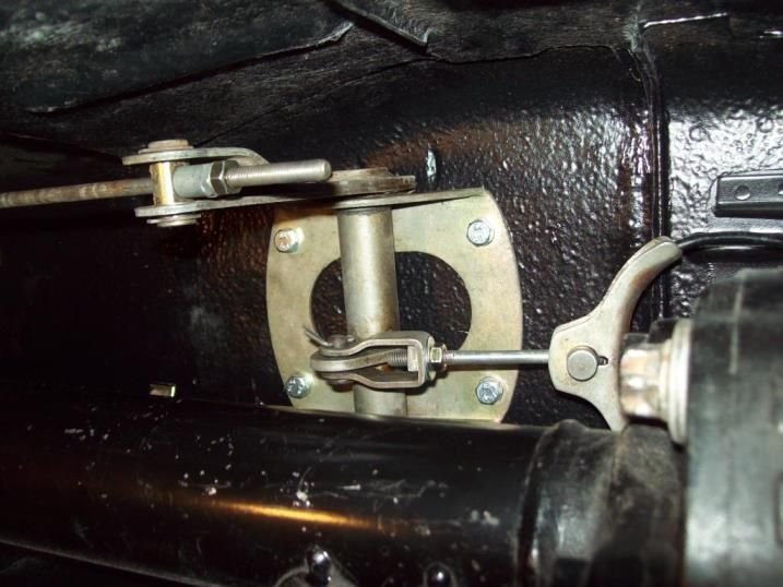

Mark. I feel sure all WOZA's cables would be the same and the issue hasn't been raised before so i must be doing something wrong.
Does this look correct?
Posted Image
Justin - I'm using standard 260Z 27 spline stub axles. I'm only running 7" rear with narrow tyres. I'm pretty sure it will break traction before it breaks anything mechanical.
Hey Peter, hope you are well. You may need to reclock the bracket for more adjustment, we had the same issue with the 2+2 V8 and Sam's car (for some reason my 2 seater was perfect. There are details on the interwebby on how to do this but basically it involves re positioning the second bracket for more "Pull"
I can do a demo one and post pics if you like.

Thanks Mark. I understand what you are saying about re-clocking - was that with std. cables or WOSA's?
I read where some pommies had made tube sleeves (about 35 mm long)to slip over the long rod and alter its lock nut position. It's simple enough so I think I'll try that first.

Hi Peter
Could you tap the thread further along the adjusting rod?
I can see a sleeve would be very simple too.
Great to see your car is getting closer, the light at the end of the tunnel is getting close now Mate

Mick. I ran a die nut over the existing thread as the rod was a little bent near the lock nut and I had straightened it, but I thought running if further might leave the new thread exposed to corrosion.

Try fitting a shorter secondary bolt and and winding back the longer one.
