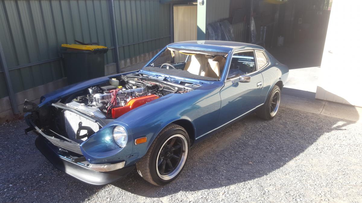

Hi guys BLU is still getting some love even though I am full steam ahead paving the verandah/ entertainment area. I have recently finished working on the brakes I have completed the r31 handbrake brackets that bolt upto an existing point where the old flex to hard brakeline bracket originally bolted upto.
I was having a heap of trouble with the 350 holley and spent alot of time chasing my tail. I checked everything pretty much stripped the engine back to bare and with all of that I was back to the carby. So with a wanted add on here tracked down some 240z hitachi carbs and manifold. Someone at some stage had painted both the carbies silver but with some thinners and a toothbrush I got all the paint off, luckily the paint protected some of the parts from rust. At this stage I also rebuilt them botled them upto the car set them to factory setting and bang it fired up.
Now I am currently collecting stainless exhaust bits so far I have all my 2"stainless pipe, stainless triflow muffler, 400 cell stainless cat, lazer cut stainless flanges all thats left is some elbows and some argon for my tig. I cant wait to start on this ☺

Posted 30 August 2016 - 11:57 AM
Some new boots for the old girl ☺ 16inch performance superlites +4 up front and -4 at the back. I would love to go a little lower to get better fitment but I am getting pretty close to that 100mm clearance mark.
  • jeff43 likes this

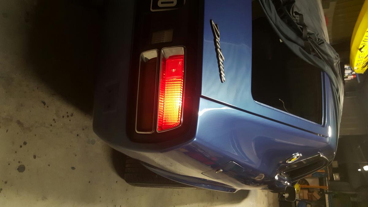

Posted 24 September 2016 - 08:11 AM
Exhaust is finally all welded up and bolted on and sounds great. Glad I went with a triflo muffler instead of straight through otherwise it would have been way to loud. According to a free db meter on my phone its at 84db at idle so well under the legal 96db for South Aus.
There were a few changes to the exhaust, originally it dogleged slightly to clear all rear suspension. However this made the exhaust sit 80mm off the ground, so that got chopped out and now a straight run from the muffler goes under the rear suspension. Giving me a very nice 115mm lowest point ground clearance so that should keep the law happy ☺
And just a picture of the girl working on her tan.
