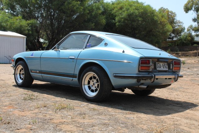

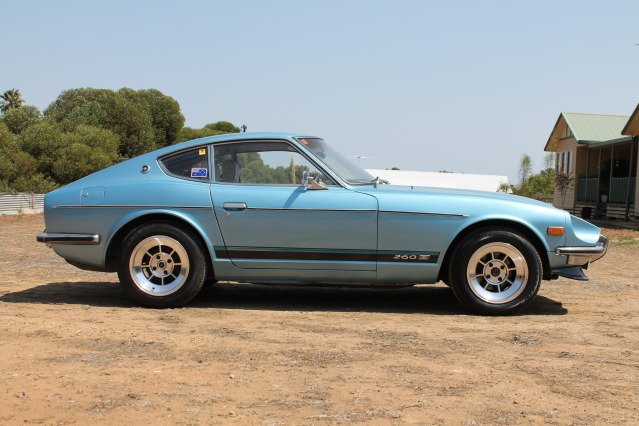

Posted 12 March 2015 - 09:58 PM
The car has been inu family for 10 years or more and the springs have never been out of the car in that time
It's is running 205/60/15 on 8" zero offset rims.

It does look a touch high compared to what we're used to today, but I'd say that looks about stock; I have the same, '74 260Z 2-seat, since 1984. As per my first reply, I lowered my car about 25mm both ends. I can barely slide my fingers under the guards & over the tyre. I reckon I've got it about right, rides nicely, not so low that suspension travel is compromised.
