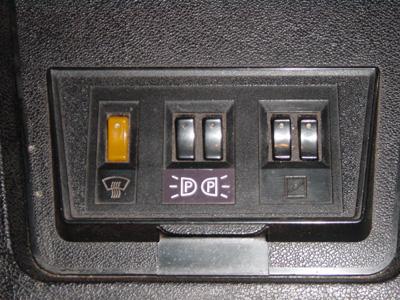

Hi
Looking for a set of these. Any out there?

Yes they are Japanese home market Z park light switches, some sets were lit & some not.
I've only ever seen them on ex-Japan-new Zeds imported to NZ as used cars.
So you could inquire with the NZ Zed club; there were quite a number of 200Zs (typically had the smaller motor) imported years ago, many were rusty so may have been parted out, someone might just have a set.
Probably better luck though hunting down a set in Japan.

Might pay to hunt around on the Europe sites or UK as I think they were fitted to the cars that went there so they could turn on just one side of the parking lights when parking half on the side walk and half on the street?

Certainly that's what they were for. I've not seen them fitted to a couple of ex-UK-new RHD cars that have come to this part of the world, only ex-Japan or Asia new cars, but could have been on some. You could make inquiries via the UK Z car website, & there must be clubs in Germany etc. But I think Japan would be your best bet.

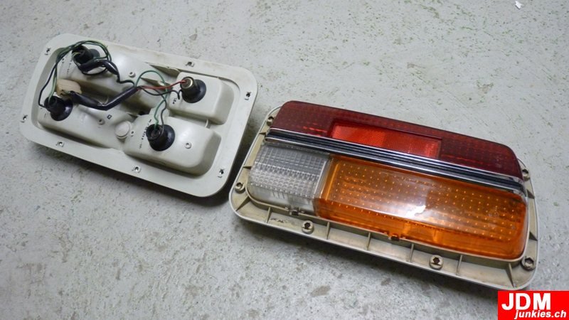

I believe there is an additional glove placement on the JDM cars that is used for the parkers. I don't think they are fitted to our cars, it has a block off plate. Would need a photo of the rear light housing to show you what I mean.
*Edit look here: Posted Image
On the right hand side in between the 2 bulb holders is a smaller circular block off tab. That's where the parker switch is usually connected to a globe I believe.
If you look at the way USDM S30z rear lights work you'll see they don't look like they light up fully.

Just checked, my spare 260 taillights don't have any additional bulb location. Mind you, that doesn't mean anything, it can be done within the wiring, like with American cars.
But those extra locations aren't necessarily for Park lights, could also be for Fog lights, required in some parts of the world.

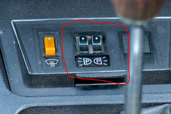

That's not the Japanese market parking light switch. And don't bother looking for them on UK cars because they never had them either.
The correct switch has two rockers side-by-side in one housing. It needs the whole system (switches, sub-loom, relay, lamp holders F&R etc etc) to make it all work properly.
I've got a spare one, but I'd need to be convinced to let it go. It's not the sort of thing that's all that easy to source when you really need one...

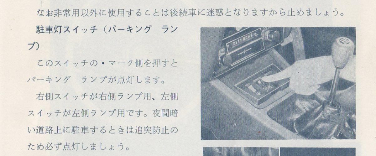

Yes, requirement for Japanese law. Parking at night on unlit roads.
The switch pair just allows you to select Left side or Right side, with Ignition off, illumination of front and rear sidelights as a pair. So if you parked on the left side of an unlit road at night you selected R side illumination, and if you parked on right hand side of the road for any reason you selected L side illumination. Just a safety thing, supposedly allowing a parked car to be seen earlier. We had a similar thing in the UK during the 50s and 60s as I vaguely remember, but not now. I notice my everyday driver Audi A6 will do a similar thing via the indicator switch though, so maybe its still a requirement somewhere?
Simplified instructions in owners manual:

BTW. The left/right parker selection is an Euro thing from late 60's. Originally introduced as parkers in winter drained batteries and law required to have a parker light on at night when on the side of unlit road. Good battery could easily handle full night with parkers on , on one side. Parking was allowed on both sides of the road, therefore the need for separate  L & R side. This is a standard Euro feature on all Euro car.
