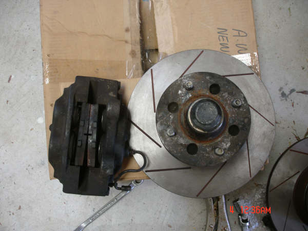

Just spotted these on ebay, not a bad price either. I'm 95% sure these are the Hilux direct bolt on brakes.
http://cgi.ebay.com....1QQcmdZViewItem
Scott
#53 sco_aus
sco_aus
  • 2,484 posts
  • Location:Canberra, ACT
  • Tagline:Scott
Posted 06 July 2006 - 01:00 PM
Just spotted these on ebay, not a bad price either. I'm 99% sure these are the Hilux direct bolt on brakes.
Scott

hmmm...Info I've read in the past re the "wider" calipers for sale above as quoted from a thread on HybridZ.
You can also use a version of the S12+8 calipers for the vented rotor conversion.
Let me explain. There are two different Toyota 4x4 calipers with the casting mark "S12+8". One for a solid rotor and one for a vented (wider) rotor. The 1979-85 4x4 calipers are for use with a solid rotor but the 1986-88 4x4 calipers are also marked "S12+8" but they are designed to fit the wider, vented rotor.
If you examine and compare the two different S12+8 calipers you will see that they are the same casting, (actually they are a pair of castings, one for each side of the caliper) except one is machined more that the other to be used on the solid (thinner) rotor.
There are advantages of using the S12+8 caliper (for the vented rotor) over the S12W caliper: It is lighter in weight; The S12+8 caliper body is not as wide as the S12W caliper, so clearance to the wheel is increased; The S12+8 caliper has two 43.0mm diameter pistons and two 33.8mm diameter pistons whereas the S12W has four 43.0mm diameter pistons. This increase in piston area requires a larger (1") diameter master cylinder when using the S12W calipers.
The belief that only the calipers with a ?W? will fit a vented rotor is a myth.
If you want to use the S12W calipers then some additional application information is the 1989-1995 Toyota 4 Wheel Drive Pickup Truck.
Posted Image
Posted Image
Hmmm...I wonder which are being sold on e-bay, S12W which according to the above are the heaviest and offer least wheel clearance or a version of the S12+8 calipers?
Sulio

I found out it was the S12+8 and I believe they ended up selling for $177.50
Not bad as from he research I've done they usually go for around $150 a pair from the wreckers.
