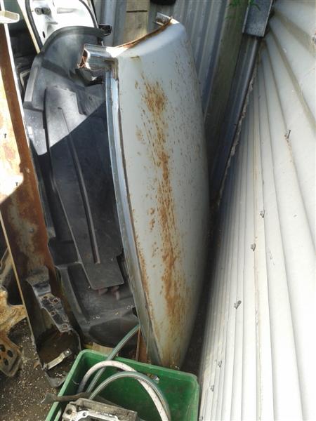

When I was looking for one I found one here, he wanted $1050.00 for it years ago, not sure if he still has it but it is still in the photo of bonnets.
http://www.sportscla...03&mid=43&aid=7
