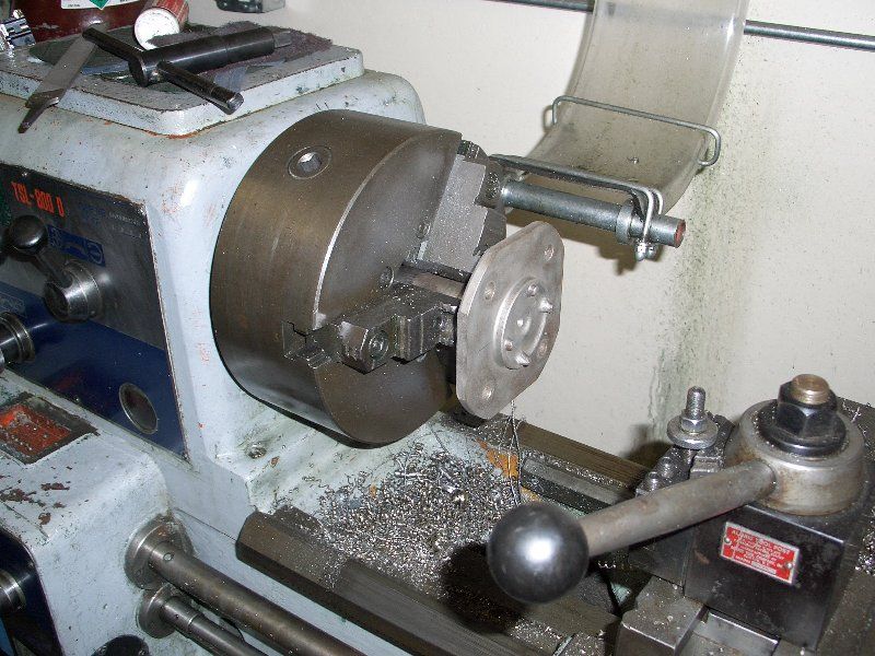

I would like to skim the flange faces of the stub axles (as shown) prior to final assembly. Has anyone done this and re-fitted the original wheel studs, and if so, were there any issues? Thanks

By original studs im going to assume you mean the ones that were fitted, that you have pushed out?
Yes, you can refit them, its not dangerous so long as they seat tightly.
Once you have the wheel bolted down and the nuts torqued up they wont move.
However, depending on how old they are, its probably just as easy to replace them with new ones.
You can get 'Nice' brand studs from most auto parts stores, usually around $4-6 a stud.
They can look it up in the listing or if they know what they are doing they can measure up your old studs and match them that way.

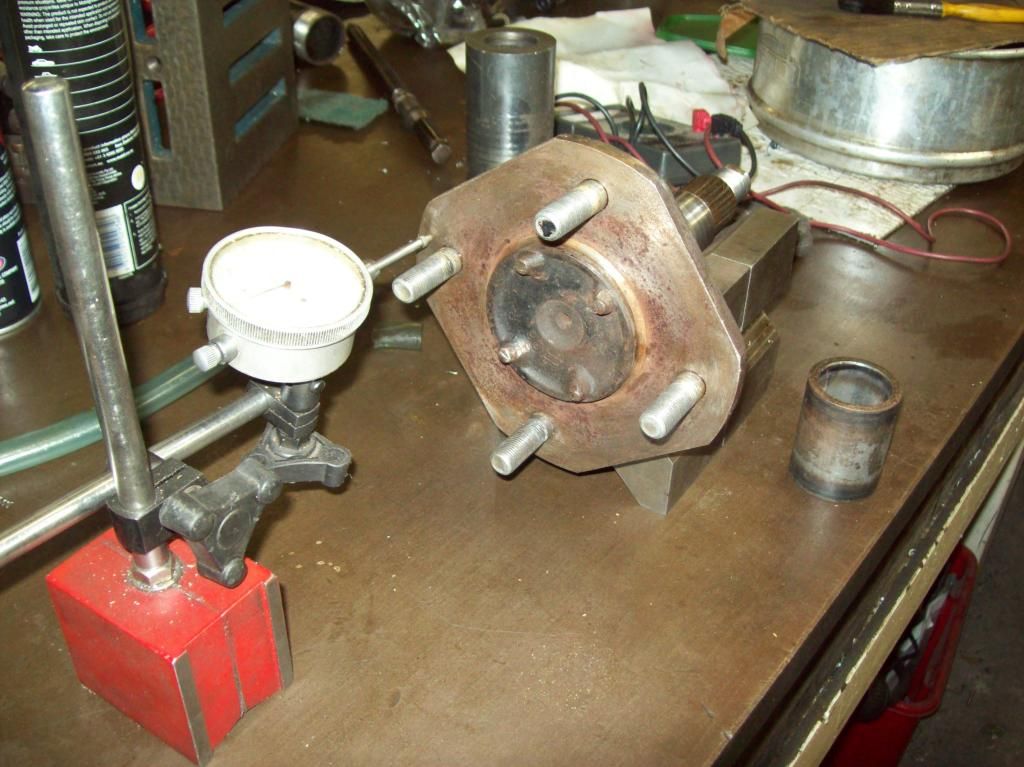

Thanks Alan. Before pressing the old studs out I ran a dial gauge over the flange face and it was perfectly true. No need for skimming at all, so bit of a false alarm. Fingers crossed the other side is the same.
