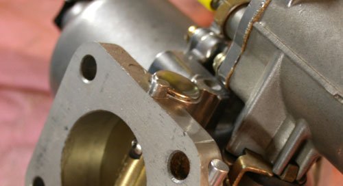

1. Roller Bearing Throttle Shafts. So this seems to be a big selling point for them. I'll send them an email and ask if they would sell these separate and I can then get a competent local machinist to help modify the carb bodies to accept them.
Does anyone however want to hazard a guess as to what type of bearings these are and what size is used or where to get them locally?
Not a great picture but here is a view.
Posted Image
See here: http://www.spannerhe...n-carbs-return/
I'm guessing they are a 'needle roller bearing' but unsure, since I've heard they have a rubber dust shield also.

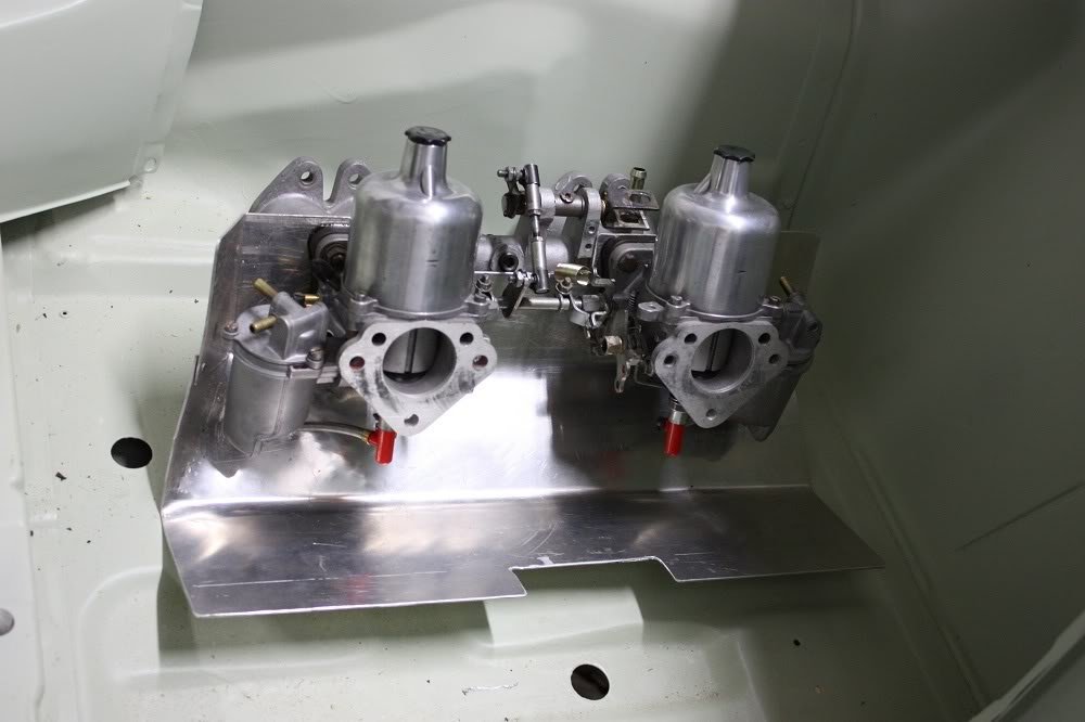

They really are about as basic as carbs get, very easy to rebuild. Here's my last pair :

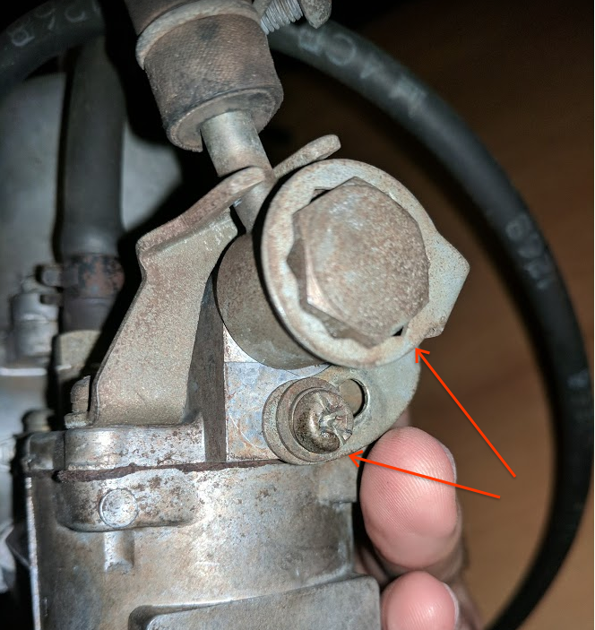

Just wondering if I did this wrong last night, but I started to disassemble 1 of my SU carb bodies and when I got to the needle I could not for the life of me remove it without bending it out of shape and despite my best efforts to not damage the needle surface itself (I wrapped it with cloth and used pliers to try and leverage it out) I damaged the needle surface (leaving teeth marks on it).
I did for the record remove the retaining screw on the side of the dashpot piston before attempting to remove it, but even with it removed it would not budge. In the end I got it out but not without damaging it. Just wondering if I overlooked something before I dismantle the other side.

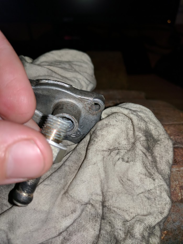

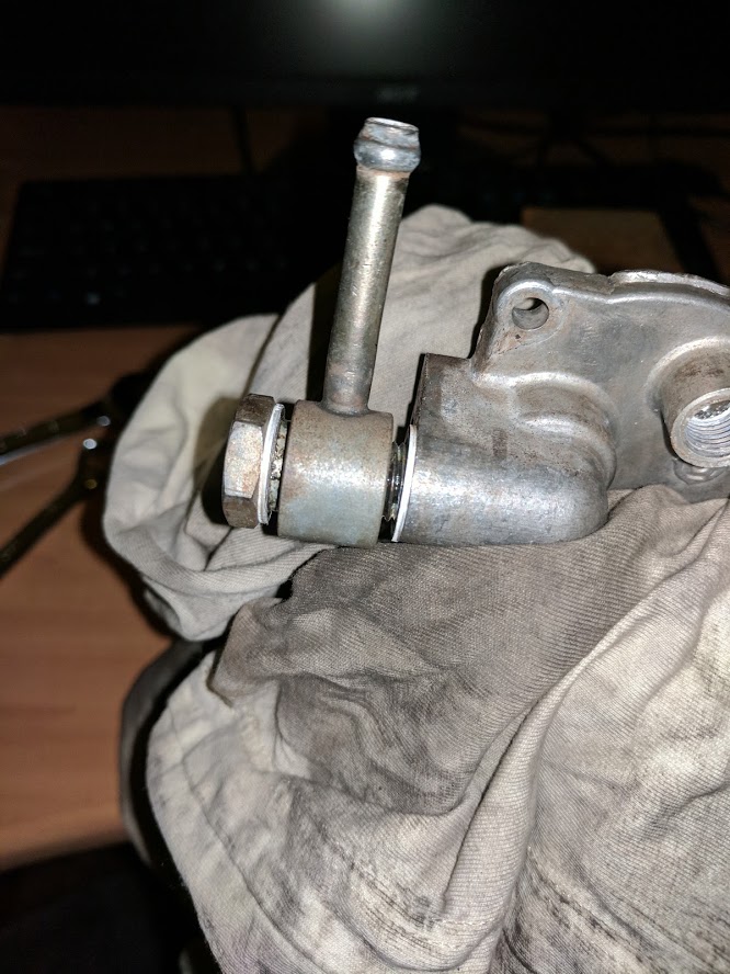

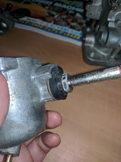

1. Is this rubber insulator / bushing for the float bowl available in rebuild kits? Or do I need to "save" it? Are they hard to find?

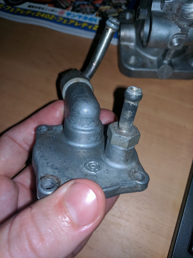

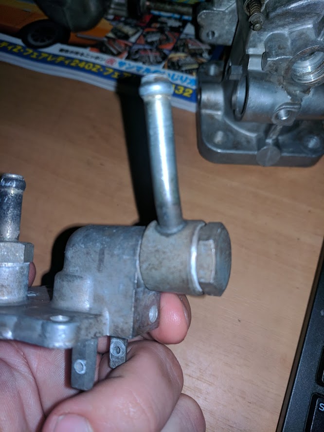

2. Float chamber lid, yellow passivate coating.

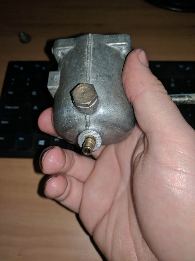

These 2 fittings are still attached to the float chamber lid, and are done up fairly tight. Any tips for removing without damaging the lid (in particular the float mounting tabs)?
3. Same problem on this float bowl plug. Thinking I might leave it. Seems to be done up tight enough that trying to undo it could cause damage to the bowl itself.
4. Replating parts (Sydney or anywhere in Australia). I want to re-plate everything if possible (that isn't alloy) on these carbs. That includes tiny springs like this, with a small e-clip and the pin it's connected to. How likely is it this will get lost? If so, where would I find replacements?

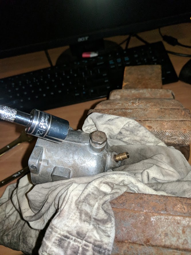

Posted 09 March 2018 - 09:18 PM
RE: #2 and #3. Using a vice with soft cloth wrapped around the fuel bowl and lid I managed to get these off with some gentle persuasion.
However I noticed I'm missing the locking bracket for the RH carb body (side closest to driver on rear of motor). Going to have to source 1.
