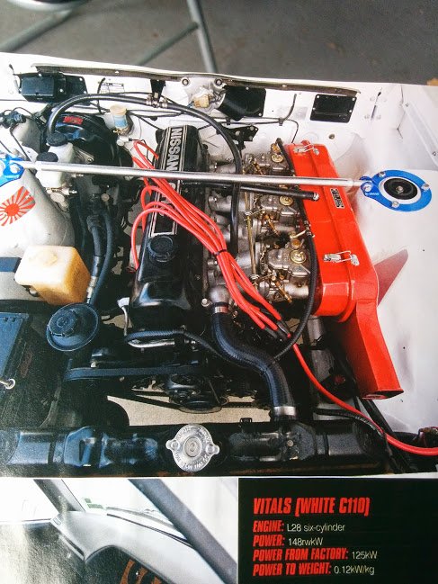

I was at Ash's shop today, Moorabbin Auto Spares and saw in 1 of the magazines this article.
Posted Image
Posted Image
Posted Image
But it's the last imagine here that piqued my interest.
Posted Image

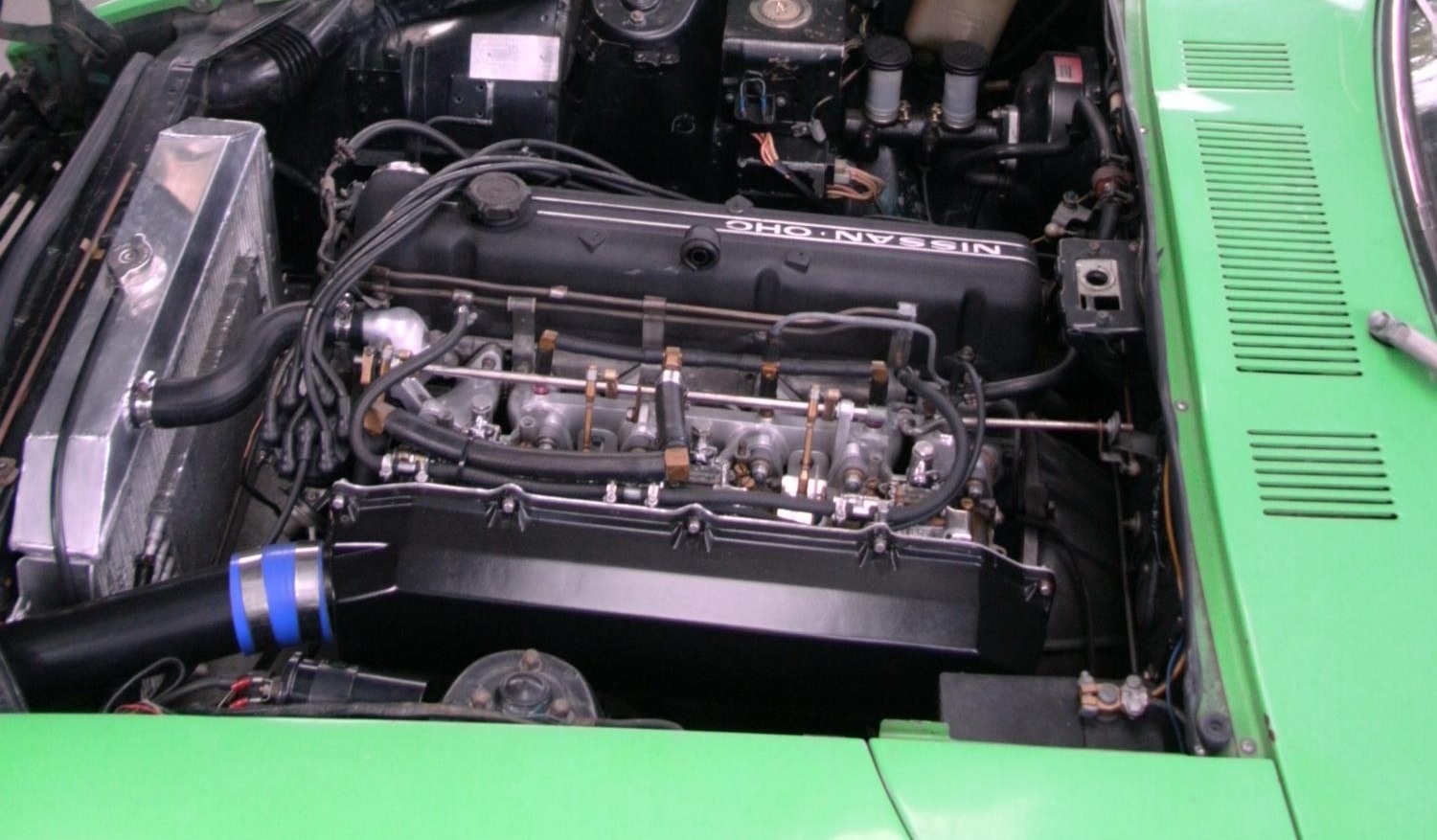

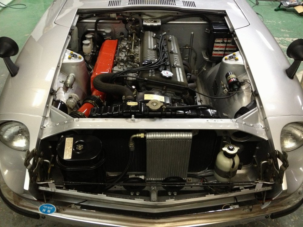

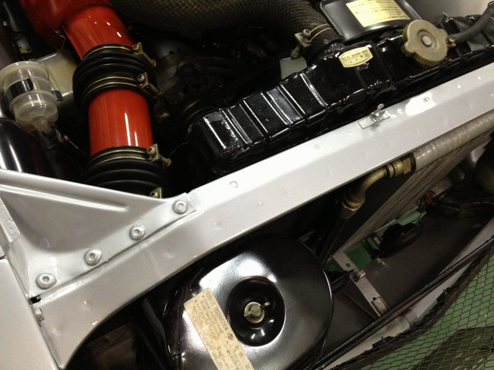

I thought it might be the Prince Skyline GT-B airbox.
Posted Image
But as you can see it's quite a bit more narrow than the 1 pictured in the C10 Sedan. So what airbox is it?

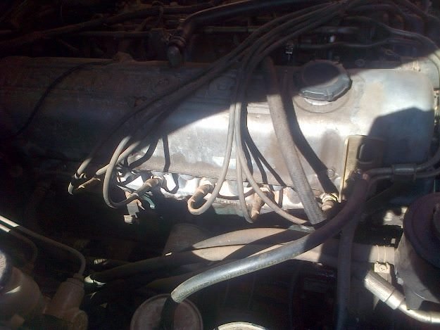

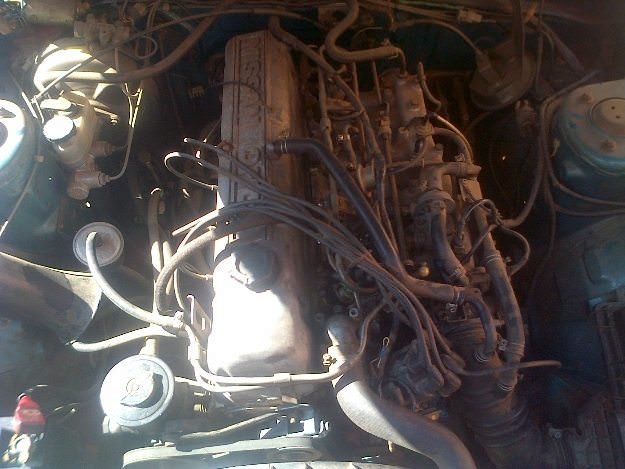

Thats a C110 sedan or a 'Yonmeri'. I be very interested in this sort of airbox aswell theres an outfit in the UK that do FRP/ CF airboxes for 6 cylinder engines equipped with weber type carbs.
That valve cover on the same car, underneath the spark plug leads there's a big OHC.
Did some searching on OLX (Seth African Gumtree?) on Laurels I've never seen this valve cover ever before, or heard of it.

That's ok, I've actually never seen the NISSAN OHC cover like that either. That's a first for me. Very rare.

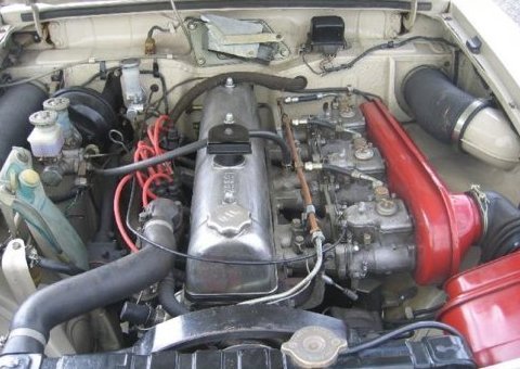

Yeah I've seen it before, I was actually looking at the 260z 'boat anchor' style airbox yesterday that Ash had lying around. You would need to cut it up a bit (remove the bottom flapper part) and extend it a bit further, but I thought it was a good starting place and once powder coated orange would look good.
http://www.sportscla...ge=P4230031.jpg
I figure someone might want to turf a 260z air box, since they seem undesirable and I wouldn't want to cut up a 240z box.

Actually filtration would be easy, just a small filter at the entry point of the airbox. The S20 airbox actually extends out in front of the radiator.
See this: http://www.geocities.jp/datsunz903/
Posted Image
Posted Image
So any kind of pod or K&N filter could work in there.

Gerry says it was a 260Z air box and "now that I remember it was built from one only, and the missing bits fabricated."
Thanks for that, yeah I thought it looked similar to the 260z style airbox. I figured it was better to start with that and modify to suit Triples. Rather than build the whole thing from scratch. I really like the clips on top of the airbox and of course the wing nuts that go on the side. They were a really well engineered piece in my opinion.
