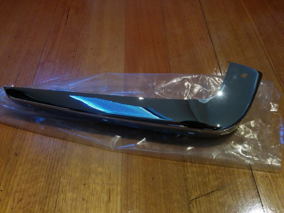

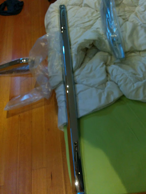

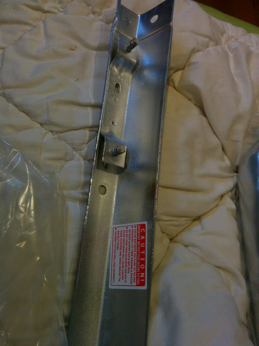

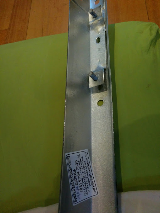

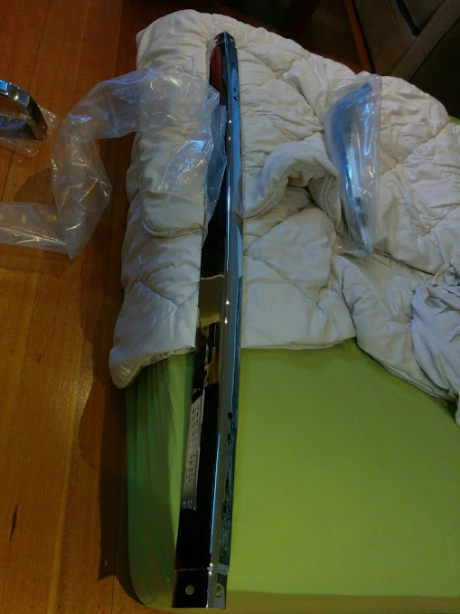

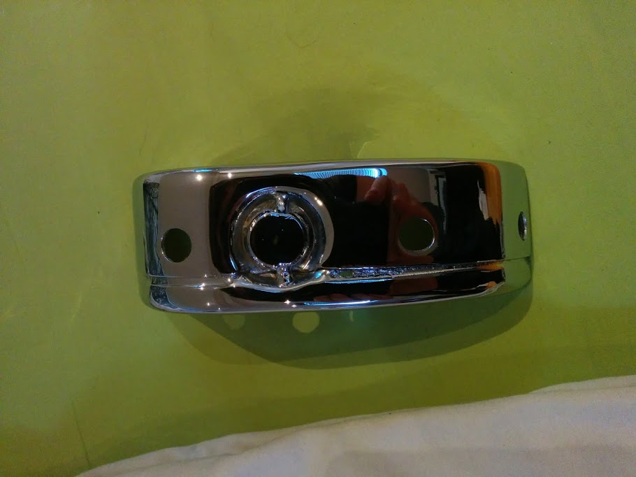

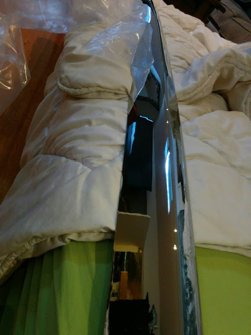

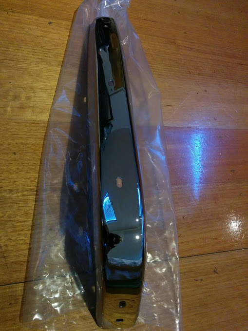

It's quite the challenge to capture the finish of Chrome with a camera, but hopefully these photos give you some idea.

Looks good Gav, might try sending them a front bar and see how it comes up. Do you know if they can fill holes in the bar? Cheers

Don't see why they couldn't. But sure ask them first.

Yes they have repair service as well as rechrome
