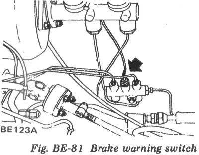

In the engine bay, after the brake pressure differentiation switch ( this brings up the red brake fail light) there is a rear line factory fixed pressure reduction valve, these can get a bit sticky, and allw more rear pressure to go to rears, causing rear lck up.
Fit, in place, a screw in/out type line pressure reducer, then have an bserver stand by on a "private" road, and do hard brake stops, screw it OUT at each try, this will bit by bit reduce rear line pressure, and stop rear lckup.
Is this what you're referring to?

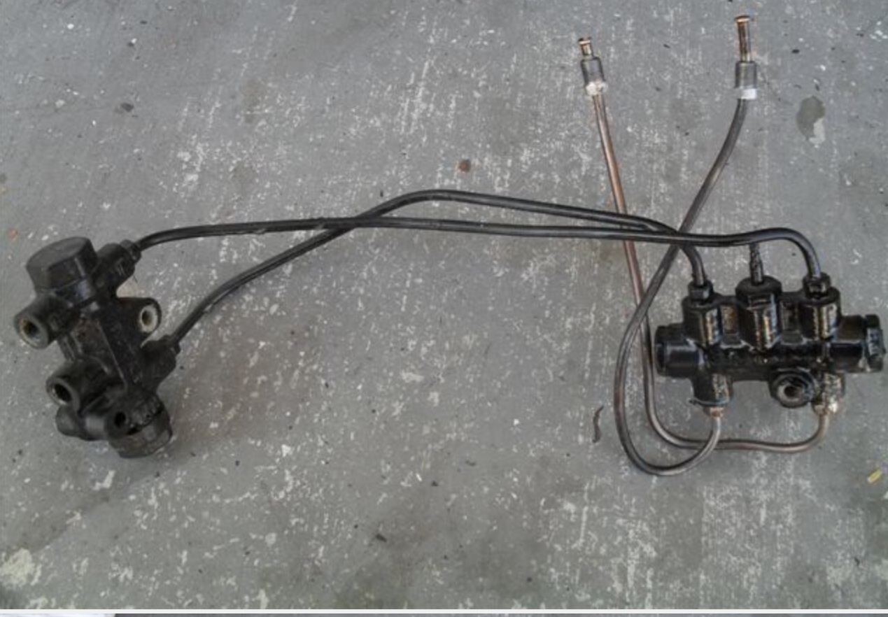

Posted Image
More likely the other valve in this picture is what is being referred to.
