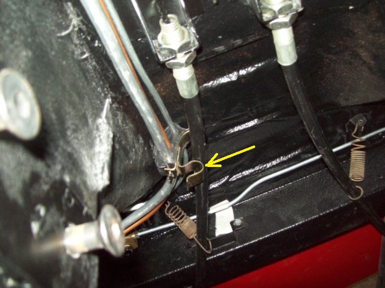

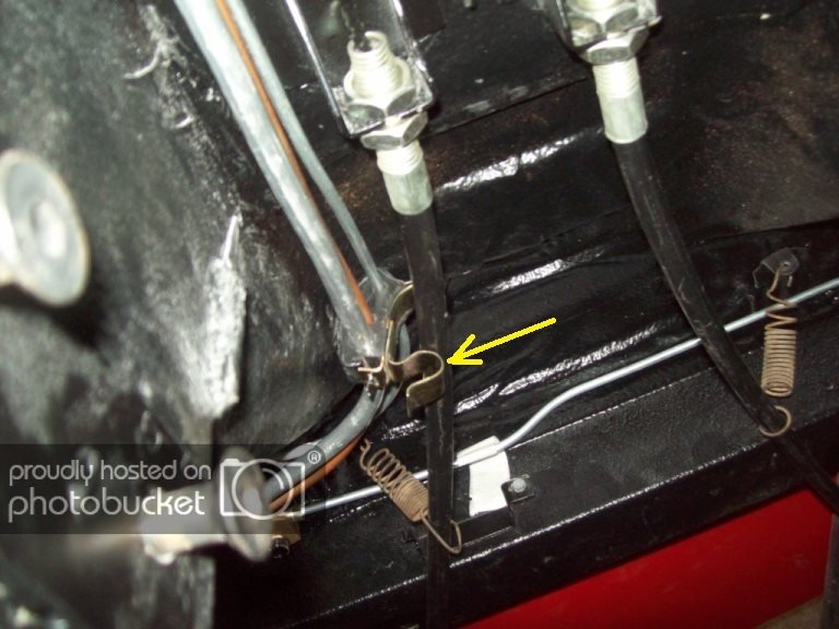

Just fitting the Woza handbrake cable for the Wilwoods and noticed how close one cable passes to a little hook on the clamp used to secure the fuel and brake line along the transmission tunnel. Is the standard cable supposed to pass through the hook?

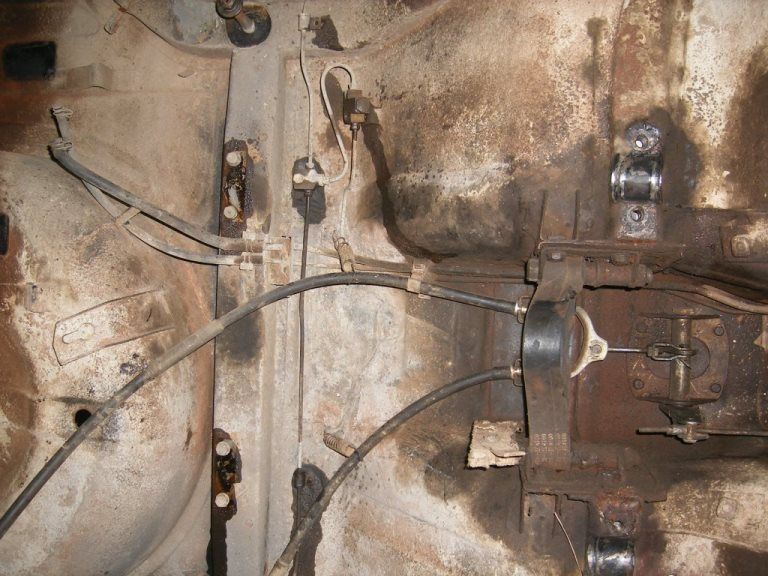

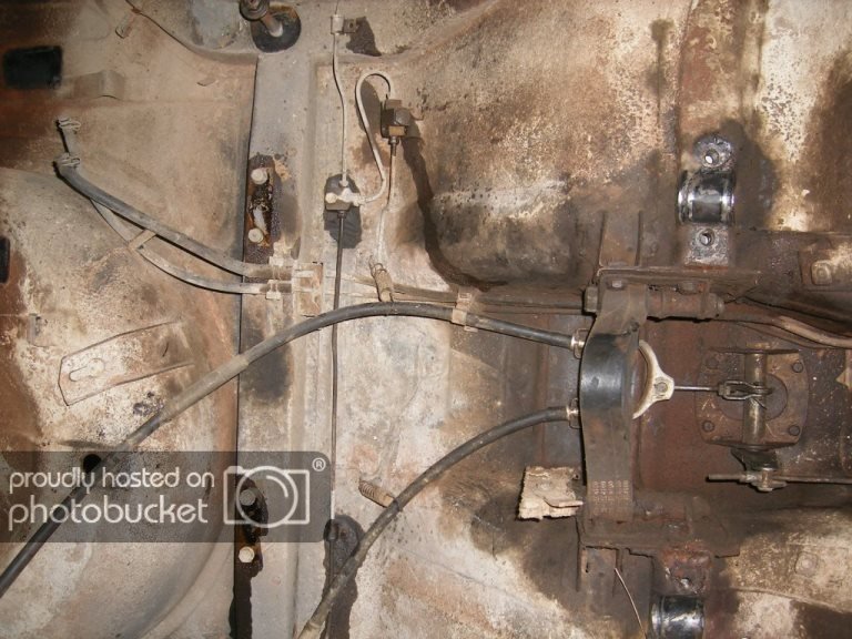

Posted 20 December 2014 - 03:28 PM
To answer my own question... I've just found this photo I took years ago when I first stripped it down.
Posted Image
A lesson there to anyone doing a rebuild - photograph and document the disassembly, you never know how long it might be before it's screwed back together.

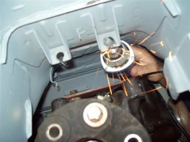

Posted 17 March 2015 - 09:27 PM
Mine was just the opposite. I had to grind the mount out to the larger 260Z dia.
