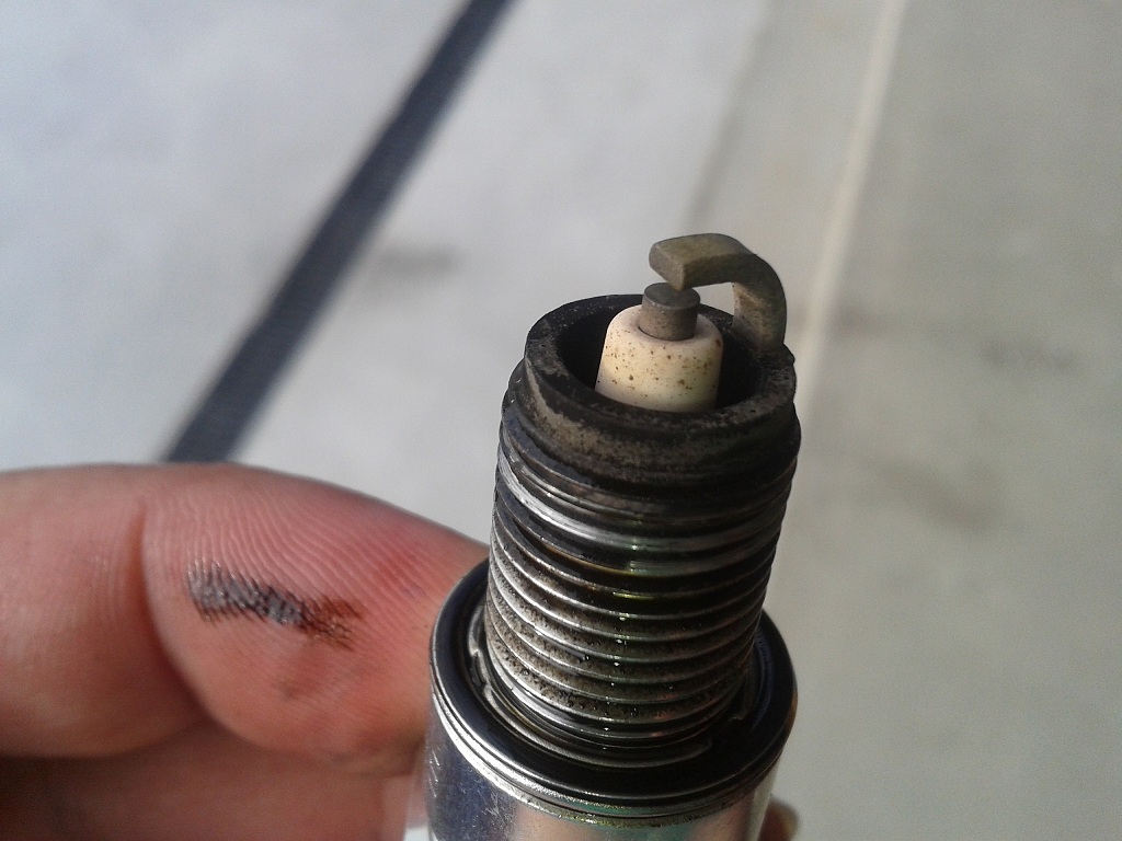

WogsRus Posted December 17, 2014 Author Share Posted December 17, 2014 Ok so i did a bit of fiddling and so forth, did timing and fuel etc etc to get it to where i think its ok. Here is the two plugs i took out after a drive, taken from number 2 and 5 cylinder counting from front to back of motor. Cylinders does not seam to ping, but hard to hear over exhaust. I think black/brown dots is BAD no? Let me know your thoughts Quote Link to comment Share on other sites More sharing options...

Enzo Posted December 17, 2014 Share Posted December 17, 2014 Hi, The bottom pictured plug is running leaner than the top plug. You should richen it up. A colour tune kit comes in handy for this. Also I noticed that you say you have trouble reving to 8000rpm. ( Bit of overkill for a street car). With a points distributor you may be experiencing point bounce as well with the higher revs. Combined with the leaner carb, it could be causing the miss. I would set the dissy to about 16 degrees BTDC with the vacuum disconnected and set all in timing no higher than 34 degrees. You will have to modify the dissy to limit mechanical advance for this. 16 degrees initial +18 degrees mechanical =34 degrees total. A reasonable starting point. David Quote Link to comment Share on other sites More sharing options...
WogsRus Posted December 17, 2014 Author Share Posted December 17, 2014 Thanks heaps will do, also some cooler plugs maybe? BP7ES ? Quote Link to comment Share on other sites More sharing options...
