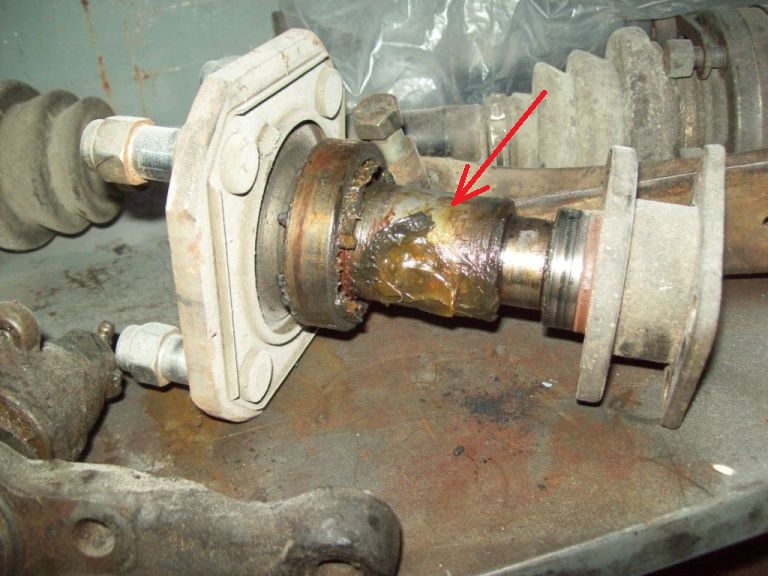

Sleeve between inners of races, supports the stub.
That's an after-market collar on the front stubs that I'll be making but I was referring to the OEM spacer on the rear.
Are the spacers different dimensions?...
Yes, but I can't remember if they are colour coded to individual bearing housings or there is some number matching. Anyone know?

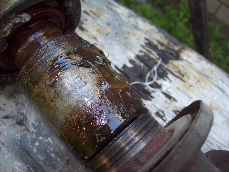

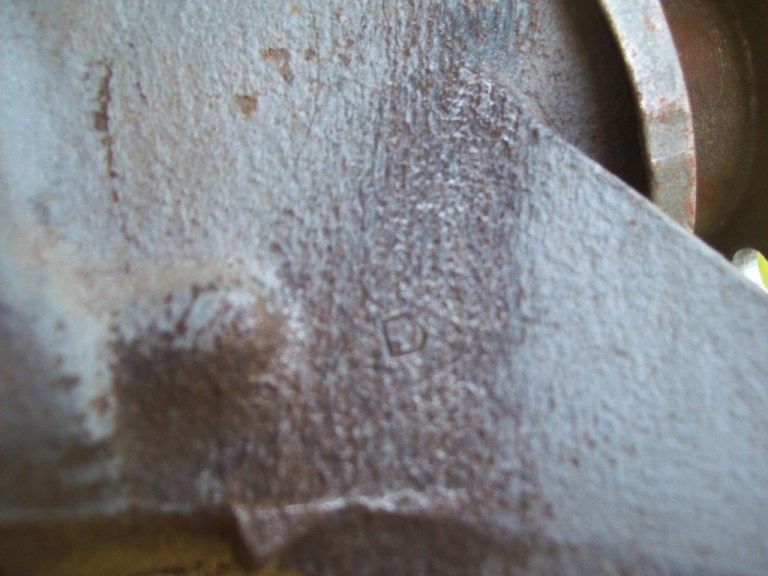

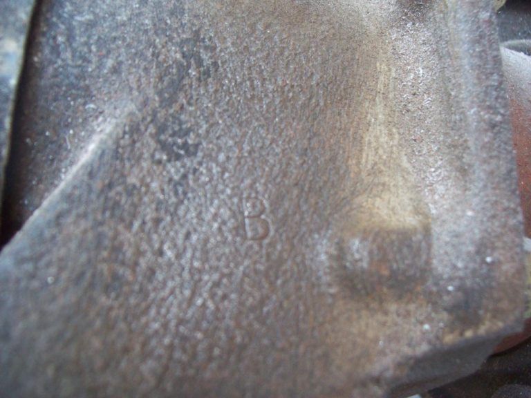

Thanks for the input and offers but I have to admit I've done the most unmanly thing of all and read the instructions!
David you are correct they are lettered but there are 3 options A, B or C.
It all started well when i wiped away the grease on a spacer and could see this.
Posted Image
Then panic set in again when I hit the bearing housing with a wire brush and this is what I could see.
Posted Image
The other housing was a bit more reassuring.
Posted Image
I'm thinking the 'D' is just a poor stamping of 'B' but I'm not convinced

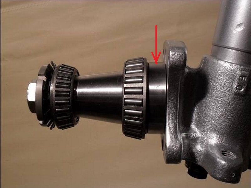

I can't quite follow. Is this a second collar and, if so, does it require a different seal? The surface finish looks too rough to mate effectively with a seal...!

#12 PeterAllen
PeterAllen
  • 1,340 posts
  • Location:Sydney
  • Tagline:Manana!
Posted 08 December 2014 - 06:01 PM
Thanks for confirming that Peter.
So what the hell is the"D"?
