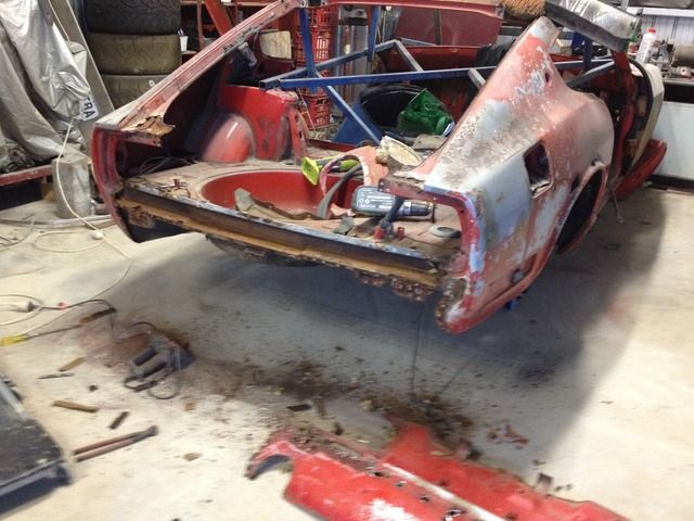

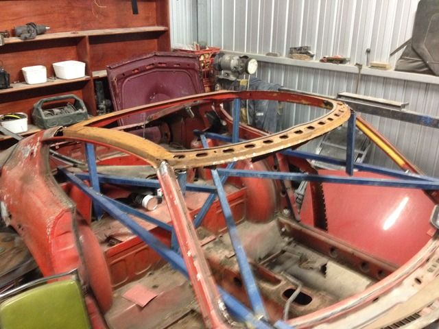

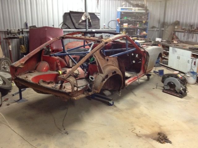

Some progress pics

You ripped that roof turret off quick, shame you didn't take more photos of the process and where all the spot welds are, that rear beaver panel area looks shagged.
Do you have another piece or was it bent bad?
#26 zzzzed
zzzzed
  • 2,691 posts
  • Location:south australia
Posted 24 March 2015 - 09:56 PM
Yeh the roof skin only took about 2 hours to remove.
I have removed about 4 now so it's not hard at all for me
If you want I can take closer pics of the rails where the spot welds are.
The rear beaver is pretty much shagged. It's full of bog and rust
So unless I can find some one who sells new ones then I will be fabricating a
New one.

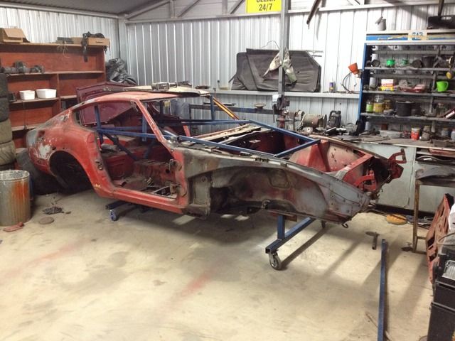

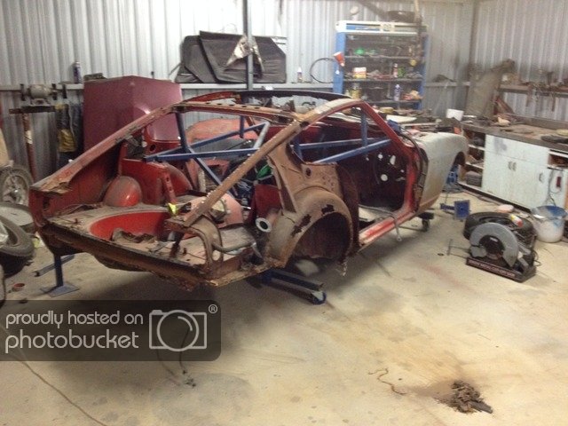

Tonight's effort.

And that kids is what free rust looks like, how many S30z's are stripped down to this level when restored? Not many...

It's the only way to do it when a car has as much rust as this one

Pretty sure Tabco sells wheel houses also, looks like you need at least 1 for drivers side :).
I'm guessing she's off to the blasters once the other 1/4 panel is off?
#38 zzzzed
zzzzed
  • 2,691 posts
Posted 27 March 2015 - 10:06 AM
Brush on some rust kill and it's good as new  :P
Yeh it's off to the blasters shortly
