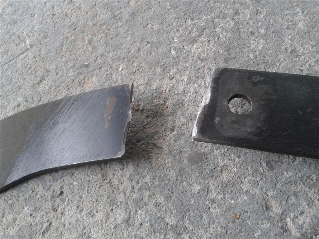

Scoota G Posted September 28, 2014 Share Posted September 28, 2014 Funny story i actually snapped my moustache bar on friday. It snapped about 50mm from the left bolt. I'll post upsome photos soon. Quote Link to comment Share on other sites More sharing options...

Scoota G Posted September 28, 2014 Share Posted September 28, 2014 Here's the one in question! Quote Link to comment Share on other sites More sharing options...
dat240z Posted September 28, 2014 Share Posted September 28, 2014 I wouldnt be trying to weld that one together!! Quote Link to comment Share on other sites More sharing options...
DAT392 Posted September 28, 2014 Author Share Posted September 28, 2014 Wow scoota similar to mine.I think they just cant handle the torque after years of abuse.After examining the one i broke it looks like the reinforcing was done because it had a crack and was patched then painted.I should have stuck with the cars original bar and maybe it would have lived a bit longer.Anyway hope I have better luck with the arizona zcar one.Should arrive this morning. Quote Link to comment Share on other sites More sharing options...
