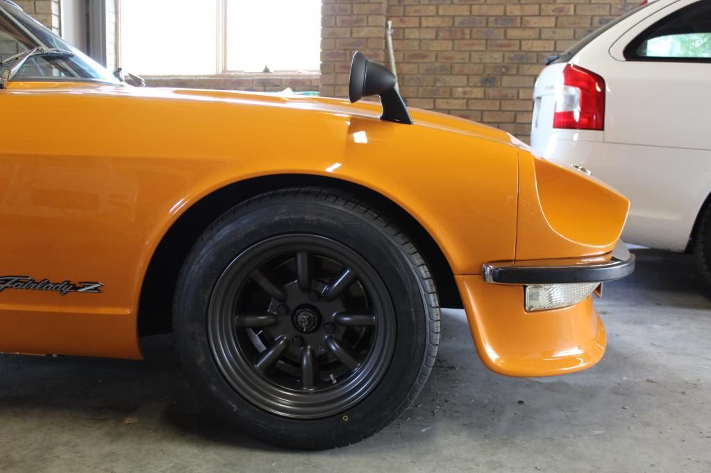

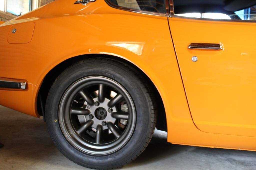

Spoken to Locky about this and i may have to head down to see him for some advice but just thought I'd see if anyone else has the same shocks and or issue, I've just installed some koni yellows 8641-1060(300zx) with 24mm sectioned struts front and rear with 175 and 200 pound eibach springs (coilovers) and factory isolators. The issue I have is there is hardly anyone bump travel, probably 1 inch front and a fraction more in the rear, the car isn't ultra low compared to others I've seen so I'm not sure whats wrong here?

Mossy, are you actually bottoming out when you drive?

I've really only taken it around the block Roberto (didn't bottom out), I plan to go for a drive on saturday to test it out more but from what I've read you should have a minimum of around 50mm travel.

To test I place a cable tie around the shock shaft and go for a drive; that'll show you its highest amount of travel. You could remove some of the bump stop to gain a tad more travel.

Did that Dimitri went for a quick drive down the street and the cable tie was at the bumpstop.

Yeah i agree with your bump stops being way too big. My coilovers run 10mm ones for this reason. You want to run at least 50mm of travel, especially with that spring rate and if you run a better bump stop you will be close to getting that. I'm running 325lbs fronts and i have 55mm of bump travel. Is your strut sitting all the way up in your strut tube? Have you wound the spring perch way down? If so, maybe you haven't taken enough out of your strut casing.

No more can be taken out of the front struts Jake, 24mm was it due to the length of the 300zx inserts. Looks like I need more sectioning of the front and rear struts, maybe another inch which means finding some ae92 corolla inserts for the fronts, rears have spacers so I can still use them.

Maybe try cutting the bump stops down first. Another thing  you can do is run a pillow ball top mount on the front which will make the car another 20mm lower and then wind the spring up the perch a bit.
