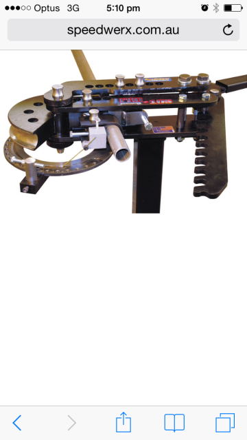

I am quite confident that I can so a top quality cage my self. I am no stranger fabrication as it is a big part oft every day job. All I need is the correct tools for the job.
My next question is
Has any one seen these benders in action. I have heard they will do the job but am unsure.

Rod Andrews (Andrews Race Cars ) uses a machine similar to the above. His is a J2 or something. Pulls clean bends. Problem is the machine aint to expensive, its the dies. Prob $1600 to set up for one size. $400 for each die after.
to get the main hoop and front legs tight takes experience. Worth buying a kit that has legs and hoop done then just cut and notch the rest.
My last bundle of steel cost about $700 and came with necessary paperwork.

Posted 19 August 2014 - 09:14 PM
I guess once you factor in the price of the steel on top of the machine, a bond cage is actually cheaper
