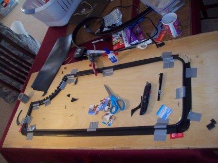

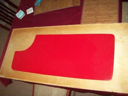

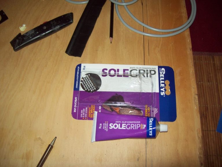

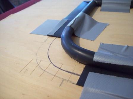

Sorry, I should have followed up on this earlier. Thanks for the suggestions, I bought 4 products for testing
Someone put me on to Loctite 406. On my test pieces it was outstanding, far superior to the normal super glues. They claim you make O rings to size by joining ends with this stuff... I believe 'em.
I've been able to make up a seal for my bootlid.
