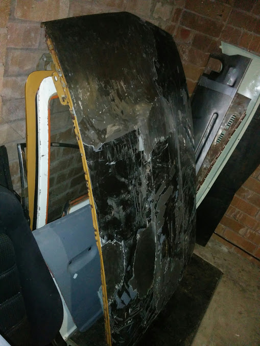

The bonnet that came with the Safari Gold (1970 model 240z) has had a bit of a mishap. As can be seen here:
The problem with many Z bonnets I see is that they have all had a slight (or sometimes slightly harder) knock at the front. Often I see this repaired but not to the standard I like.

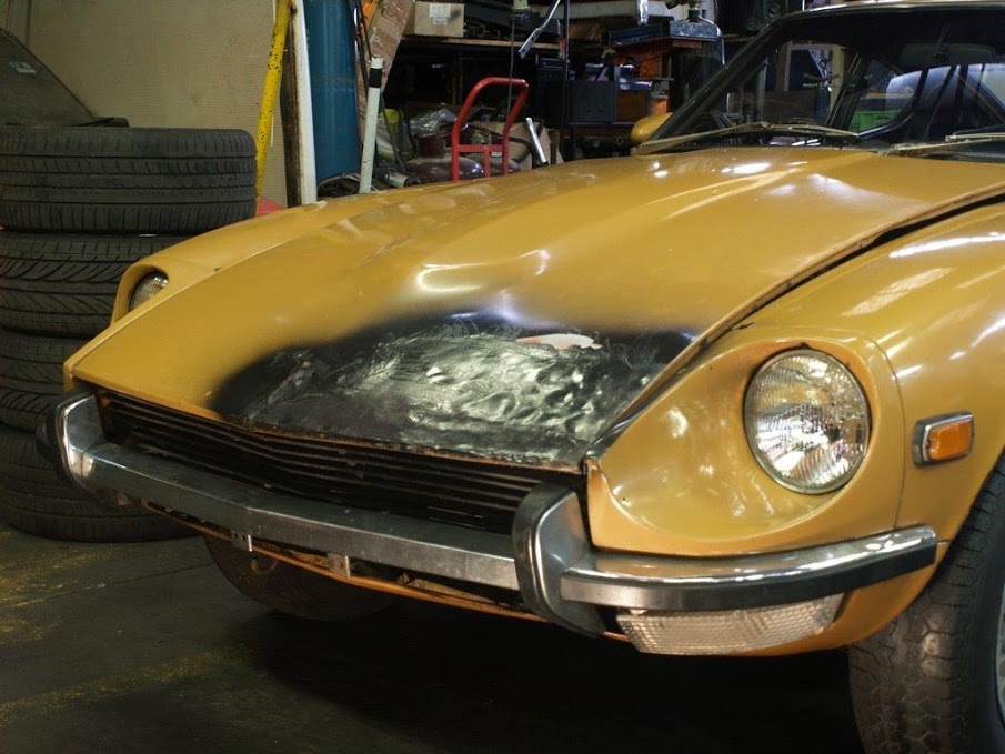

Here is an example (admittedly not the best) of my 72 240z - when it had an earlier non-fluted bonnet, which had been modified with E-Type style slat flutes in it.
You might not be able to see very clearly but there is a slight 'droop' in the line at the front of the car - it had been previously repaired after a slightly knock at the front. (This bonnet has since been replaced with the later fluted bonnet below).
Note how it sharpens the front of the car up? There is a very defining line at the front of the bonnet that is often lost when repaired incorrectly.
The reason for the poor repair is often due to access to the front part of the bonnet. The frame itself makes it nearly impossible to beat it into correct shape from behind. So instead you need to reply on body filler and using a slide hammer or similar to pull the dents out of the front of the bonnet. Which is less than ideal.

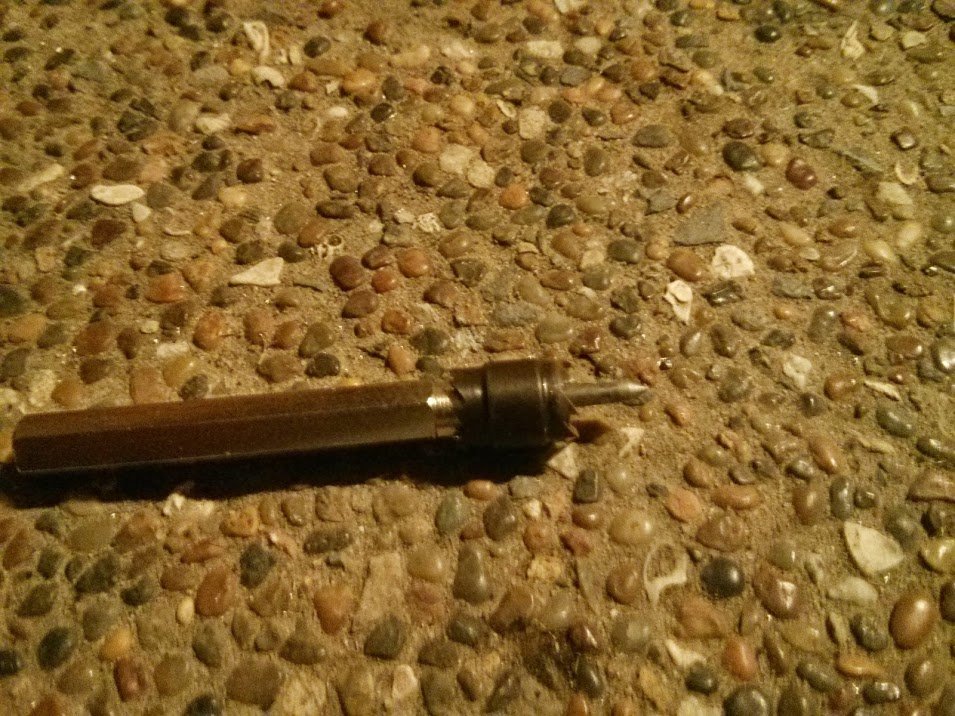

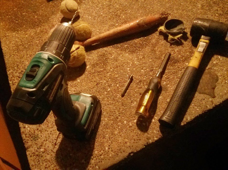

To start, here is the basic tools I'm using.
1. Basic multi-speed hand drill
2. Thin Sharp Chisel
3. Hammer - doesn't have to be a soft rubber mallet as pictured.
4. Spot Weld Cutter (see pic below)
I got my spot weld cutters from eBay store http://stores.ebay.com.au/ozmestore1
http://stores.ebay.c...d&submit=Search
The actual drill attachment you only need 1 of, but you can get the cutters separately and when they go blunt just throw them out and replace with another 1. I ordered a bunch at the same time since I'll be undoing a few spot welds.

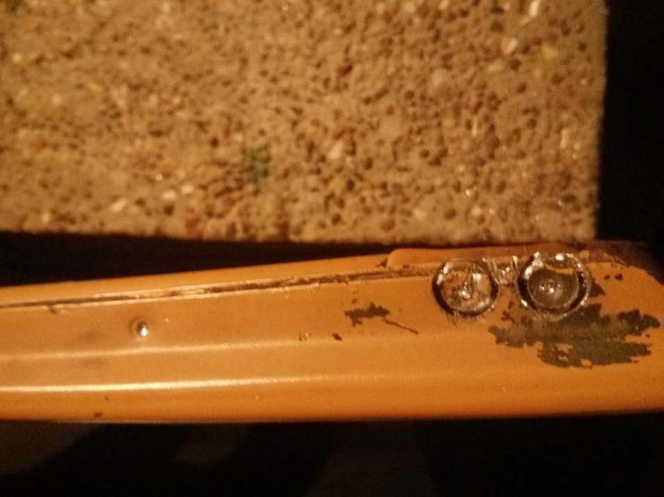

Cutting out spot welds.

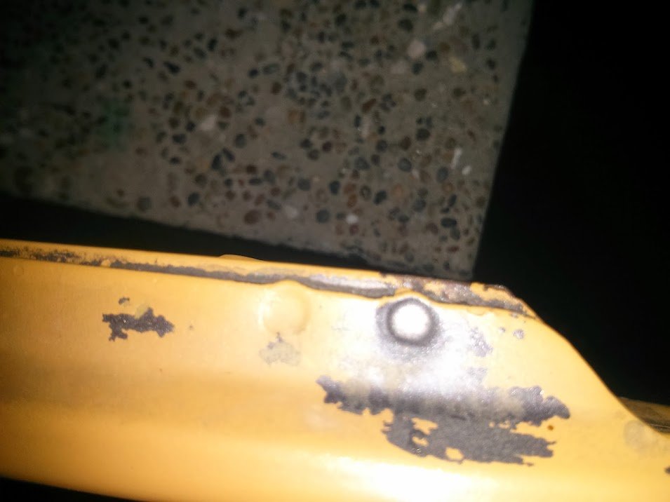

Along the edges of the bonnet is a bunch of spot welds like this.
It might be hard to find them if there is rust, paint, crap covering them. So look carefully to make sure you know where they are.
Start by drilling a small pilot hole in the middle of the spot weld. Then once you've started the pilot hole you'll put the spot weld cutter locator into the middle of this and start to slowly drill.
The idea, is to cut the top skin layer around the spot weld, freeing up the skin from the frame. As far as I can tell the spot welds on the skin are under the front of the bonnet and along the edges and the rear has a lip folded over the frame.

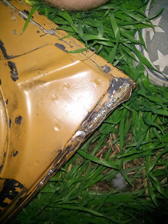

Unfolding lip
I put the bonnet on the grass to prevent damaging the skin or denting it anywhere else.
Using a screwdriver I slowly start to undo the fold at the rear, gradually lifting it up as you go along the rear edge of the bonnet.

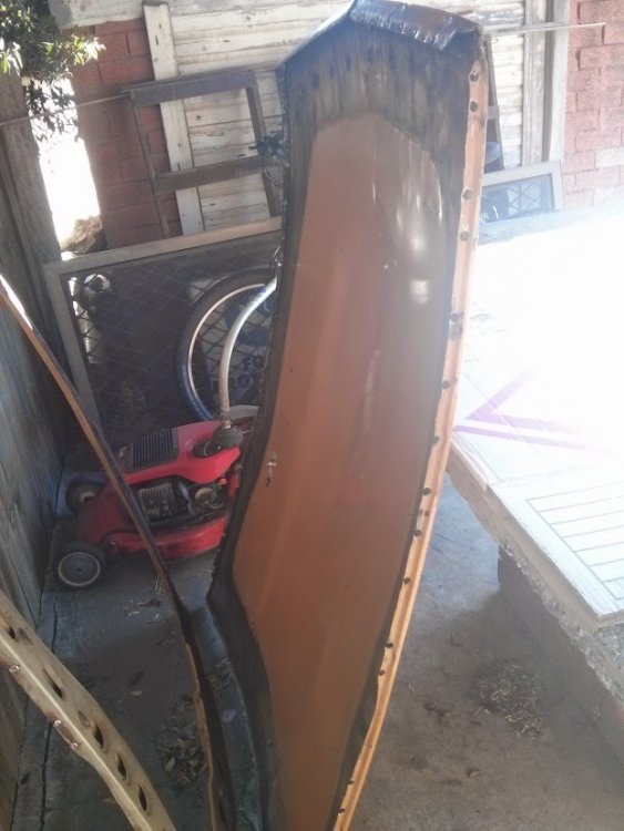

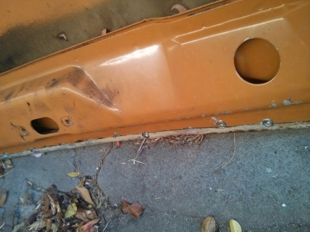

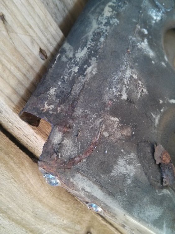

So apart from removing the spot welds along the sides of the bonnet, I also discovered after racking my brains for a few minutes that there is a few 'hidden' ones at the top (the end near the driver) of the bonnet also.
So that's along the sides, at the front under the fold part (where the grill is) and at the rear where the folded lip is. These are by far the hardest to spot (as I discovered).
Posted Image

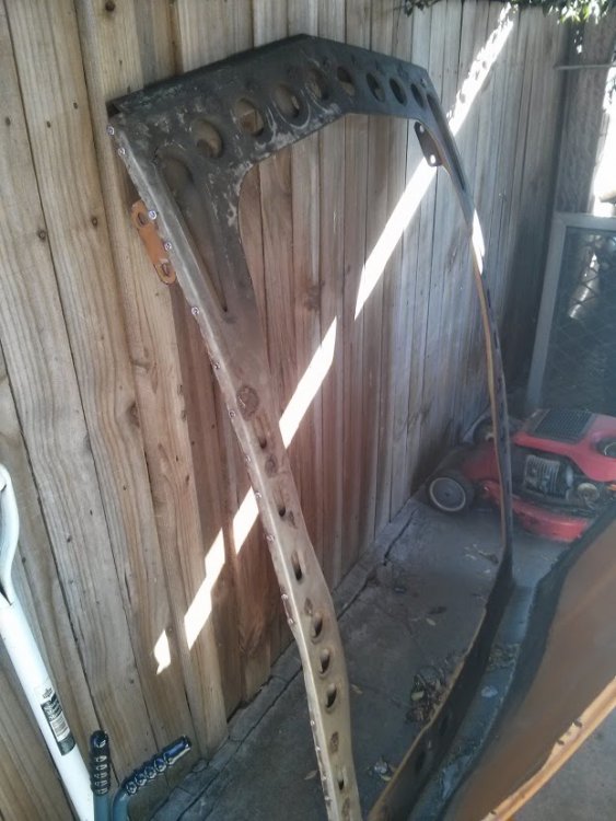

Separation after that point is relatively straight forward. The frame looks like this.
Posted Image
Skin like this:
Posted Image
The frame is relatively straight, to my surprise I expected to find it bent (from the surface damage) but it was actually pretty straight. Just the top right edge is slightly bent.
https://lh4.googleus...1_=w623-h830-no
Ignore the oily residue (probably from the engine / oil breather?)
To my pleasant surprise the bonnet has almost 0 rust, there is some surface rust here and there etc.. But it's relatively solid - even where it took the hit. I did notice about half-way down the bonnet though on the underside is a bit of a ripple (perhaps from some form of dent?) on the top side it's not obvious, but there is some cracked paint (yep the bog monster nikki*).
Posted Image
I guess just another example of the previous panel master using bog instead of a dolly and hammer  ;D - Each time I find this stuff I'm like this.
* The guys at the tafe course kept referring to filler as 'nikki' and I thought it was quite funny - you know just a nickname. Till I discovered there is a product called nikki.
http://www.paintandp...-a-new-concept1
To be honest after finding the frame isn't that bad and very little rust, I was thinking to myself I really didn't need to separate the skin and frame, but I don't know how I could possibly get the damage out to a level I'd be happy with if I left them together. I guess my tafe course teachers probably would have had some techniques - but at least now it will be easier with access to the rear.
I don't know if it's better to patch the metal that is there and re-shape it, or create a new section and weld it in? Alternatively someone might have a bonnet that is damaged on the driver side in which case I'd be interested in making 1 good bonnet out of the 2?

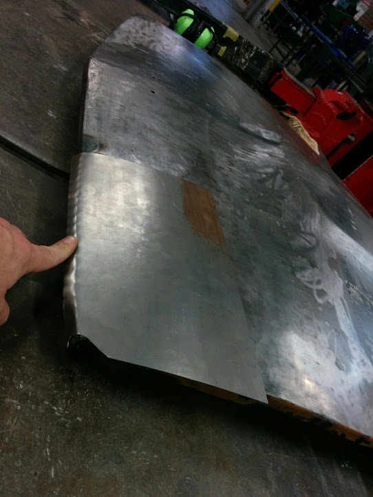

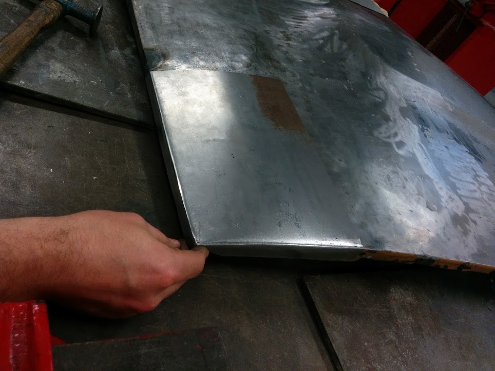

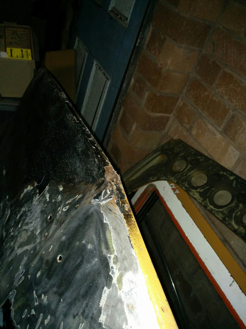

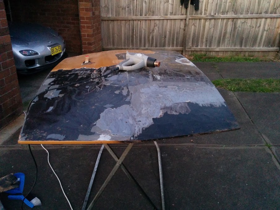

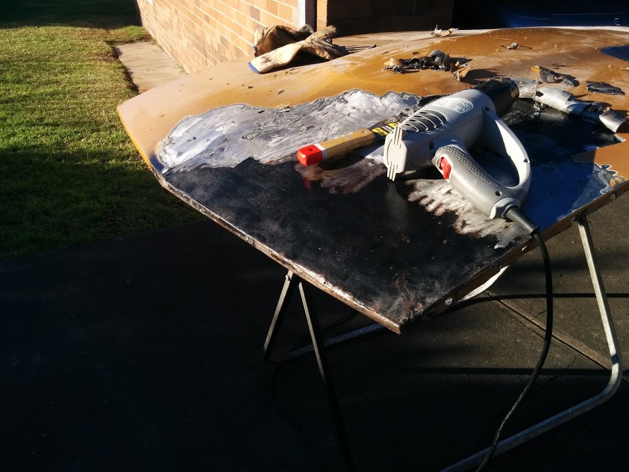

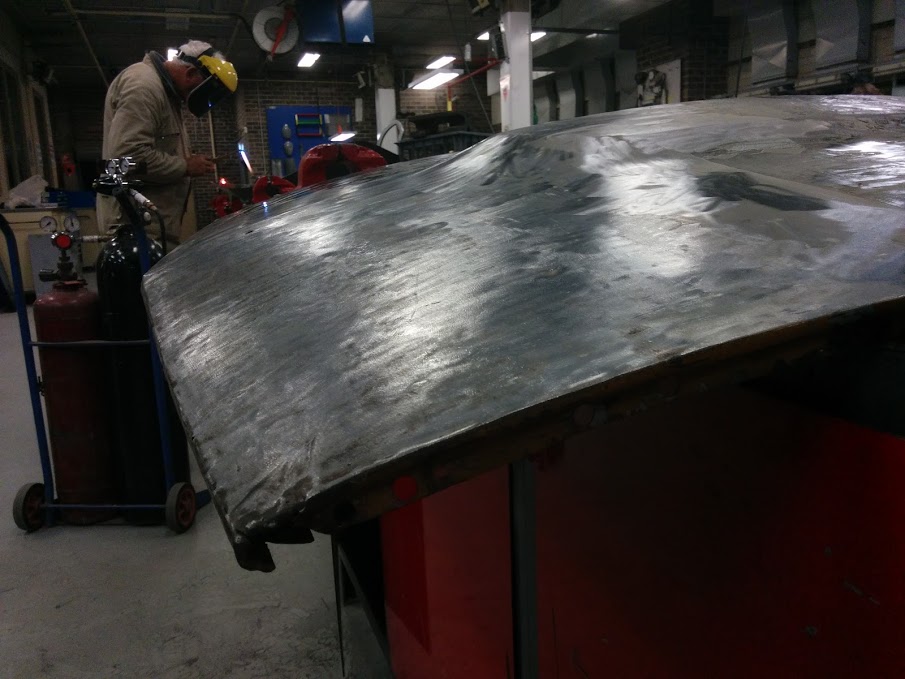

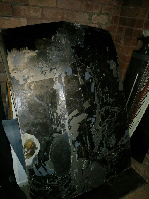

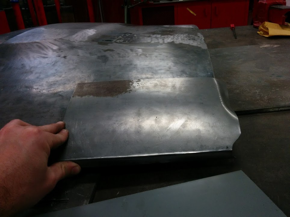

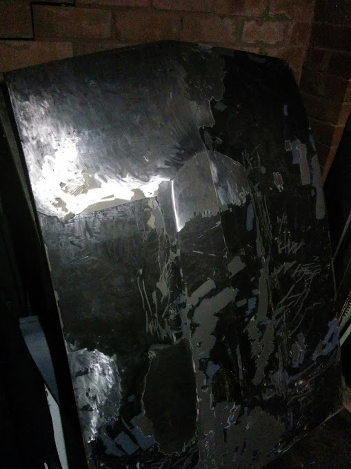

So last week at my tafe course I started to hammer and dolly the bent area of the bonnet. However as I was trying to beat it into shape I discovered quite a thick layer of bog/filler and this made it hard to know exactly where I needed to hammer up the bonnet to get the right profile.
So I spent the afternoon stripping the old paint using a heat gun because it's likely the paint was lead based and I didn't want lead dust going everywhere using mechanical action, I considered paint stripper but it's messy and I wasn't fond of using chemicals while my dog was around me watching on.
I wore a mask because the paint does burn and you can get fumes, which again isn't ideal so I tried to avoid breathing any of that crap in. It's still got a small layer of filler on there, but I'll use a 'seaweed' wheel to strip all that gunk off.
You can see I made a template or profile of the bonnet from the other side to see how far up the left hand corner needs to come compared to the right hand (driver side) where I got the profile from.
I only found a couple of other minor dents that had been filled in with body filler but thankfully NO rust! Except minor surface rust.

Here is the profile/template, hard to photograph the gap but it doesn't sit flush on the left hand side. Compared with the right.

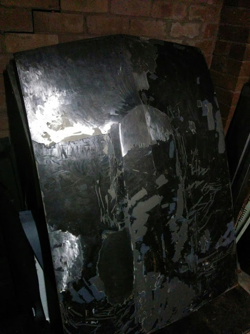

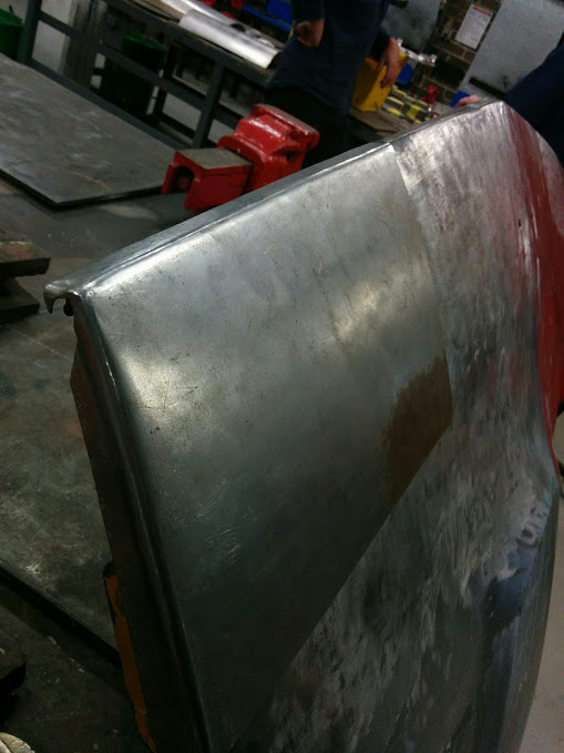

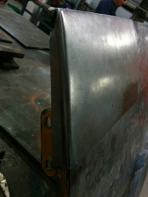

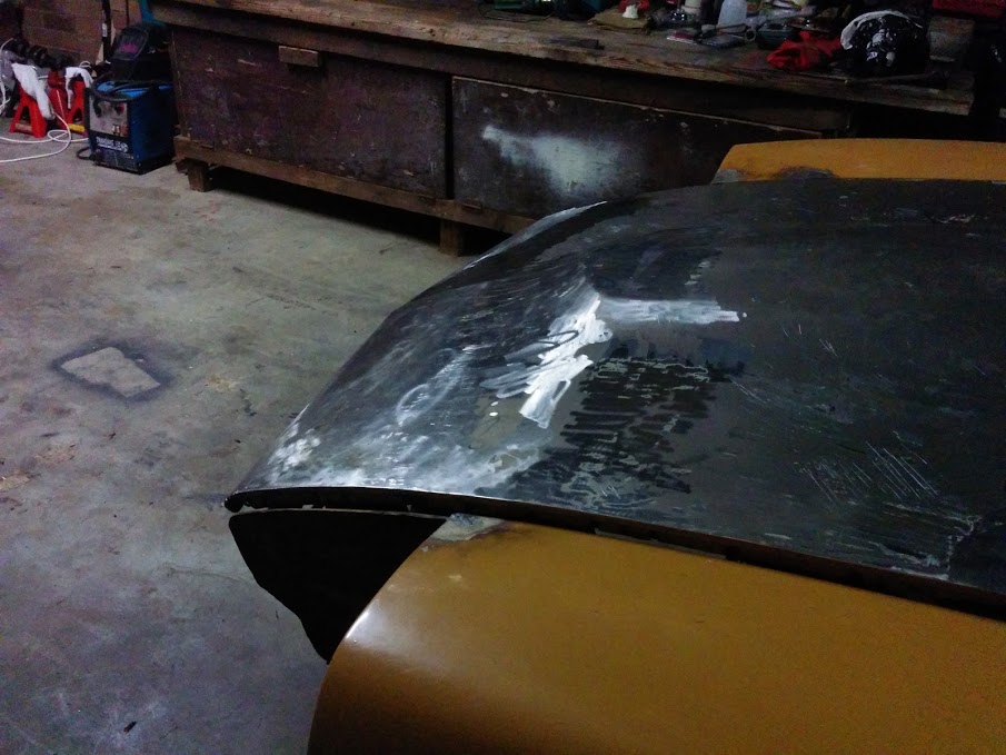

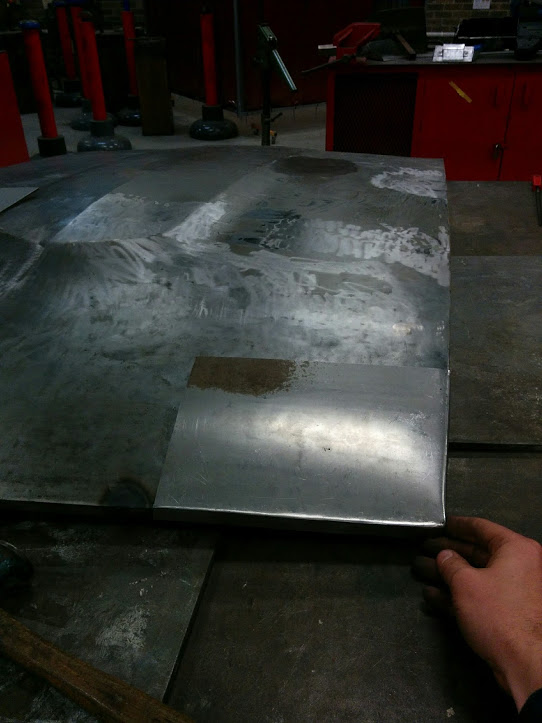

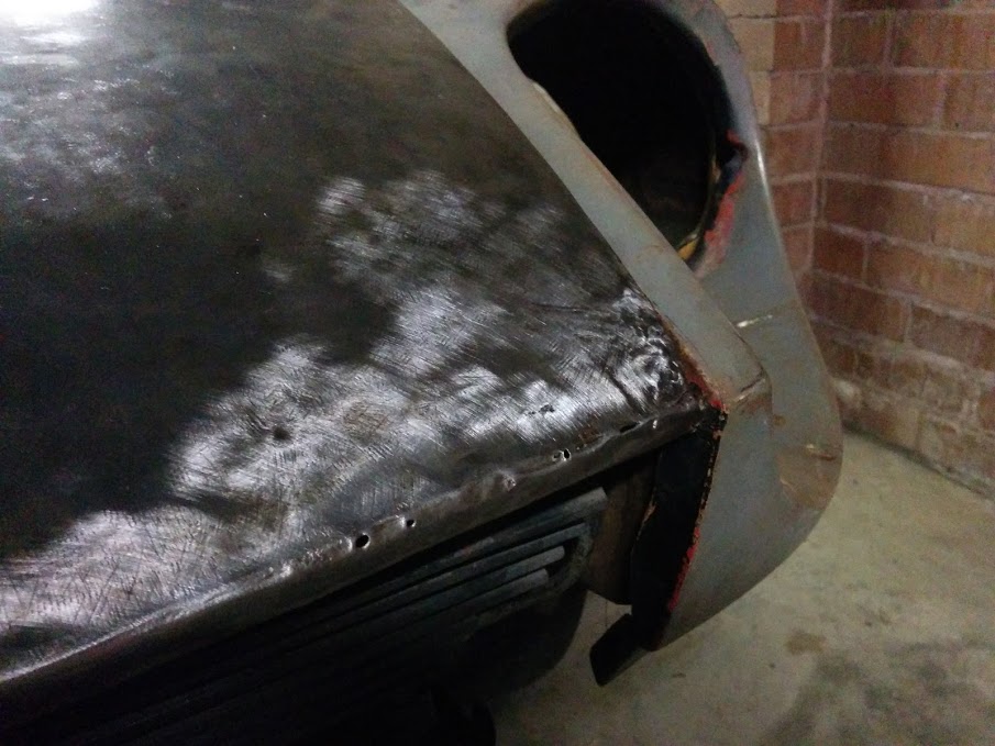

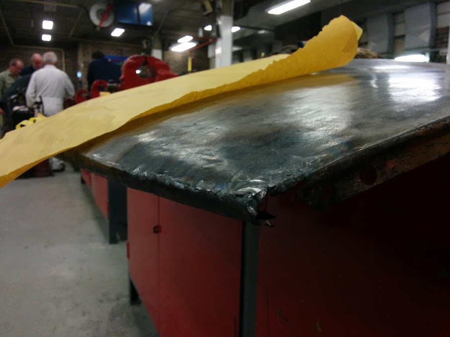

Well this has come up better than expected.. There is still a lot of detail work to be done, but I've somewhat surprised myself as to how much improvement has been made.
Spent a lot of time with hammer / dolly and dolly and slapper re-profiling the bonnet.
There is a couple of splits along the leading edge that I'm going to use the Oxy welder to patch up and should give it an even more 'true' look.
Using a slapper helps 'shrink' the metal so it's not really oil canning or anything at the moment but if there is areas that need to be tightened then a quick heat shrink might do the trick.
At some point I'll test fit it onto the car to see how it looks and get a better sense of how it will sit. Not in these photos but the template I was using to determine how much work would be needed (based on the left side) now sits very close on the right side.

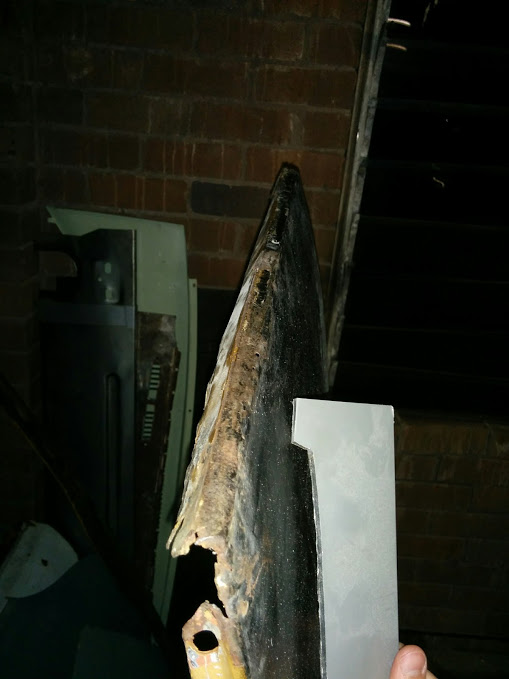

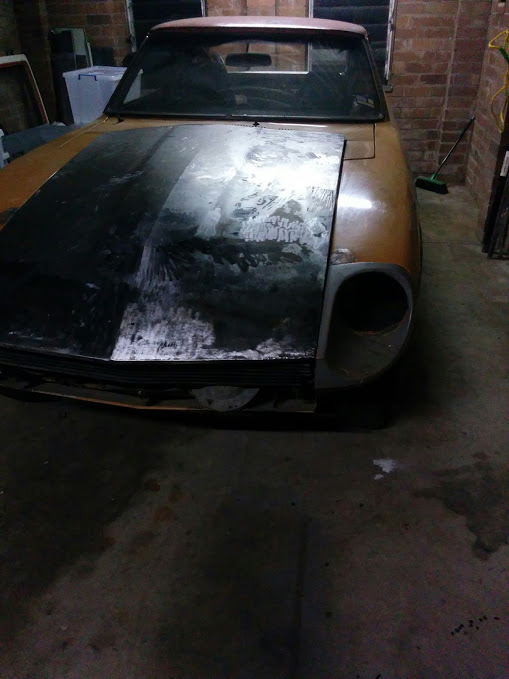

Before heading to Tafe I decided to try and mock up the bonnet on the car, given that the skin was not attached properly to the frame it's difficult to get a true sense of how everything will look.
Since I had removed the bonnet latch mechanism I couldn't completely shut the bonnet.
You can see the front right side was about an inch short of the headlight scoop (only roughly placed with fender not fastened down etc..).
