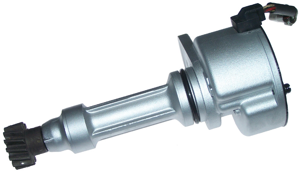

I believe the turbo ZX had a CAS distributor set up which you can use as a trigger for aftermarket ECUs.
They look like this:
http://forums.ctzcc....opic.php?t=5784
http://www.the510rea...tart=15#p203487
Zshop recently sold 1 on eBay.
http://www.ebay.com....n-/281323802960
The only downside I can think of is the fact that it's still a mechanical set up and that can have slop in it if/when it wears.

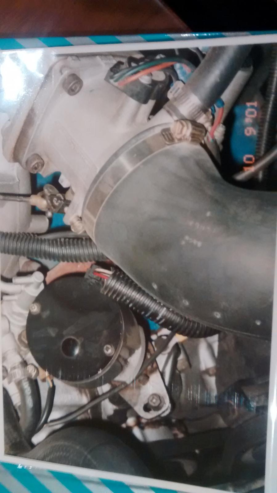

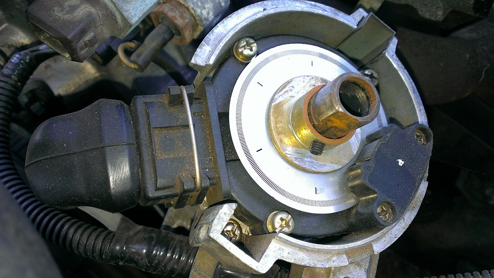

back when I had my 280ZX 2 seater a Series 4/5 Mazda RX7 unit replaced the dizzy as it had the CAS in it.
some minor mods required to make it fit
with dizzy
without
RX7 CAS unit. Not exactly sure what they're called
