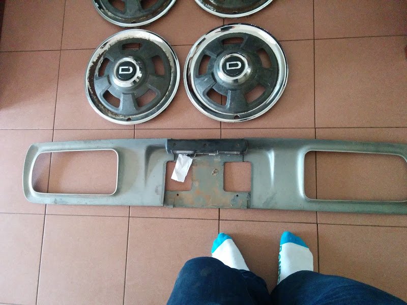

Have a look at the post I made here:
http://www.viczcar.c...oject/?p=175177
Check out the difference in colour between the rear garnish set and the hubcaps.
Nevermind the socks! I just got home from a long flight and didn't want to wear shoes anymore when I took the photo. :). However I believe the rear garnish is closer to the 'correct' colour. But generally speaking I'd eye ball it and maybe test a few different options to see which you like most.

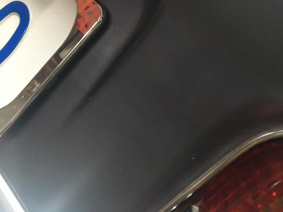

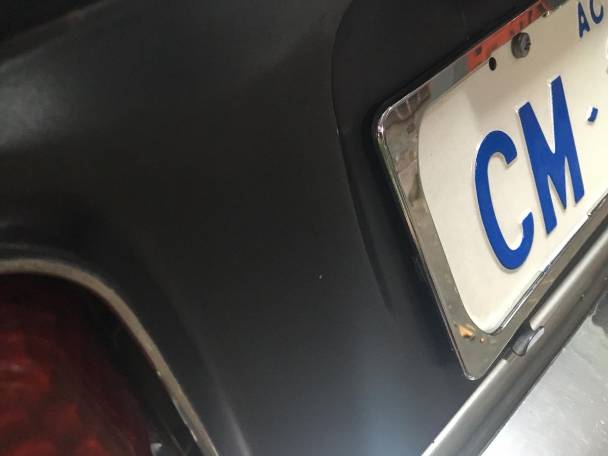

Posted 21 April 2016 - 05:43 PM

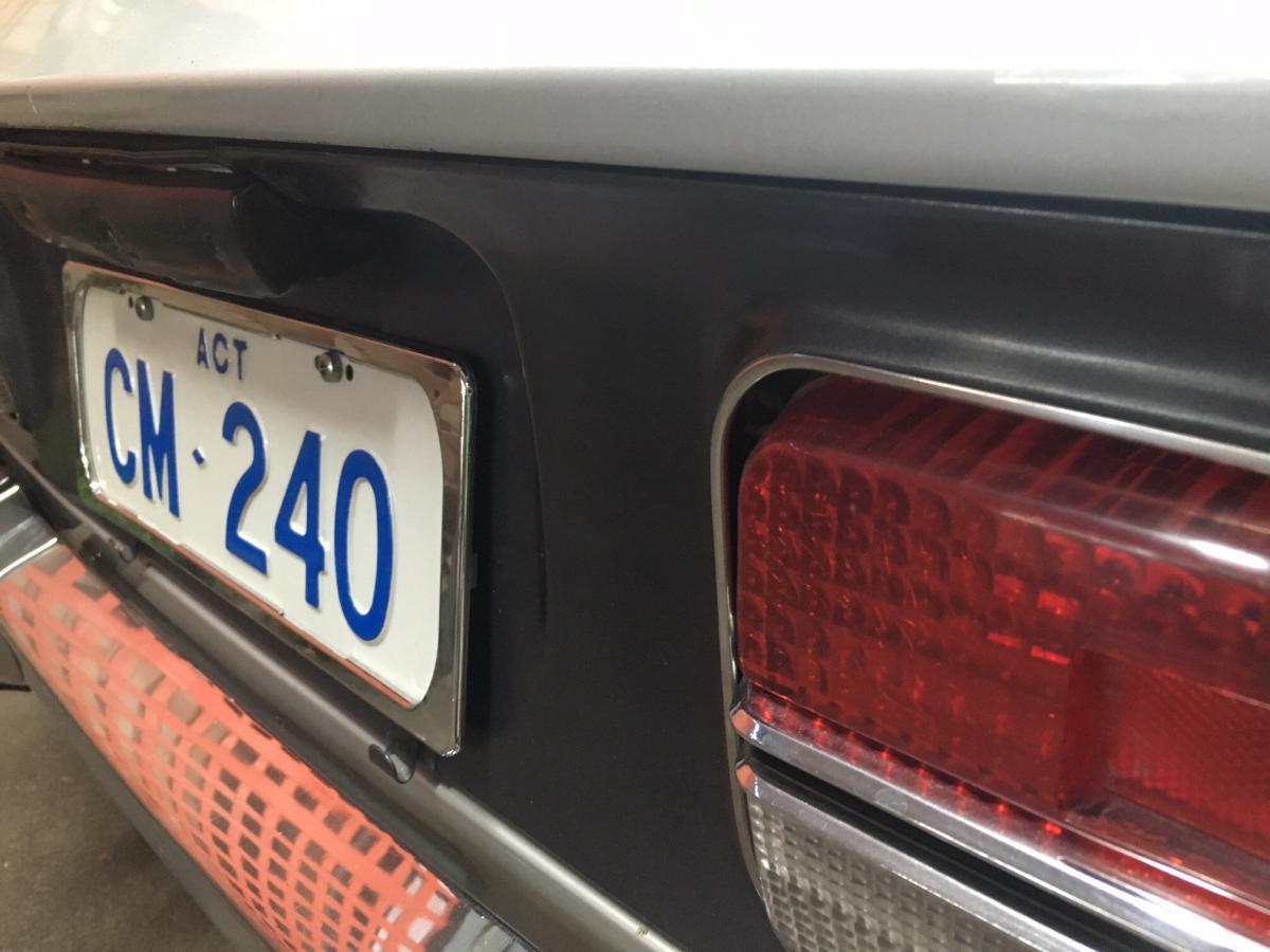

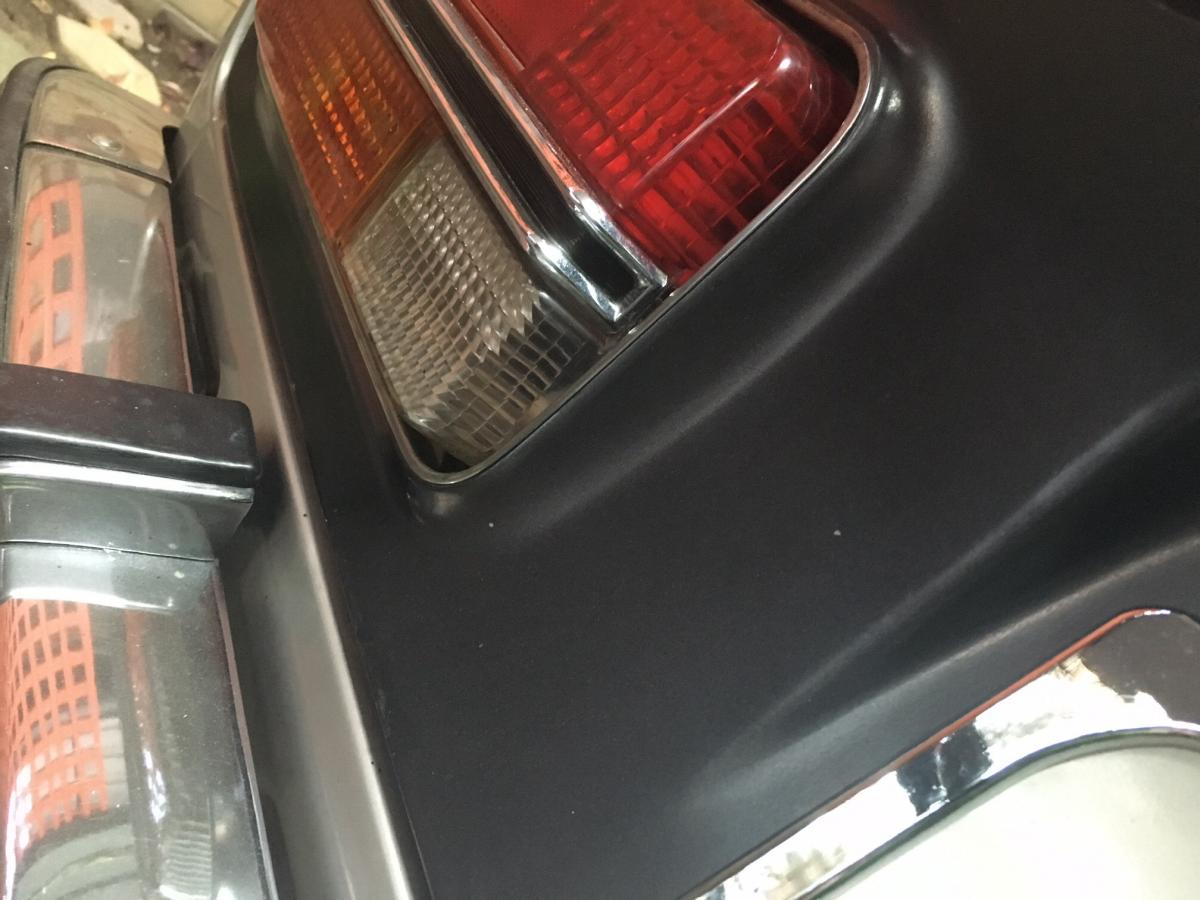

Pics of my garnish, which is in pristine untouched condition. Colour on my hubcaps is identical.image.jpg image.jpg image.jpg image.jpg image.jpeg

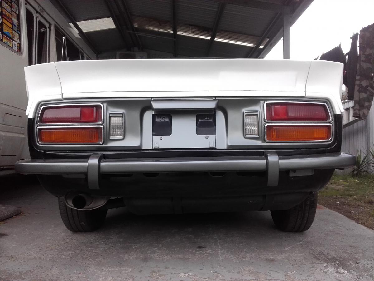

If anybody is in contact with Adam Fairfax (brown hornet), I gave his painter a tin of paint that was perfect colour match. Never got it back. Maybe it still exists.

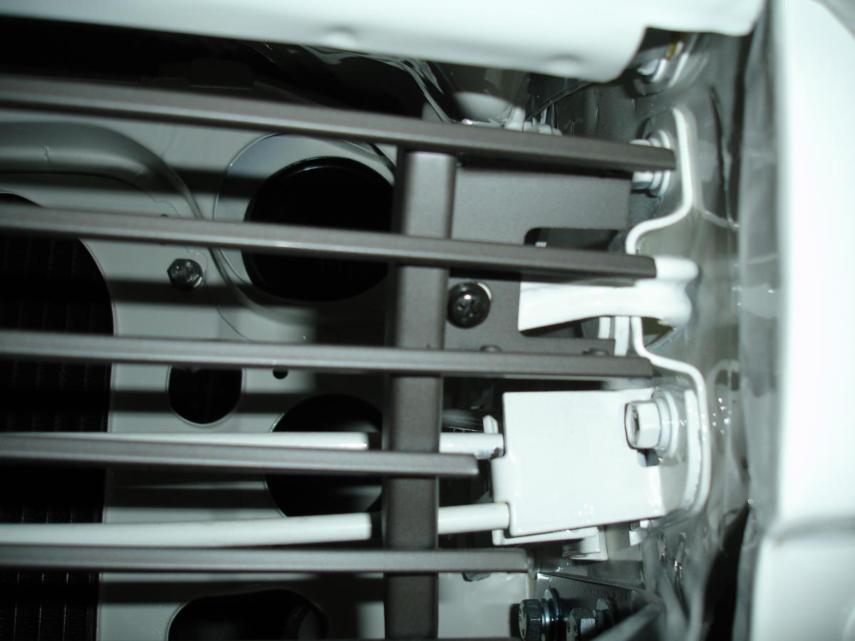

I have a set of NOS rear tail light panels and the back is a red oxide paint and the grey is matt with a metallic grain. I will add a photo over the weekend.
When I gave the paint to Adam I asked that the painter spray a swatch card so I could let other people restoring 240's use the swatch to match.
The grille, hubcaps and rear panel should be the same colour.
I have attached a photo of a new grille that shoes the matt finish.

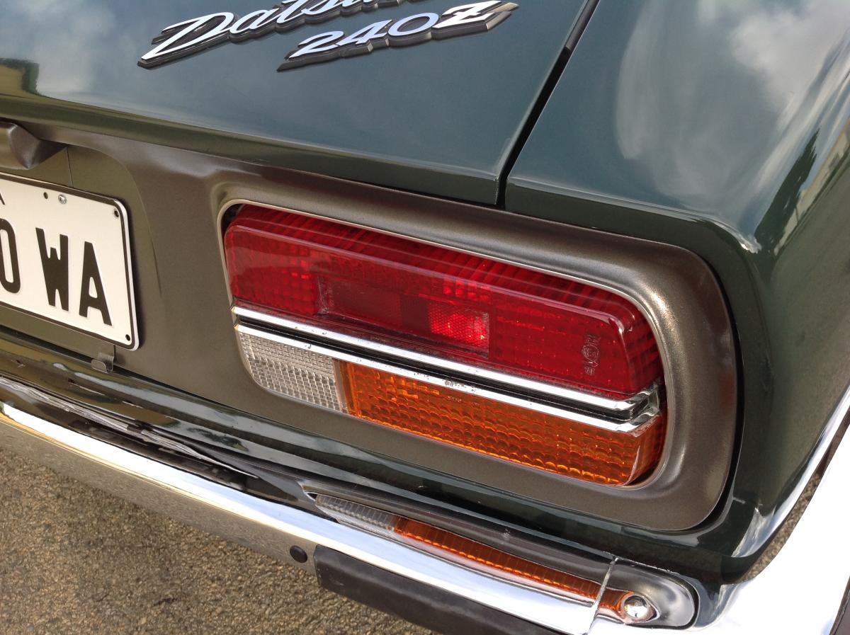

Posted 12 June 2016 - 12:29 PM

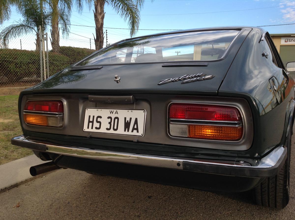

I gave my tail light surrounds a hit with some of the Duplicolor HWP102 yesterday. See pics below. It looks good to me, but I'm not as anal as some in regards to originality and I don't have anything to compare it with. I haven't used any sort of clear over the top. My car is also a darker shade than the original 907 green, it's not low light, so this should be a fairly good representation of the colour.
  • gav240z likes this

Posted 12 June 2016 - 01:37 PM
Looks really good, much nicer than before. Looks like it was black before?
#39 GK510
GK510
  • 89 posts
  • Location:Perth
  • Tagline:On the never ending quest that is Datsun ownership
Posted 12 June 2016 - 01:51 PM
They were black originally. Then I painted them with a metallic grey, which was actually a Toyota colour from the Duplicolor range, but that ended up looking blue rather than grey. Looks much better now I reckon. They are actually different surrounds than the ones in that earlier photo. Those ones were pretty rough and didn't have the trim around the tail light holes, so that also helps with them looking better now.
