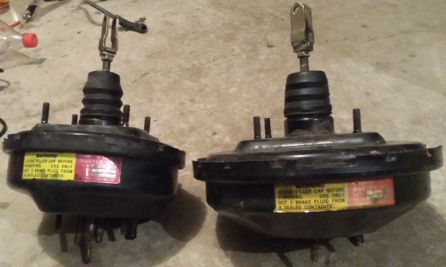

I've attached photos of my brake booster
Posted Image
Posted Image
Once the booster issue is fixed she'll be all road legal :)

I have a 77 with a 15/16 master and booster from 280zx fitted upside down. You just have to bend the hard lines slightly (with your hands) for it to fit. I believe both S1 and S2 280z parts will fit, one upside down, one not. I also have the hilux front and r31 rear and it works a treat.

Just curious, but can anyone suggest why this apparent JDM car has English written labels on the booster?

It's nothing out of the ordinary, even for today. The part maker for the booster is bendix so nissan/datsun would have a had a supply contract with them at the time, probably a lot more cost effective than producing in house etc.
I've owned imports since I was a teenager & the Japanese always mix English in their cars eg. the dials & buttons for aircon & radio have always been in English. More modern cars like my V36 with factory touchscreen display was mixed with English & Japanese.
As for the reason why... I have no idea  :P
Everything relevant is on the red label.
The booster was actually manufactured in Japan by Jidosha Kiki (they made several parts for these cars) but the design was licensed from Bendix (USA) who held the patent. It's quite a common arrangement, and you'll see a lot more of it on an S30-series Z if you look into it closely enough.
There were some special labels and stickers for the Japanese maarket models, but for everyday items that were shared across several market variants (and also several other models other than the S30...) labels, stickers, logos and other data were written in English.

Got the replacement booster, definitely a difference but luckily it all cleared in the engine bay & it mounted right-side up :)
Posted Image
Probably the hardest bit was putting back the bolts on the firewall, very awkward but all in all only took half an hour at most.
The brakes are good now & no more rough Idle which is awesome. The booster is a bit too powerful for the stock brakes as they come on very strong at the end of the pedal travel, hopefully it's not an issue for the blue-slip inspection. At least the booster is working & it will pass the brake test no problem
