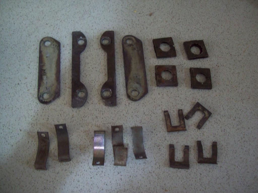

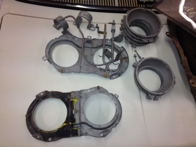

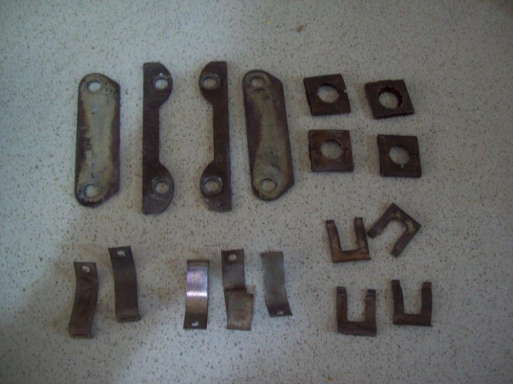

Finally getting on with some assembly. I've looked around and there doesn't appear to be too much which actually need electroplating. I'm only looking at items which were originally cad plated and I'm not running any Datsun engine/drivetrain/brakes.
Any suggestions on what I might be missing to send to the plater?

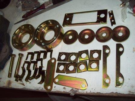

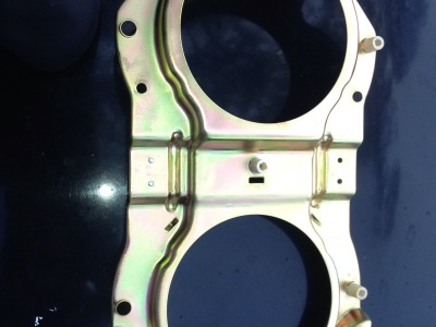

Posted 18 June 2014 - 02:34 PM

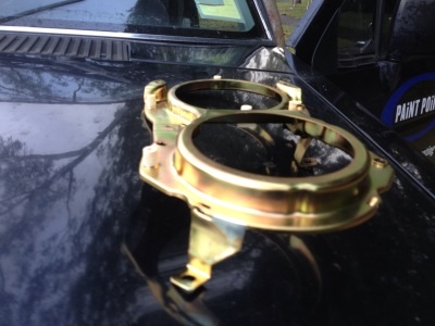

Got some of the items back today, including some belonging to George.

I didn't worry about doing my bits from under the car. They are only going to get dirty again so painted them. I bought a DIY plating kit but as yet haven't used it. But good to see your build progressing.

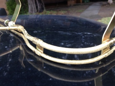

@Peter - you mentioned the discoloration is more obvious in photos (I totally get that, given my steering wheel and center console resto thread and various other things I've done on the car the flash / photo makes certain things look different).
I'm wondering though did you discuss this with the plater? Is this something that can be adjusted controlled in the process? I'd like to go with a yellow as can be look if that's possible?

I'm wondering though did you discuss this with the plater? No, I wasn't aware it would be an issue
Is this something that can be adjusted controlled in the process? I don't know  ...
Cozza had some done at Alexandria recently so he might like to chime in with his experience.
I only had the plating done because I thought paint would come off a painted surface when they were re-attached to the car. If I did it again I would go for the aluminium/silver passivating rather than the yellow/gold as I'm after function not appearance - unlike yourself and George I'm not doing a restoration.

Yeah I was after the original look so went with the yellow passivating finish.
I have painted lots of these type of parts in the past but the paint gets damaged once you tighten a bolt or slide a clip onto them.
It does have a bit of the rainbow effect but nothing I'm concerned by.
I blasted all my parts except the fuel rail (wouldn't fit in the cabinet) You can see the pitting as mentioned above.
I had no problem with the plastic and rubber parts, they are as good as before they went in.
Generally I'm happy with the outcome and the service I got from Alexandria Plating.
Got a beer carton full of stuff done plus a ice cream container full of nuts bolts and clips for $80. I don't know about others but I was surprised it was so cheap.
