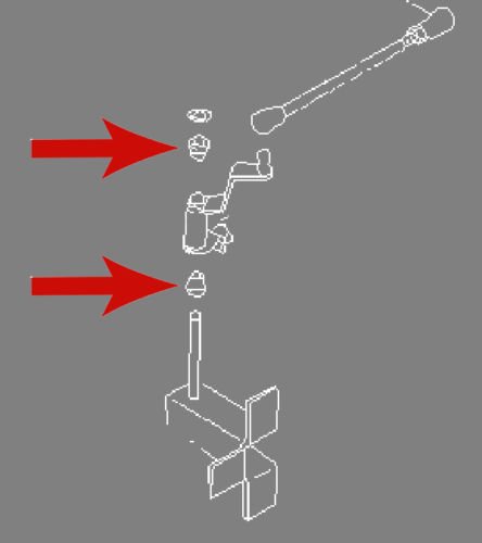

I think I am missing these 2 nylon bushing
Posted Image

they go here
Posted Image

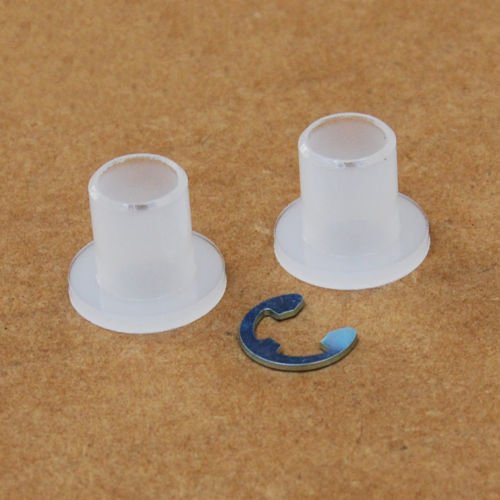

You are correct in that you are missing at least the upper nylon bush (maybe the bottom too) and the E-ring in the photo you posted. Buy those and install them and it should fix the problem, if not only then start adjusting the carbs. Lucky the nylon bushes and E-ring are a cheap fix. The cable tie could come off, I wouldn't drive it like that.
cheers
