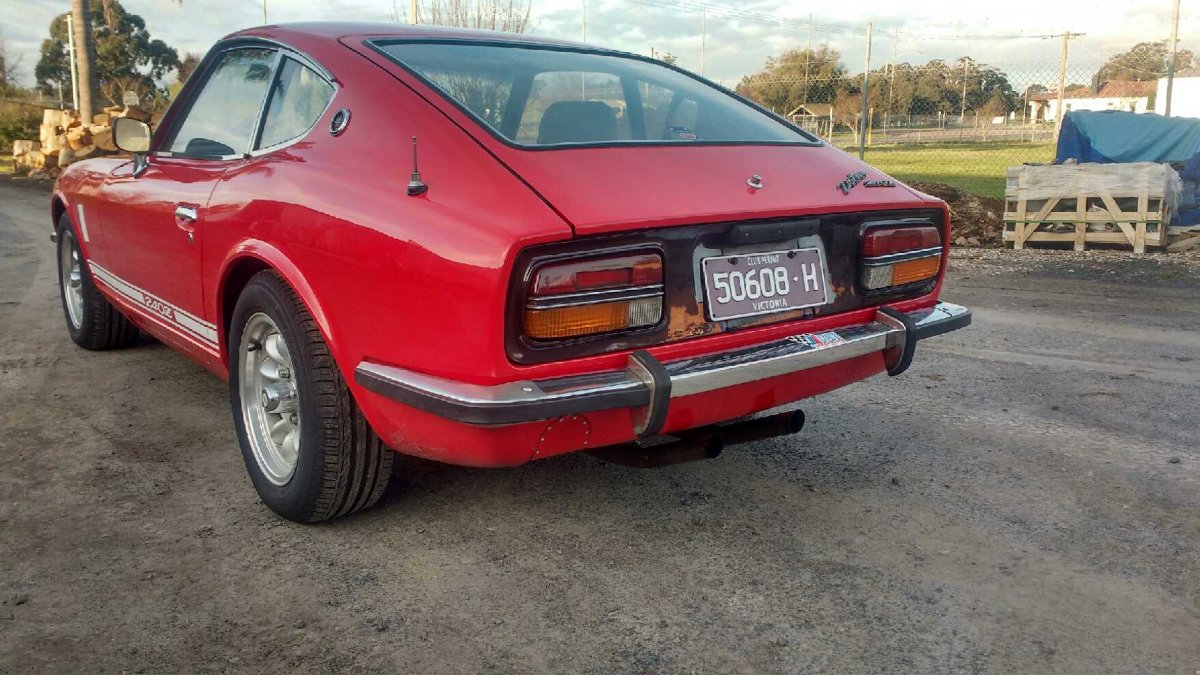

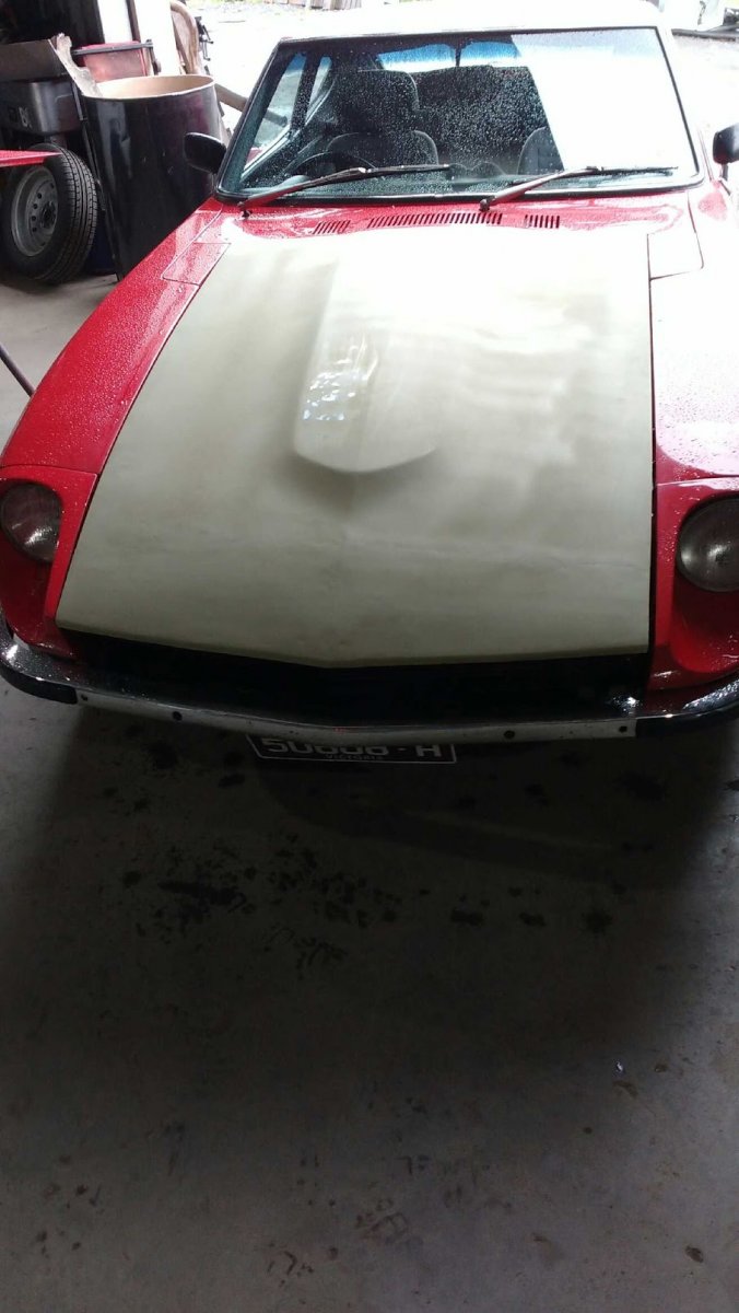

Well Locky threw my set of dry stored Triples on her and apparently idles at 700rpm. It will need some heat shielding and aesthetics wise I miss the orange air box.
Looking forward to driving it after a good tune and some much needed work eg:brakes.

That manifold was a right PITA to make fit!
I was a bit surprised when it started up, once fuel pumped into the carbs...!
I just have to make the accelerator linkage work, fit the air cleaners, install the O2 sensor & get Lou M to give me a hand to fine tune it.
Going to need longer spark plug leads too, as they interfere with No1 carb drop link.
Gearbox is in too, with a modified cross-member & shifter - gearbox works a treat!
Next up is modifying the abortion that is the exhaust system & giving the brakes a once over...
