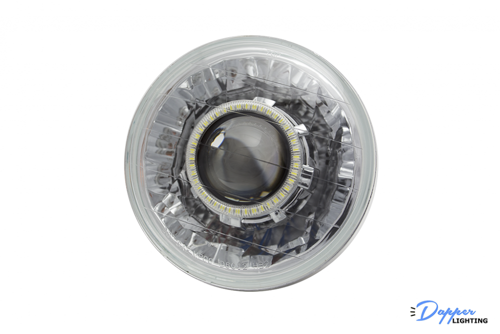

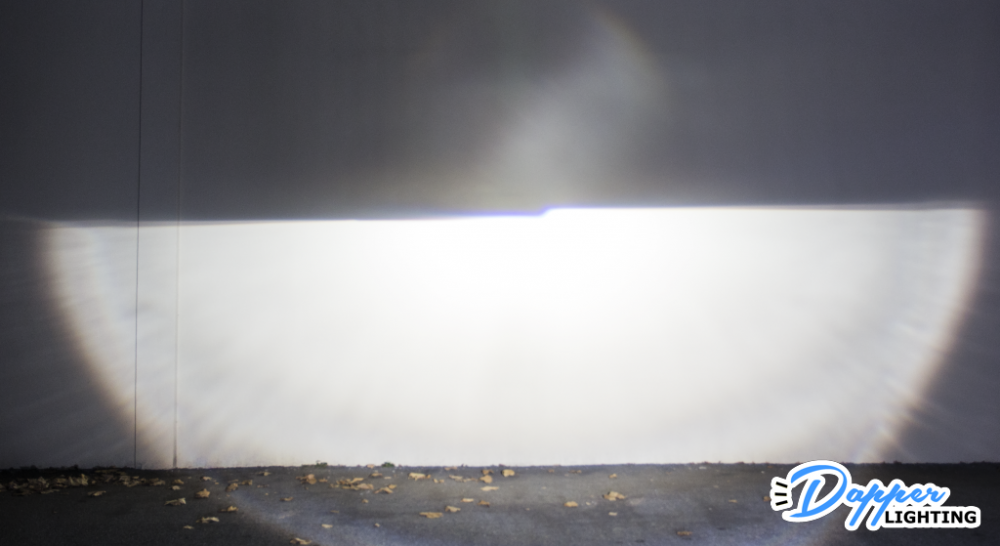

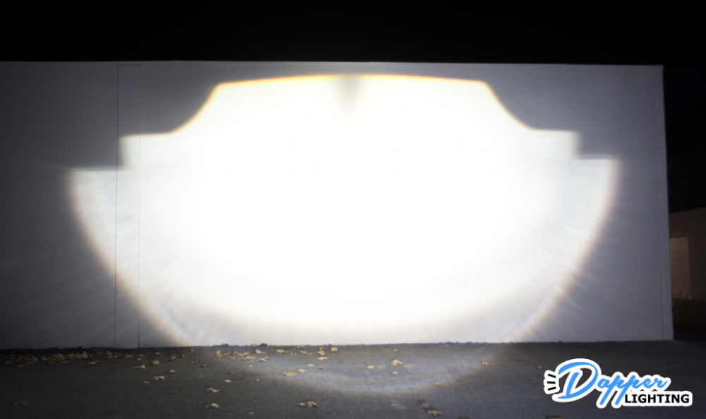

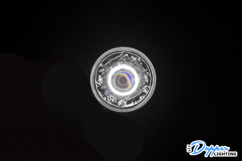

Ben from Dapper Lighting. I frequent most of the Z forums and thought I'd chime in.
99% of the stuff on ebay is garbage. They are fake projectors and are extremely dangerous to put HID lighting into.
The bi-xenon V2 projectors that we're using exceed FMVSS108/DOT specifications and will give you clearer, stronger, and better cutoff light than OEM vehicles.
A good projector costs $120-150 so for kits to be selling for $99 with projectors and HIDs is a big red flag.
Let me know if you guys want more info and I'll dig up some photos of the comparison shots between the two.

For RHD vehicles, the light pattern cut looks like this, \__ \__
For LHD vehicles, the light pattern cut looks like this, __/ __/
Swapping them side for side wouldn't achieve anything.
