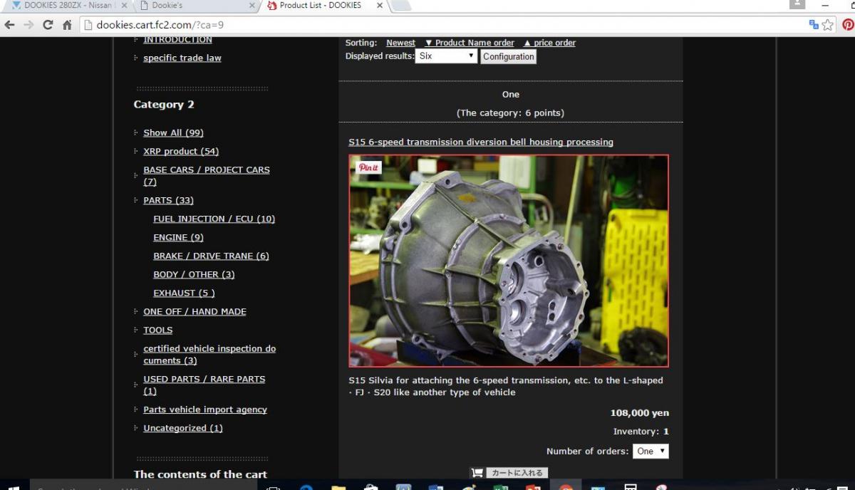

BELL HOUSING
I had to remove 35mm from the front bell housing when it is welded. S15 (200sx bell housing size = 286mm prior to being modified, 251mm after the chop)
Depending upon what clutch plate you have (as they come in different sizes) - you will need to select an appropriate idler bearing carrier. For the record there are at least 3 difference sizes that I have found thus far. In my case I needed to use shortest one I could find (which was approximately 47mm).

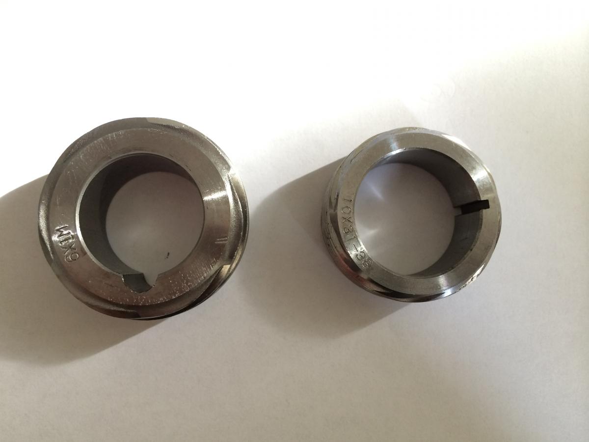

WORM DRIVE GEAR
I have attached photos of this one. As Dave1600 outlined in another post (S15 6 speed transmission on an L28), you need to find an earlier model (2000 or earlier I think). You do need to find one which has the removable plug in place. Photos outline a Lexus IS200 worm drive compared with our Datsun worm drive gear (ours is the biggest one). All you need to do is trim the height and widen the hole of ours. You also need to source 5mm ball bearings as it is smaller than ours, and a little tweak of the worm drive where the bearing will sit.

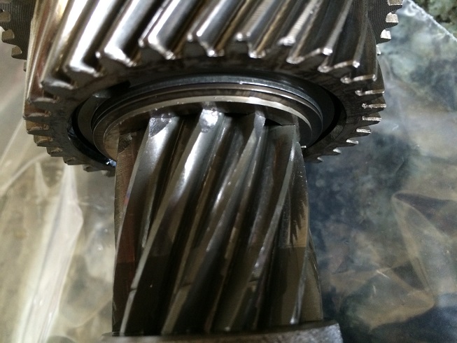

MODIFICATION TO THE COUNTERSHAFT
These gearboxes have a bad rep - particularly as the cars were used for drifting. Once the power starts to head north of 250hp they can have issues where the forth gear pushes hard against its thrust washer, chips the teeth on the counter shaft and (from what I can gather) eventually it forth gear floats and ended up meeting with reverse. Therefore I also went to the extreme to modify the countershaft ready to handle a higher torque (possibly not required). In reality my countershaft was already chipped (photo included). There is a company in SA that gave excellent service and great advice and I cannot recommend them/him highly enough. Sam from Neat Gearboxes - was able to answer all the questions I threw at him throughout this process and also modifies these countershafts.

Bell Housing - $500 - $1500 (depending upon how lucky you are - just make sure its done properly)

Countershaft Mod - $950 (approx. but this includes a new countershaft as well)
