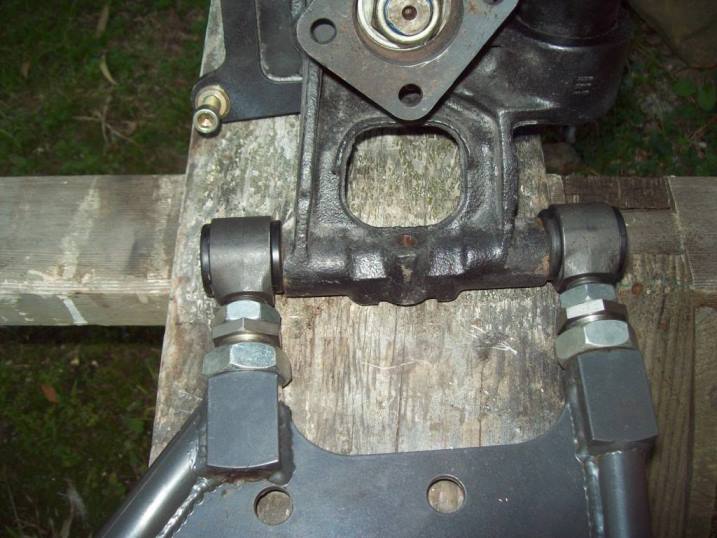

Hi Guys/Gals
I 've just had them electroplated, the plating only goes an inch(25mm) or so up inside the tube

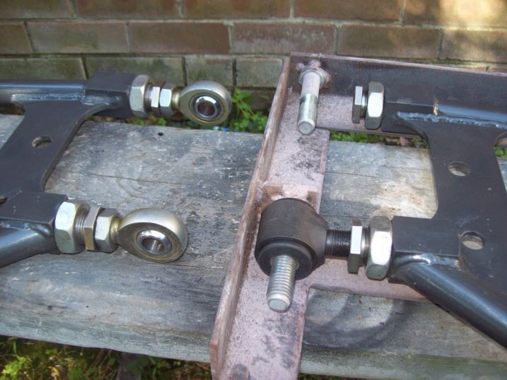

Posted 07 March 2015 - 09:38 AM

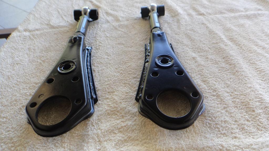

Arms Dealer......
#71 Riceburner
Riceburner
  • 3,261 posts
Posted 07 March 2015 - 09:45 PM
Wow, they look great David!
I really shouldn't be shocked after fitting/using your rear control arms, these front ones look awesome too  8)

#74 600Z
600Z
  • 266 posts
  • Location:Tasmania
Posted 08 March 2015 - 10:44 AM
Very nice work I like them.
Just wondering what wall thickness tube are you using?
Justin :)
#75 dat2kman
dat2kman
  • 4,061 posts
  • Location:Newport Waters Qld
Posted 08 March 2015 - 11:35 AM
Good bit of kit!
Bons is the in-out adjuster, like a tie rod, you dont have to drop the Heim joint by pulling pin out f crossmember, to adjust.
#76 zcar63
zcar63
  • Donating Members
  • 94 posts
  • Location:Brisbane
  • Tagline:New Member
Posted 08 March 2015 - 01:11 PM
Hi Jason/600z
Jason do you have any trashed 6 speed gearbox's i can play with?thinking of doing the bell housing thing.
The adjuster is machined from solid 4130 (chrome moly),the female end of the adjuster is L/H thread and the male end is R/H.The insert in the control arm is also 4130 ,the spacers that go either side of the rose joint are mild steel,they are spacers after all.This set will give you between 1.5 to 3.5 degrees camber approx.
Cheers David

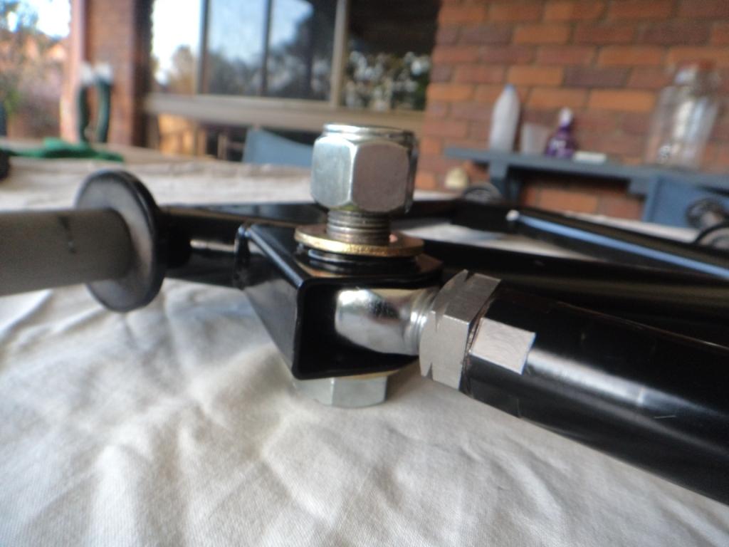

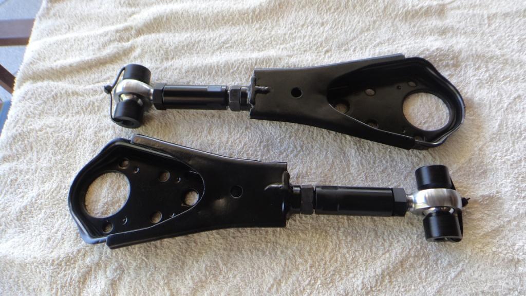

Posted 11 August 2015 - 11:43 AM
Front arms Pics as requested
