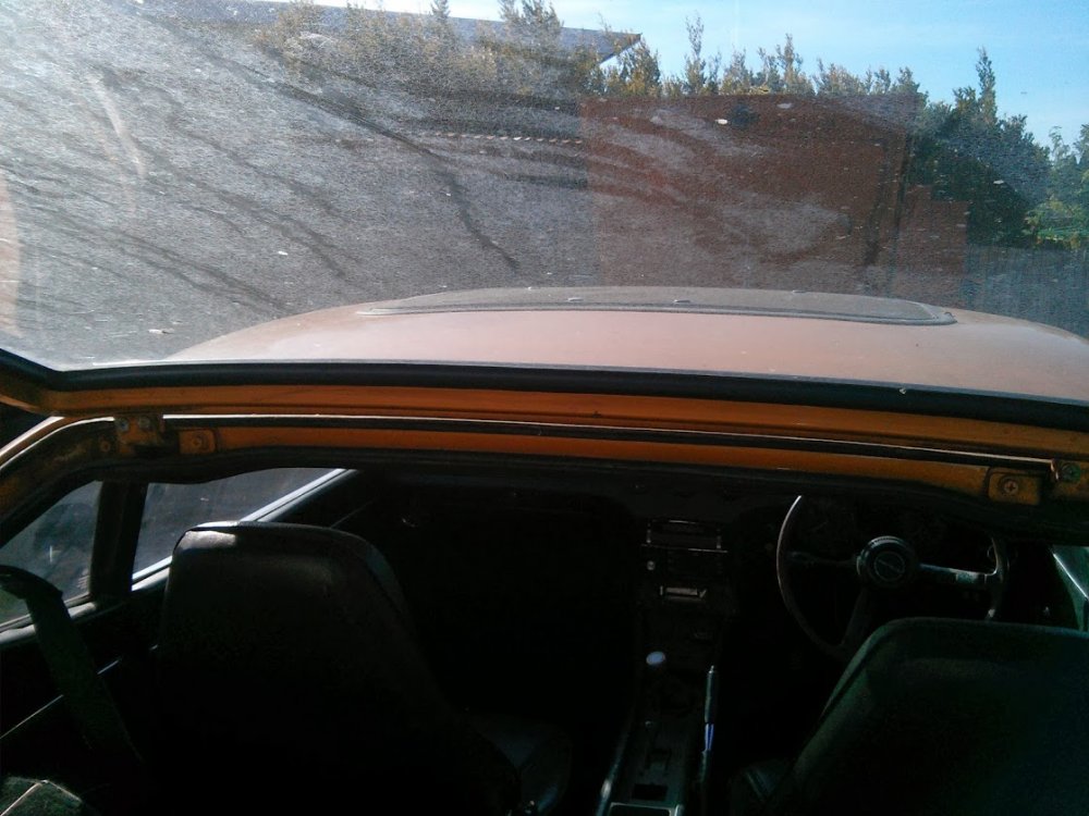

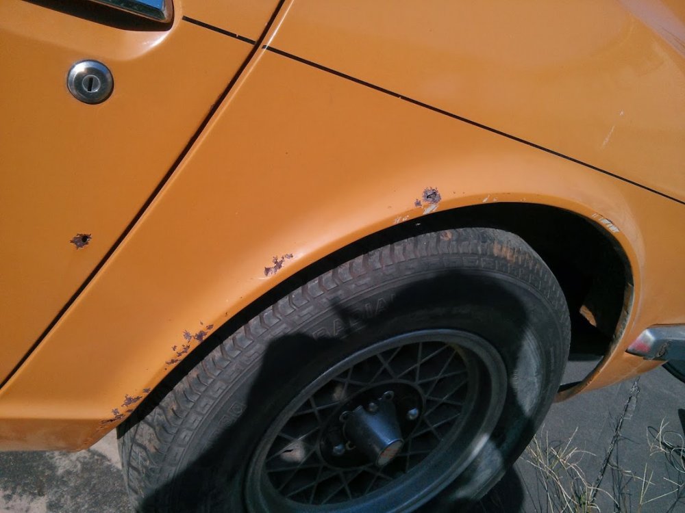

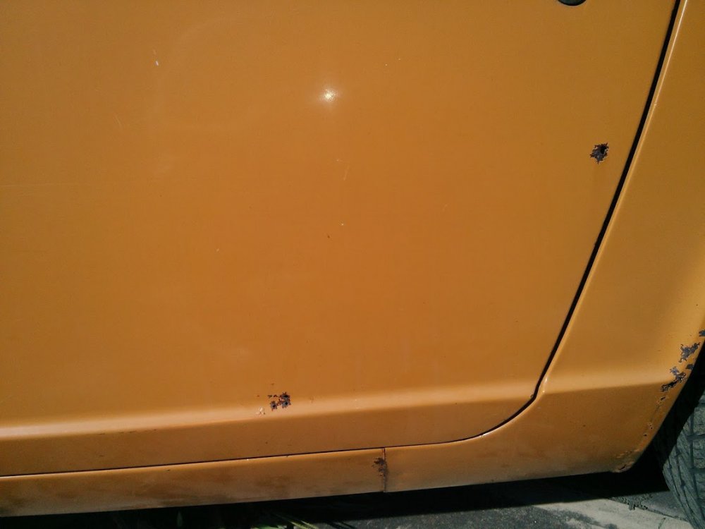

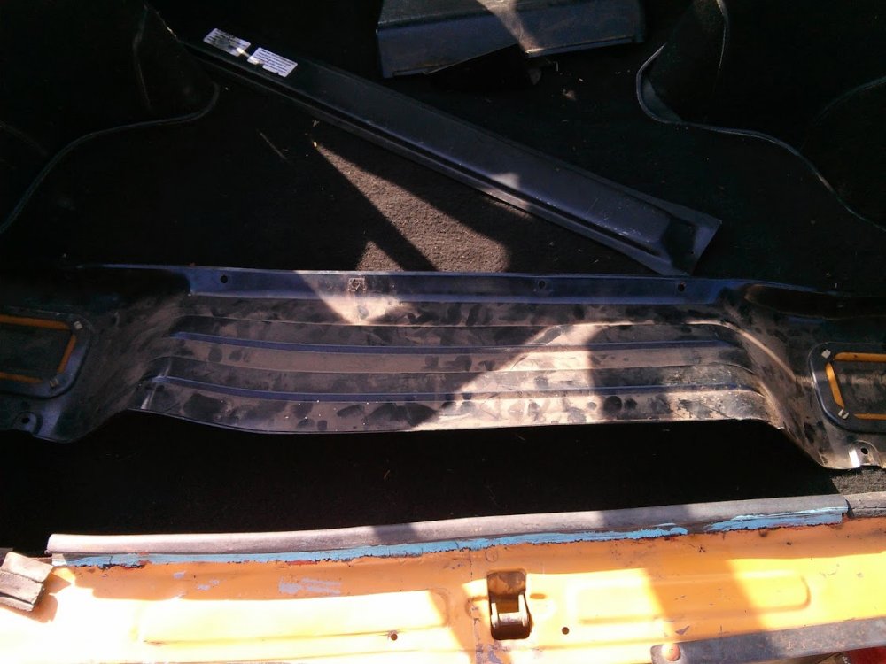

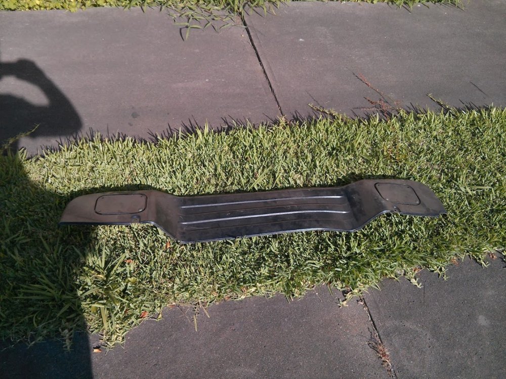

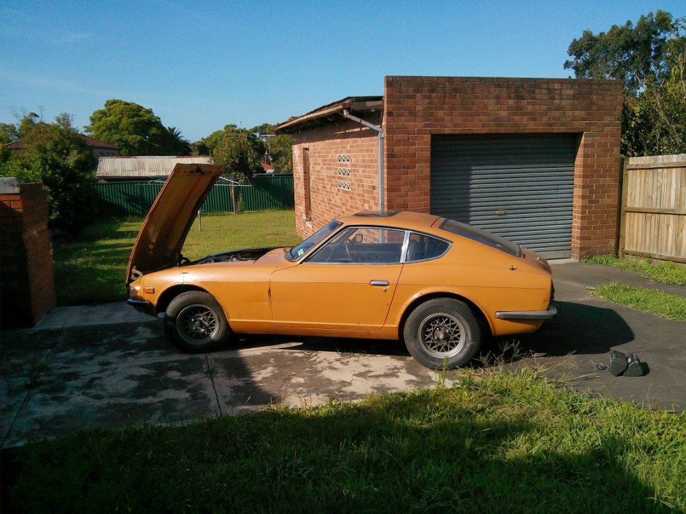

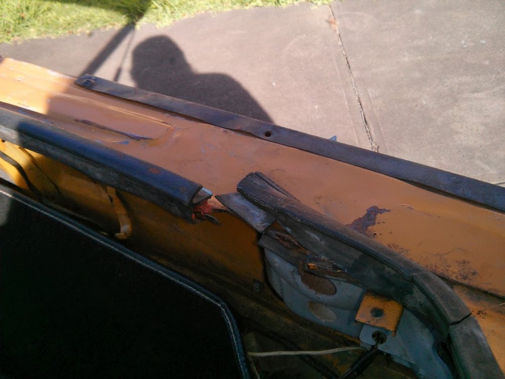

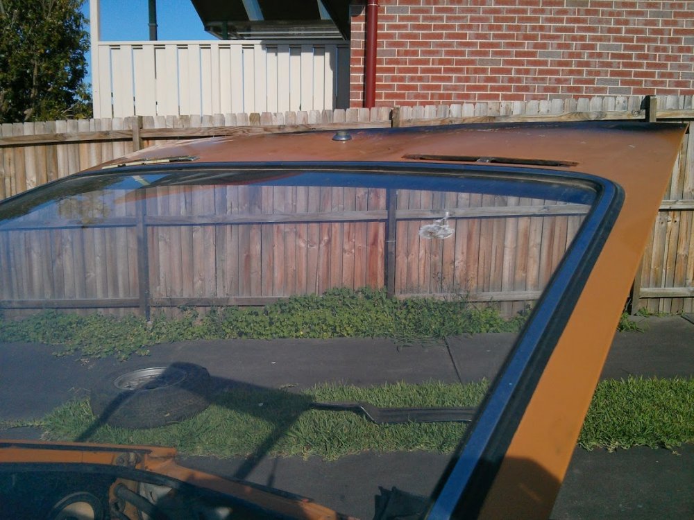

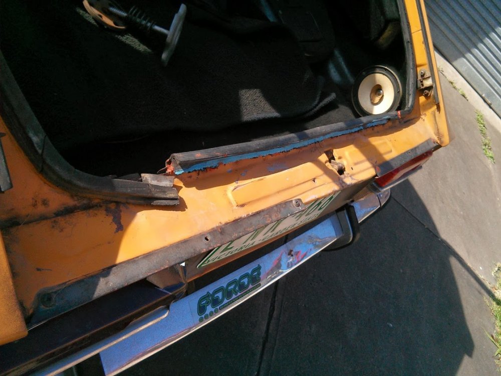

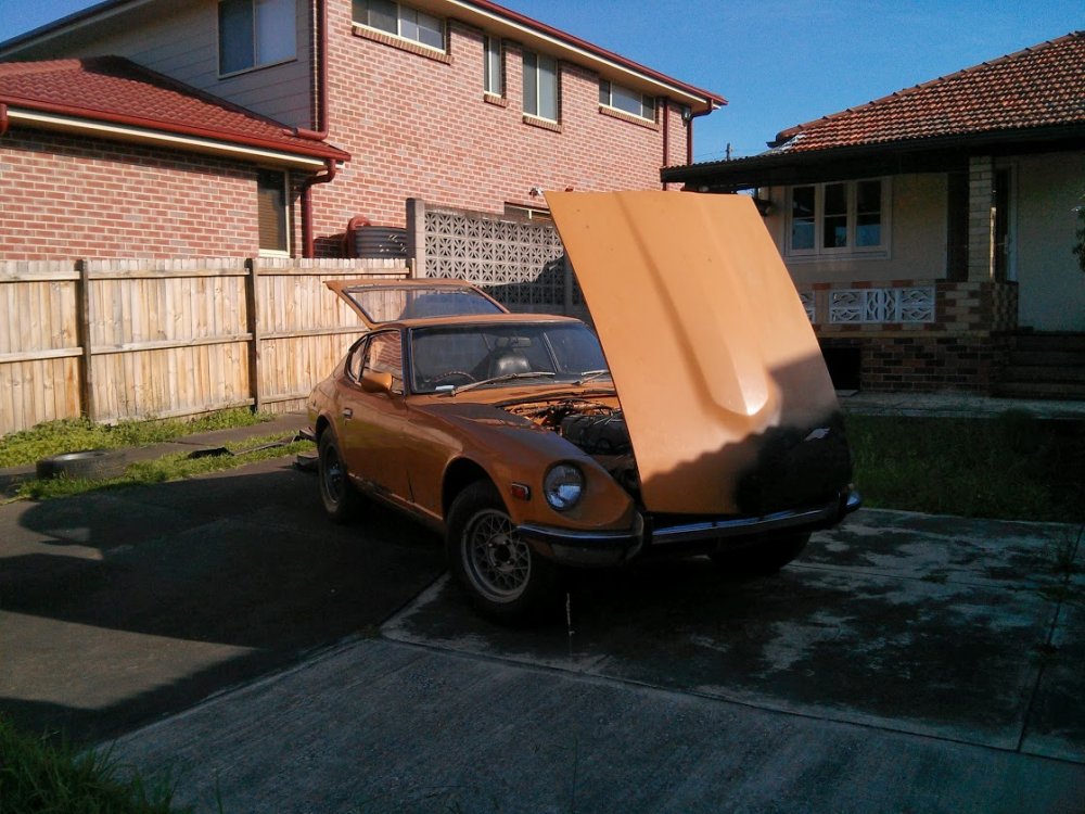

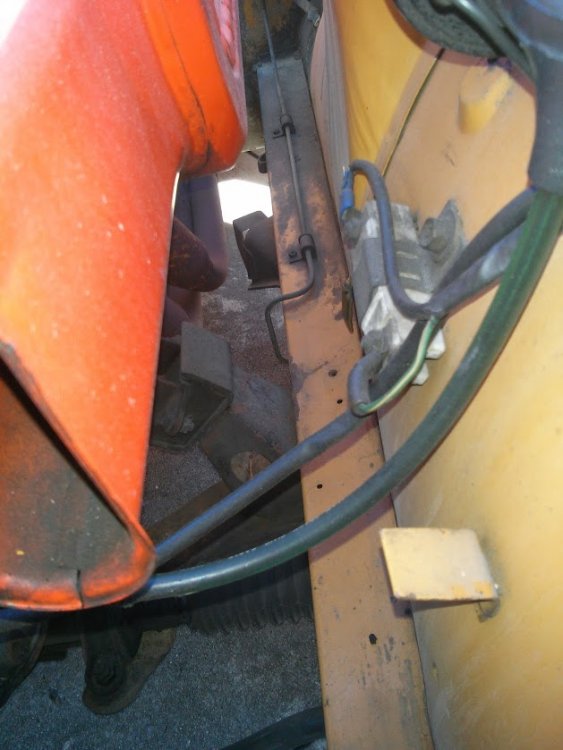

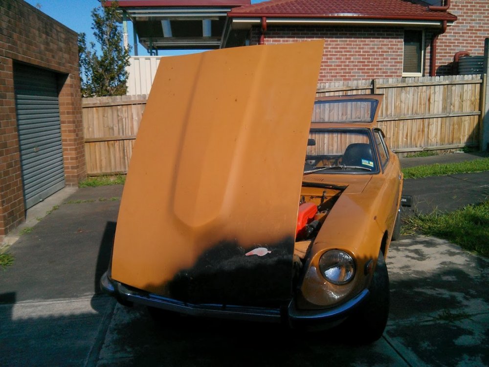

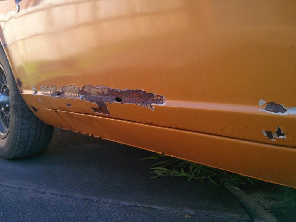

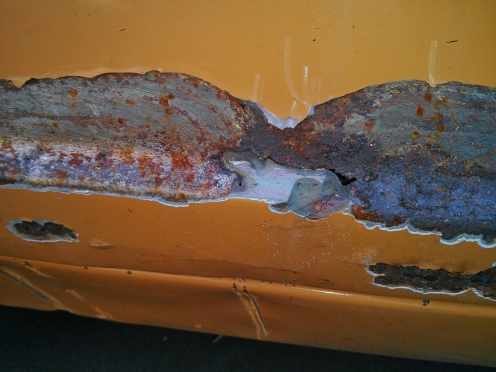

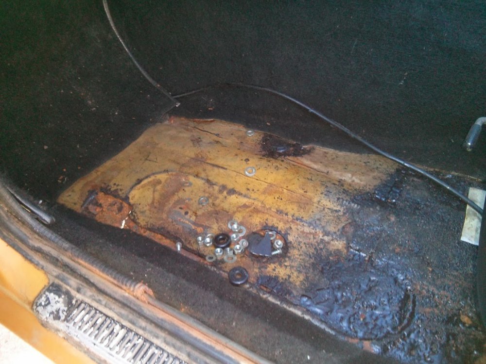

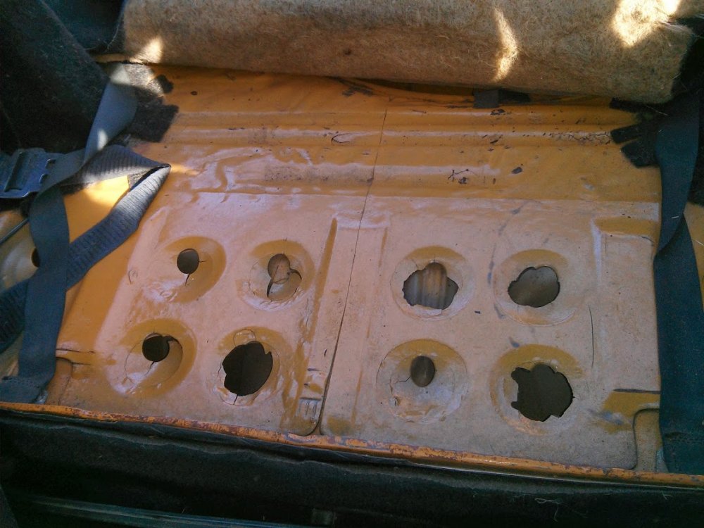

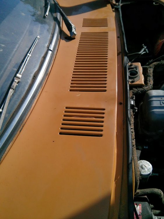

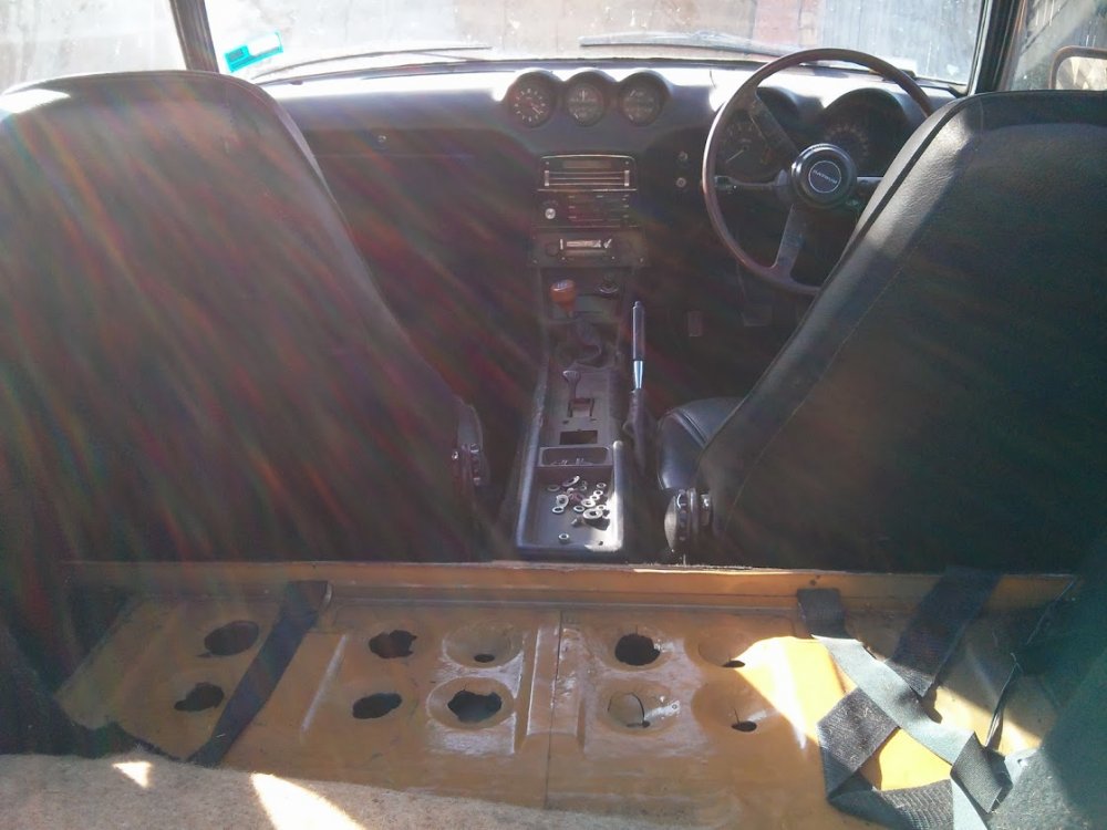

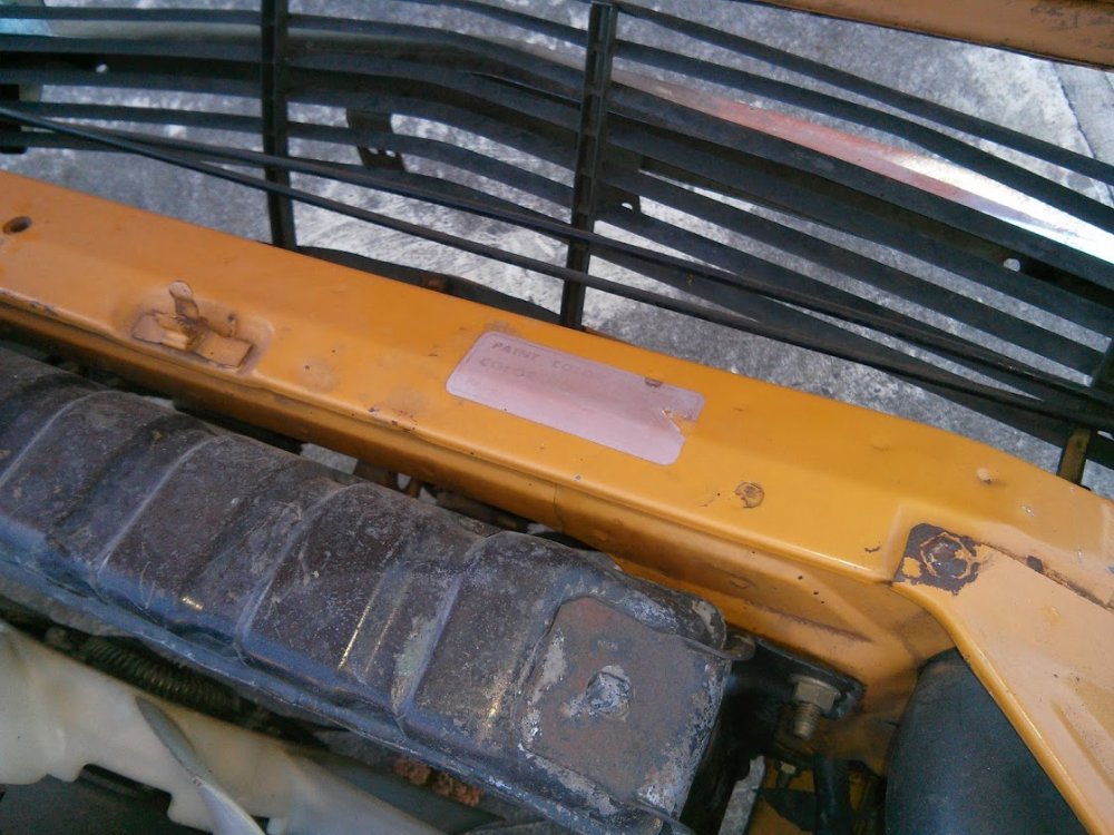

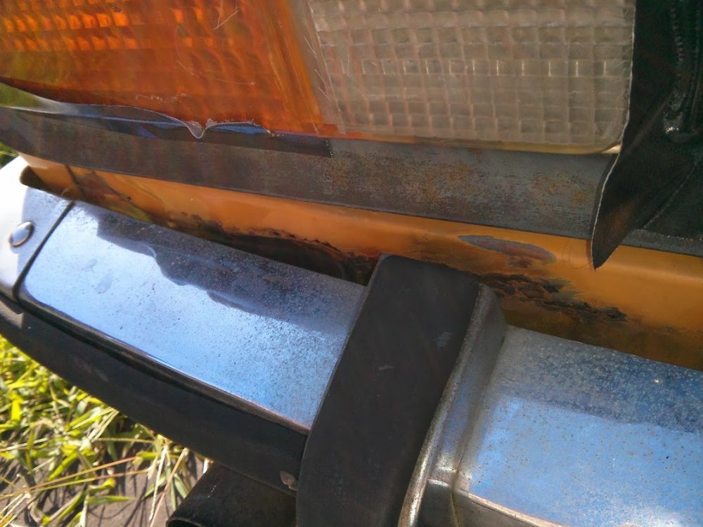

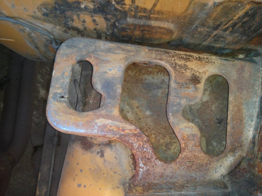

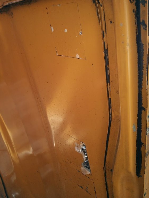

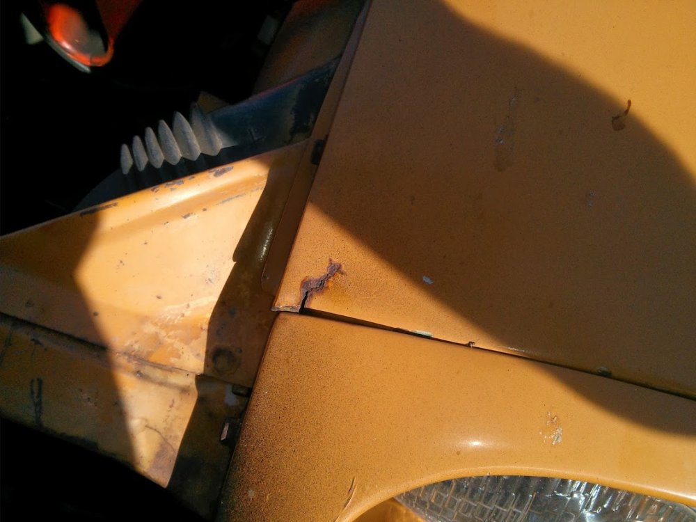

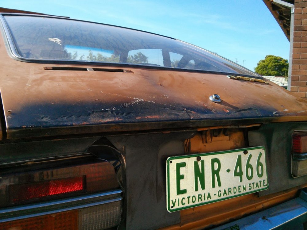

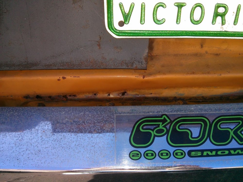

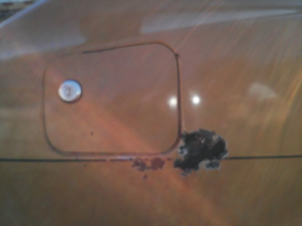

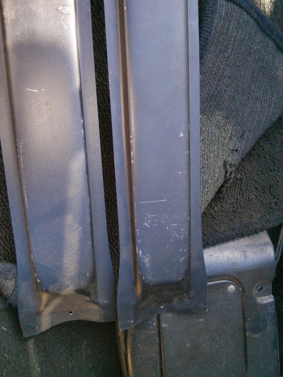

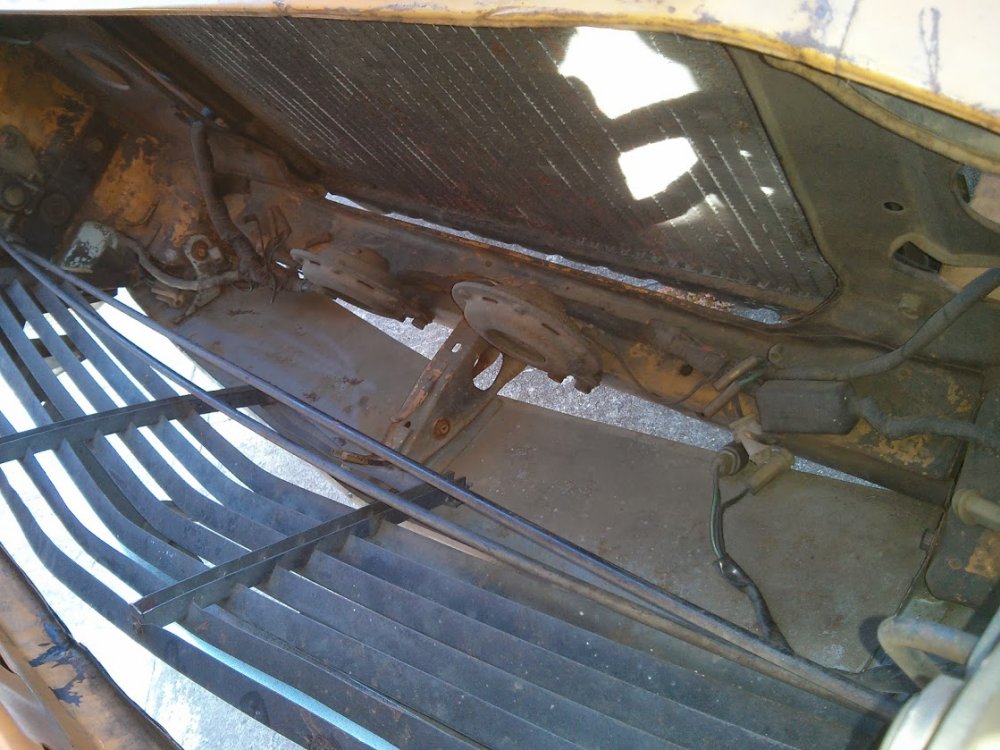

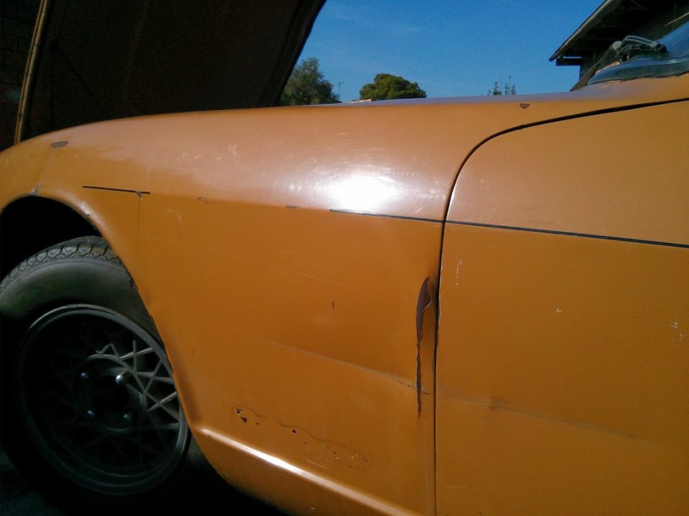

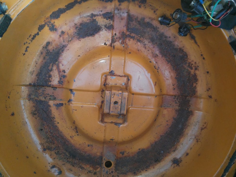

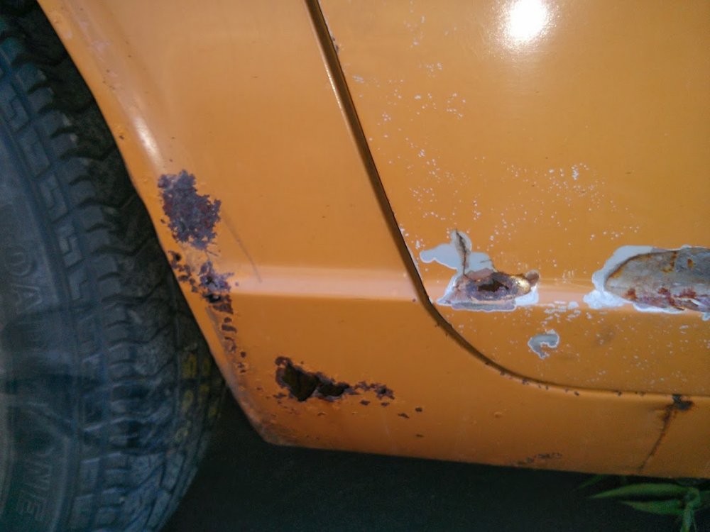

Administrators gav240z Posted December 19, 2013 Author Administrators Share Posted December 19, 2013 Brace yourselves, Z-car pics are coming... So the 240z arrived today in the late afternoon. It was a hot day in Sydney and we (the tow truck guy) and I managed to get the 240z down the driveway and into my yard. The tow truck driver seemed keen to sit behind the wheel, he was asking if I'll restore it etc.. and then said should put an RB26 in it. I mentioned it was an early car worth keeping original, but he seemed uninterested in that sort of silly talk. First thing I noticed, driver door handle is broken. It lifts but does nothing so you have to access the car through the passenger door. Not a big deal, but it will get annoying. Rust in all the usual places, which on a 240z means everywhere! . I have to say I had a mixture of excitement and a hint of, Oh Noes what have I got myself into. But only just a little bit. For the most part I'm really anxious to 'carefully' rip into it. I found some old rego stickers going back to 92/92/94 Notice how it was classified as a 71 model? I thought that was funny considering how early she is. Drivers side still had the original DR Lucas headlight. I haven't seen these since my 73 240z... The passenger side though was a GE item. Panel beating is hard work apparently.... so someone gave up. Check out how long the grass is....my lawn mover won't start. Going to try a new spark plug tomorrow. Spent the afternoon taking it apart. Bloody Victor mower's lol.. No stowage bins. Those cheese grater style holes are a weird shape because it's the sound deadener that's cracked not the metal underneath. No stowage bins obviously due to being an early girl. Still has the original anodized style hood hinges. Most 240z's by now have these painted.... Sunroof is an 80s item looks like Aussie made too. Ashtray lid why you snapped? Glovebox stickers, not sure if they're all original? It would be awesome to re-create them as part of it's restoration. Adam (A.K.A Mr Brown Hornet) - please sit down, because I'm about to show you the original lap belts and i know you're going to get excited.. Another item that would be good to replicate the logo of... Dashboard... I'm always amazed that the glove boxes in these are not in pieces. Considering they are made from uber expensive cardboard material. It has a mystery 5-speed. So secret it's not written on the knob . Early style map light. It points into the cabin, where as the later ones point downward more... The floors are probably the worst part of all. They look like they have been in a boxing match... guess these are going to get replaced anyway. Original Nissan key. Choke knob seems different, must be an earlier style no? Early steering wheel had no spokes cut out of it. Going to need help figuring out what these do. My 72 doesn't have these here. Pioneer - not hitachi I'm afraid. Still has original Nissan stamped glass. I always read it as Nissan Template instead of Temperlite Spot the rust. Drivers sill and door (will more than likely need a new door skin or fix the existing 1). I got sills, with different rust holes. Someone has tried to bog the doors at 1 point. Lower front wing.. I want my Datsun badges back In fact all the badges are gone, someone has nicked them at some point when it was sitting around I guess. Yeah mate I wanna fit a tow bar to my 240z so I can tow caravans or something.. Seems like a stock muffler with aftermarket tip welded on.. Bit of a pinch.. For a good time call... Original sticker is coming loose on water/washer bottle. I find your lack of rust disturbing. Cowl isn't rusty... These NGK leads are the BOSS my old 240z had them, they are really high quality and good fit on the old L-series. Anyone know if they are still about? Chassis is dead straight. Another original sticker. Fragments of original stickers under the hood. Paint Code Sticker under bonnet. 920 has been rubbed off ;( Minor rust on front wing. Firewall rust.. Battery tray - rusty but not rusted. Still has original battery tray - I've never seen a 240z still have 1 of these! Door and front wing are a little close. Sunroof - you were hot shit in the 80s if you had 1 of these. 1/4 panel roof stress crack. I'm guessing under here lies a surprise for me . Usually they rust good up here, but seems pretty good on this car. Someone replaced the diamnond vinyl which I love with shag pile carpet But I did like this feature... Spare Wheel Well only has surface rust to contend with. Rear of boot area, you can see it has a slight bend due to the rear hit. Jute Material and Spare Wheel Cover. Shame I can't redeem this voucher! Rear number plate assembly and vent for rear hatch. I couldn't believe this wasn't even cracked. It feels very fragile though...I think the later ones were better quality no? But if you look closely you'll see I scored some replacement chassis rails. Vintage carpets. Storage box - cracked pretty well beyond recovery. Missing console piece. Nissan Datsun Sports Owners Club Newsletter from 1992! - Simon will loose his shit over this . Rear hatch slam panel looks ok from top, but she's got rust underneath.. Nice use of body fill. Tape was used as the rear light unit is a bit loose and didn't want it to fall off. I was going to turf these but then I thought hmmm maybe I should keep them? Install them again when it's finished or something? Quote Link to comment Share on other sites More sharing options...

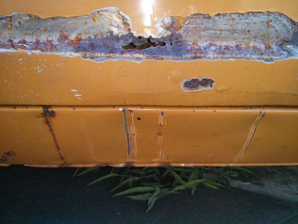

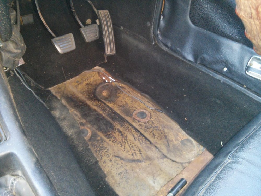

Zedback Posted December 19, 2013 Share Posted December 19, 2013 For a 40+ year old car that's got a drop in sunroof and has had a hit up the rear it's remarkably rust free. Doesn't look a thing like mine! Congrats. Get a rotisserie, welder, grinder, hammer and a vice and just go for it. Quote Link to comment Share on other sites More sharing options...
zzzzed Posted December 19, 2013 Share Posted December 19, 2013 You got an awesome buy there mate. Quote Link to comment Share on other sites More sharing options...
George Posted December 19, 2013 Share Posted December 19, 2013 You got an awesome buy there mate. Agree. Have a blast Gav. Just out of curiosity, how much would it cost if you had to pay someone to do all the rust repairs? Quote Link to comment Share on other sites More sharing options...
C.A.R. Posted December 19, 2013 Share Posted December 19, 2013 All those photos seem remarkably familiar... If you need any conformation shots from my Early Girl, yet sing out Quote Link to comment Share on other sites More sharing options...

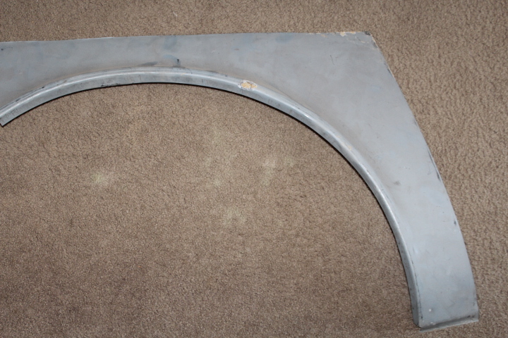

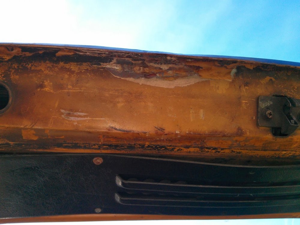

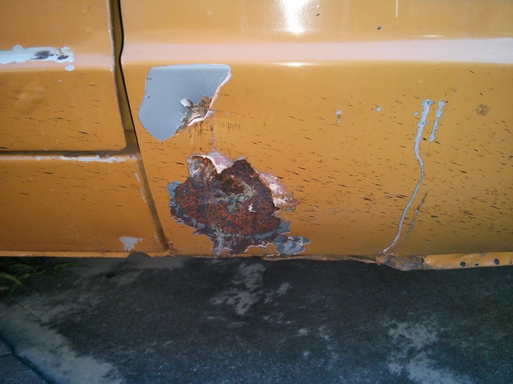

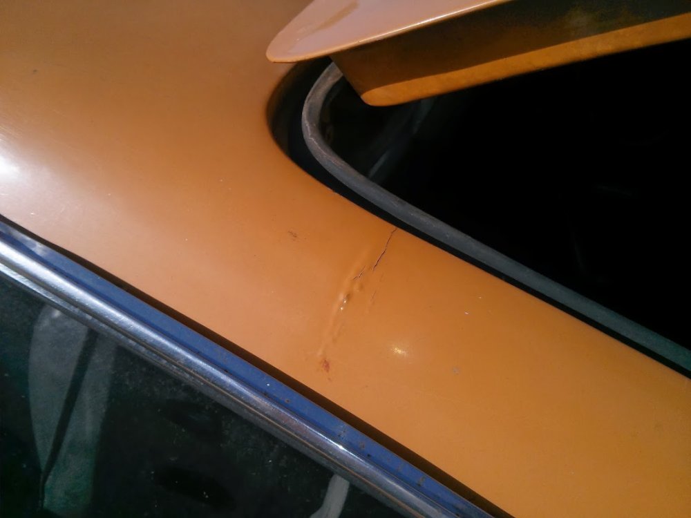

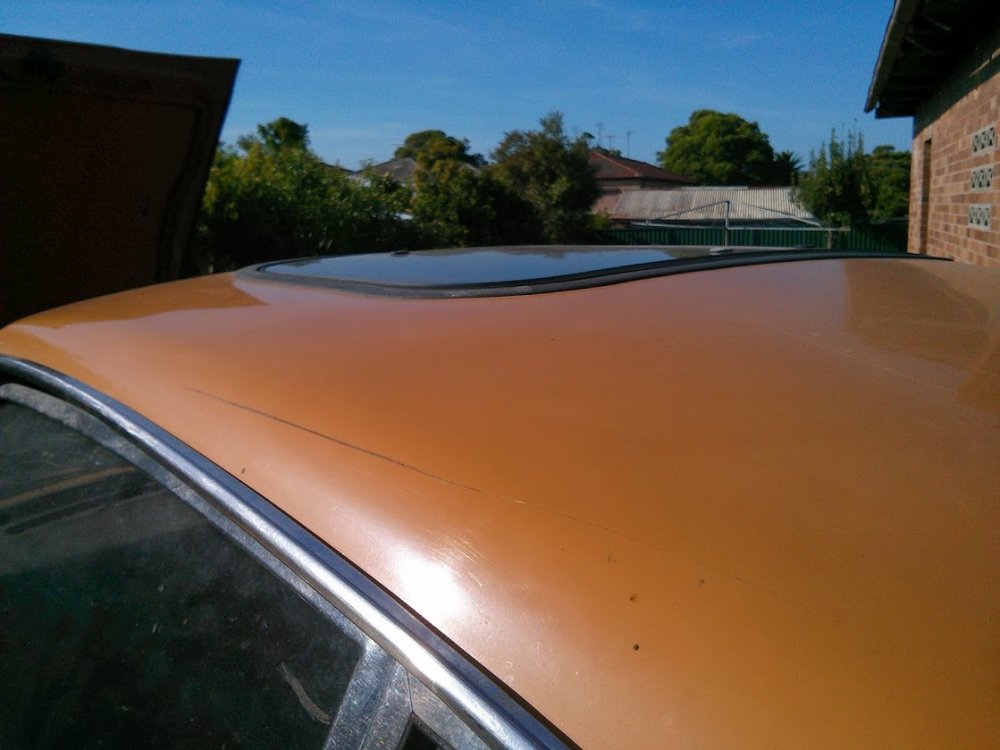

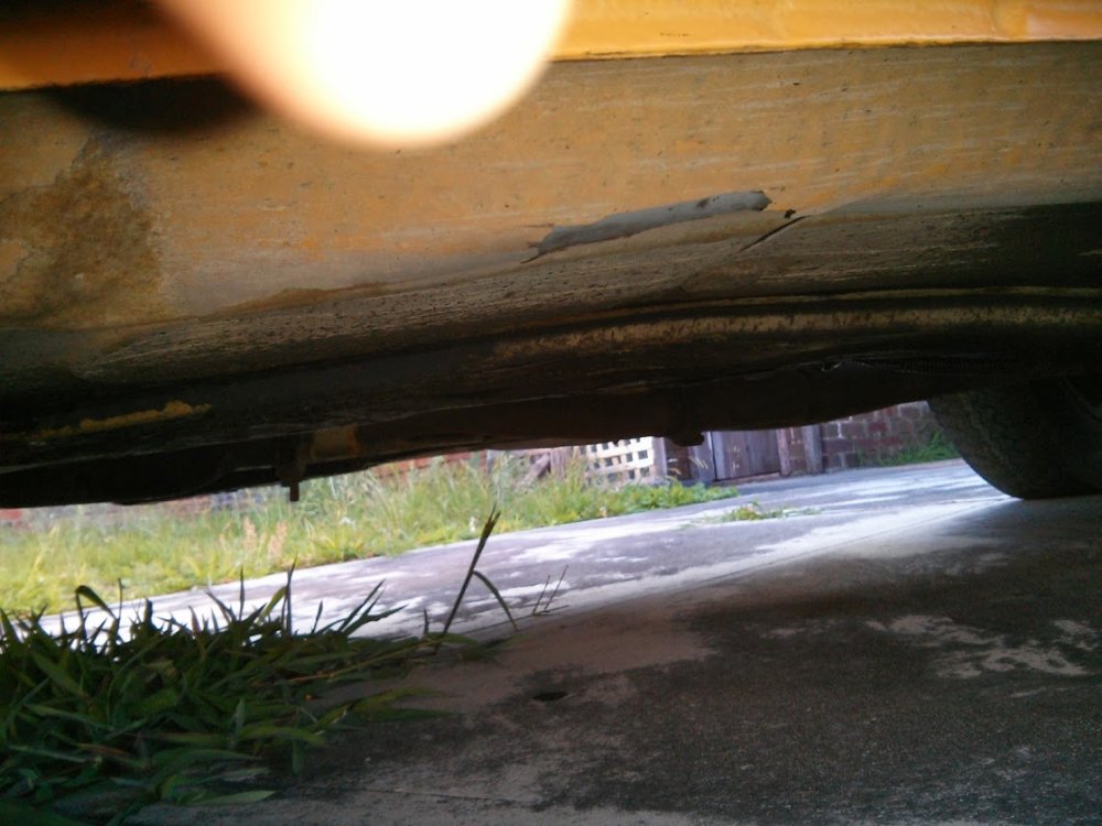

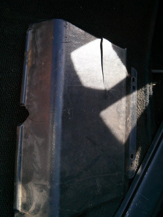

mossy Posted December 19, 2013 Share Posted December 19, 2013 Glad to see you got it there safe Gav. That 1/4 crack near the roof line, I'm pretty sure thats where the lead fill join is, mine had the same sort of crack but there were no suprises underneath. I've got a left over wheel arch repair section from my 240 if you need it. Quote Link to comment Share on other sites More sharing options...
Administrators gav240z Posted December 20, 2013 Author Administrators Share Posted December 20, 2013 For a 40+ year old car that's got a drop in sunroof and has had a hit up the rear it's remarkably rust free. Doesn't look a thing like mine! Congrats. Get a rotisserie, welder, grinder, hammer and a vice and just go for it. Thanks mate, you've certainly helped inspire me to take the plunge on this 1. You got an awesome buy there mate. Yeah all things considered I'm pretty happy with it. Agree. Have a blast Gav. Just out of curiosity, how much would it cost if you had to pay someone to do all the rust repairs? Hmmm I guess it depends if you stripped the car yourself etc.. I got Rob at ZFactory in Victoria to do some rust repair on my other 240z, which consisted of sills, rear of chassis rails etc.. from memory it was very reasonable prices. I can't recall exact amount now as it was 10 years ago nearly! I would need to look it up. But rust repairs are the most expensive part of restoring a Z I'd say. That and finding all the missing bits and pieces. This will definitely be a budget build. All those photos seem remarkably familiar... If you need any conformation shots from my Early Girl, yet sing out Thanks matey, maybe I can come down for a few welding lessons? . Glad to see you got it there safe Gav. That 1/4 crack near the roof line, I'm pretty sure thats where the lead fill join is, mine had the same sort of crack but there were no suprises underneath. I've got a left over wheel arch repair section from my 240 if you need it. Mate I'll take any charity I can get. If I don't use it I'll make sure someone does. So yes I'd love to grab that off you. Quote Link to comment Share on other sites More sharing options...

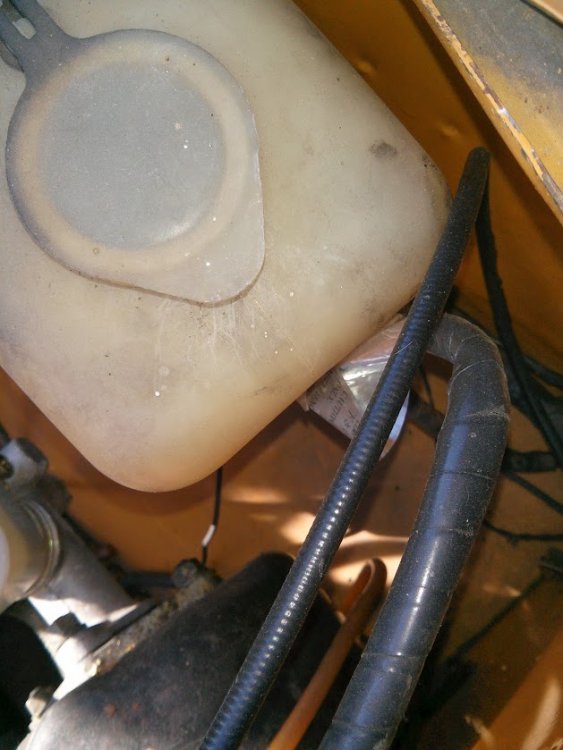

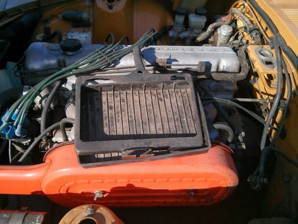

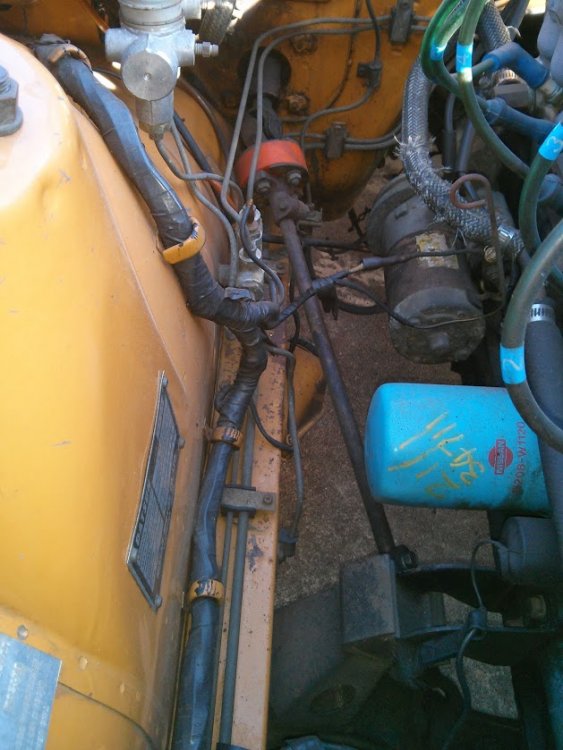

Administrators gav240z Posted December 20, 2013 Author Administrators Share Posted December 20, 2013 Oh yeah I checked the motor oil, it's of a milky consistency (not black, but a milkshake grey). Perhaps it blew a head gasket? Has the E31 head on an L28 bottom end. Aftermarket extractors (the ones we see on loads of Aussie Zeds) and still running points distributor. I think my first step is to slot in a motor and see if it will fire up, at least that way I know it will run and I can possibly move it around the yard under it's own power. Then gradually I'll tackle sections of rust and as a I build the confidence up I'll look at putting it up on a rotisserie (gonna have to learn to spell that word, think I'll be using it a lot). . It was funny the Tow Truck driver said "shame about the sunroof" and I laughed to myself and thought, yep that's the 1 thing out of the whole car I'm disappointed about, but I'll keep an eye out for a 2 seater roof. I have a spare bonnet also, but I might see if I can use a hammer and dolly on the original one and beat her back into shape. What's the worst that can happen? . Might also paint it flat black like the 432R's and Alan's replica project, leave the under side in Safari gold. The fuel tank has overspray on it (from when someone tried to touch up the backend) and the fuel tank has taken a bit of a beating on the underside. So I might look for another tank. Quote Link to comment Share on other sites More sharing options...

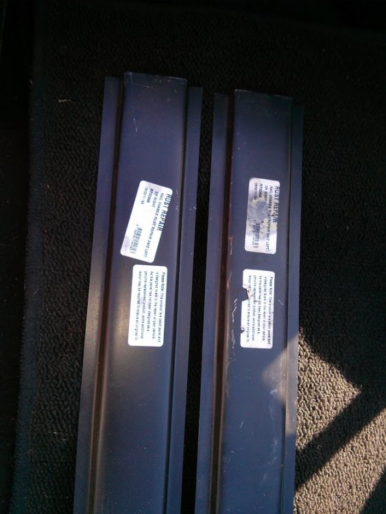

Brabham Posted December 20, 2013 Share Posted December 20, 2013 Pretty nice zed there Gav, good that you scored some chassis rails too, only remove as little metal as you need to do the repair, always best to keep as much original metal as possible, although you still need to make sure all the rust is gone/treated. Sounds like headgasket has gone, if you are going to pull engine out probably not worth putting one back in as the bay needs some work on it, pump the tires up high and two people can push it around on the flat ok. I thought the original headlights were Koito's? That is what is stamped on the headlight housings and I have seen car with lamps to match, Lucas was British and GE US, Koito's are Japanese made so would make sense. The two switches are 1)NOS and 2)Methanol-water injection. No, don't know what they are for either but look aftermarket even though there are cutouts for them-someone will know. My vote for new wheels goes to original steelies and the plastic covers - everyone has Wats now! Good luck with it Quote Link to comment Share on other sites More sharing options...
mossy Posted December 20, 2013 Share Posted December 20, 2013 Mate I'll take any charity I can get. If I don't use it I'll make sure someone does. So yes I'd love to grab that off you. No worries Gav, just cover the postage and I can send it or you can see if someone can take it on a Melb to Sydney trip Quote Link to comment Share on other sites More sharing options...
vorn70 Posted December 20, 2013 Share Posted December 20, 2013 Now you know what you have got you can make a start. I like your idea to start on the areas you have the confidence with, you will be surprised how your skills will improve and the areas where you started you will look back on and say I could of done that better, but I like the idea of the car telling a story in a "home shed" restoration. Good Luck mate, and you know better than anyone everything you will need to do has been done by a member on this forum. I know what I have read on this forum has helped me heaps. Quote Link to comment Share on other sites More sharing options...

Moderators PB260Z Posted December 20, 2013 Moderators Share Posted December 20, 2013 Oh yeah I checked the motor oil, it's of a milky consistency (not black, but a milkshake grey). Perhaps it blew a head gasket? Has the E31 head on an L28 bottom end. Aftermarket extractors (the ones we see on loads of Aussie Zeds) and still running points distributor. I think my first step is to slot in a motor and see if it will fire up, at least that way I know it will run and I can possibly move it around the yard under it's own power. Then gradually I'll tackle sections of rust and as a I build the confidence up I'll look at putting it up on a rotisserie (gonna have to learn to spell that word, think I'll be using it a lot). . I agree most likely the head gasket is blown. That doesn't nesecarily mean it wont run and give you enough grunt to move it around. Would be worth trying even if just for shivs and giggles ???? Quote Link to comment Share on other sites More sharing options...
Riceburner Posted December 20, 2013 Share Posted December 20, 2013 Nice one Gav! I think the lead cracking is a result of chasis flexing, You can fix it yourself if you're brave. Have a look for "Peach & Tomasini" dvd's, those guys are masters. BTW. How come you can post so many pics in one reply? Lol Quote Link to comment Share on other sites More sharing options...

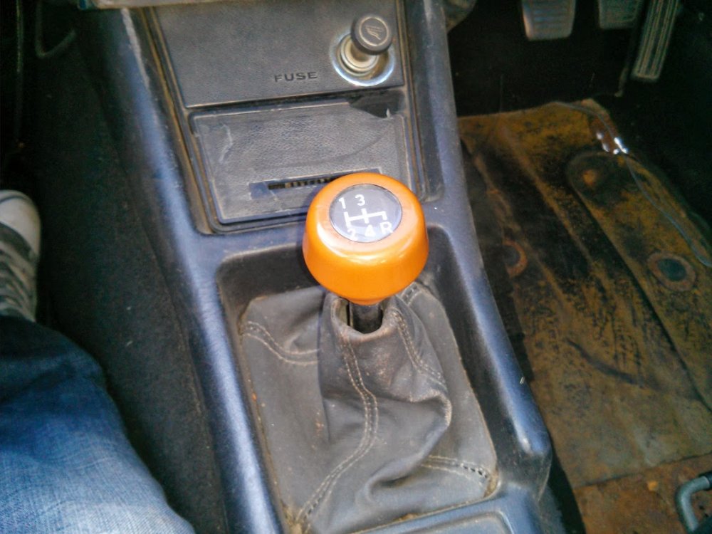

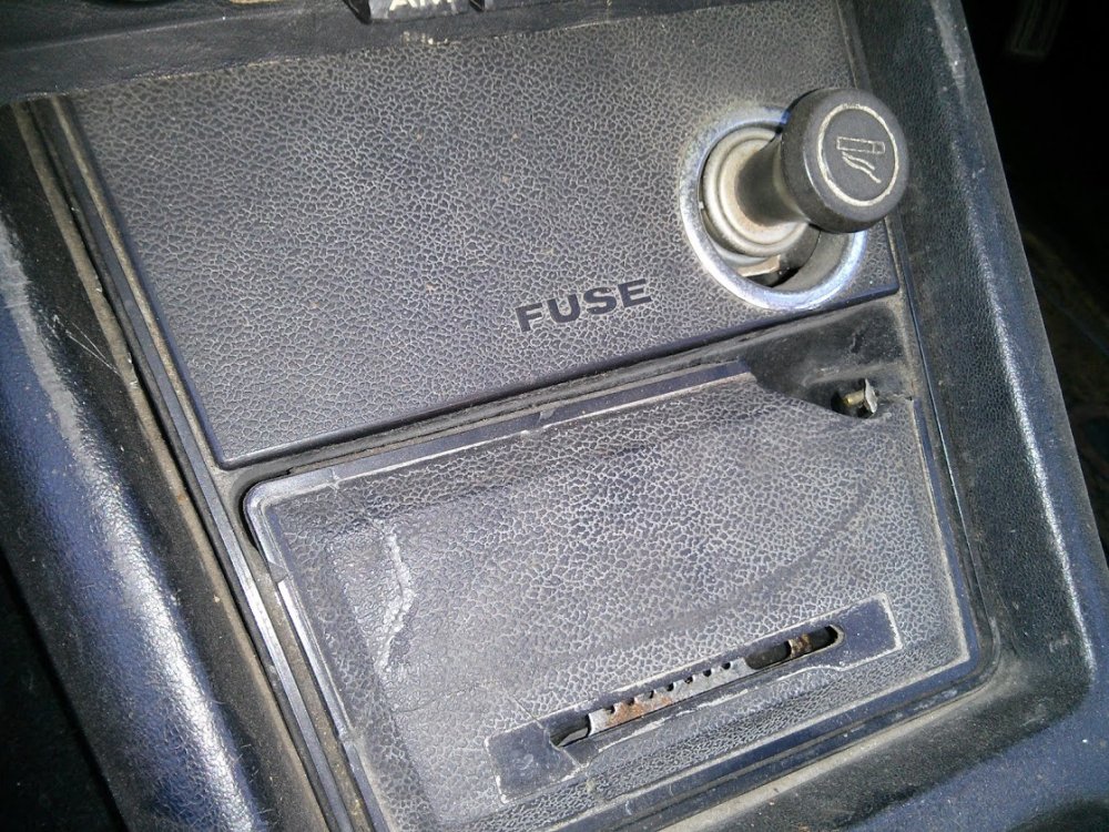

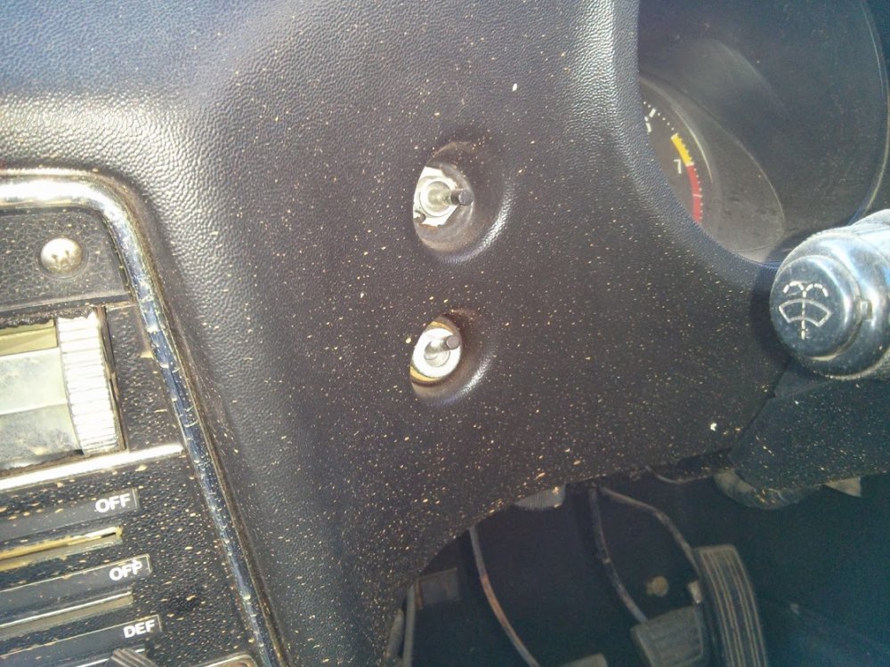

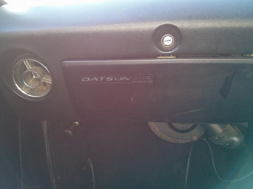

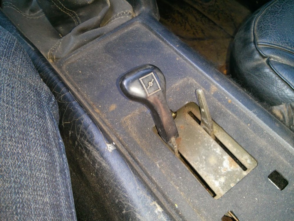

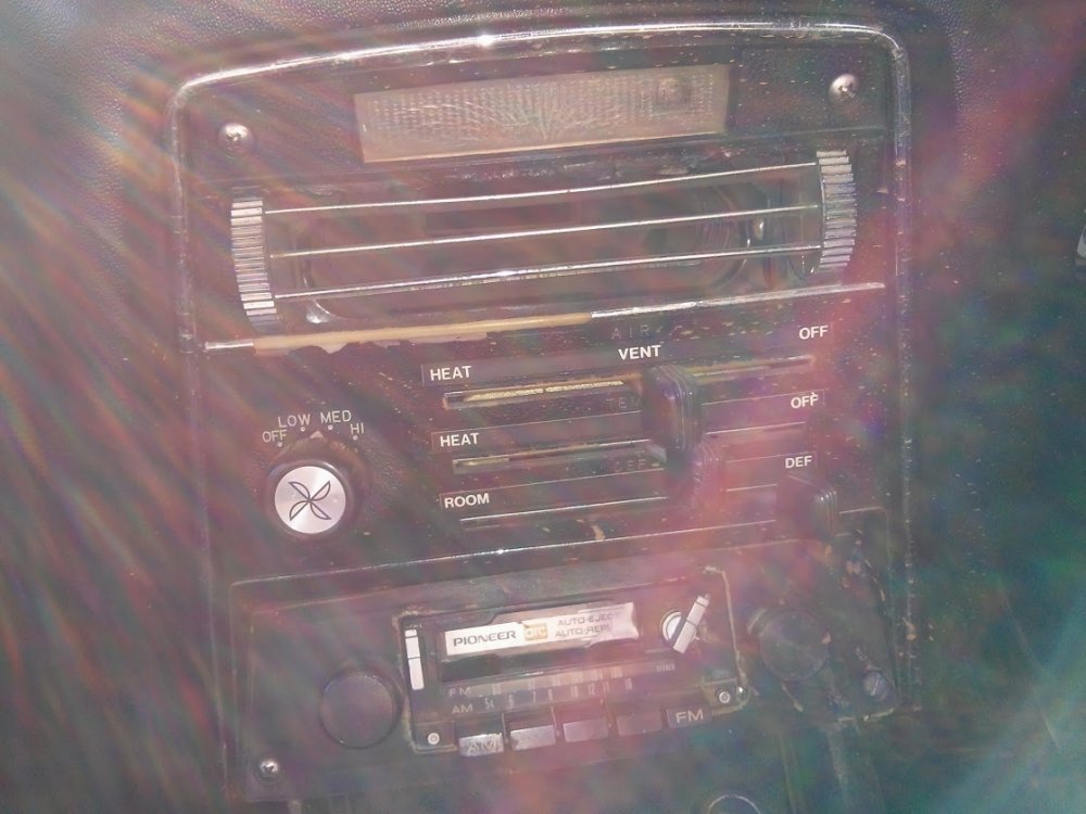

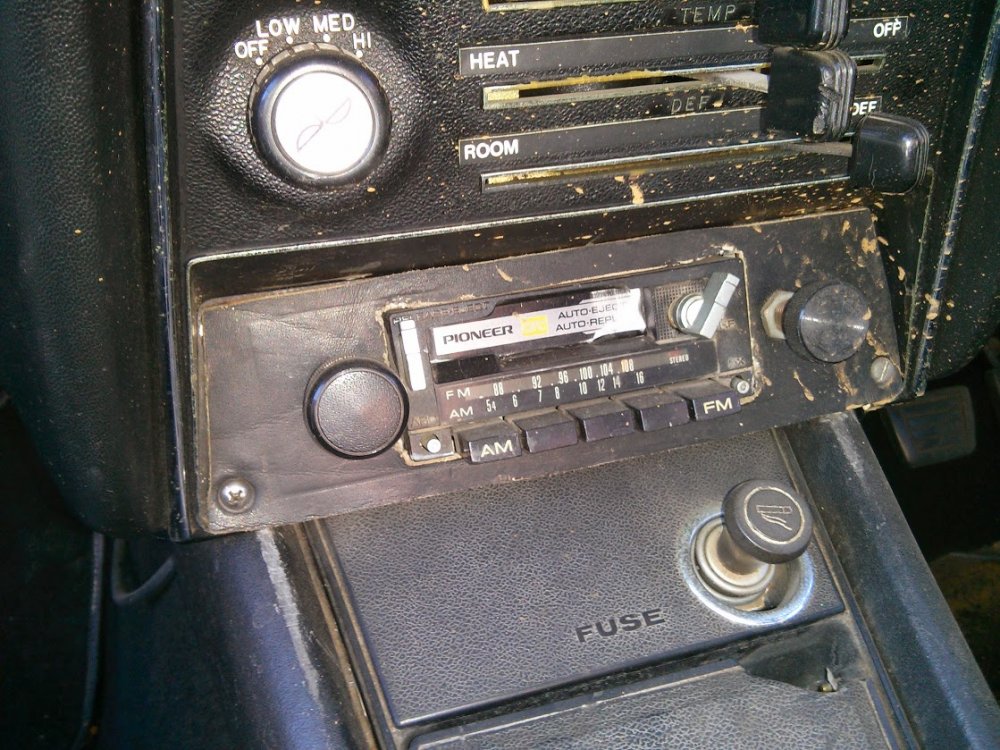

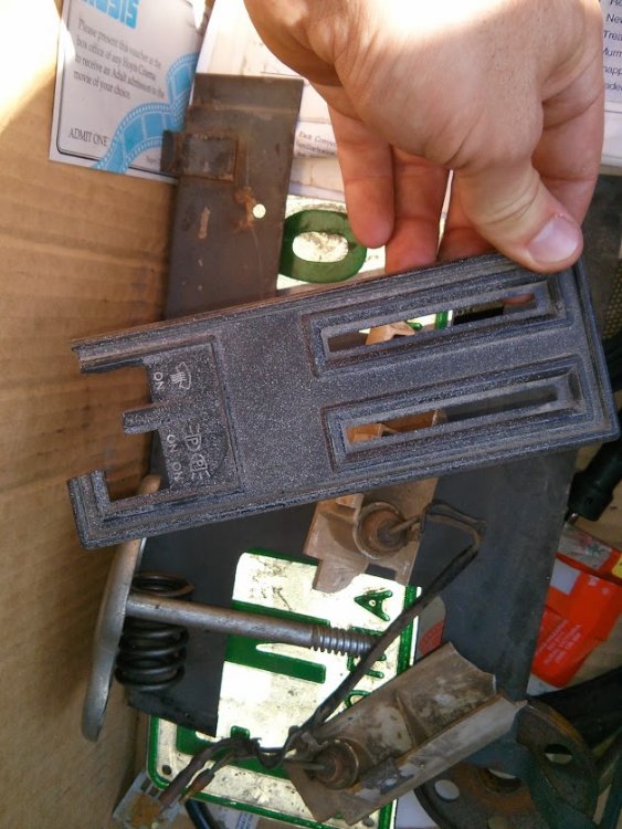

HS30-H Posted December 20, 2013 Share Posted December 20, 2013 Going to need help figuring out what these do. My 72 doesn't have these here. Upper one was originally left as a 'blank' indentation from the factory, with no switch installed. It was reserved as the location for the Fog Lamp switch, should the owner choose to specify the extra-cost option fog lamp kit. Original and genuine fog lamp switches are SUPER rare. Looks like a previous owner installed a switch for something else there. The lower one is usually the hazard flasher switch. Quote Link to comment Share on other sites More sharing options...
