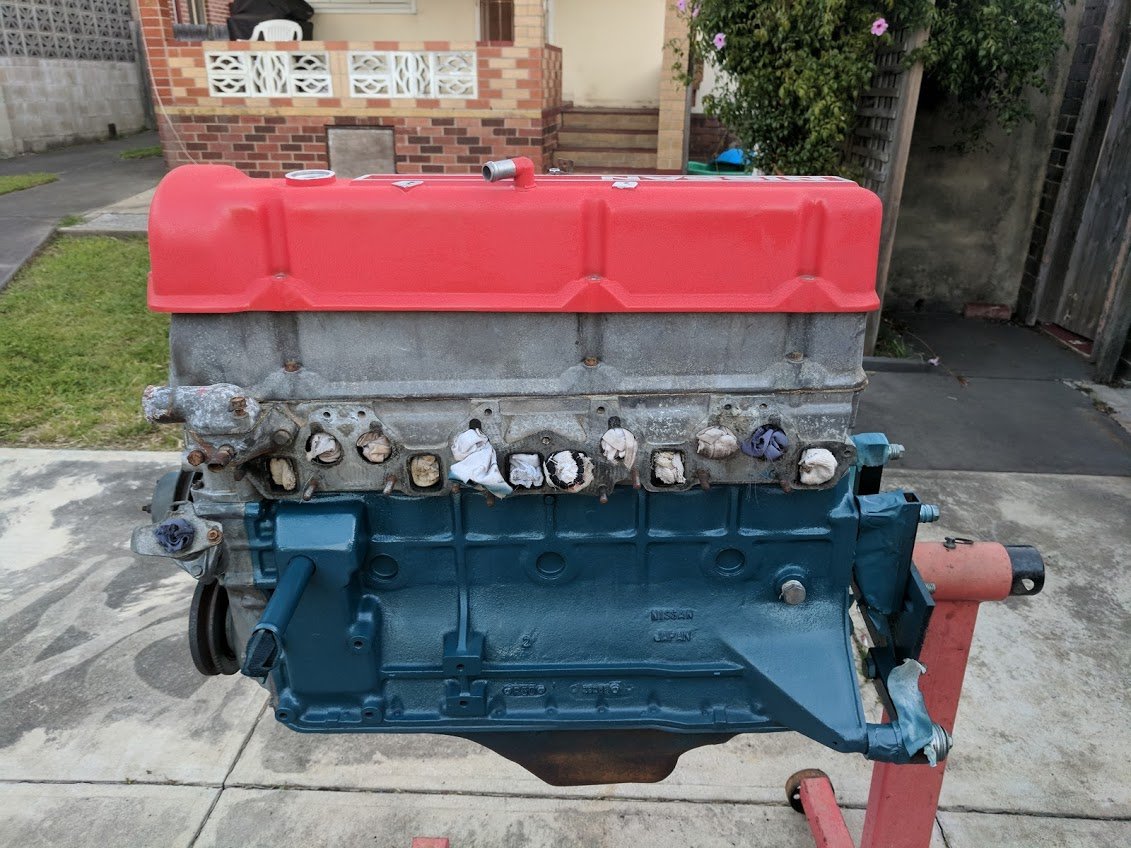

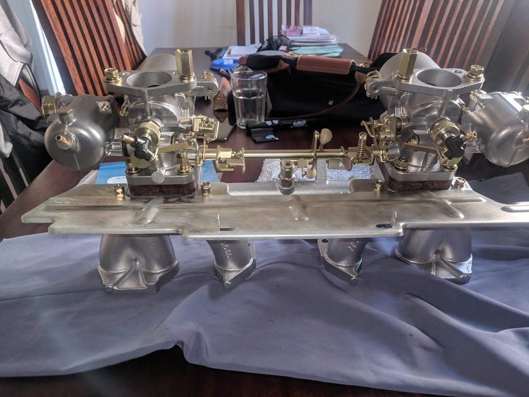

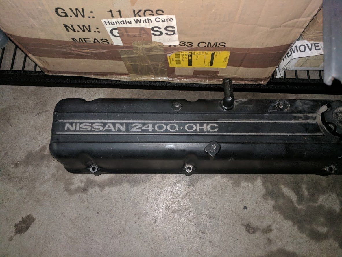

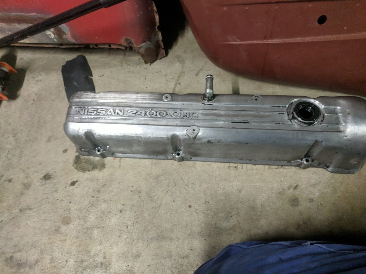

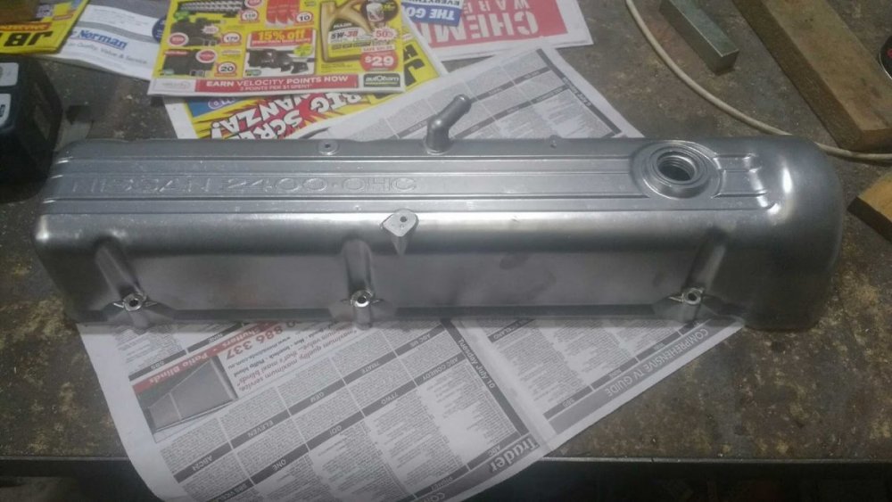

I hadn't realised it was 6 months since the last update. I was going to wait, but there is some news to share. When I was in Melbourne I dropped my E31 head down to Les Collins workshop (Stewart Wilkins is very busy - hence going interstate). The cylinder head has some corrosion in the combustion chamber from sitting 20 years. So the cost to refurbish the head is a little bit higher than expected the chambers will require some re-welding and repair, but... since it was the E31 I decided to go ahead rather than use an N42 or later cylinder head. On an early girl it just feels a bit more 'correct'. I am fully aware for the most part it's just a casting number.
Camshaft specification is likely to be standard A-grind or a mild cam to suit induction (SUs). This way I'll retain standard rockers, lash pads etc..Cam towers will be changed from external oil bar lubrication to internally lubed camshaft and towers to suit.
I still haven't fully decided on the block, but I think I'm going to use an L24 block also (even if it won't strictly be matching numbers). I have a spare L24 crank from my 72 240z and 2 L28 cranks (2.6ltr) laying around. Not sure if I'll give her the slight bump yet.
I am doing this to stick to a sensible budget, rather than modify while it's apart. For those wondering yes, there is good reason for sticking to a budget which will eventually come to light, but for now it's an Auszcar secret. ;)
Benefits of staying stock are, cheaper to rebuild, I can retain the SUs rather than "need" triples along with the standard airbox and I think it will set a good baseline if I do hot her up in future. Also a standard motor will be easier to drive, so my partner can also drive it relatively easily. I forgot that driving an S30z is not quite as easy as modern cars and I think this will be a good way of getting her comfortable driving an older car.
Finally I opted to go for water jet blasting on the cylinder head and valve cover after seeing a couple of P90s with the treatment down at the shop I thought the finish was awesome and not too much "hot line bling".
In other news, the tafe course should resume a couple of weeks into February so I should be able to get cracking on the body again. This years build moto is to outsource a few more jobs and get the project moving along faster.
  • Lurch ™, jeff43, Sirpent and 2 others like this

Good to see progress Gav, the cover looks like it just came off the production line, well done ;-)

Looks fantastic Gav. Water blasting does the job well.

I like it because it gives it a very plain like new finish. I remember when Adam's Brown Hornet was done and I saw how he opted for the flat alloy look I really liked it. I think James at MIA Engines in DeeWhy had used a scotch bright pad to get that finish on it.
The water blasting is a little more bright than the dull look of Adam's valve cover.
Ultimately I think you can have too much bling. This is a bit more understated. The finish looks even better in person! I am anxious to see the cylinder head with it also.

The water jet blasting finish looks great, does the cover in that photo have a sealer on it? Do you think carbs (Webers) could be treated with it? How much does it cost? And finally, any idea on where this service is available in Sydney?

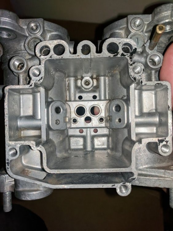

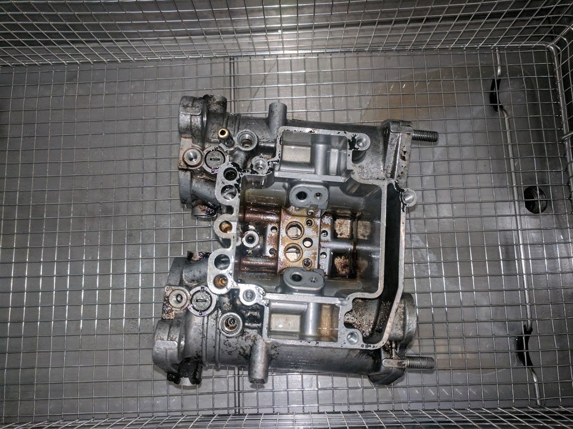

I don't believe it has any sealer on the cover, my understanding of the water jet blasting is that any oil leaks can easily be wiped up unlike the standard finish where it can impregnate itself into the surface. It sounded good to me, hence the reason I went with it. We will see if it works in practice though.
I am pretty sure Peter Mac posted a photo of some Mikuni's that had been blasted, don't see what harm it would do. Gotta be better than other solutions! Between the head and the cover it was about $200 (so $100 each). I don't know anyone in Sydney I'm afraid.

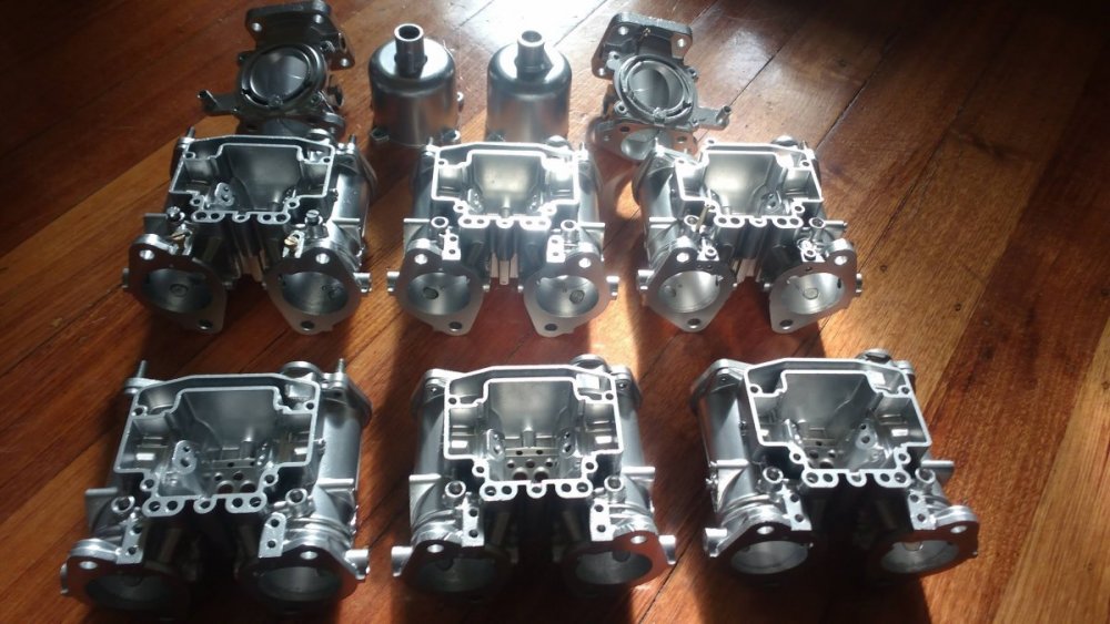

I just looked at the bill for my Water-jet basted rocker cover & it was $200 to have done (inside & out).

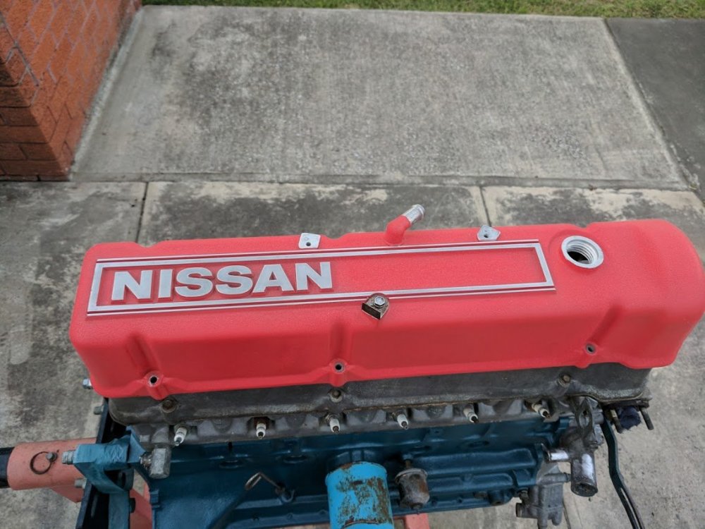

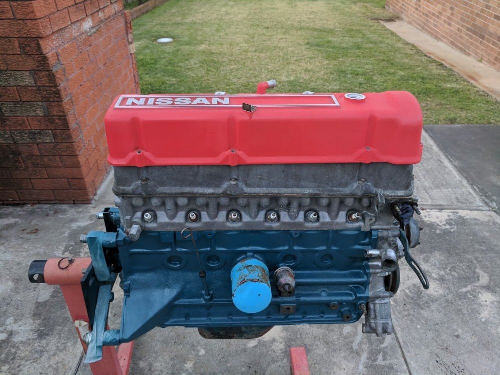

Update from the Candy Shop.

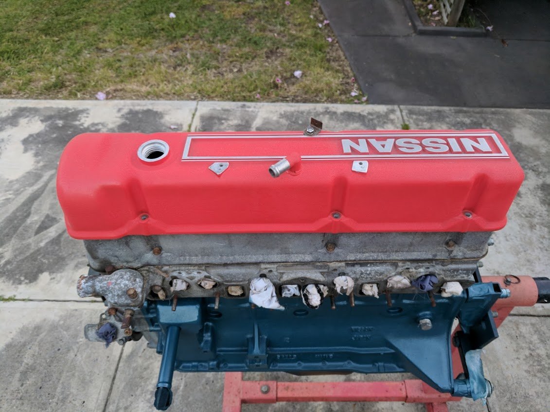

And boy am I glad I opted for the water blasted finish. I reckon it looks the ducks nuts. You can see how it looked before looking at the Overview Of L6 engine heads thread (the images of the E31 are this cylinder head).
Can't wait to get this thing fired up after 20 years of laying dormant.

Looks the absolute goods Gav !
  • gav240z likes this
Nice Gav. I recognise that table!!
