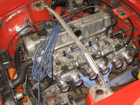

Triple Dellortos ready to install

Thanks Jack. Yer I'll get that linkage sorted soon and bolt them on. Probably still a couple of weeks away as I'm away from home on holidays atm.

Well it's been some time but finally got a chance to install my tripples. To my surprise once installed they started and idled with no adjustments. Took the car for a spin and found it smoked more than usual and sounded like it was running rich. Photo below of my dirty engine bay. Disregard all the tempararily blocked off lines. Next move is to remove the A/C and all the unecassary piping in the engine bayy to clean the motor up a bit and have a go at tuning the carbs. Oh definately need to change the dodgy flexible Lynx rose joints.

well they look sweet, your almost there if the car starts and idles. Did you buy this setup brandnew or secondhand. What sort of $ are we looking at here if you dont mind me asking :)

Hi Sulio,
          Congradulations on the latest edition to your car. Remember that Dellortos like about 2.5 psi fuel pressure. You can also change the bango fitting on the last carb to allow fuel to return to the tank through a small restriction , to reduce pressure on the needle and seats when the engine is turned off.

sulio ; You didnt talk about the sound i mean the ... Grrrrr sound. There should be a law against it. In fact i am going outside to start my car up again.  ;D
Congrats in getting them on and getting them started. I know what a B$%^ they can be...  But the increase in performance is superb. You'll love it.
One question : how's the strut bar clearance on your linkage . Been thinking of putting a strut bar but the linkage is quite high.
enzo250gto : thanks for the tip will follow on mine .
I bought these used from an Italian fella that sell them on e-bay. All up the set up has cost me about $1100.00 to date that is with carbs, manifold, linkage kit, soft mounts, trumpets. However, from my understanding you can spend that much quite easily on proper dyno tuning once installed.
Thanks David, Yer well I have them running from the mechanical pump. I've noticed some time ago I also have a fueflow sensor inline between the pump and carbs. I do not believe it's a factory item so most likely remove it.
It regards to the small fitting I noticed it and I've plugged the reurn line. I'll look up the Italian fella for that lst fitting.
Yer they do sound pretty good. Scare small children away!  ;D Thestrutt bar clear easily as the carbs sit lower than the SU's.

Hi Guys,
Well after plenty of messing about to get linkages correct, (I ended up ditching the Links manifold and plastic rose joints and buying a new Redline manifold and metal 5/16UNF rose joints I have set my tripples up and got them running better than the SU's with minimal headaches as far as set up went. My 240 SU's were a nice inprovement on the the old flat tops in terms of both power and reliability. The Tripples have been a jump on that again to my surprise considering its a stock L28 in need of a rebuild.
Since my last post on this topic I have installed the air bleed restrictors Mick74 truned up for me which fit very nicely. I also installed 130 main jets. The engine cold starts very easily with no requirement for chokes although I might install a cable for them one day see how I go. Engines idles as low as 500rpm but I've got it idling at 900rpm atm. Acceleration seems nice from down low with a very nice power band at higher revs there is no obvious bog down or spitting at the carbs. I am still running the 7222.10 emmulsion tubes which I would like to replace with 7222.7 but this will be a fine tuning exercise as I'm very happy with the way she goes atm. any gains will be icing on the cake.
I do have one question. I have been advised by many to aim for idle mixture screw to be between 1 to 1.5 turns out and I have mine running at 1 turn out and running nicely. However the Des Hammil book advises they should be 3 to 3.5 turns out for Dells!???
Anyhow for anybody that might be inetersted I have listed my final set up below. As already mentioned the engine is an L28, stock cam, elec dizzy working at 12 deg advance.
