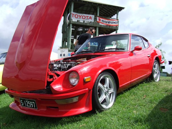

this is a set of 17x7 performance lotus on my 260z very low profile tyres not sure what off my head. looking at the 16x9s on the sale items now so may be for sale in near future. They were a popular correct offset (no spacers) modern z wheel a little while ago. I like them but prefer the jdm watanabe,superlight, rota rb look. Just not sure i can cut metal and put the flairs on........a very tough call :)

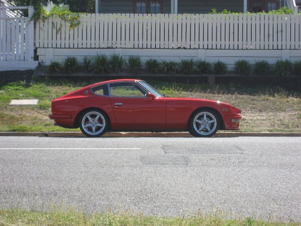

better view of profile, clearance and wheel style :)

I have same wheels as 74zzz on a2+2. 235x45x17 which means very cheap rubber as it matches the old Commodore/falcon.
See photos in my signature link.

ride is stiff to solid:) Jason is right! with front camber can be a little sketchy in the cornering dept.....
