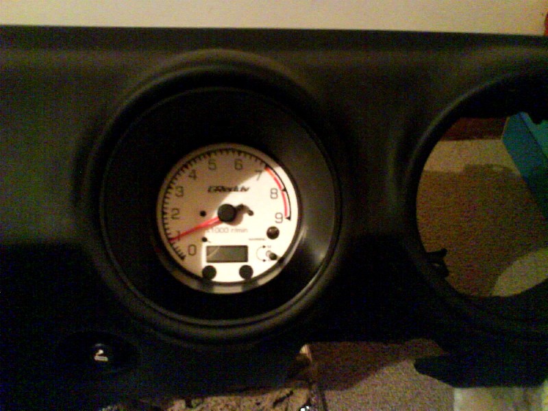

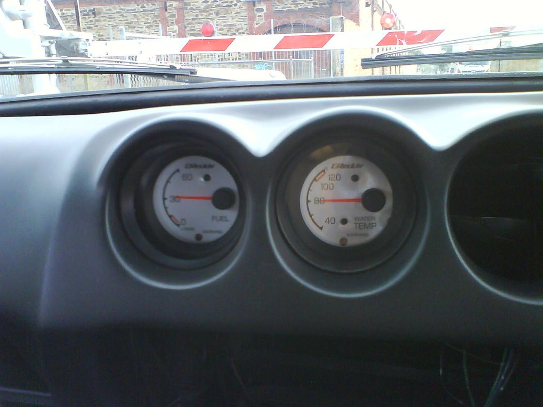

i know ive been slack. well making your own gauges is a big project in itself.
so far ive completed the temp, fuel and rpm gauges. though only the first two have been installed in the car.
speedo, boost are about 90% completed just need to stick them into original Z housings.
oil,volt and indicator/warning lights cluster are lot further behind.
as my other telementary is displayed using Apexi AVCR ie rpm,spedo, throtle, injector pulse etc.... at the moment its all i need to run the car.
havent installed the rpm gauge as i need extra mini loom for wiring in the backlight controll as its in the way.
backlight is based on LEDs 3 main colours RED, white and blue but switchable 7 colours (ie more than one colour at the same time) hence the reason for the extra loom.
just took this pic this morning of the two gauges mounted in the car while i was waiting for the chu chu to go past on my way to work.
as soon as i put the backlight loom in al take nite shots.
ah i found the rpm picture on my work pc. bit crap quality but at least the gauge can be seen completed.
