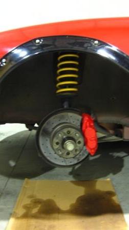

Well I fianlly installed the 83-89 (I think) S12+8 Hilux Calipers I had. Put in new Bendix pads also. Currently using 7/8 MC with drums oin the rear. I put off installing the 15/16 MC til I pick up some 280ZX calipers.
Anyhow the braking was much improved. Took it out on a quiet road and did a quick succession of hard brakes from 100km to stop. Now from memeory the stock brakes with what I was advised were "performce" pads would get soft after about 4 to 5 quick stops like this. With the Hilux calipers I get about double that. Also the I don't need to press the pedal as hard when braking normally.
It will be very interesting to see how the 15/16 MC and rear discs will behave once installed.

Just picked up a set of the hilux calipers from a mate in the club. I figure its a good time to replace the rotors as well and have seen all the ebay ads for the slotted ones with the holes. Sulio in your picture yours just has the holes drilled.
