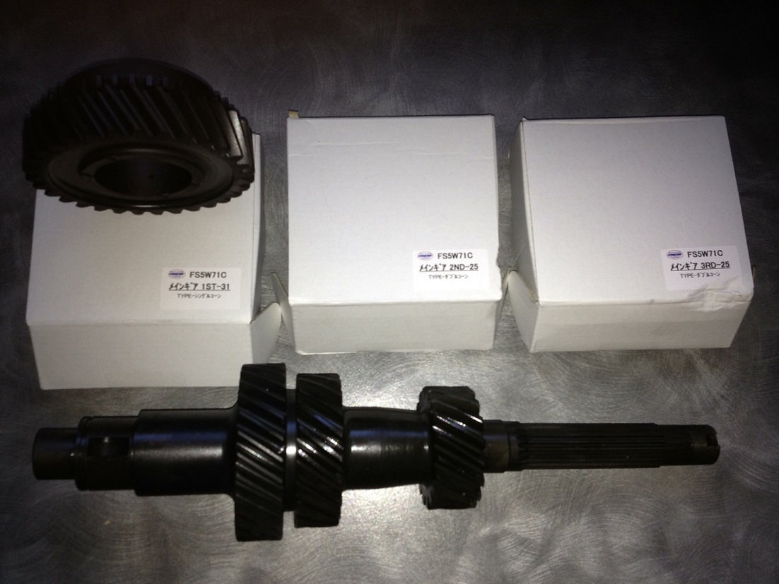

I have a syncro question so may as well post it here too. I have new Kameari CR set and all new syncros. Do I need to lap in all syncros or only syncro on the used 4th and 5th gears?

Yeah it's a set for the rb20(r32gtst) box Stu Wilkins had a .83 fifth that I also got.
Why are the new gears brown/bronze?

The colour would be due to heat treatment process at a guess.

Yeah i was just going to say the same thing, or a coating.
PMC just made me a similar setup Kameari 71C gear cluster but in 71B housings so it just bolts up.

Here's what it looks like. I thought maybe it was to stop corrosion, but heat treatment sounds more likely.
Re syncros, I think I'll only have to lap the used gears as these will be the only ones that are worn/shiny.
EDIT. How did he fit the C gear sets into a B housing?
