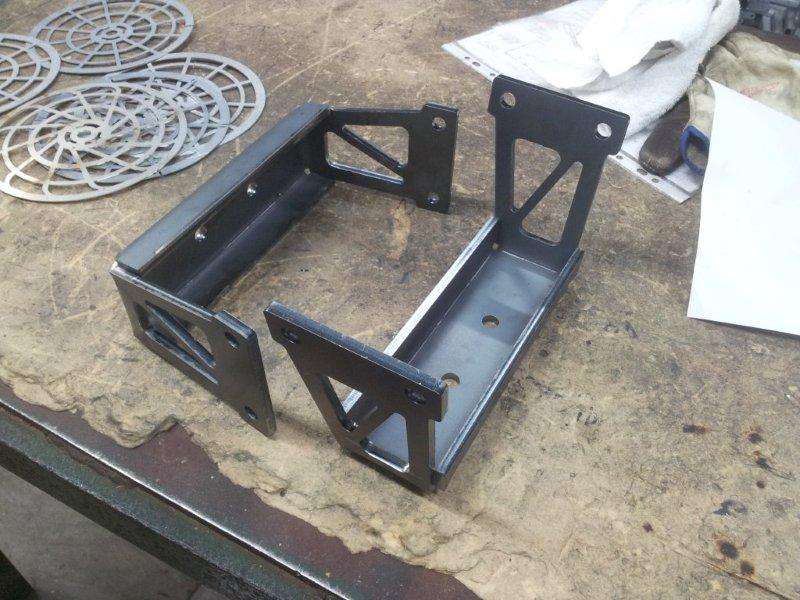

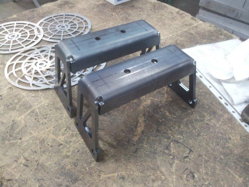

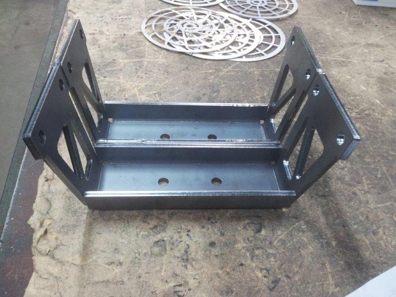

As Promised,
I read this post ages ago and roughly drew these up,
only since ive seen it get bumped a few times have i bothered.
Changed the layout a bit, to make it EASY to cut and bend, then weld corners only, mayby whack a tack welded nut on??
hole size for bolt is only 11mm, so clearance for an M10 or tap to M12?
Also the gap between the 2 flanges is an easy 50mm, so check with the rubber bumpers you may already have.
These are strictly the 1st offs and are unwelded, can be if you want????
Ill check fitup tonight when I get to my wk-shop, need to check brake and fuel line clearance....
Make an offer.....
Nat0

Hey Nat, I have a techno versions style and mine has a cut out on the top drivers side to clear the steel fuel/brake lines. I'm not sure of the dimensions though. Even with this mod it was very hard to fit.
If I had my time over I'd go the SW Motorsport style, so much easier and it uses a bush that is proven to last 40+ yrs.
