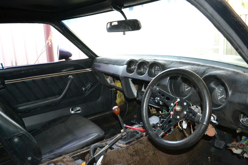

Well its finally happened and I got myself a zed. Now as much as I wanted a 2 seater the simple fact of the matter is my wife gave birth to our first baby a few weeks back and I plan on taking them both to future events so the 2+2 made sense to me.
The history that I know of the car is that it was restored in the early 90's by the person I purchased the car off. Now he live in WA but then moved the Cairns where he ran the car on WA rego until it ran out and then it just ended up in a shed. He has now moved back to WA and I got the car from Cairns and its now ready to be restored again but there is some parts on the car that are still good (eg the carpet).
Basic out line of my plans are:
Exterior: High gloss metallic black, Polish all the stainless and chrome up. Re-chrome the bumpers (they are currently matched to the body colour), Headlight covers, clear lights which will be tinted with Crystalite (ADR approved headlight tint), HID's from zcarparts, Flares, Wide wheels to fill the flares, New badges all round including fairlady badges instead of the 260z ones, Fender mirrors (thanks Fairlady Z).
Interior: Black with red stitching, Will try and restore the wood and chrome plating as well. Hopefully will get a wood steering wheel from Fairlady Z as well
Engine: Hopefully a stroked L28 (3.1L) with triple carbs. I already have triple 40mm Dellortos with a redline manifold, The seller thought they were 45mm but when I checked today they have DHLA 40 on them.
Suspension and Brakes: Well it will be the usual brake swaps with discs all round and some form of coilovers.
I will be getting a list of parts I need as I strip her down so I will be sure to be hitting up a few members looking for stuff. Car looks like it had AC fitted to it as well.

Found my old image shack account so thought I would get pictures up on there so I can add larger images and not be limited to 4 per post.
Posted Image
The box with the Triple 40mm Dellorto's
Posted Image
View through the hatch
Posted Image
Rear seats aren't too bad but will still get retrimmed.

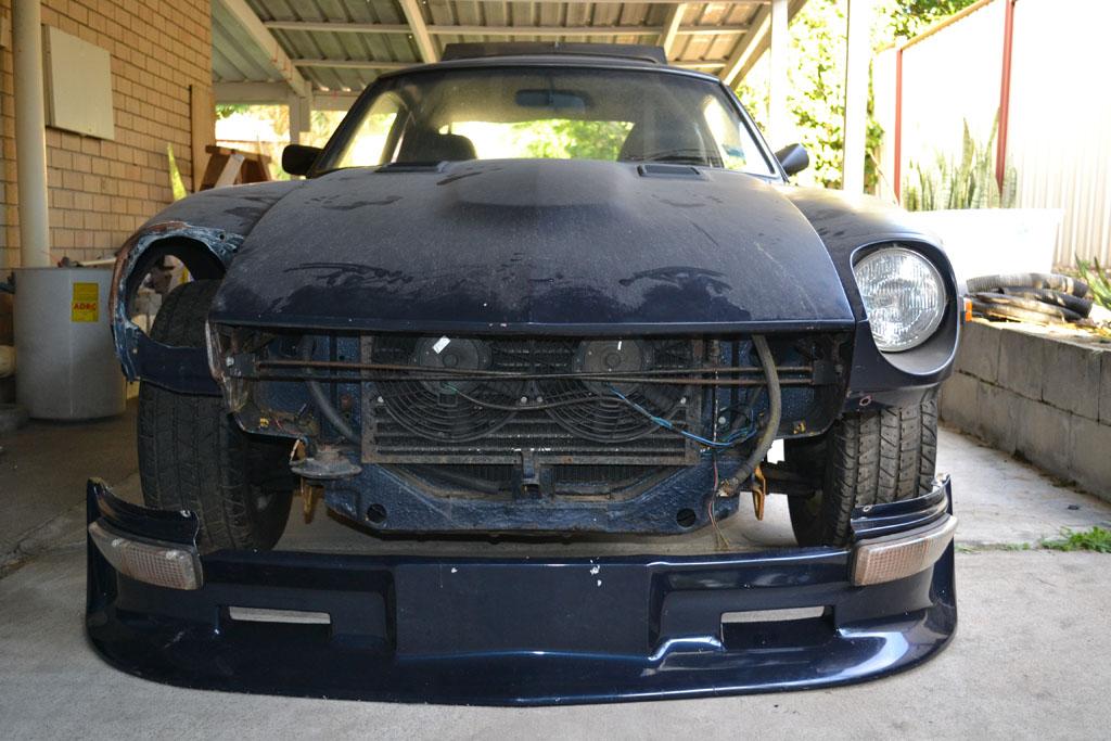

Went and poked around the car again today and finally got her up on stands to get a better view on things. Got some more parts coming which I will add photos at the end of the week but here is some more random things that have turned up.
Posted Image
Some random new old stock like ignition leads, l28 and l26 dizzy cap and rotor buttons and some other stuff.
Posted Image
Gear stick boot N.O.S as well
Posted Image
Window winder locking clips N.O.S
Posted Image
Door locks and the base as well that goes into the door card N.O.S
Posted Image
Zed finally in the air
Posted Image
Pulled the guard off to check it out as it will be going to panel beaters

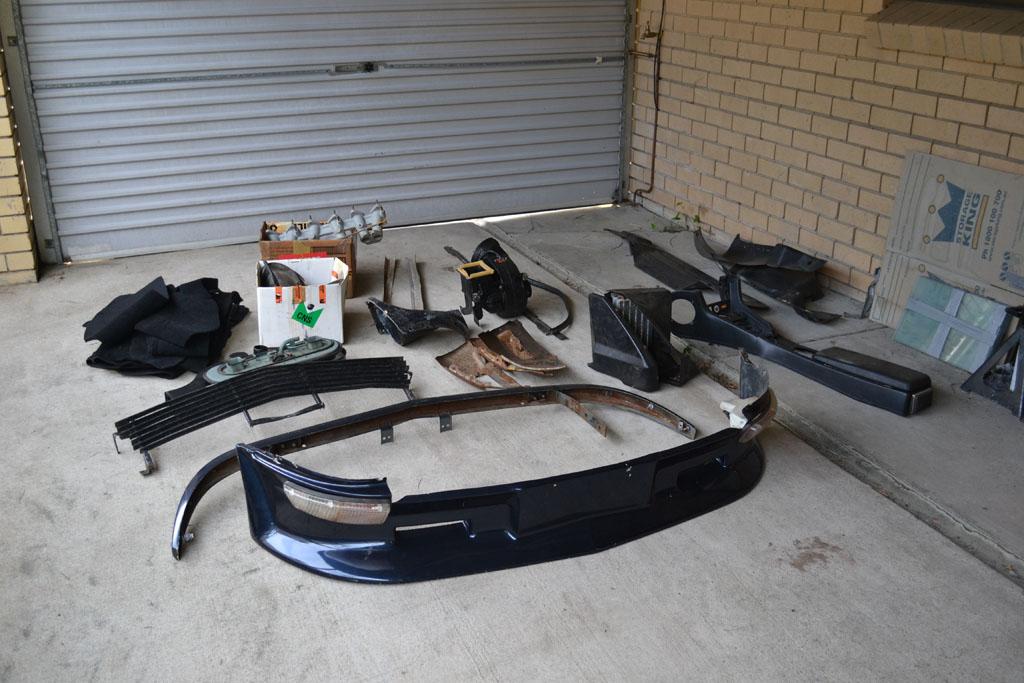

Well time for some more parts updates.
Posted Image
ZG Flairs from trusty Johnny (Fairlady Z)
Posted Image Posted Image Posted Image
432 Spoiler from Johnny as well. Needs some mods to fit the 2+2 right.
Posted Image
Box of random parts. The console piece was in better condition then mine so grabbed it.
