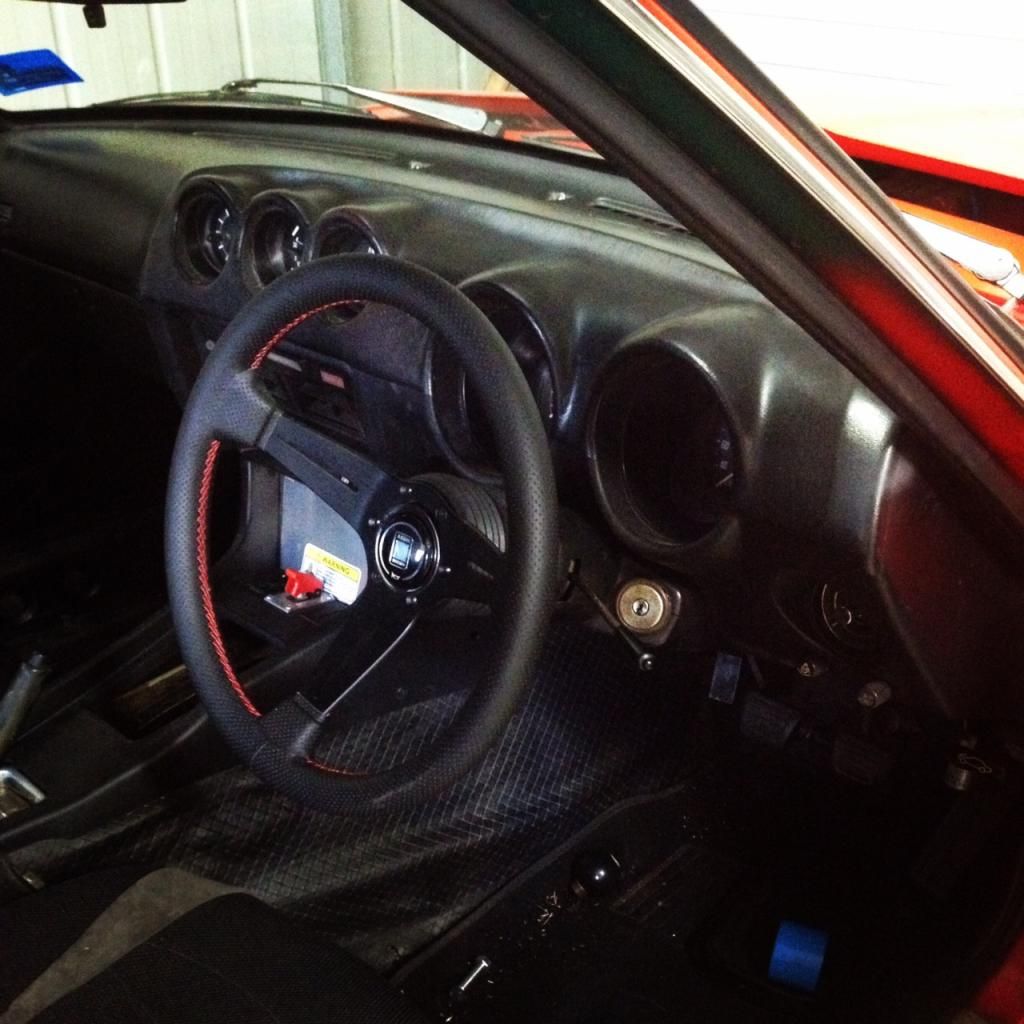

but the nardi...
Posted Image
just looks the part, ive only got the nardi horn button just sitting there as the clips need modifying to fit but i love it :D

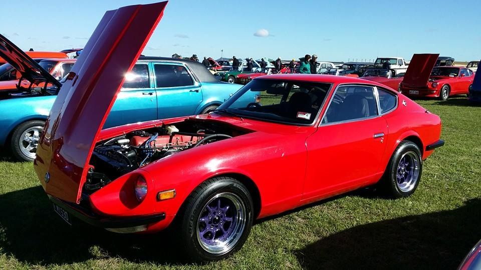

If you look carefully you can see 2 more zeds behind me, i met the guy in the red 240z last year. hes running a L28 turbo set up and what you can make out beside that is a blue 260 2+2 with a 350 chev, his plates were 350ZD

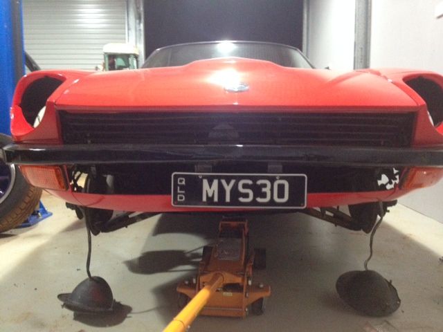

Not a great deal has happend ive swapped my gearbox back over to the 280 box instead of the 240 flange box that came bolted to the motor.
Posted Image
Having a hoist at my new place with my mate makes life a hell of a lot easier now too  ;D
Considering i had her jacked up on axle stands to rip the other gearbox out, i decied to wait till i moved to utilise the hose and make it easier refitting the new box.

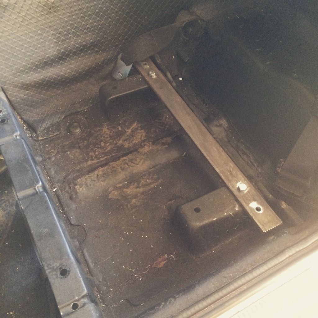

Im also waiting on some some T3 gear also, front & rear strut braces, C pillar brace, braided brake lines and the tow hook kit well because racecar!

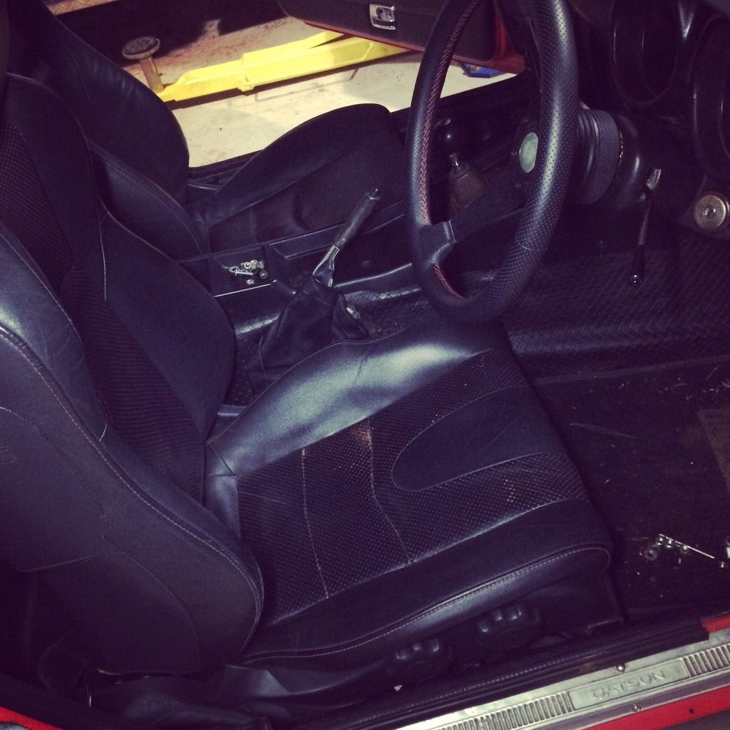

I've also scored some 350Z seats off may mate who upgraded his seats. here's the two side by side  8)
Posted Image

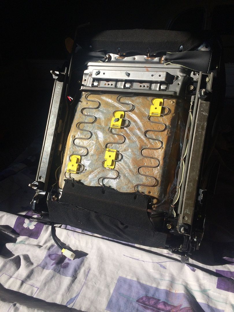

i was lucky enough that all i needed to do was remove the factory 350z rails and put my 260z seat rails on. i only need to drill one hole in the front of 350z seat base for the 260z rails to fit straight on
Posted Image
When it came to mounting the seats in the car i had to drill 2 new holes in the front section where it bolts to the floor. the reay section was too narrow so i used some 40x5mm flat with the extended holes drilled to suit and used the factory holes to mount my bracket so i didnt have to drill any more holes in the floor.
Posted Image
once that was all bolted in the seats dropped straight in
Posted Image
Posted Image
They actually look almost like they should be there. all the seat still function's and the rails move freely. i have removed the side air bags and repacked the hole with some foam cushion and you wouldn't even know. I've only got to run power to the drivers seat so i can be able to adjust the back support and it will be all sweet to get mod plated.

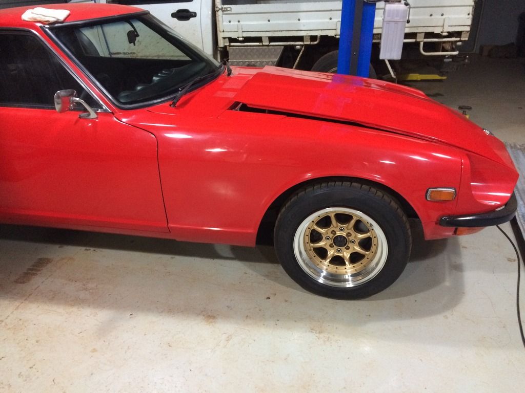

The purple wheels are no long purple but gold now.
Posted Image
It looks a lot better and cleaner IMHO

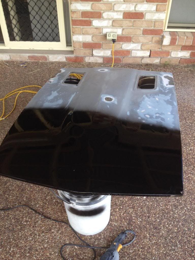

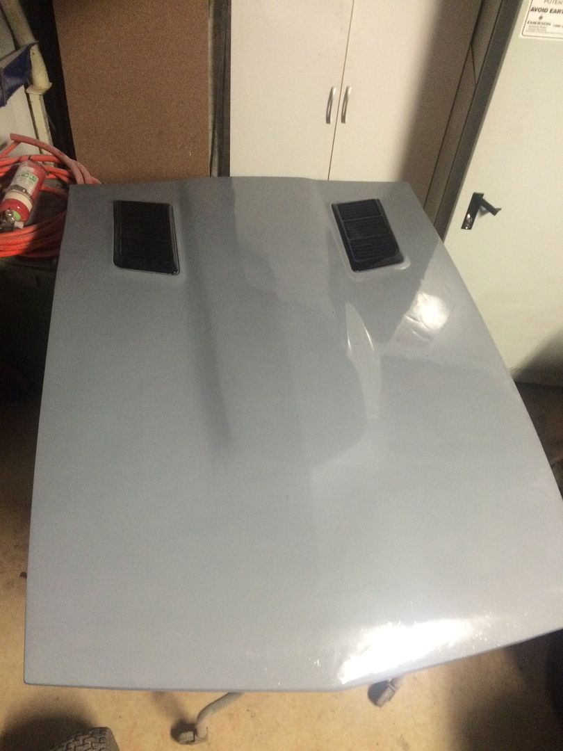

The bonnet also hit road block. i was going to paint it red, then it was going to be matte or gloss black, but now after finding a set of bonnet vents thanks to a fellow forum member Triptych. I think ill get it wrapped with the intimation carbon wrap with the black vents in hi gloss black to offset it.
Posted Image
